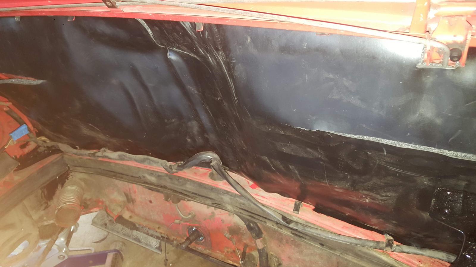

PostPosted: Tue Oct 02, 2018 6:13 pm    Post subject: Re: 1976 914 2.0- Reply with quote
It’s starting to come together.
Little por-15 in, around, under the hell hole. And in the engine hanger.
Motor done assembled by strictly foreign in Murphy, Or. 2260 did go with the SLR and 44/38 heads.
Rebuilt transmission
Redoing shift rod bushes
New braided brake hoses
little more prep. Darned little more prep and she rolling under own power
