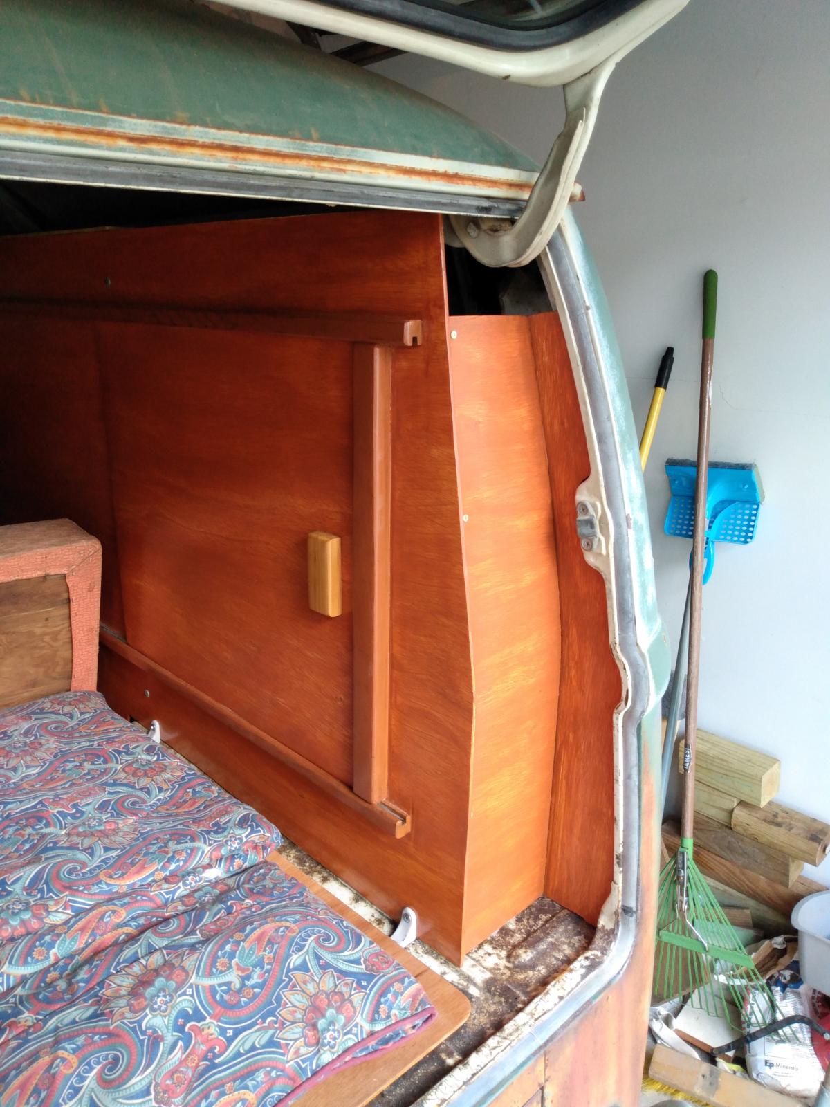

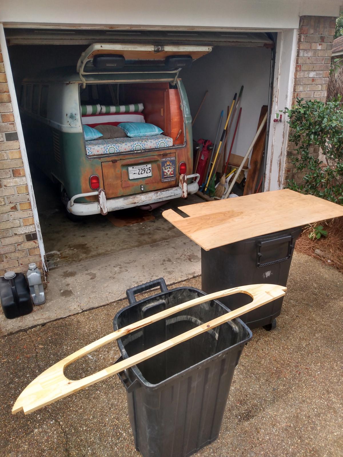

Figured I'd add a couple photos of the most recent component I've built for my camper, a headbanger cabinet.
Never argue with an Idiot. They'll only bring you down to their level and beat you with experience.

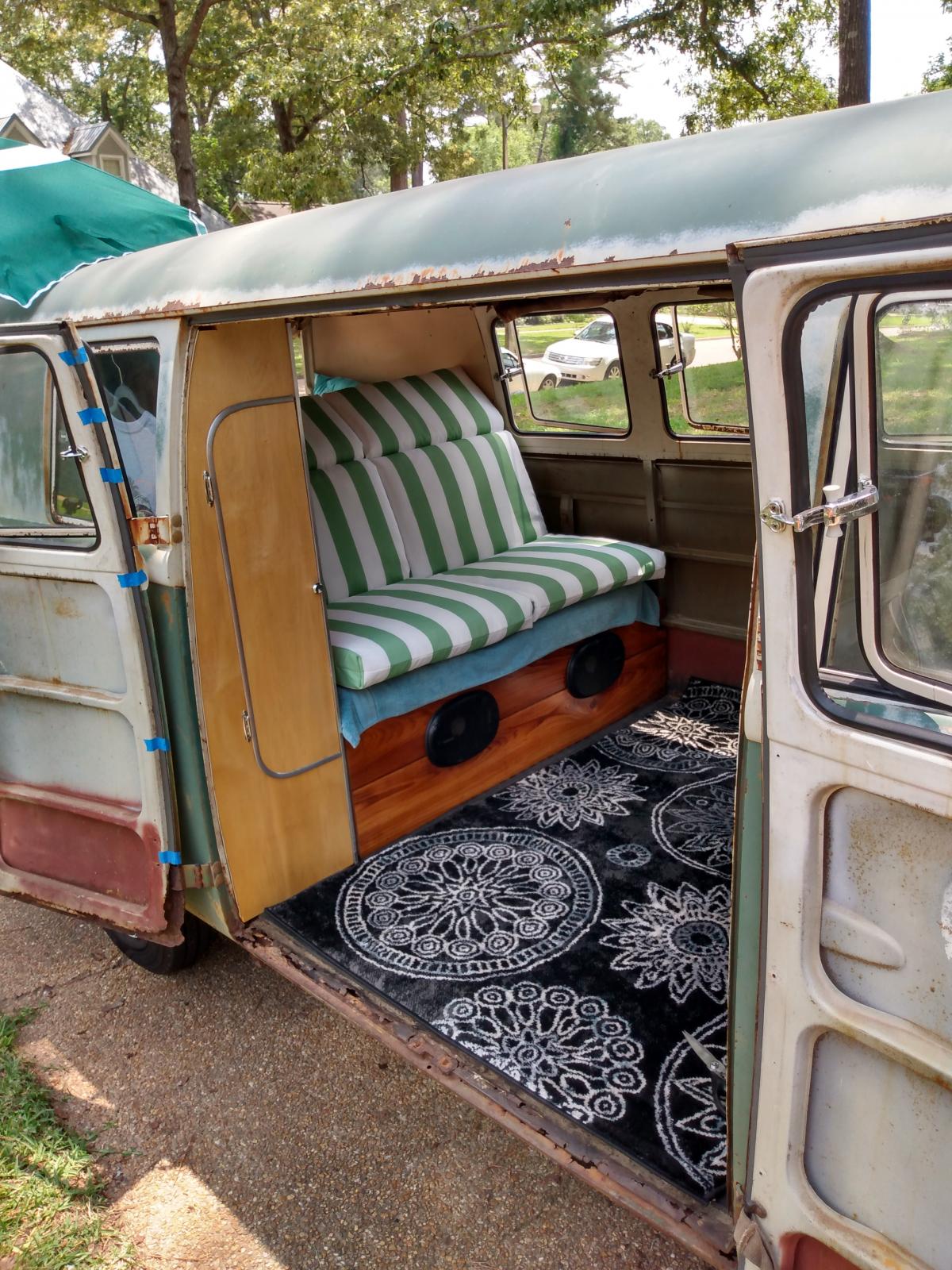

That rug really ties the bus together does it not? Hehe.
It's amazing how much less the cargo doors rattle and how the entire bus is getting just a bit more quiet going down the road with the more stuff I am adding to it as compared to when it was completely gutted/empty inside.

The Rug. ‘The Dude’ would certainly approve.

Nice work. Looking good!

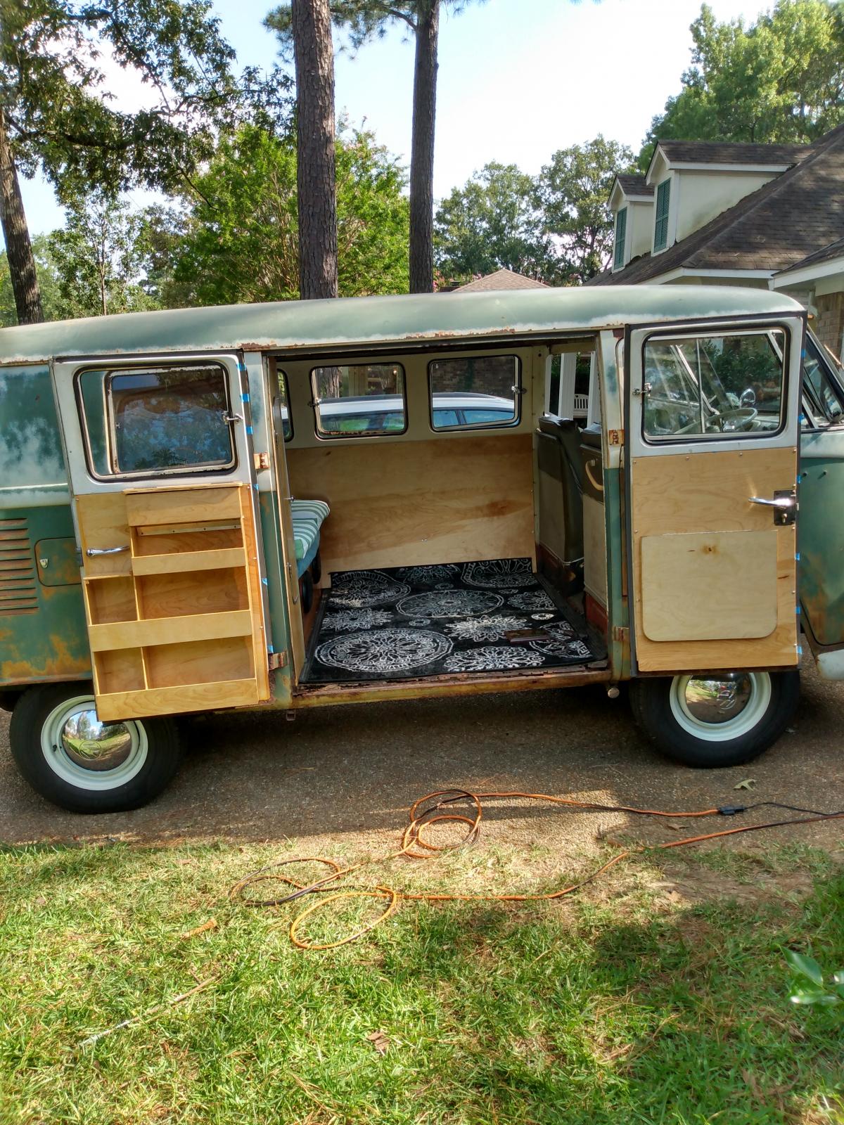

Cast iron tree branch sourced from Hobby Lobby supports the folding table. It installs in seconds with a pair of nylon 1/4 x 20 rc model airplane wing mounting bolts. Upward shaped branches I'll use to hang my cooking utensils from.

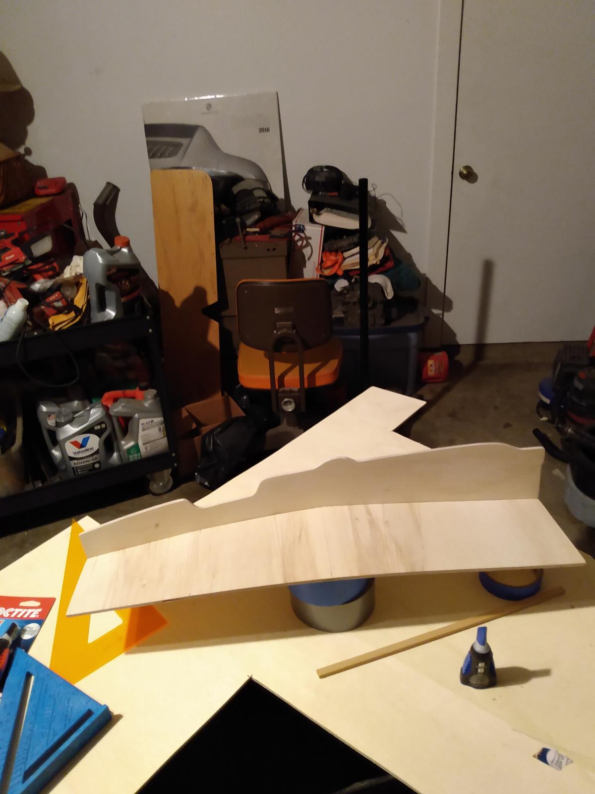

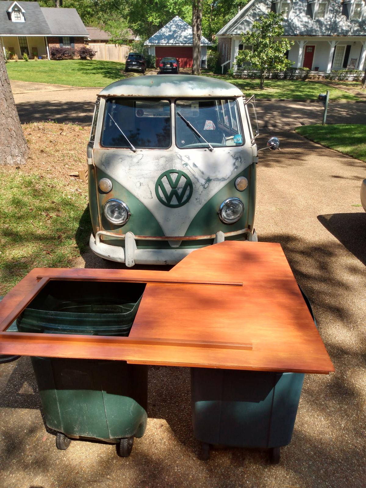

50 years of building RC model airplanes, this was pretty simple to make for my cabinet end closing panel.
Fit just right, left a little niche that fits a quart of oil just right!
The local auto/boat upholstery shops are busy for months out. A trip to the local close out blow out discount store I scored some outdoor furniture cushions and a rug. That rug really ties the bus together, man. Hehe.
Shot from the weekend car show. The BonTonRoulet was a hit!

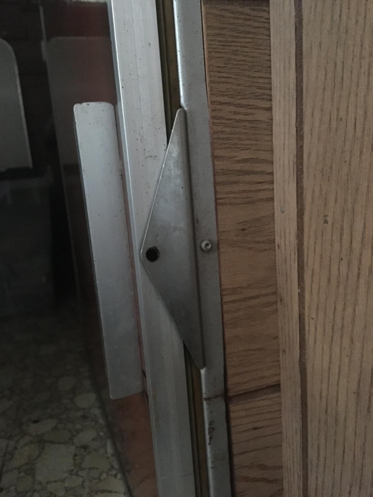

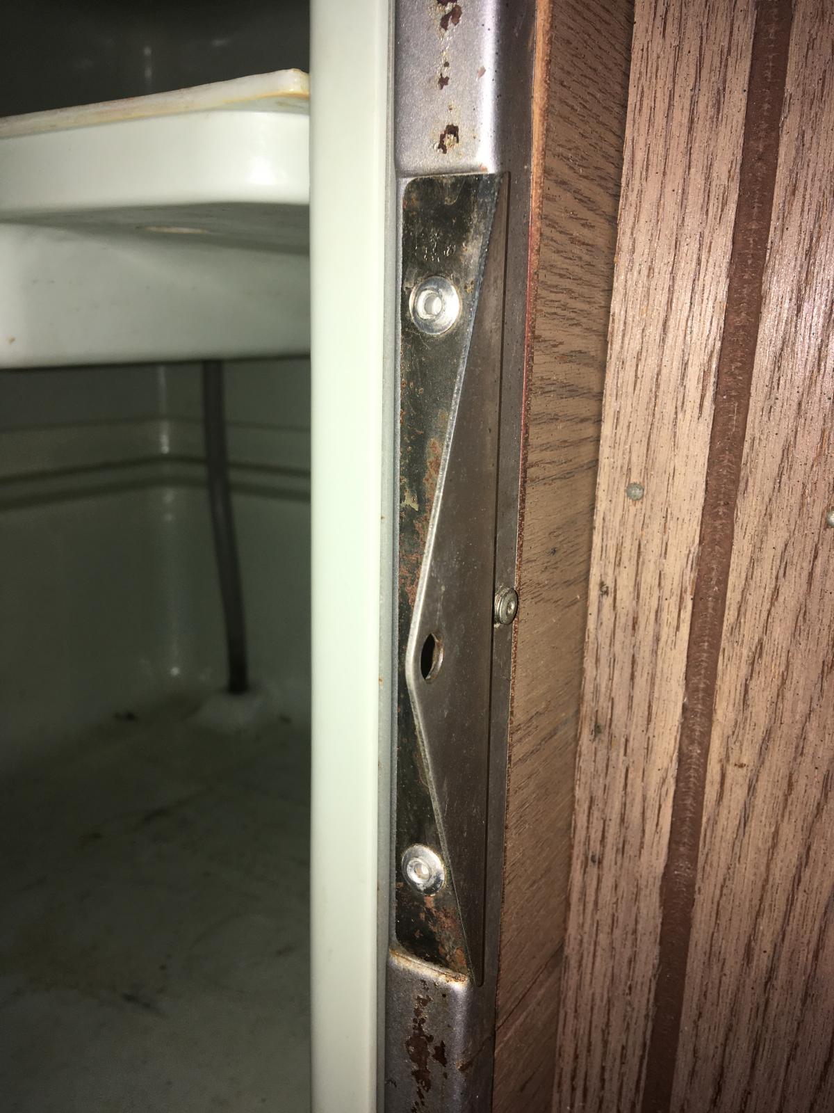

[quote="Michaelfind"]
oakman wrote:
Michaelfind wrote:
In your pictures, I see the door pin, I think, in a holder on a short chain near the "sink." That is probably for your ice box door.
I really like that your door pin is on a chain fastened to the cabinet. My father tied ours to handle with a short strip of leather so it would not get lost but I suspect yours is the original set up.
My icebox had an empty rivet right behind where the pin goes, on the frame of the opening (not the door). I'm positive it had a chain with the pin attatched.
Is there a rivet with nothing attatched in that spot on yours?
Kind of looks like it beneath the leather string?
Good eye! I believe you are correct. I finally got some pictures and there is a rivet with just enough space beneath the head for a retaining chain. It matches the rivets that hold the pin plate to the door frame. Now, I will try to figure out how to reproduce their original idea there. Thanks for pointing that out!
Pics below:
