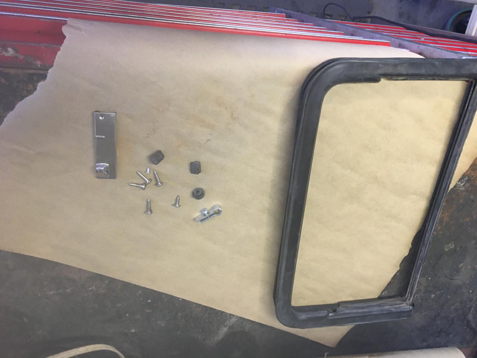

So, after calling Gary and Robbie to remind me of a few things on the vent wing parts/assembly (since it's been 10 months since taking apart the wing window) I finished it. I first sprayed the frame with a rust converter paint to neutralize any remaining rust. I then put three coats of black on the frame.
I layed the parts out that I "thought" came from the vent window assembly. Then read a few old threads on this vent wing for additional reminders. I had already stripped the rust and old zinc off the tension clamp and re zinc plated it last year.
I had one rivet holding the frame off so I could easily remove the glass frame from the main assembly. I made a mistake twice in the reassembly steps. I first put the rubber gasket in the mainframe. Then I realized I couldn't get the glass and frame in. I yanked the rubber seal out and laid it in loose. Then, put the glass and it's frame back in the wrong direction. Finally, I put it back in the right direction so the two pins went in their spots. I then put the rubber seal in around it. Getting the rubber seal in was complicated by using the original VW rubber that was just a bit hard but in great condition.
I then put in a new aluminum rivet to close the frame together again.
Not a fun project by any means. The main frame was rusted at the bottom as most are but it was still rock solid after media blasting the rust off. I sealed it well with several coats of rust converting primer followed by 3 coats of paint. Hopefully this repair will last for decades to come.

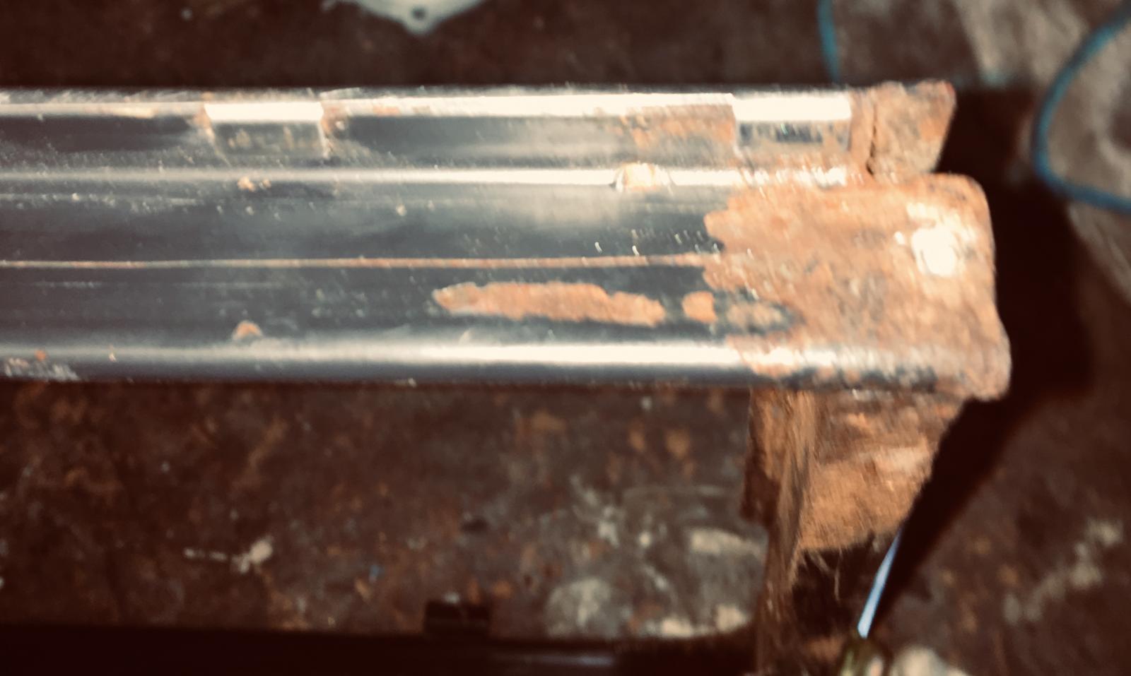

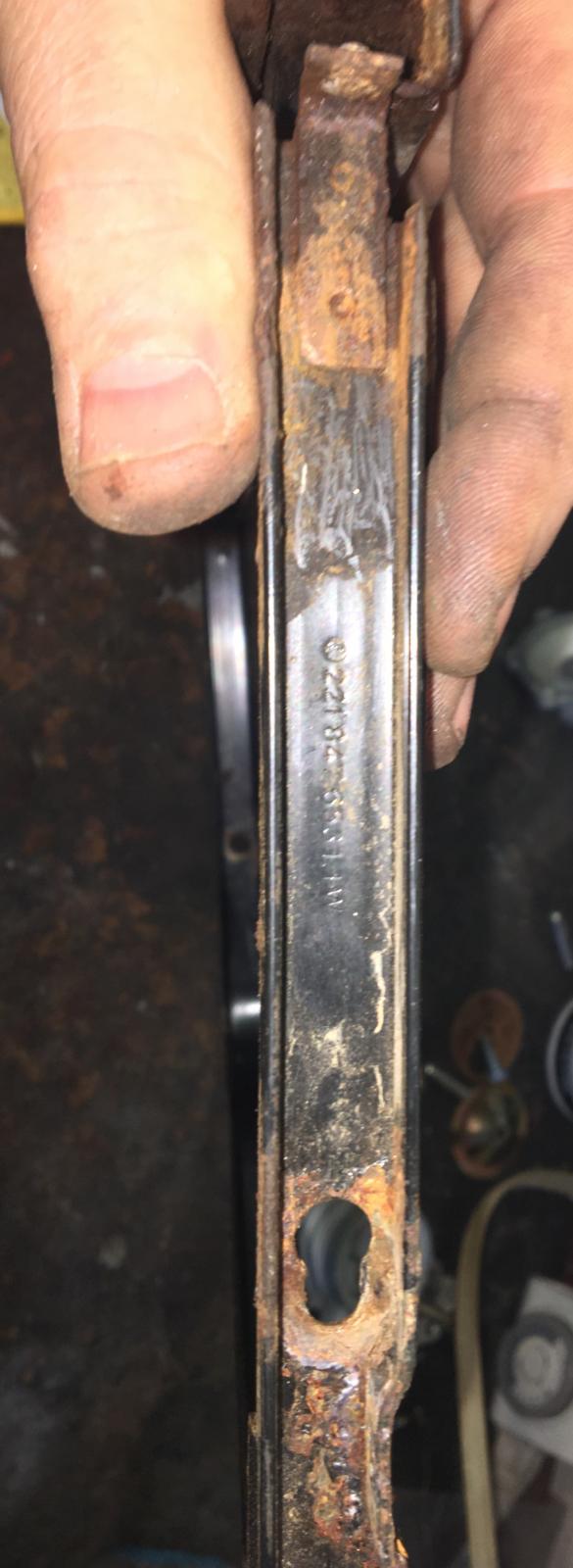

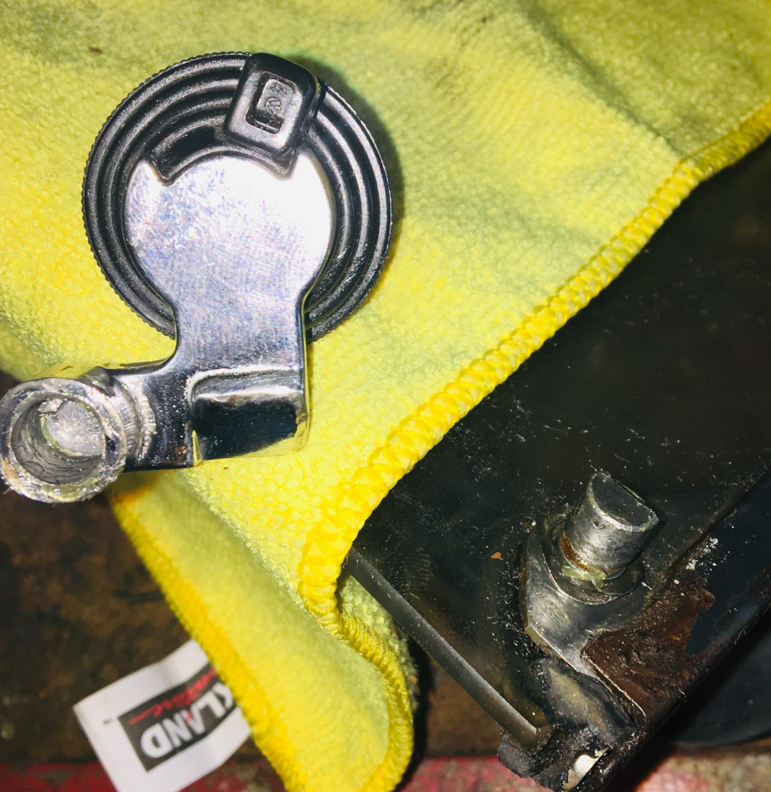

In between some fuel pump and distributor restorations, I blasted the rust off the drivers side rear vent frame. It certainly has some pits from the corrosion but the frame is still rock solid.
I also stripped and re-bright zinc plated the vent wing clamp and screw.
I got 99% of the rust blasted off the frame. I then neutralized the seam were it was tough to get it all out. Then, i primed the blasted areas with Zero Rust which also neutralizes any rust and then seals it tight. I plan to sand the whole frame down with 400 wet and dry sandpaper. Then paint the frame semi-gloss black
The vent wing clamp was starting to have rust break through as the original zinc plating was almost gone.
I stripped the corrosion off with an acid mix, wire wheel followed by a dip in the zinc plating tank followed by an additional blue chromate coating. Should be good for another 30 years.

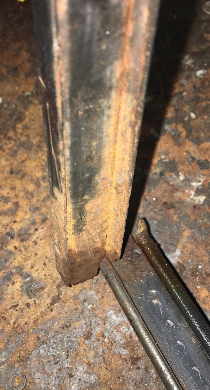

The frame had some nice rust developing on it where they usually rot out. The good news is the frame is very solid. I grinded off a frame mount assembly rivet to open the frame up and remove the glass. I plan on blasting all the rust off the frame in my blast cabinet. Then treat it with a rust converter followed by a few coats of semi gloss paint. I am happy to not have to damage my wallet by purchasing a replacement.
The vent wing rubber is either original or a VW dealer replacement. It's perfect still and soft. I don't think this vent wing has even been out of the bus. I'll remove Mr. Over-sprays paint off it and put it back on when the window frame is repainted.

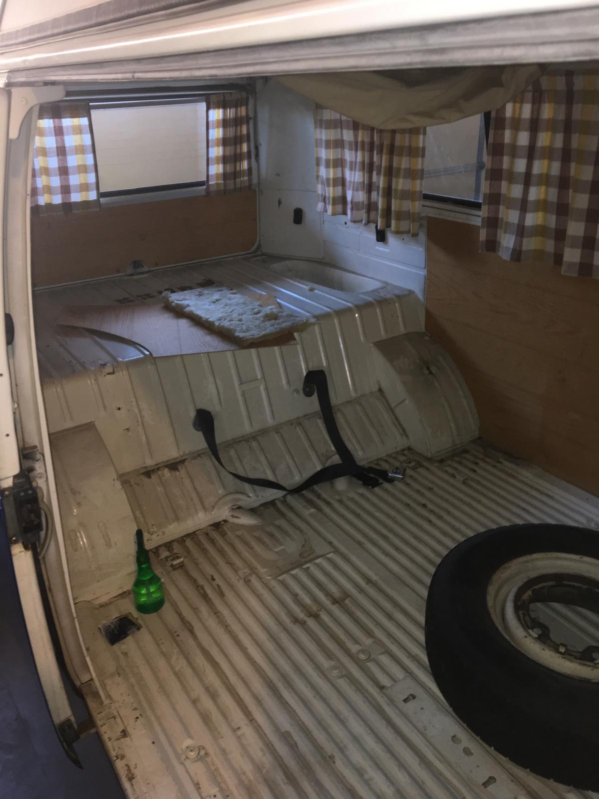

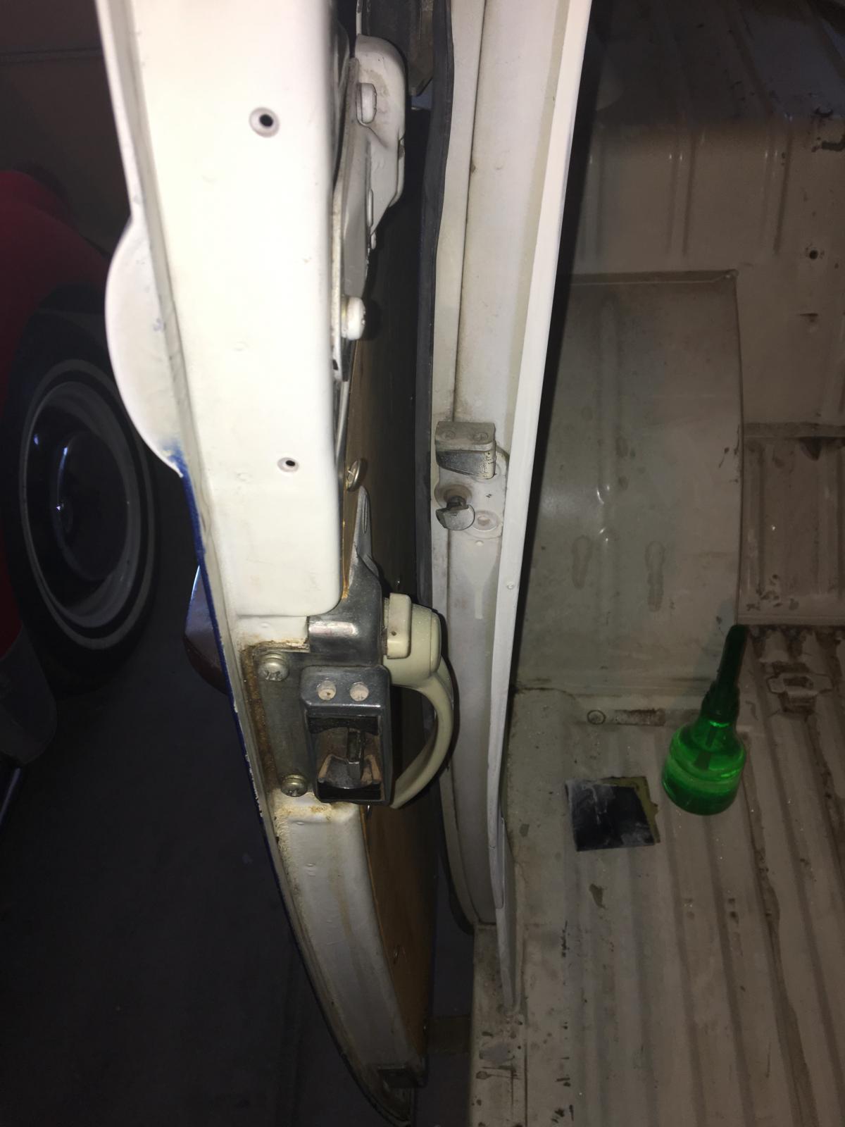

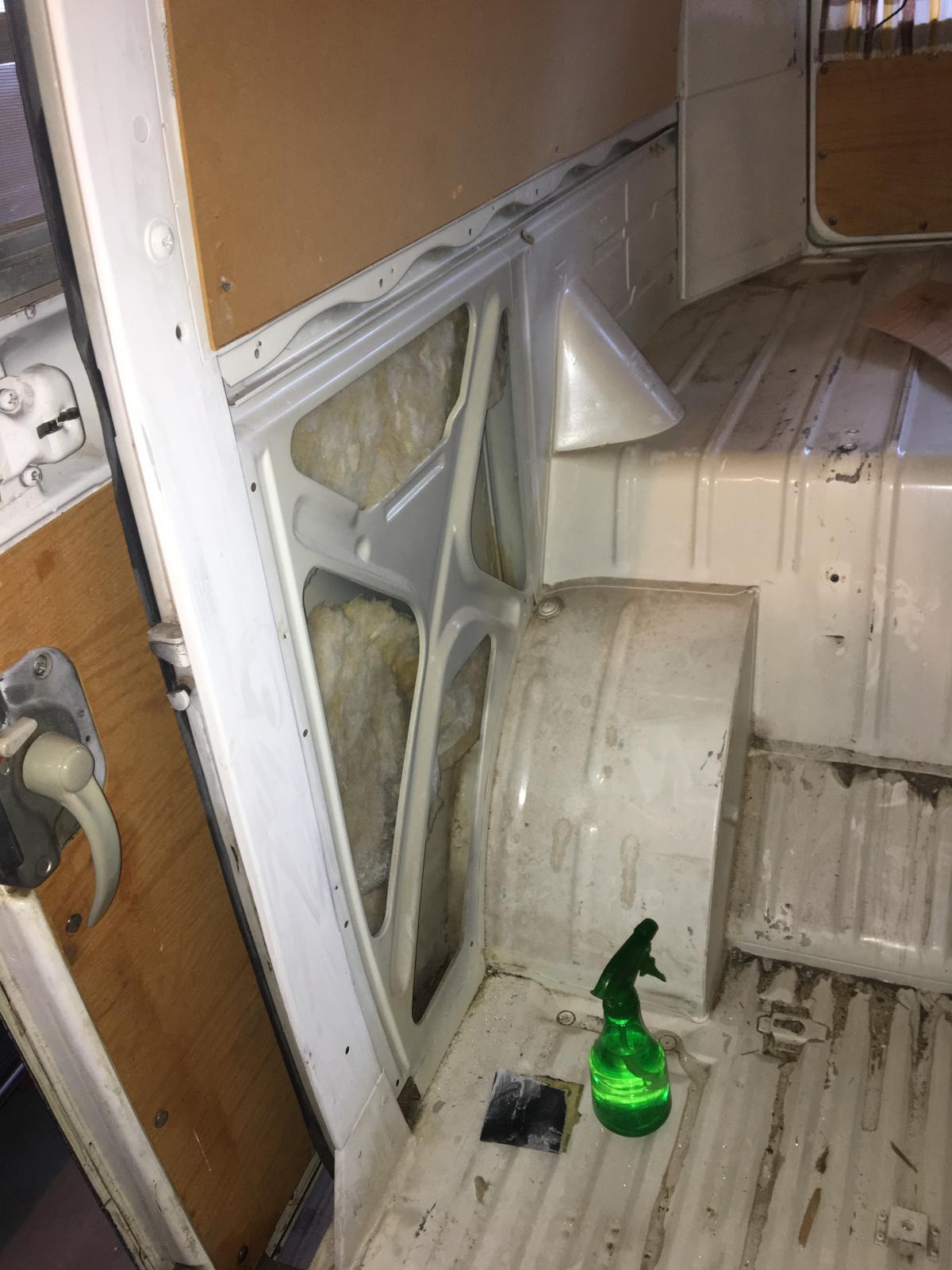

Now the bad part. The cabinets are in great shape. However, my bus was missing the head banger, sink/refrigerator and other misc pieces. The long cabinet was a poorly made copy of the original as was the seat. I pulled them all out of the bus. I'm now staring at a ton of work. Ugh! Crying or Very sad Before I install them, I'm going to need to-
* Remove the rear windows.
* Remove the rear hatch and sliding door.
* Gut the rest of the interior inside.
* Repaint the inside of the rear hatch and slider.
* Remove the paint off the hardware.
* Strip and re zinc plate the door striker plates, screws and hardware.
* Replace all the crappily made wood panels with the correct Baltic birch. Ceiling panels, side panels, rear hatch and sliding door panels need to be replaced.
* Someone in this buses past repainted the interior a bright white. Of course they happily oversprayed anything they could. Pulling parts or taping off these items that shouldn't have been painted didn't seem to be a thought to them. The good news is the paint they used adhered nicely. My plan is to pull the windows and everything else and then wet sand their repaint job, remove the overspray and then spray over it with the correct Pearl white.
* Fix the drivers side rear vent window.
The good news is there's no rust inside this bus. So, that will save a lot of time. I ordered and received the correct reproduction linoleum floor, aluminum entry track and the plastic guard from NLAVW.com who are in Great Britain. I give this company a strong thumbs up! Fantastic communication! Blazing fast shipping that arrived in less than 7 days. Super nice people as well. I will use them again.
Now, I need to find the time to chip away at this project while working full time, having a side business and other "wife" duties. Can't wait... Razz

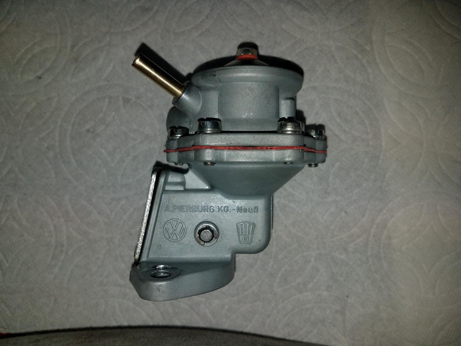

I installed an NOS dome top Pierburg of Mexico pump on the engine a while back. I had planned to reinstall a restored, correct German VW logo'd Pierburg pump. Wolfsburg West has come out with a new Effee diaphragm assembly for the Pierburg pumps thats perfect. It's exactly like the one in the NOS kits I have.
I went through my core pile of rebuildable original Pierburg pumps and found a correct one to restore. I took the time to strip and re zinc plate most of the hard parts during the restoration.
I then wanted to verify that this main Diaphragm spring had the right tension for the correct fuel PSI. I installed the pump with a T'd in fuel pressure gauge. The pump put out right at 3psi.
Of course, the restored pump makes the rest of the engine look like shit now.. Razz
