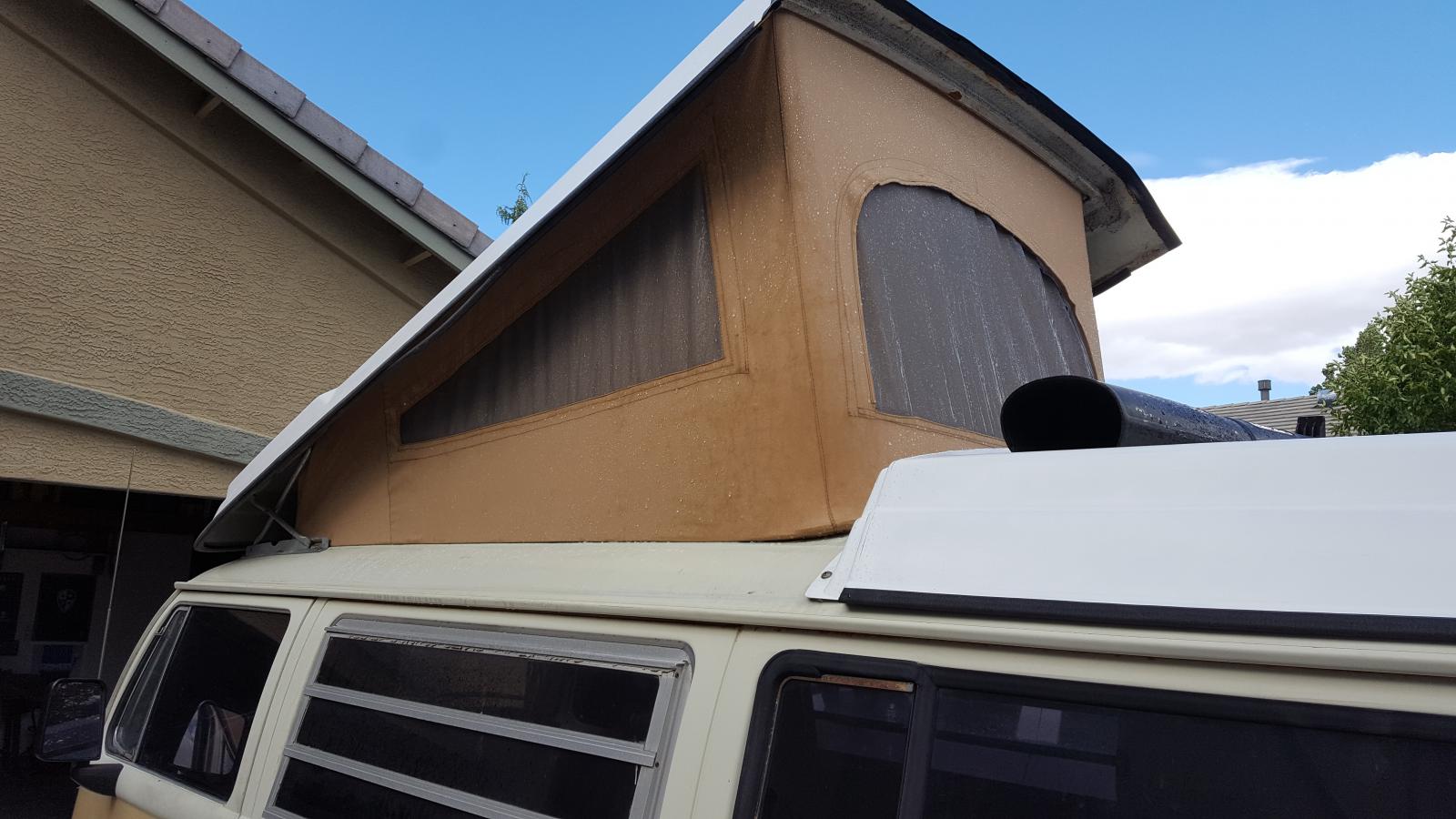

PostPosted: Wed Jul 13, 2016 4:13 pm    Post subject: Re: First Air cooled.. 70 Camper. Reply with quote
Got the top on, its a bit tight but it works. I am pulling my hair out trying to get the h30/31pict tuned up with the 009. I am trying to get my hands on a timing light and even then I wont know how to use it properly. Its the stock crank pully so just the usual timing marks, I have no idea how to set it. It runs but backfires like a MF!

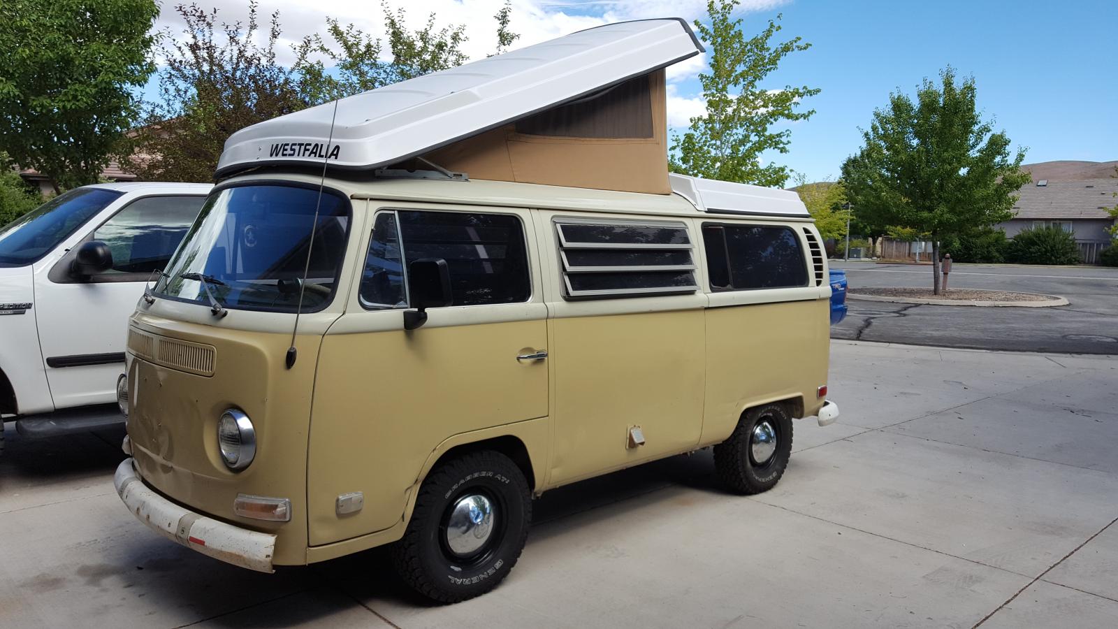

PostPosted: Sat Jun 25, 2016 8:46 pm    Post subject: Re: First Air cooled.. 70 Camper. Reply with quote
Well Guys, I put the bus through its paces today. I drove the Dubs on the Lake Cruise. I made it the whole way. The oil temps got up there on some of the long hill climbs (about 210*) but most of the drive it was around 180*. I need to square away my timing and re tune the carb but I made it and the bus is safely back in the garage. Thanks for all the help you guys provided over the last 2 years Ive owned this Bus. From driving it home with the throw out bearing in pieces in the bell housing to cruising next to Lake Tahoe I am very happy to own it.
Thanks all.. Here are some pics from the last few days including today.
