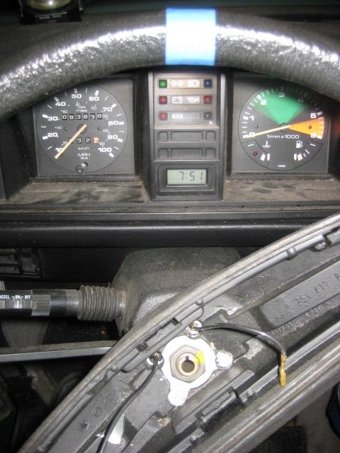

I finished the job last night by aligning the steering wheel that had gone crooked on me when I reinstalled the rack. After marking the wheel’s rim with tape during a test drive I pulled the horn cover easily (caution: this can be a nail-breaking activity) and Sharpie-marked the steering shaft for my alignment. Removed the nut and yanked the wheel, then reinstalled it in the right orientation. Ten minutes. The two wires for the horn can be tenacious on their spade connectors, so be careful removing them.

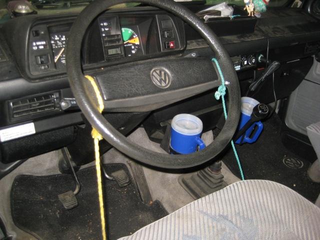

I thought I'd post some pix I took on this job with some thoughts and hints to pass along. First involves keeping the steering wheel aligned. Rather than try to fix it after I wondered if tying it off before beginning would help so that is being tried. I'll let you know if this helped when I'm done.

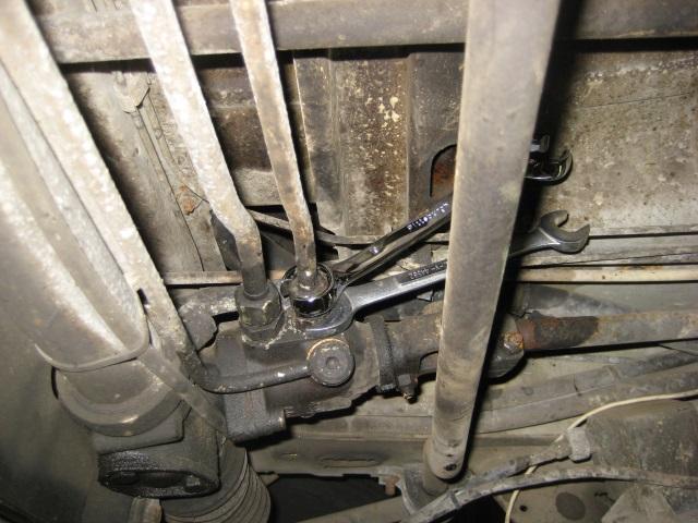

Flare wrenches are handy to remove the power steering lines to the rack. Auto Zone had a set of three that topped out at 18mm, and Advance Auto and NAPA had the same sets, but we need 19mm for one line and 22mm for the other. I don't especially like shopping at Harbor Freight but they had sets in both Metric (up to 22mm) and SAE so I got one of each at 9.99 on sale.
When loosening the tie rod ends at the steering knuckle you must knock them loose without damaging anything. After removing the cotter pin back off on the castle nut until its top is flush or a little proud of the ends of the threads on the end, then hammer away without damaging the threads to loosen. Another of those "just in case I need its," a spot of white paint on the threads to mark where the tie rod ends are now. Can't hurt and might help.
Several threads on the topic say you do not need to remove the spare carrier but I needed the space to work due to stuck hose fittings. Having the space helped a lot since I had to wedge wood blocks above one of the wrenches to immobilize it when double-nutting the fitting.
Once the frontmost (smaller) of the two hoses is loose, go ahead and remove the rest of its fitting to permit better access to the rear (larger) one. Makes life easier.

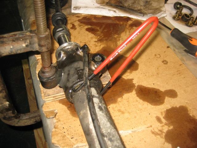

My contribution to the Samba brain trust and tool resources. Many of these rack threads mention the "special tool" you need to find or make in order to unscrew the internally threaded lockrings at each end of the rack. The solution is as close as your nearest bicycle shop and its Park Tool display. I used the red SPA-2 but the older blue or yellow ones (which now appear to be out of production) might be better fits. You probably still need to use a hammer and drift punch with a small tip to do the preliminary loosening on these rings, but this tool speeds up the rest of the removal.
http://www.parktool.com/category/bottom-bracket?page=1
The black plastic tube in the same photo is the one I'm having trouble removing but rereading several threads indicates this is just a vent line so I plan to cut it away from its end fittings and replace it with a new run. Good luck when you try this job. It's not as messy and painful as exhaust work, but not by much.
