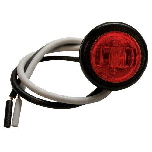

Are you driving it around as it is in that picture? No wipers, mirrors, turn lights, no front plate... Na, your not driving it like that?
As far as running without lights in California, do as you will... Might want to keep in mind if your involved in an accident your fault or not, without those lights on your vehicle someones insurance company is going to own you! And to be honest what Mr. Savage and his inspection crew @ SCORE thinks isn't going to mean squat? I'm heavy into the 4x4 scene here in San Diego, lighting, tire width stick out, and vehicle height are the things Mr. POPO is looking for in a quick glance. Personally Id rather have something in place not working and get stopped than not having anything there at all? They dont just write fix-it tickets any longer. Now its about the $$$$$$ and the fix is going to be really cheap compared to those violations.
We have found for turn indicators and marker lights these little 3/4" led's are super bright and DOT approved. Drill a 3/4" hole and poke it in for a very clean application. Comes in clear, amber, and red. Just a thought for a clean, easy, and best of all inexpensive fix.
3/4" Super Bright LED 3/4" Clearance Marker
RED LIGHTS
Lights and mounting grommets. Each light mounts in standard 3/4" cut out. Super bright LEDs provide superior light output.
Low LED Amp Draw
100,000 Hour Rated LED Life
Space Saving Design
Meets P2 Requirements
Completely Potted/Sealed Electronics
Hi Impact POLYCARBONATE Lens And Housing
6" Leads
Operating Voltage 12.8 VDC
Amp Draw - 50 MA Shocked Shocked
