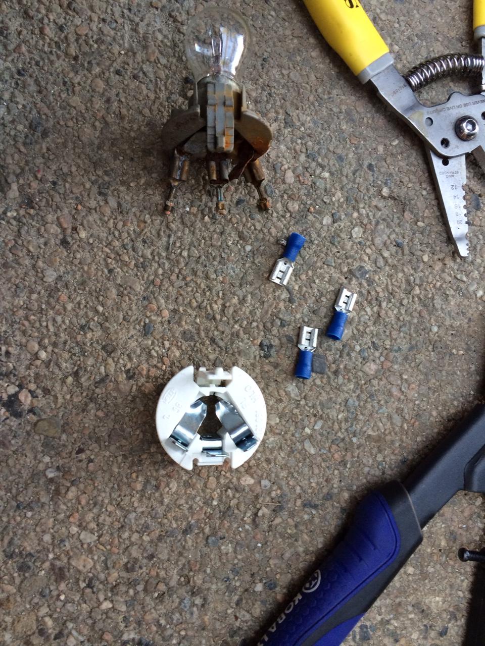

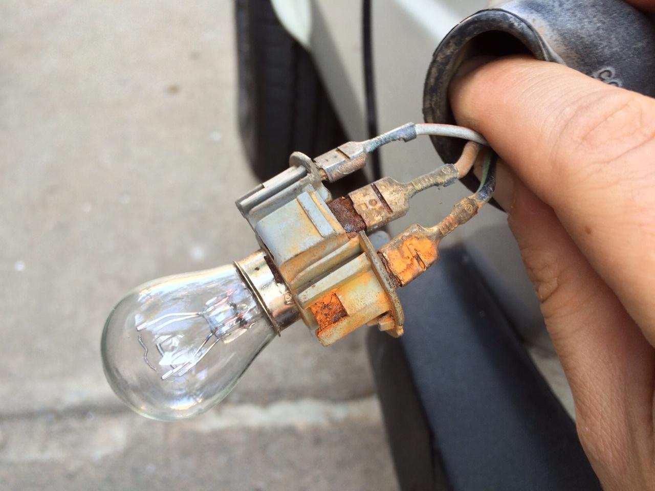

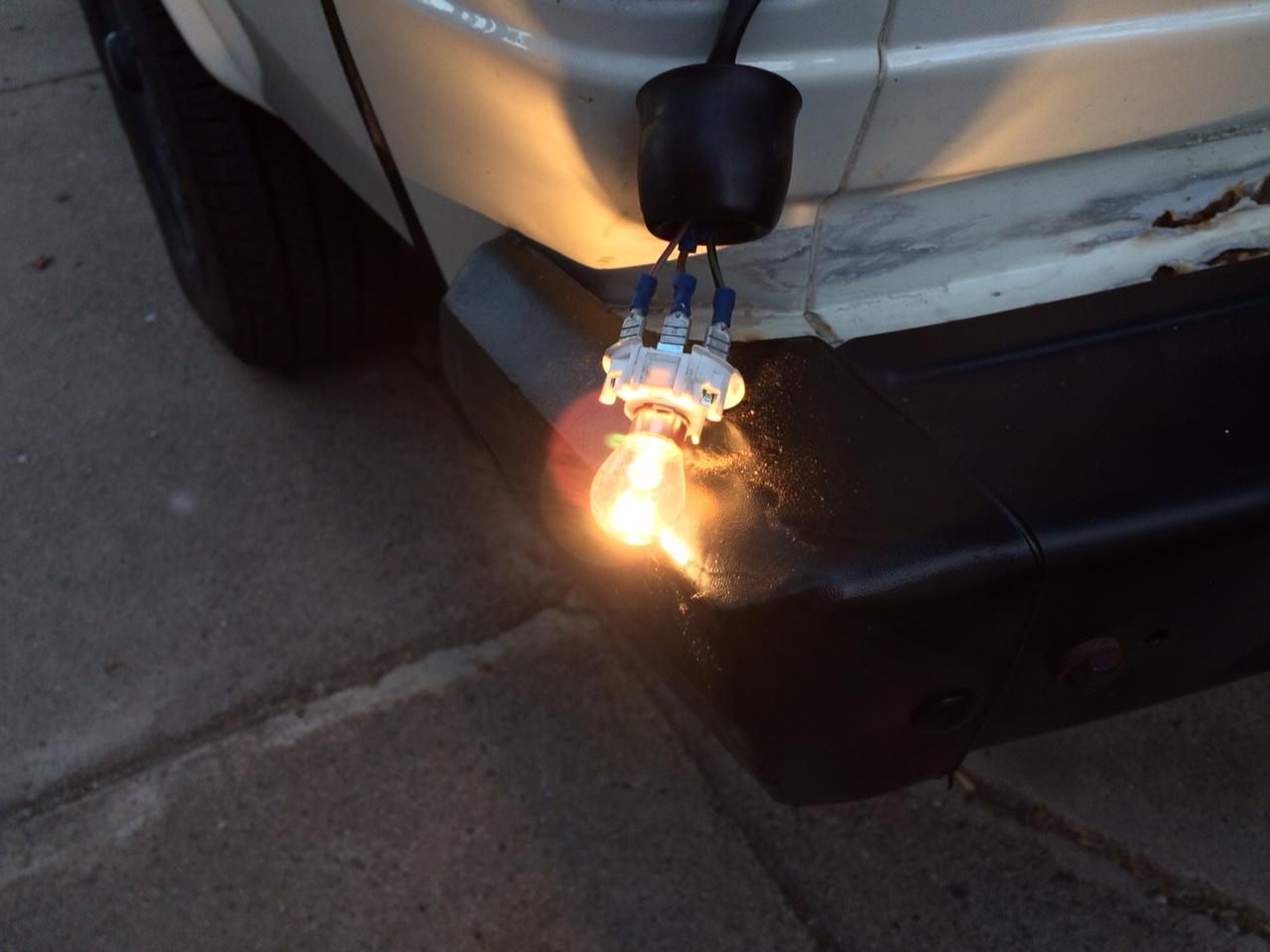

Car got a new feature about 6 weeks ago - a buzzy right turn blinker.
I started by checking / replacing fuses, and eventually decided to investigate.
Okay, time to rewire.
Not pictured: 2 more days to figure out how to re-wire the new (two filament) front turn blinker bulb correctly.
Problem still isn't 100% solved. I believe I have a bridge, or a bad connection on my actual blinker switch. when partially engaged, it's okay, when 100% engaged, it doesn't function at all, or I have to cycle through my brights for the right blinker to blink right.
I stopped when I realized I have no idea how to remove the steering wheel yet.
Grounds are okay. Fuses + relays are okay. I switched relay out with the other van, and it worked fine in other van, and problem persisted in this one.
Oh well.
