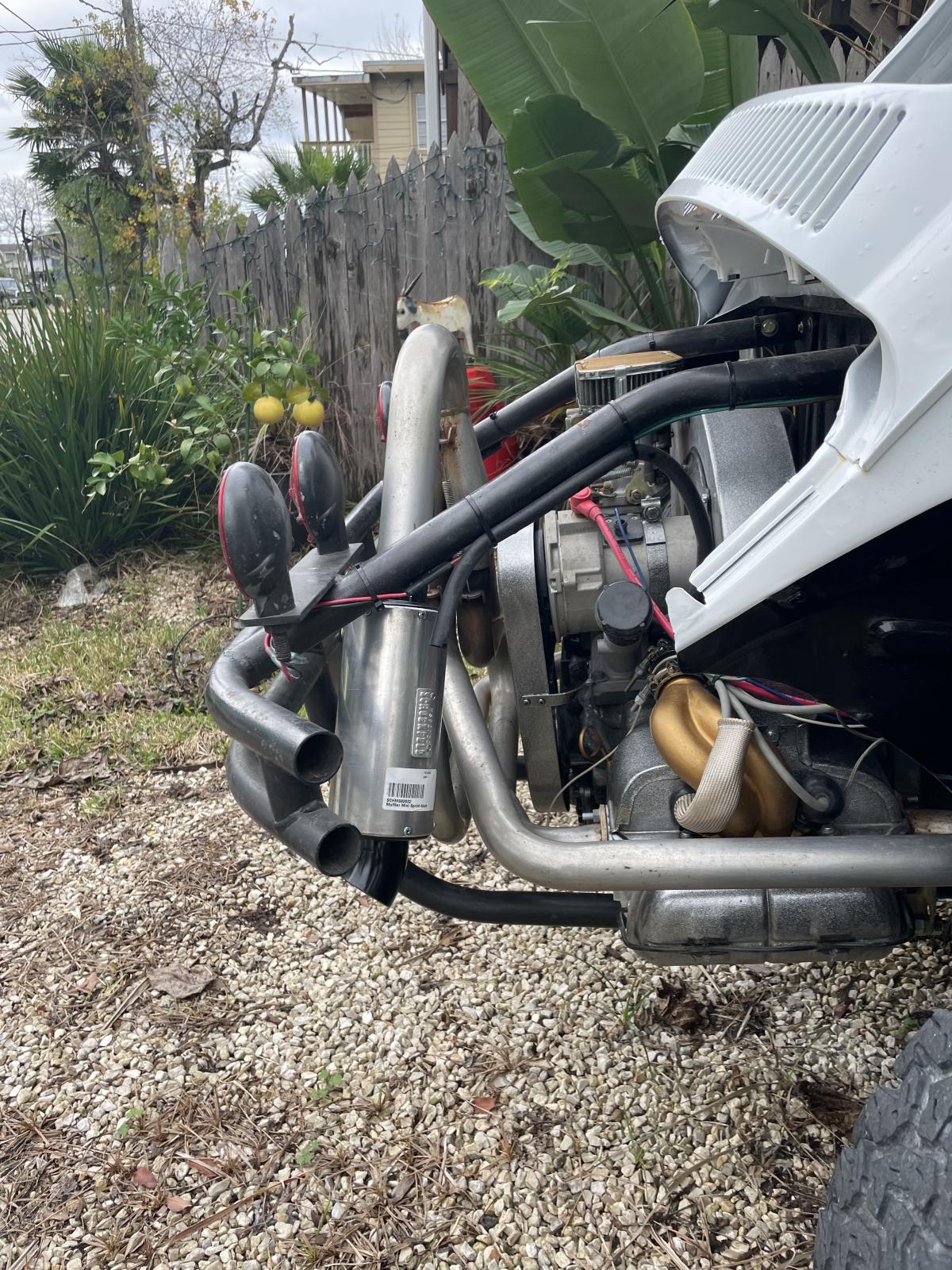

PostPosted: Thu Dec 22, 2022 2:00 pm    Post subject: Re: 1969 Baja Bug - TX Build Reply with quote
I'm planning on tackling the muffler problem on mine this weekend, the straght pipe was cool for the first 100 miles but it's getting old now... I've got a Tri-Mil Quiet Pak collector that fit just fine until I tried to put the bumper back on.

PostPosted: Thu Dec 22, 2022 6:46 am    Post subject: Re: 1969 Baja Bug - TX Build Reply with quote
Well I reluctantly have put a muffler on, it’s still loud but it took the bark out so it doesn’t draw quite so much attention. The muffler is a circle track midget racer part “schoenfeld” is the brand. It’s straight through, kinda like a glass pack but it is rebuildable if the packing burns out.

Had a valve cover leak, and one oil pump stud is weeping, otherwise no leaks! The jetting is bad, way way way rich and I’m not certain but it seems like my timing/spark is a bit erratic. Need to check out the distributor, condenser, and maybe fouled plug from being so rich. Coil got pretty hot so I need to Chase that down also
Lights!
