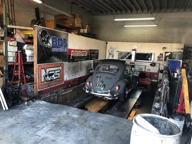

The day finally came! I drove my bug for the first time since I got it nearly 4 years ago!
While the car was at Koch's, they re-indexed the rear and got it at a good height, installed the new master cylinder and put in a windshield. They also adjusted the carbs. I am still a little rich, so I may need to jet down one size.
While I was waiting (about 3 weeks), I finished my deck lid. When I arrived to pick it up, they helped me install it, as the plan was just to drive the car home.
This was my first drive in the car and for the most part, it drove well. The alignment was way off and I was very cognizant of every noise and smell. It was a stressful drive, but it made it with out a hitch.

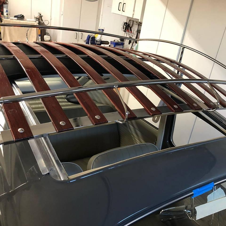

arizonabuckeye wrote:
Looks incredible! Any shots of it with the ragtop open and the roof rack on?
Just this one, but I can take more when the car is done.

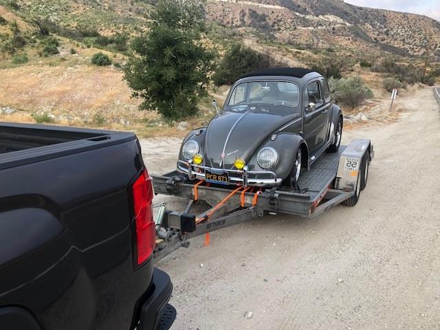

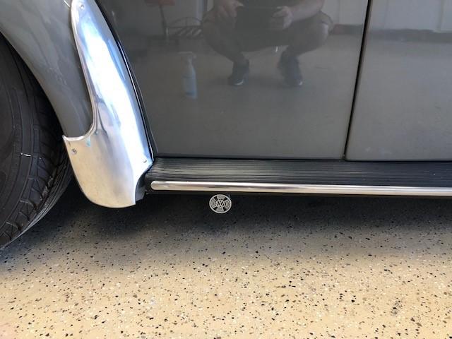

PostPosted: Tue May 01, 2018 11:25 am    Post subject: Re: Corney13's '63 Beetle Reply with quote

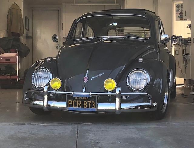

The bug finally left the garage / driveway for the first time since I brought it home in June 2014. Off to Koch VW in Acton for some buttoning up and to fix some of my rookie mistakes. I had to lift the rear back up to the stock height in order to get it on the trailer. I was going to take the time to index it properly by adjusting the inner and outer splines, but I am just going to let Koch do it. I always thought 1 outer spline equaled about 2.5 inches, but for me it is either ass high or 3 inches off the sump drain bolt. Not drive-able in my opinion. I will also have them raise the front. I am near full adjustment on the beam, so if they cant get it high enough, I may have to swap out my unused drop spindles for stock height spindles and just adjust off the beam. Goal is to have the tires basically in line with the fender line. Other than that, they will replace the windshield, add a dual circuit master cylinder and fine tune the carbs.
Here are a few photos before it left. Additionally, I finally got around to repainting the decklid after it fell.
