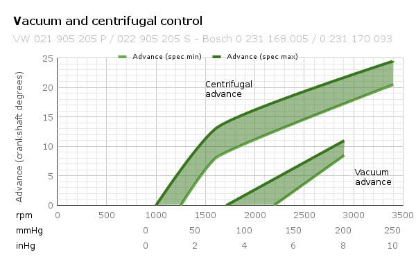

One of the reasons I was looking for this post today was because I found a piece of information that relates to my distributor, for which there don't seem to be any curves available (although the data itself is on Bentley).
There is a M107 technical note on the late Michael Knappmann's site that, once translated from German, reads:
5 - Ignition system
a - Distributor
4/1800 022 905 205 S
4/1800 021 905 205 P
The advance values for both distributors correspond to distributor 021 905 205 G (see Repair Manual section M 3.2/1-3 and M 3.3/5-20).
A while ago I plotted the distributor curve for 022 905 205 S / 021 905 205 P (which are essentially the same part, the only difference being that ..205 P has a RPM-limiting rotor):
Comparing it to the curve of the 021 905 205 G distributor, and bearing in mind that on the diagram below the RPM and advance values need to be multiplied by 2 (they refer to distributor rpm and degrees, vs. crankshaft rpm and degrees on the above):
The curves look similar enough. Comparing the actual data from Bentley and the Repair manual, there seem to be just slight differences of 0.5 advance degrees.

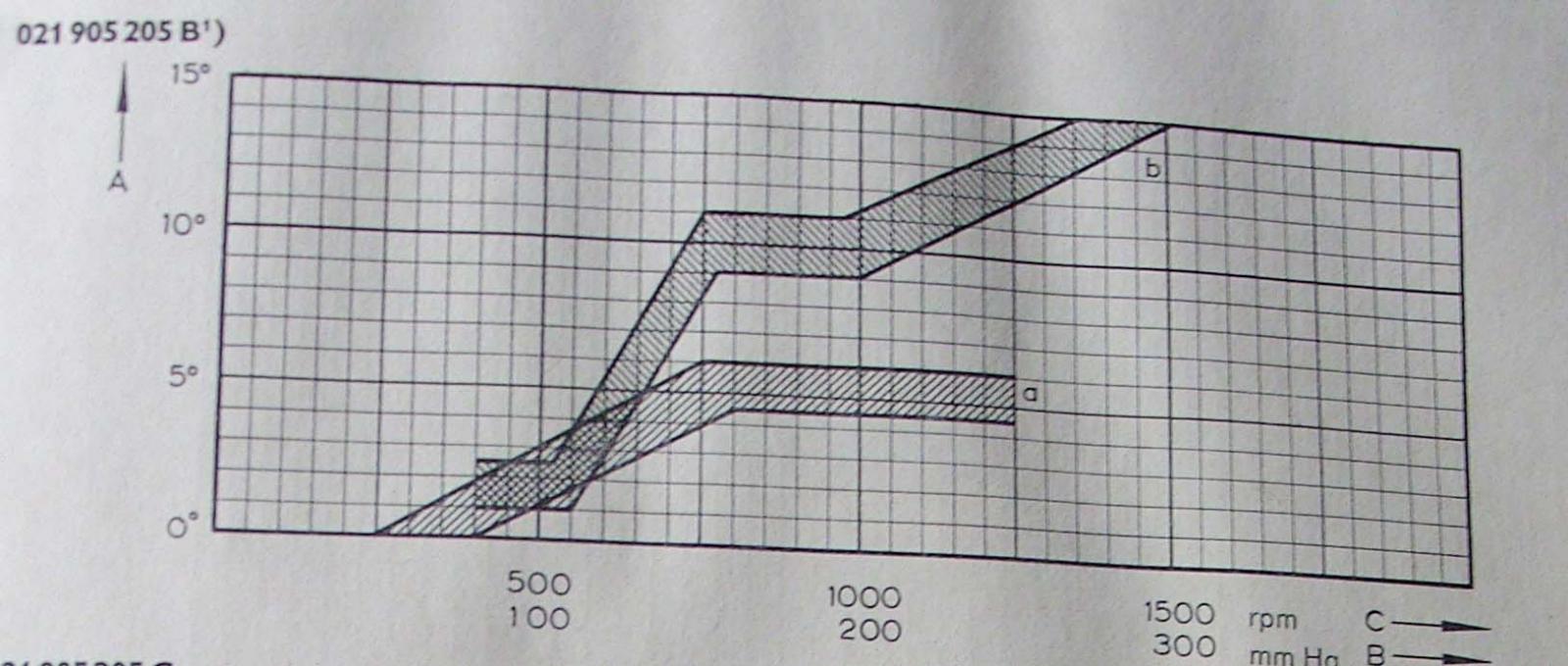

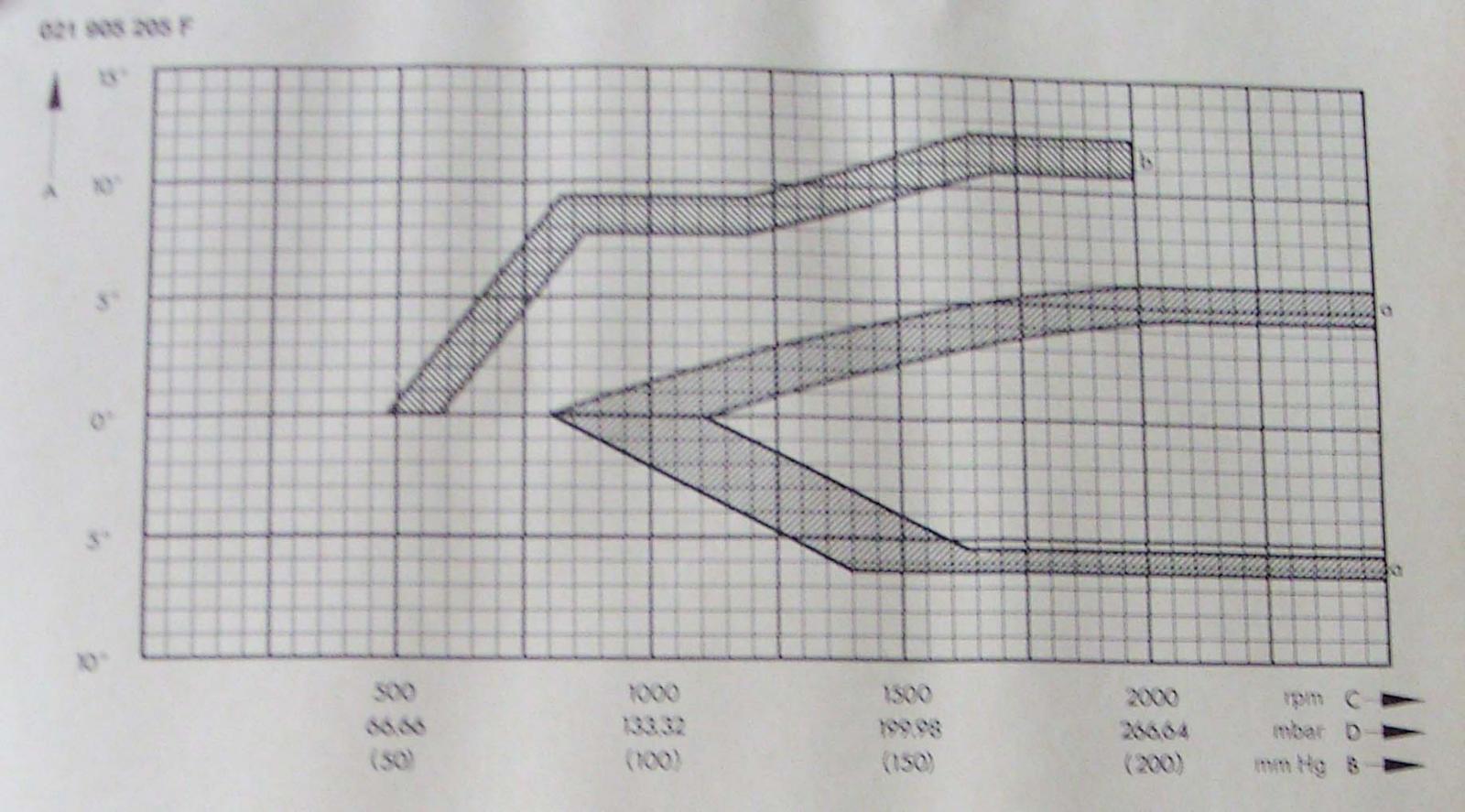

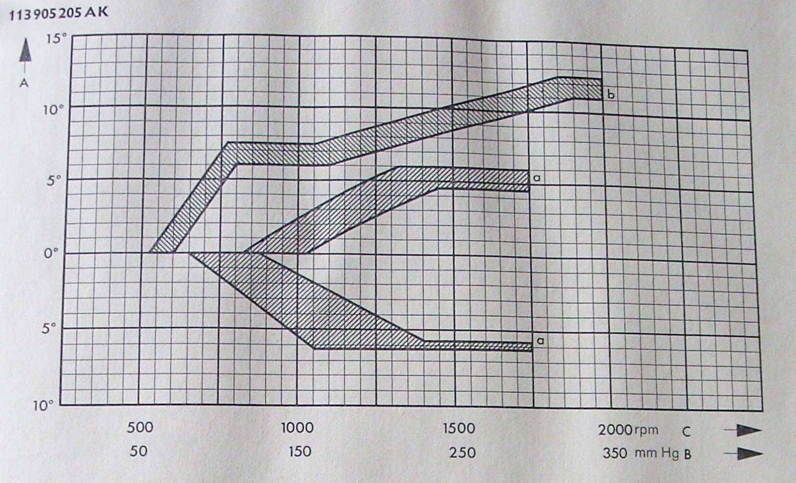

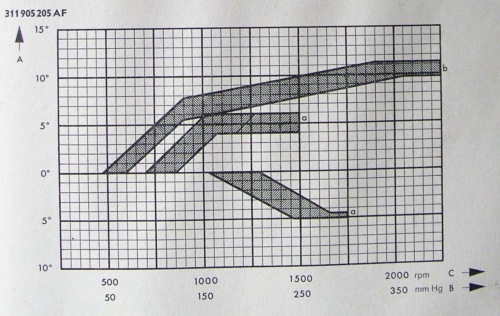

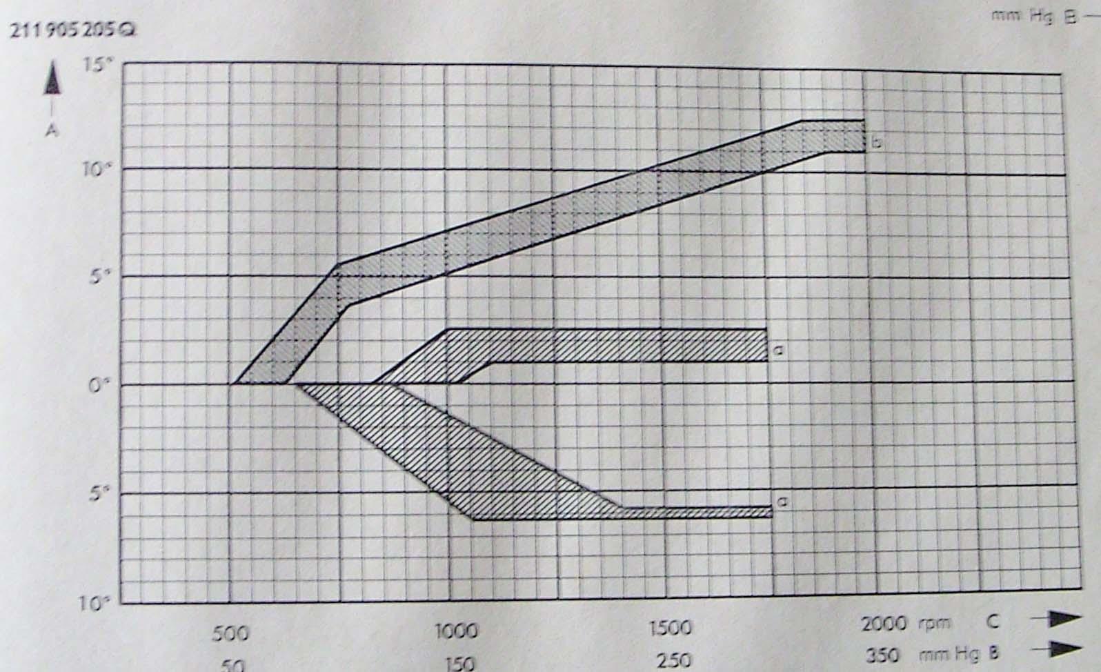

These graphs show the acceptable advance curves for VW distributors. So if you have one of the distributors listed on any one of these graphs then all you have to do is check your advance curve(s) and see if your distributor is still within spec.
Some graphs only have one curve on them, measured against vacuum (mm HG) with no RPM listed. These are vacuum only distributors like the ones used on 1970 and older manual transmission VWs. There are some with two advance curves, one marked "a" (vacuum curve) and the other marked "b" (centrifugal curve). These are SVDA style distributors. The ones with three curves (one of them bends down) are DVDA style distributors.
Note that the degrees are distributor drive degrees. To get crankshaft degrees you will need to multiply the number of degrees by two.
Generally, this is just to make sure your distributor is within spec, not for chosing a distributor. Normally you would chose the distributor based off the number on the carb. But I suppose you could put it on a dyno and find a distributor with a curve that matches your engine even better.

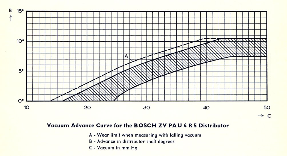

PostPosted: Sun Feb 15, 2015 11:35 am    Post subject: Advance curve for Bosch ZV PAU 4R5 distributor Reply with quote

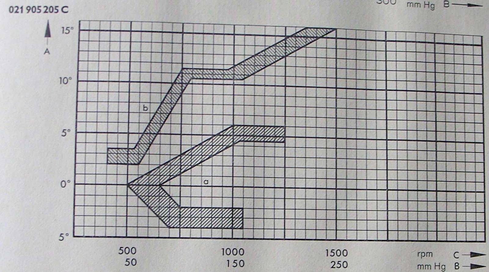

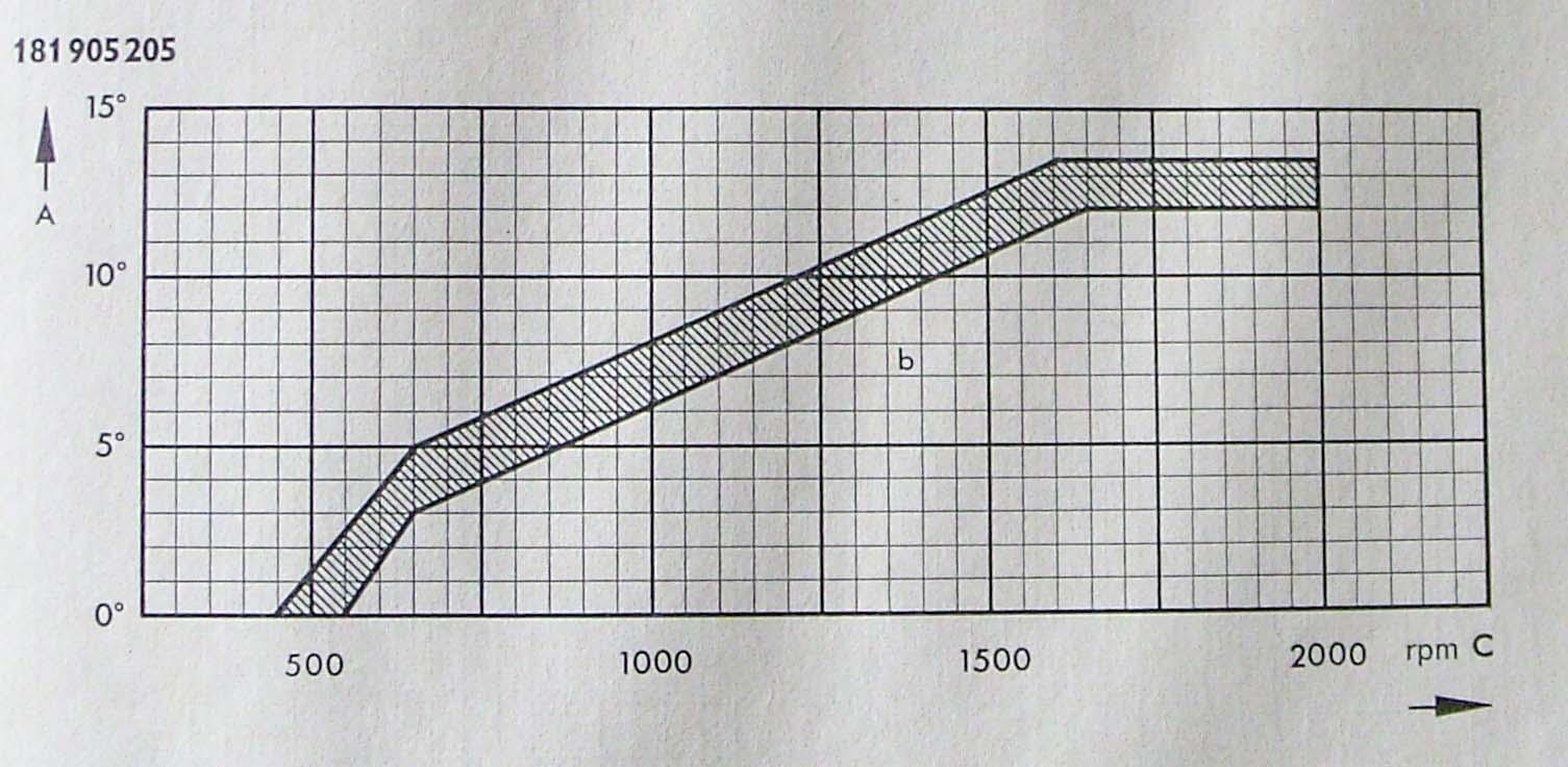

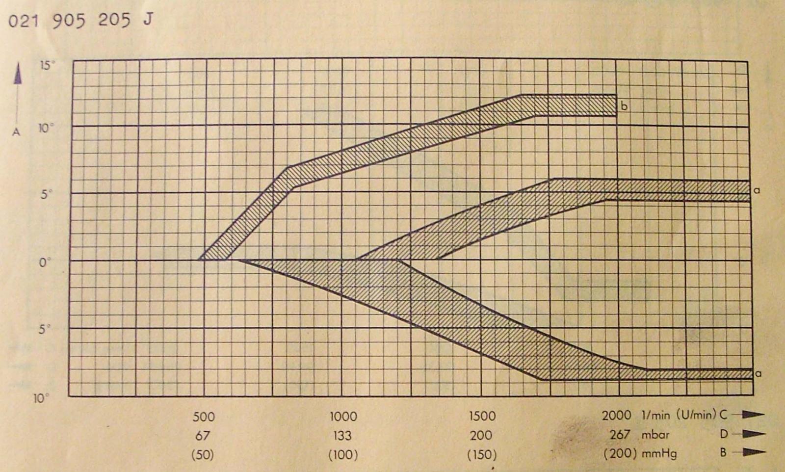

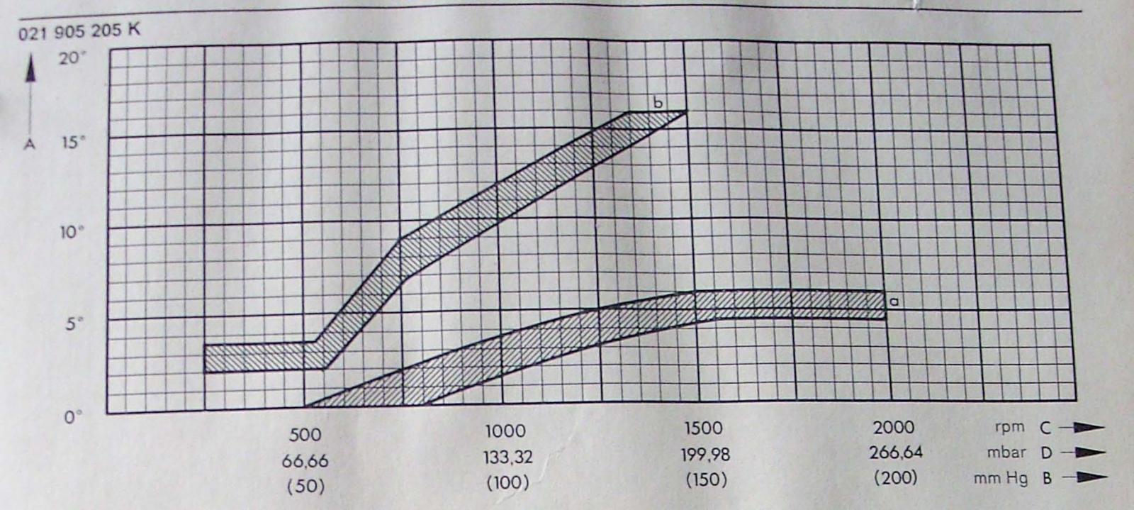

Posts: 71554
PostPosted: Tue Jan 20, 2015 4:56 pm    Post subject: Stock Distributor Advance Curve Diagrams Reply with quote
With thanks to mikedjames for posting these in the Gallery
[Edit: dupes removed]
