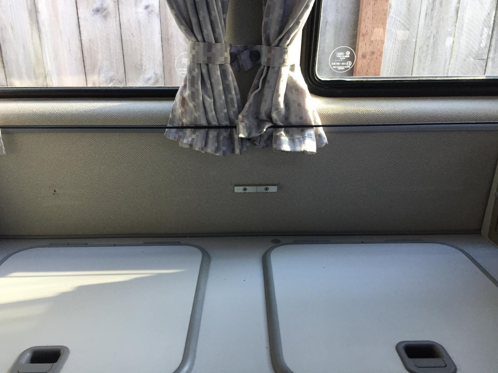

I think I’ve landed on a solution that works for me.
My criteria:
- I don’t want to rely on twisting the knob with all my strength to keep the table from swinging out during travel. I also don’t want loosening the knob to be inordinately difficult for others who may be attempting to free the table from the Westy clamp death-grip. (The friction tape sounds like a good idea but it also sounds like a gooey mess after some time).
- The table needs to be secure, I really dislike the sound of the table slamming into the wall after the Westy tensioning contraption has failed to hold the table.
- I want it to be relatively easy to swing the table in and out, i.e. the Westy tensioning knob shouldn’t be so tight that the table is difficult to swing out.
I’ve tried magnets and was just about ready to try a positive spring pin in index hole similar to the centerpunch dimple ideas suggested in this thread.
As a last ditch effort I bought a sturdy magnet, screwed it to the c-pillar and I think I’m happy (so far). I tried magnets before but placed them where screws only went through the trim panel which isn’t sturdy enormous go for this application. Screwing into the c-pillar was a big step forward.
Magnet...
https://www.amazon.com/gp/product/B013L36SXA/ref=oh_aui_search_asin_title?ie=UTF8&psc=1
Screwed to the c-pillar is key...

PostPosted: Sat Apr 13, 2019 10:33 pm    Post subject: Re: Trick for securing Vanagon Westy rear table? Reply with quote
My criteria:
Magnet...
- Jim
