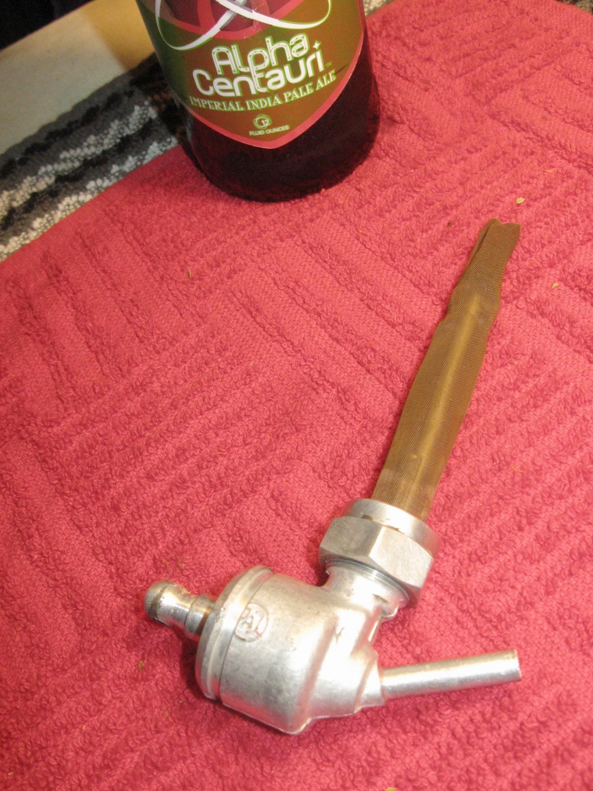

"Alan" Thanks for the reply, I think the problem is more the tube size at least in my case, mine may be restricted due to the silver soldering I did. I should just replace the whole pet cock. When I rebuilt it it didn't want to stay together very well it would pop apart sometimes, I finally used screwdriver grip in the retaining ring, also it doesn't stop turning if forced either past the 12:00 or the 3:00 O Clock positions. I worry it may pop apart again with a full tank of gas! What a disaster. I wish I had never messed with it. Originally it was blocking the fuel almost totally but I had blown my air hose up the fuel line from the engine and it cleared it. But I rebuilt it anyHow. Just hope it's together right.
Yes I know I built this engine for the 1971 Bus but now it running in the 1960 Beetle, Maybe I should request it get moved to the Performance forum. It does really run sweet. It's Quite. It Pulls nice and strong. But does seem to only be able to use first 1/2 of it's throttle. That seems to be better now on the Highway though, Pulls strong past 55 mph in 3rd but really it's got good torque so shifting at 45 mph to 4th the engine takes over from there quite well.
The Zenith's make a lot of noise inside the car when I open them up. Sounds a bit out of Carb balance but it's not? Maybe it is? Temps are pretty even.
I might just do away with the Pet Cock and carry a gallon of gas in the car. Wonder if later vw tank fittings would work to eliminate it?
The Zenith's when it hits reserve seem to stumble a lot but don't completely conk out for a few blocks.

I'm guessing this petcock is not on a bay window, tho the thread seems to be in bay window forum.
Great job choosing the Zenith carbs. Good German stuff, but a bit of a learning curve.
Also, good for you knowing and mentioning the screen filter inside the fuel pump.
I'm currently working on a petcock bus, a 1956 single cab.
I often thought it might be better to leave the sock out, then put the filter UNDER the tank At least that would get the problem sediment into an easily removable place.
And here's my biggest point: If you SOLDERED on the petcock, you may have damaged the rubber which might be now partly plugging the passage. Time to put a new rubber part inside the petcock.

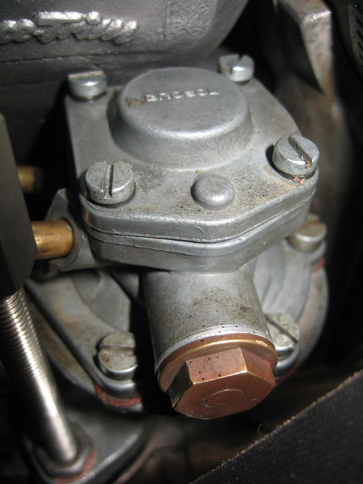

Thanks Alan for catching my misunderstanding, You guys might be on to something as last year when I rebuilt the Pet Cock I did accidentally break off an inlet tube and I soldered it back on.
Looks like the short tube was left alone, I should try measuring that fuel pressure drop again with it on reserve.
This video is one I took before making this post so it would have been with the pet cock in the up position "Long Tube"
(Note! I Later discovered My fuel pressure gauge is out of calibration and reading 1 lb low so it was actually about 2 1/2 lbs with what looks like from this old video a 1/2 lb drop in pressure revved.)

"Stock"? The screen in the pump? Yeah, it's all been gone through but it could need cleaning again. I did put a metal inline fuel filter on it weeks before and the gas tank filter got cleaned last year along with all new gas lines. It does deliver gas pretty slow though to where the rubber fuel line connects to the metal line where it comes out near the engine under the car. I know because I drained the tank when I swapped engines. It was just a slow flow taking maybe 5 minutes to drain the last gallon. If this is a problem then I probably need to eliminate the pet-cock, Are Pet Cocks too restrictive for Dual Carbs? The other thing is it's still running too rich too as I have yet to re-Jet as I had planned.

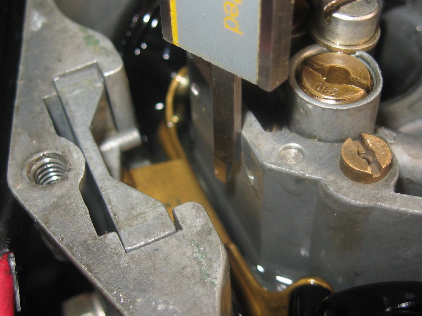

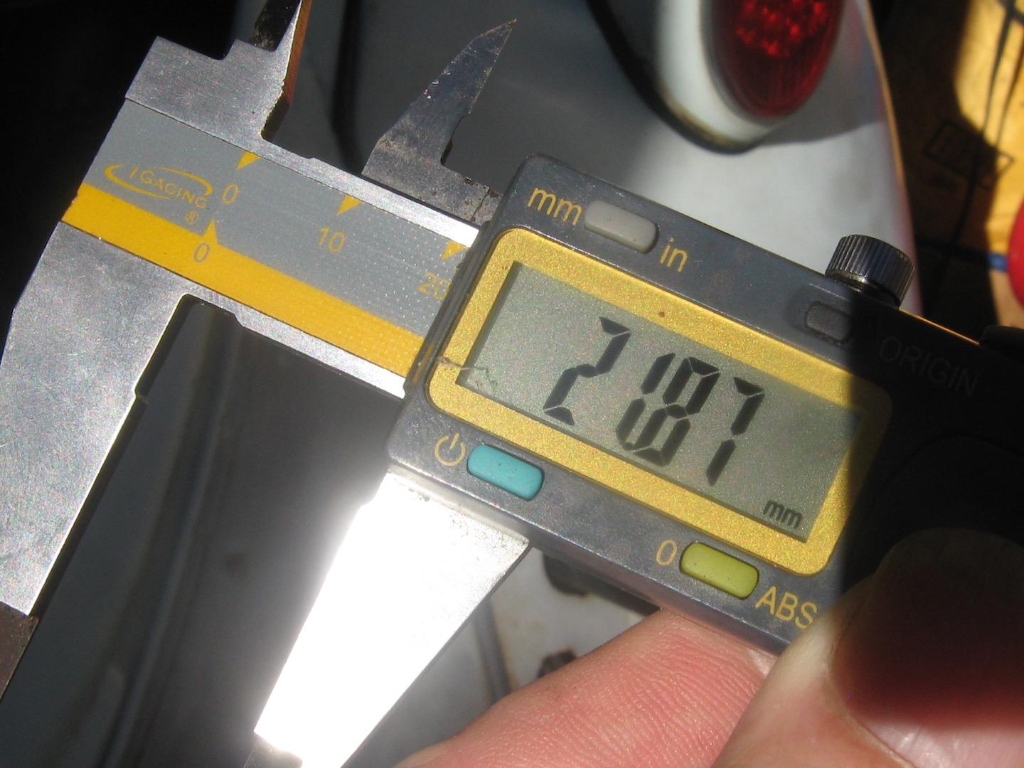

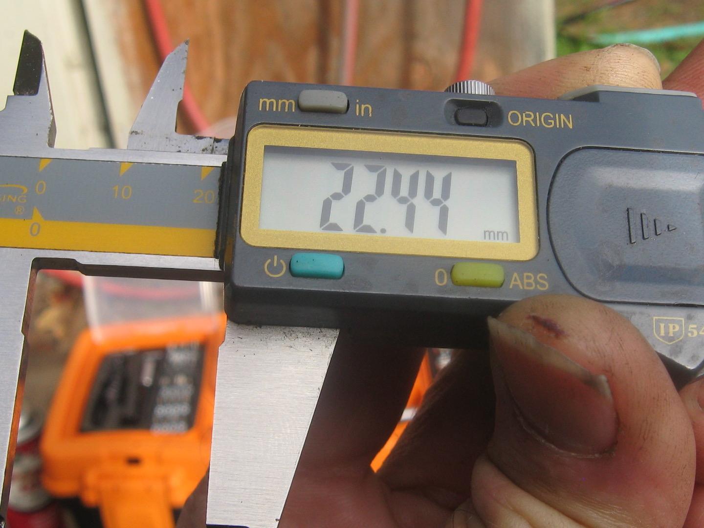

Leveled the car better and took fuel level readings near the front to back center of the carbs. After the readings below were taken installed (1.3mm Washers Rt Carb) (2.2mm Washers Lf Carb) No readings on the new settings yet, But in the test drive the car ran strong without the hesitation I was getting with the previous settings. I can still see drops of gas coming out of the mains, not too bad though, drops of gas seem to break up better. Probably will remove the carbs and give them a full cleaning next.
21.87mm reading on the Rt. Carb with the 1.5mm Washer:
Rt Carb Measurement Location:
22.44mm reading on the Lf Carb with 2.8mm of Washers:
Lf Carb Measurement Location:

Just finished the "Test Drive" Mixed results. Seems to run plenty strong however it may have a problem with #2. I leveled the car and revved it, #2 is popped a little but #2 is not dribbling like the others. Also getting an acceleration delay now when I give it throttle. I think there's been something wrong with #2 all along and the reduced float level just shows up the problem.
When the new idle jets arrive 0.45's currently 0.50's I will pull the carbs off the car for the installation and do some cleaning. Also I can install 2.30 Main air corrections jets currently they're 2.10's and see if that helps the dribble.
