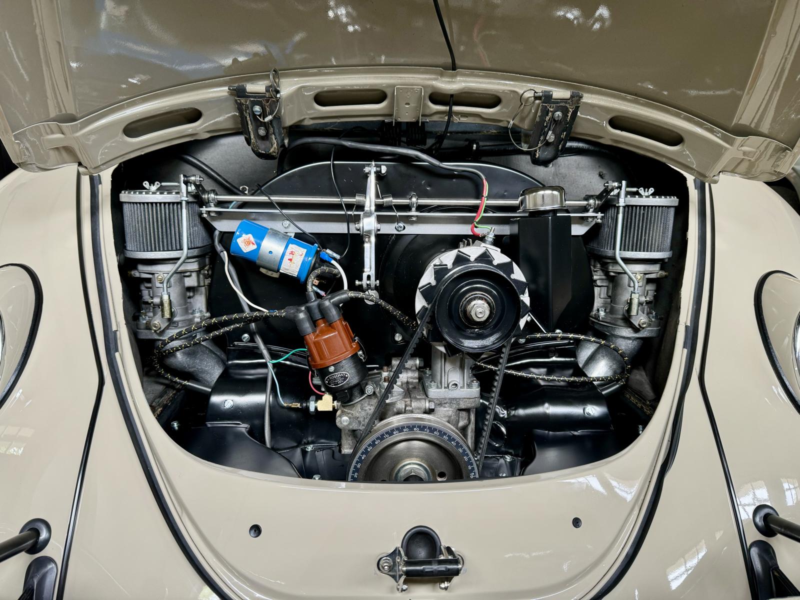

PostPosted: Sat May 25, 2024 3:47 pm    Post subject: Re: COOLED brand Engine fanshrouds and engine tin. Reply with quote
And here it is in the car.

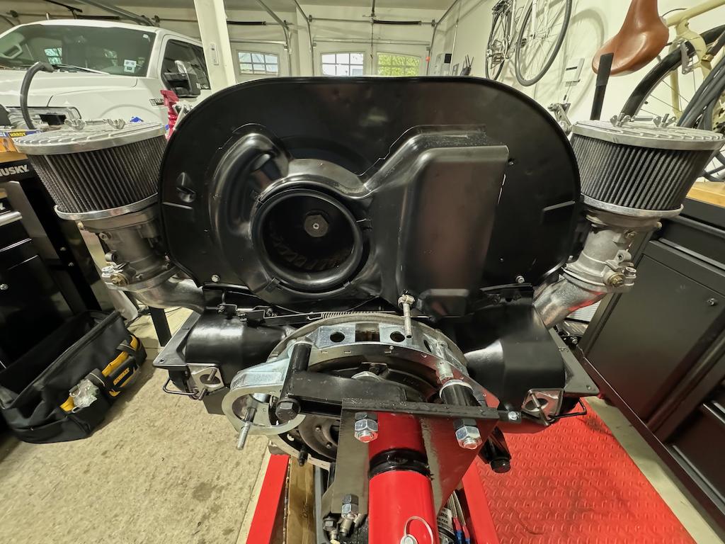

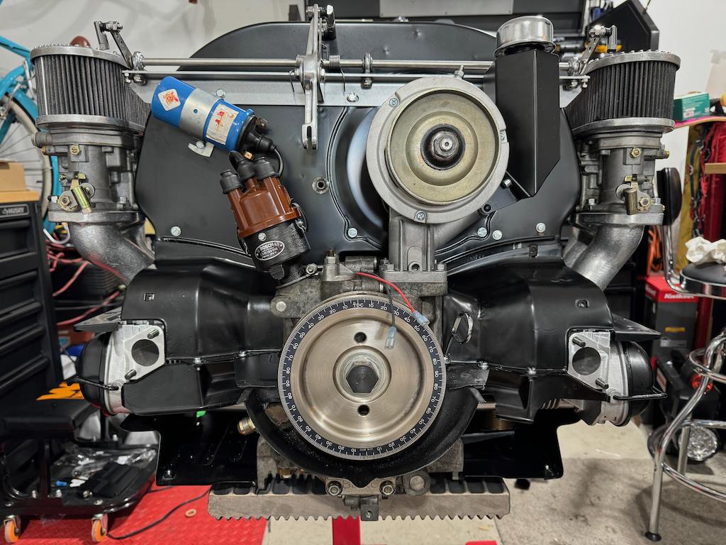

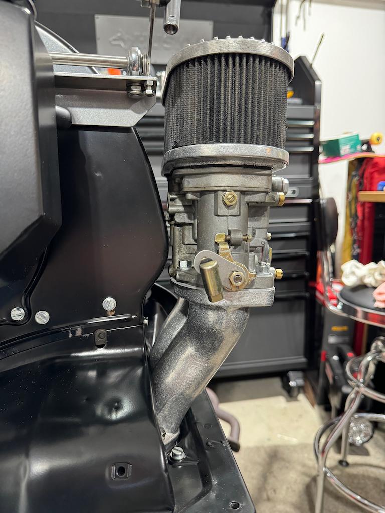

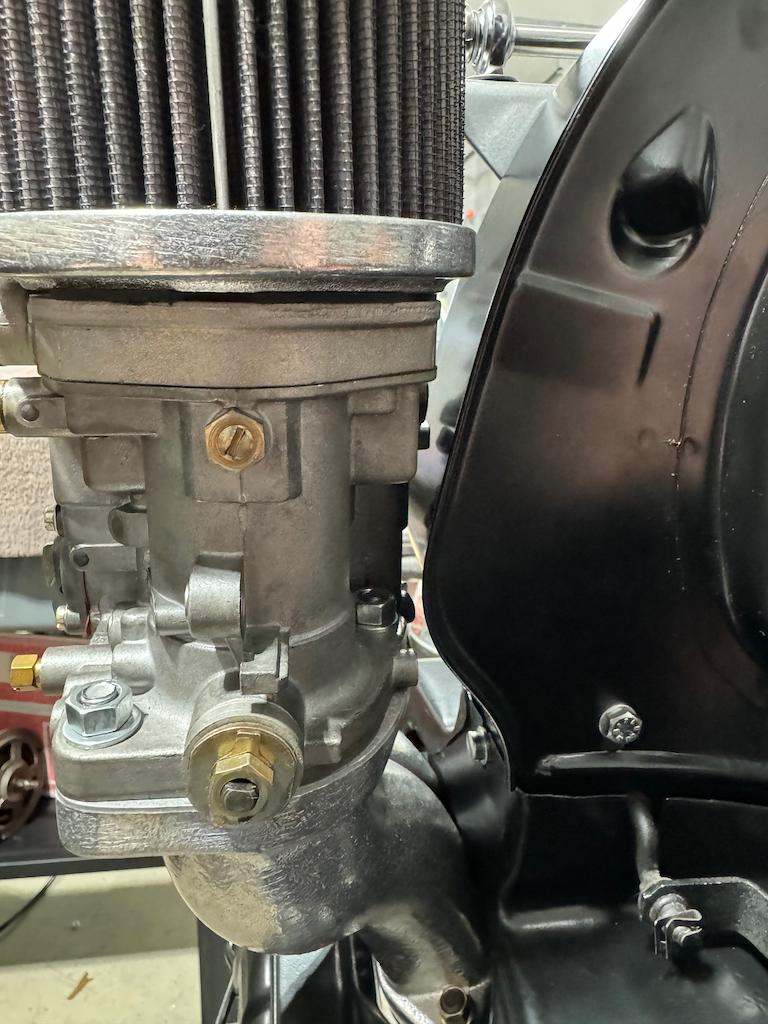

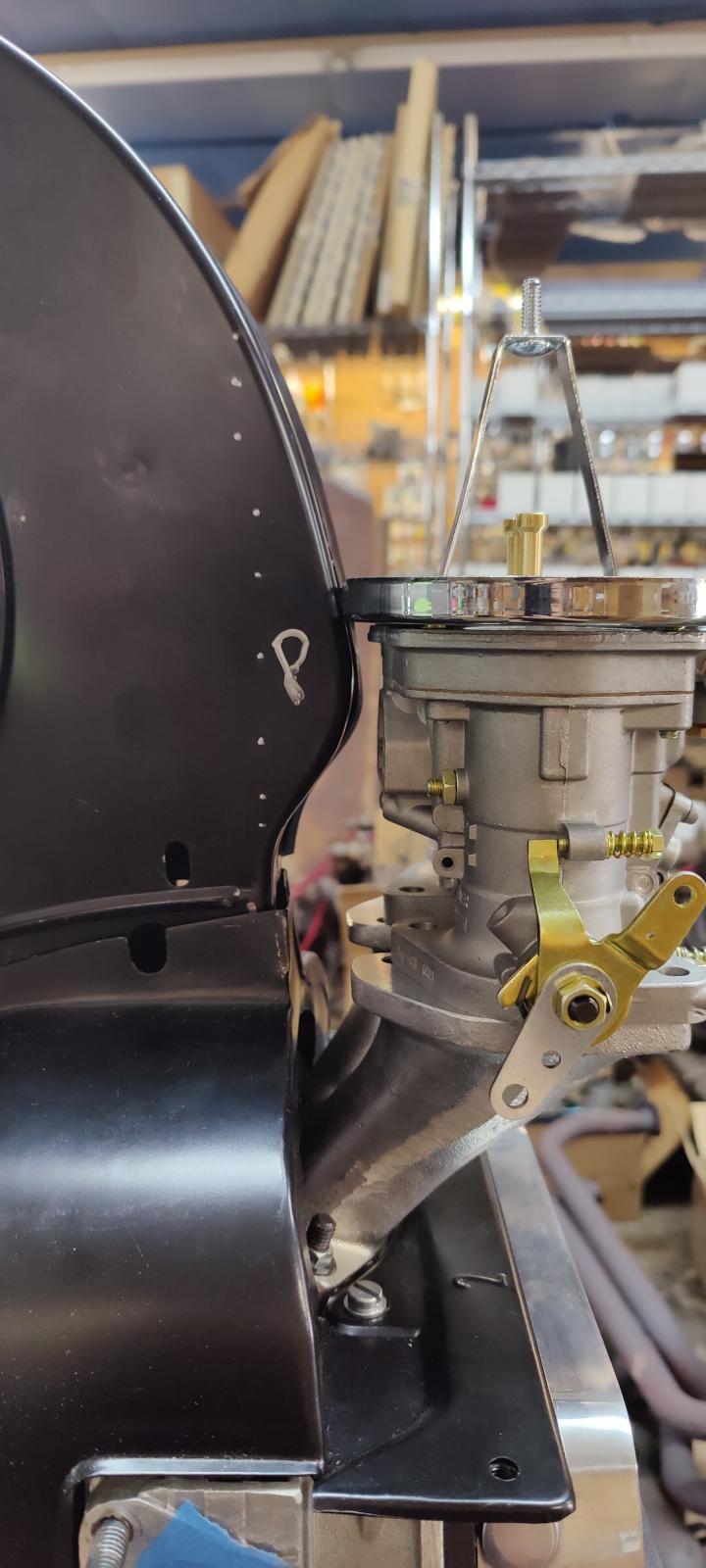

PostPosted: Mon Apr 29, 2024 10:46 am    Post subject: Re: COOLED brand Engine fanshrouds and engine tin. Reply with quote
For the sake of future readers, here's how dual Dells on CB manifolds work with the Cooled shroud. I love the fit, carbs have enough space to install in the engine bay and when bolted down aren't contacting the shroud at all. The pics make it look like the carbs are closer than they are in reality.

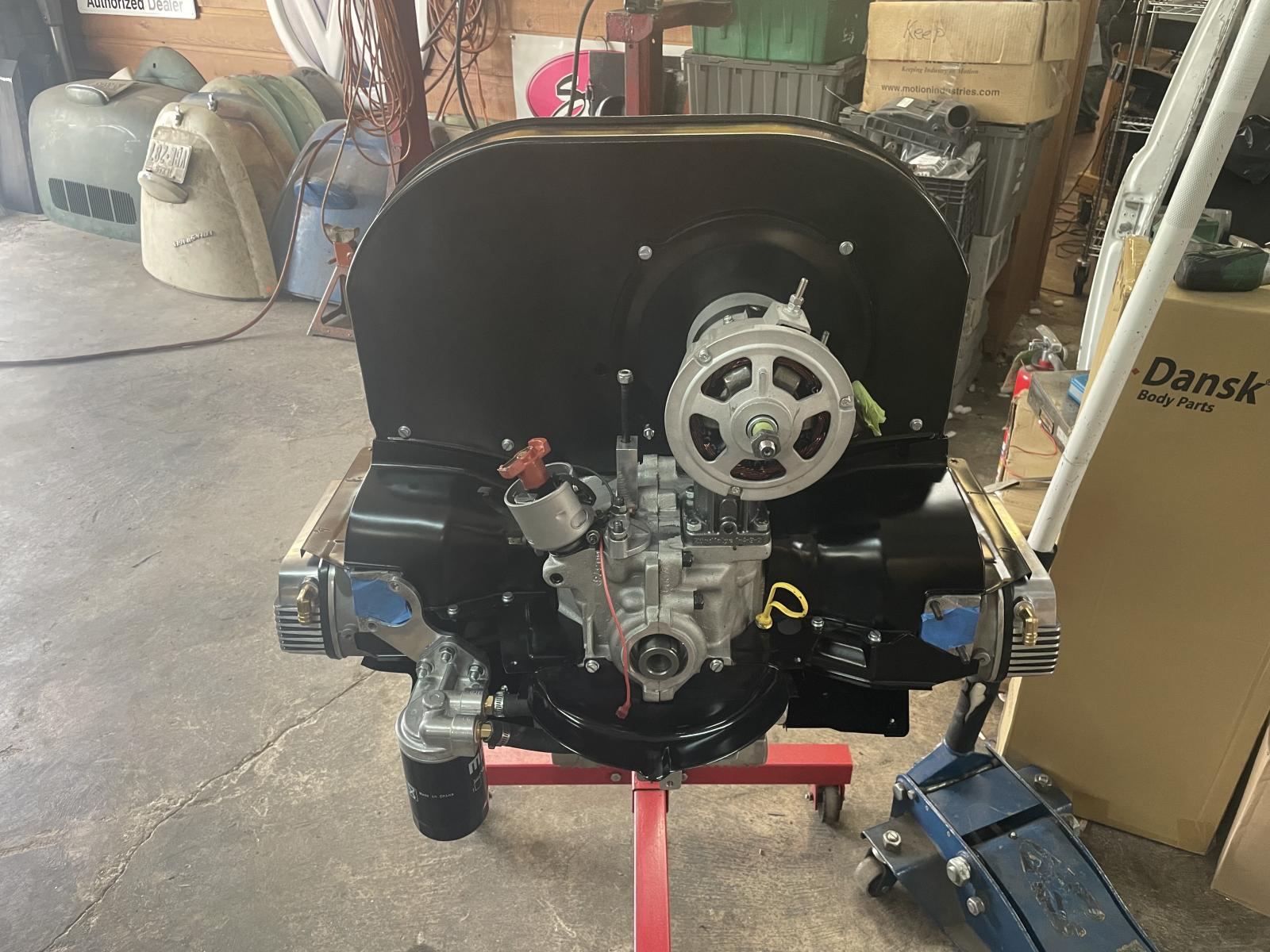

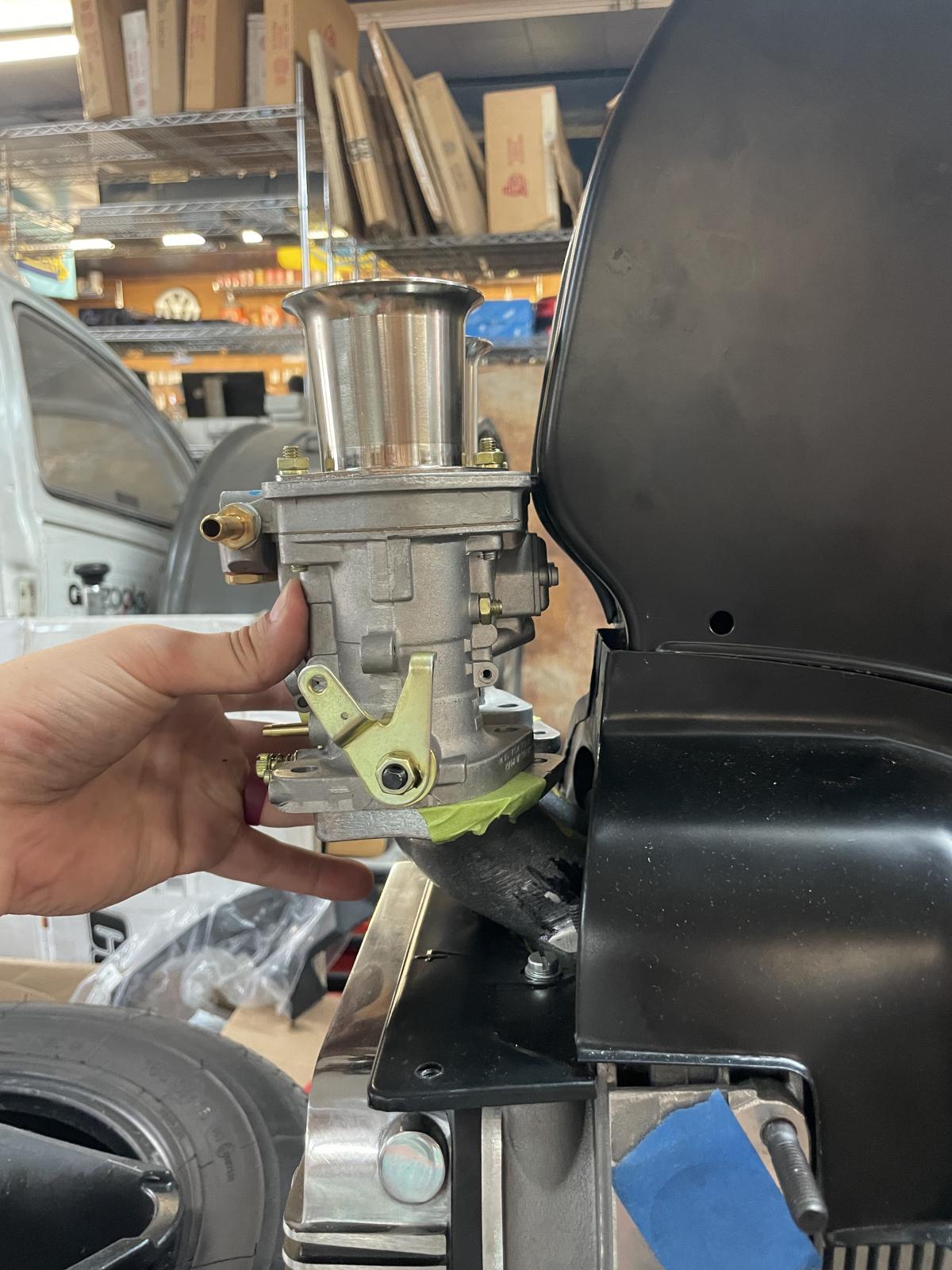

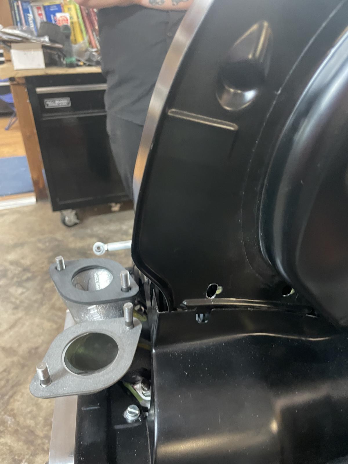

PostPosted: Sat Apr 27, 2024 5:45 pm    Post subject: Re: COOLED brand Engine fanshrouds and engine tin. Reply with quote
Another picture with the carb.
Frizbal
Joined: July 03, 2016
Posts: 133
Frizbal is offline
PostPosted: Sat Apr 27, 2024 5:42 pm    Post subject: Re: COOLED brand Engine fanshrouds and engine tin. Reply with quote
They were the type 1 shorter manifolds from CB. But the gene berg manifolds didn’t fit either. Manifold flanges and carb linkage would have hit the edge of the shroud.

PostPosted: Sat Apr 27, 2024 1:24 pm    Post subject: Re: COOLED brand Engine fanshrouds and engine tin. Reply with quote
Frizbal wrote:
I installed one, but unfortunately had to have it hacked to pieces and re-welded… sure wish they would make a version that fits type 1 manifolds. Had interference with both GB and CB manifolds. But she looks sexy now!
Not sure what your problem was. Here's their fan shroud, with fresh air, and CB manifolds.
The shroud is the same dimensions of the stock one and i've had both Dellorto and 48 IDAs with no problem.

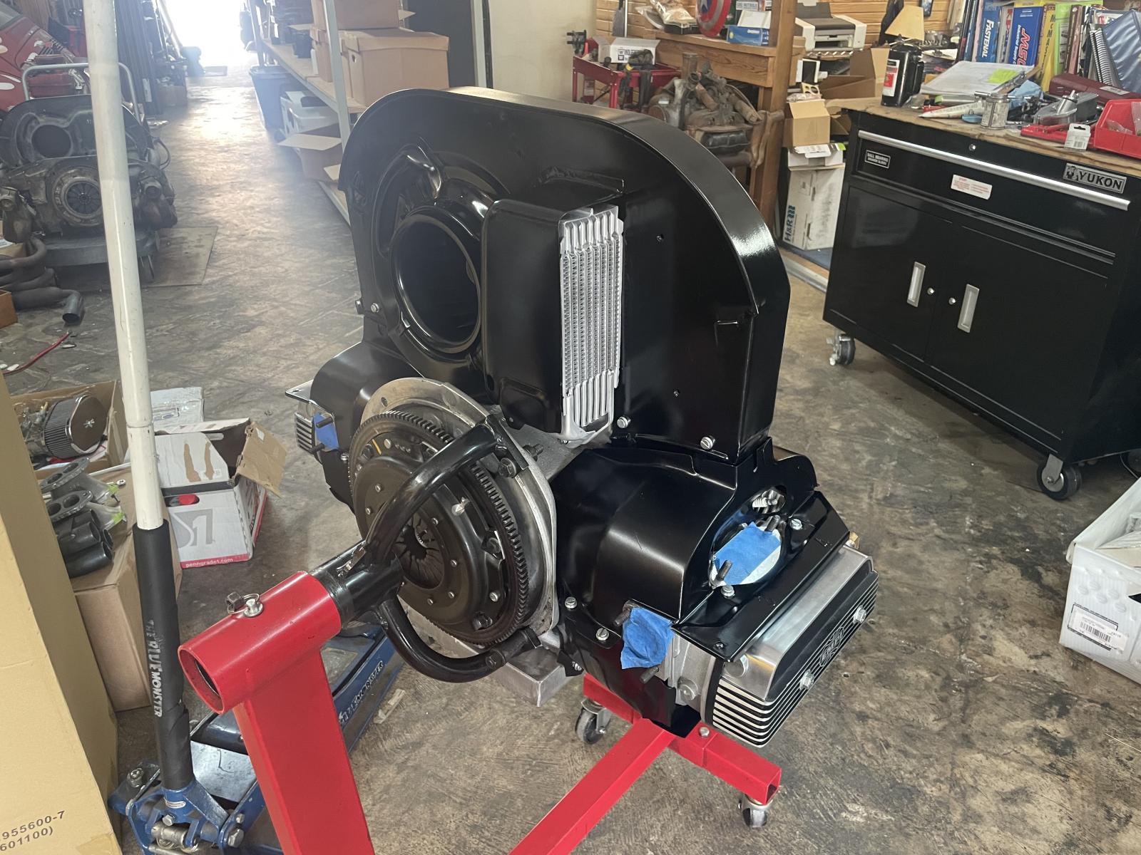

Thread
Joined: June 25, 2017
Posts: 71
Location: Portland, Or
Thread is offline
PostPosted: Sat Apr 27, 2024 12:57 pm    Post subject: Re: COOLED brand Engine fanshrouds and engine tin. Reply with quote
EDIT: figured out the interference, it was the inner flaps hitting the cylinder fins. Which makes sense since the barrels are larger.
I’m mocking up my build using the cooled fan shroud with the type 4 cooler. I’m also running the stock thermostat flaps. What linkage rod are those of you running this setup using? I’m using a 75-79 linkage and so far it’s pretty tight with the base of the cooler. I’m worried it might interfere when everything is buttoned up.
Was there any modification of the linkage needed on your setups or is there another version of the linkage that works better?
