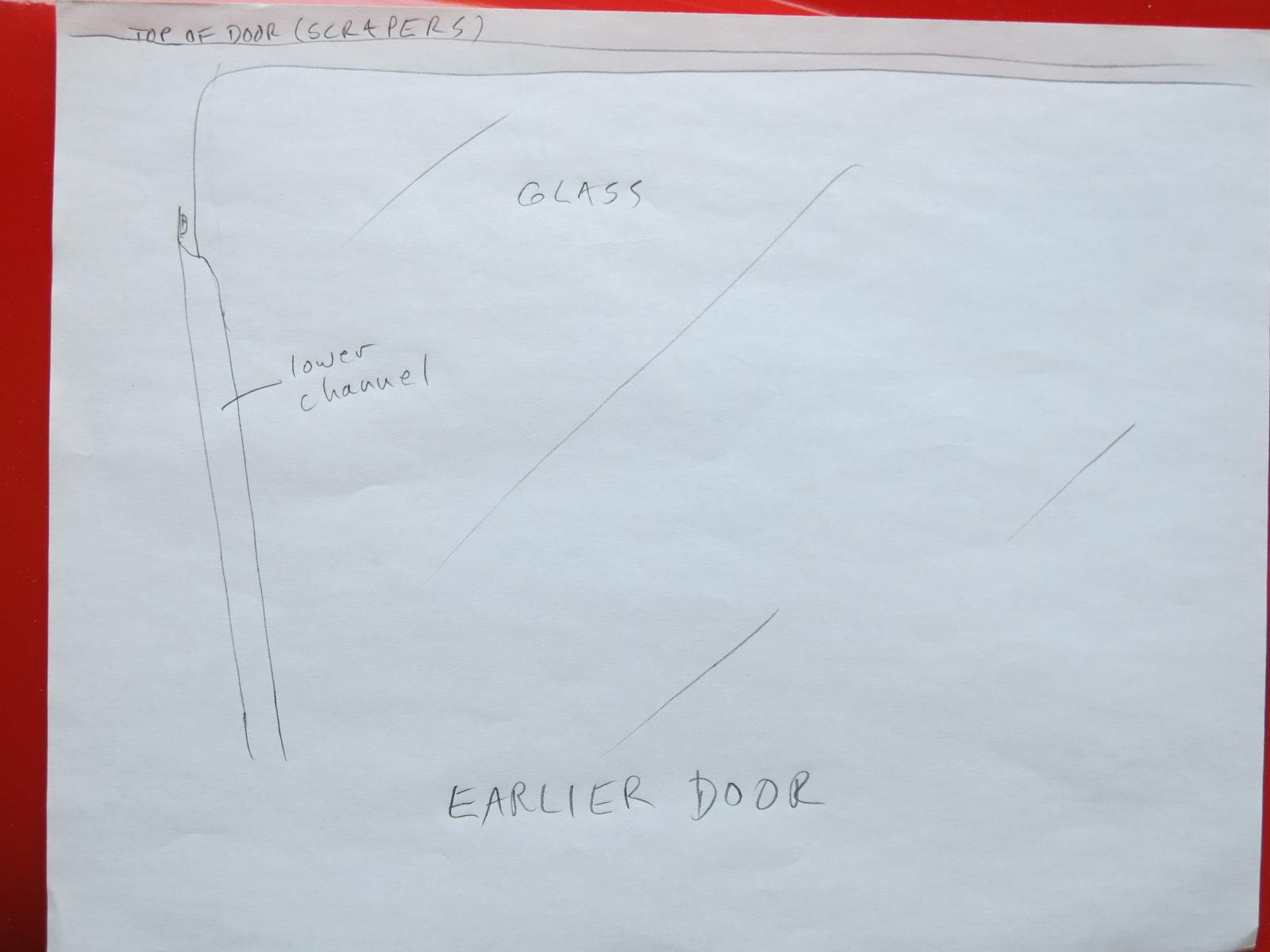

PostPosted: Sun Oct 11, 2020 9:58 am    Post subject: Re: Cab Door disassembly/maintenance/adjustment/reassembly (lots pix Reply with quote

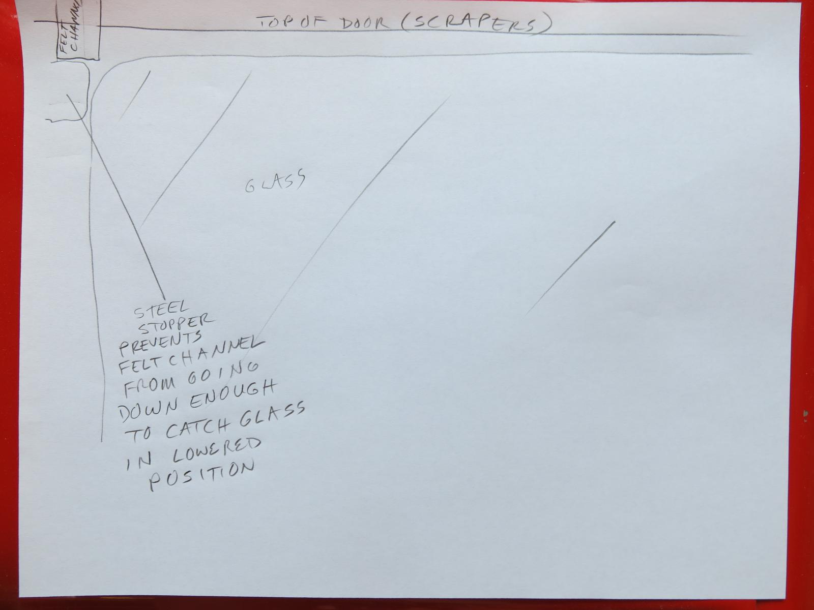

busdaddy wrote:

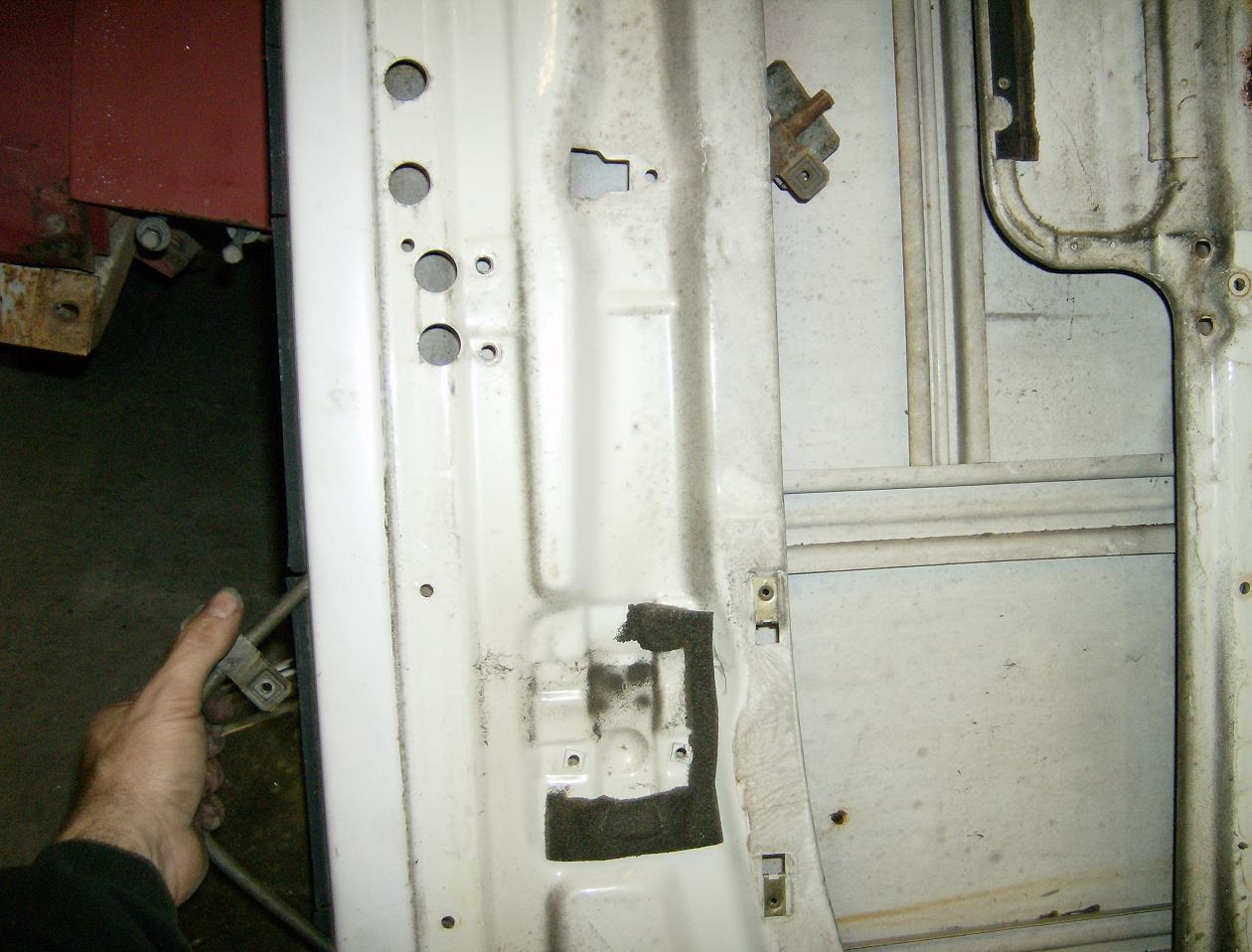

You didn't happen to get a picture of that steel stopper did you?

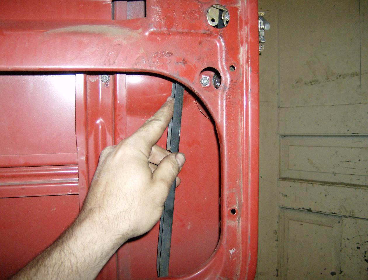

The arrow points to the metal part I am talking about. This door is from a later model bus (mine is a '73) and my passenger door does not have this metal arrangement. It doesn't really look like it in the pictures, but this piece protrudes inward from the back of the door about an inch. When I tried to assemble everything the first time, I could not fit the new felt channel between the face of this metal piece and the trailing edge of the window glass. I ended up shortening the channel so it didn't have to try to be between the two, and as such it would come down and butt against the top of the metal piece if it were exactly the right length (I think I was a little short).
This later door also does not have the metal lower channel piece that comes up from below, clips in at the top, and has a 10mm at the bottom to fasten it. So on this particular door, fully assembled and with the window all the way down, there was nothing to prevent the glass from rattling side-to-side, which you could hear when you shut the door. Not a huge deal, but I don't think I had it right. I would like to get it right, of course, how ever it is supposed to be.
Thanks!

PostPosted: Wed Oct 07, 2020 1:57 pm    Post subject: Re: Cab Door disassembly/maintenance/adjustment/reassembly (lots pix Reply with quote
I looked down in there with a flashlight. It is all put back together with scrapers and channel now. I remember when I was trying to put the channel in it seemed the glass was against this steel part of the door which acts as a stopper. When I look down there now i have the feeling that the channel is probably supposed to fit between the glass and this steel part - that the steel part is designed to be right behind the channel.
I plan to take it back apart (don't ask) so when I get it apart I will do my best to get a picture of it.
Thanks
busdaddy
Joined: February 12, 2004
Posts: 52818
busdaddy is offline
PostPosted: Wed Oct 07, 2020 12:09 pm    Post subject: Re: Cab Door disassembly/maintenance/adjustment/reassembly (lots pix Reply with quote

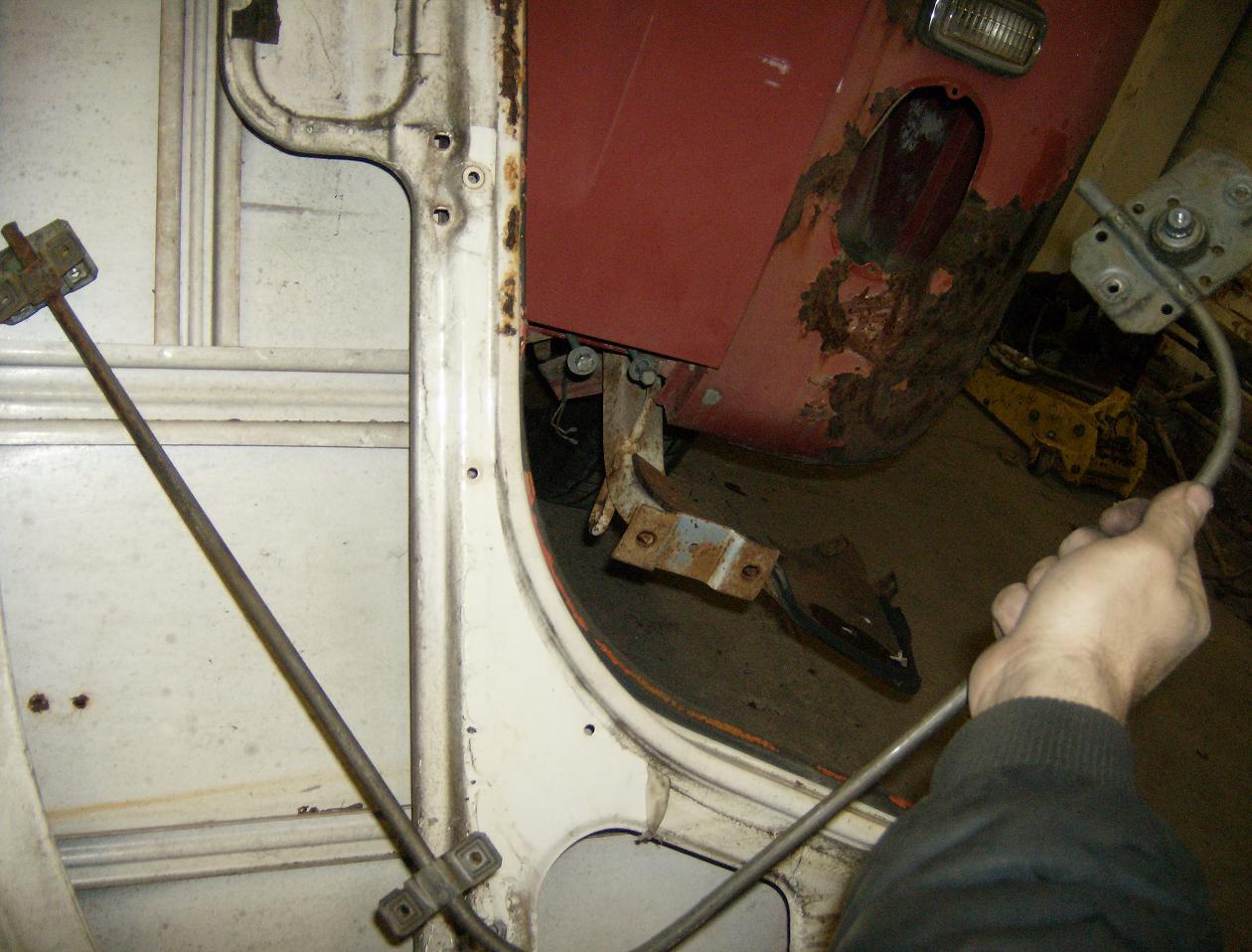

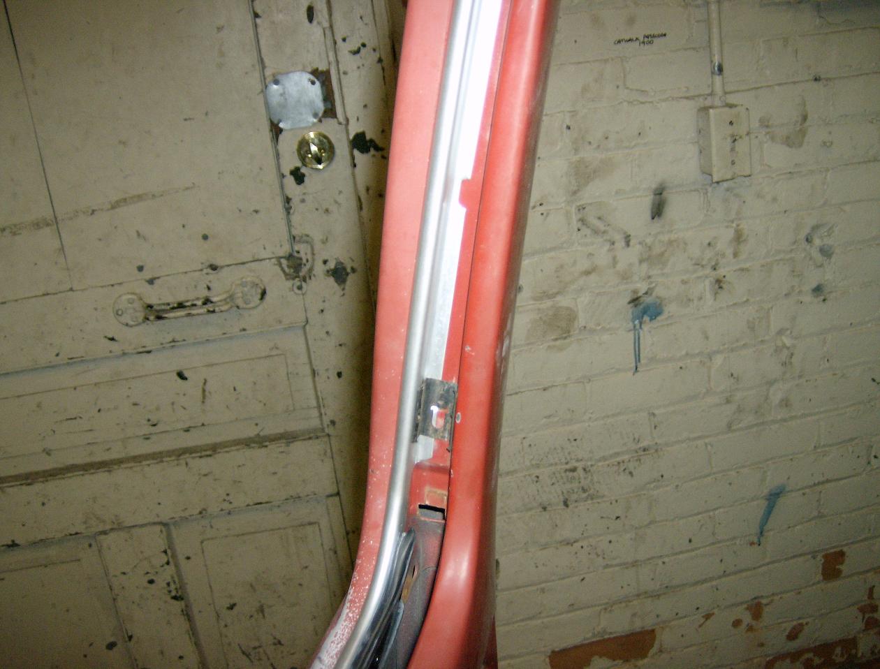

I used this post recently to rebuild my bus doors. It was very helpful, but I wanted to add my two cents, mostly regarding the best order to do things in...
—Roll down window.
—Remove upper/rear felt, LEAVING THE CLIPS IN. If you just yank the felt out with the clips, you will likely break the clips, then you will be sad while you locate and order new clips. Carefully poke around with a standard screwdriver or some type of pry tool until you find the clips, then use the pry tool to release the felt channel from the clips.
—Roll window up a bit and remove it from the regulator, then slide it off the regulator and down out of the way.
—Remove lower rear window channel, if your bus has one. Later busses do not.
—Remove inner door latch/handle.
—Remove inner scraper.
—Remove all 6 10mm bolts holding the regulator in.
—Remove vent window.
—Remove window.
—Remove regulator.
—Remove outer door handle.
—Remove latch assembly.
—Remove outer scraper.
In general, assembly is done in reverse order.
One other tip... To rebuild the vent window correctly, you will need a replacement rivet to re-attach the vent window to the frame after installing the new vent window seal. These are not included in the WCM or Wolfsburg West window rubber set. I found this out in process, and was sad when I had to wait to mail order those two tiny little parts.
Good luck! It’s a bitch, but worth it if your bus has the original 50-year-old rubber parts like mine did.
