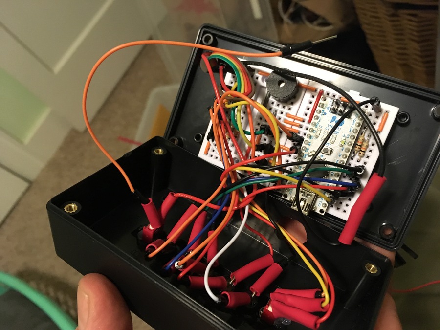

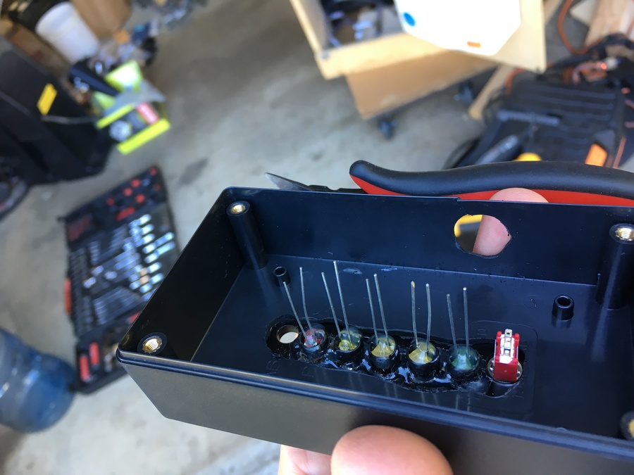

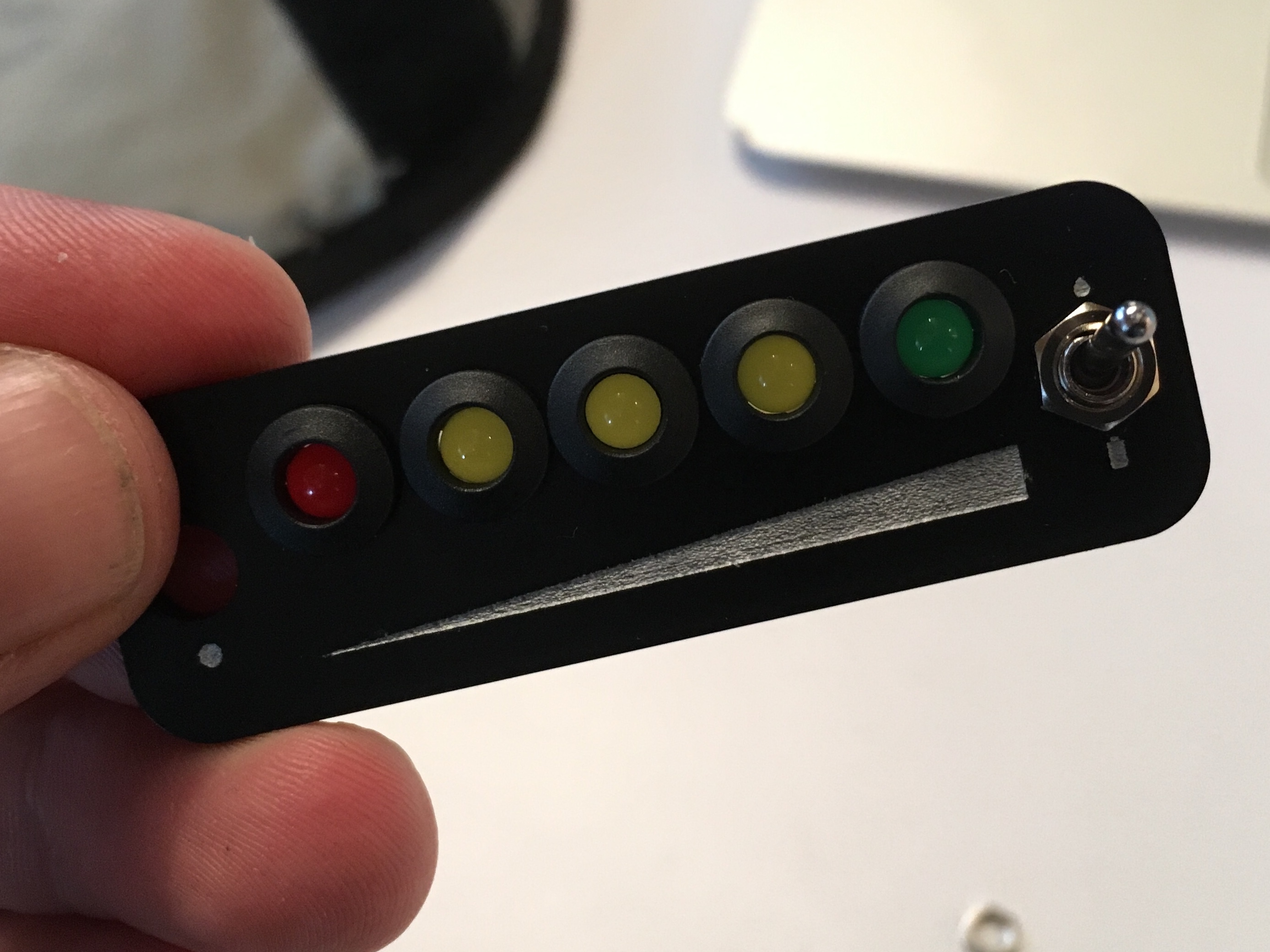

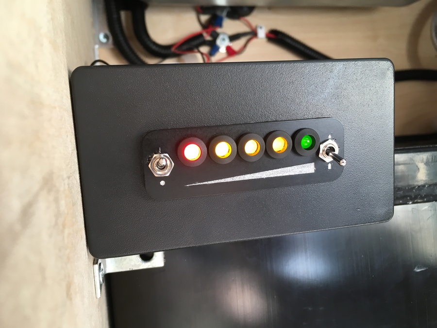

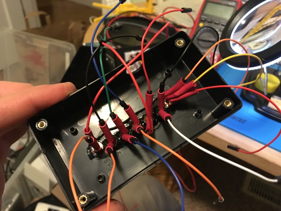

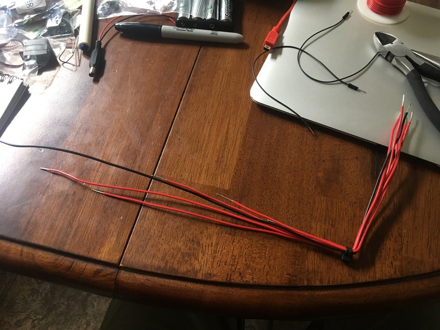

I haven’t posted in a while, and it’s not directly related to the recent reply, but I thought I’d give an update on my fresh water / aux voltage project. It’s by no means complete, stable, durable, or beautiful, but I’ve been learning a bunch of skills along the way to make it better.

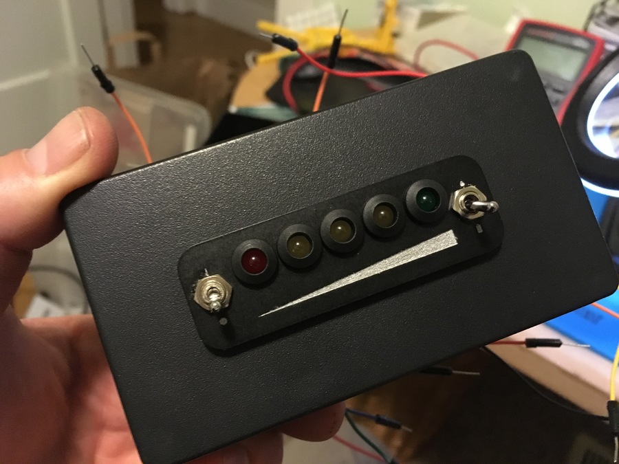

I borrowed time on a Glowforge laser cutter to make a faceplate out of acrylic.

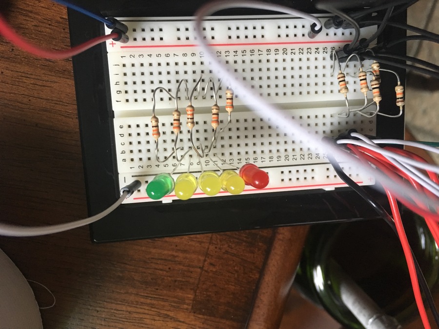

I popped in some LEDs and switches.

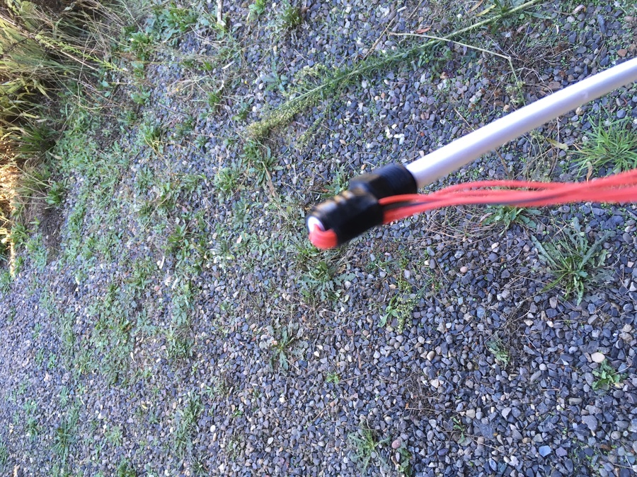

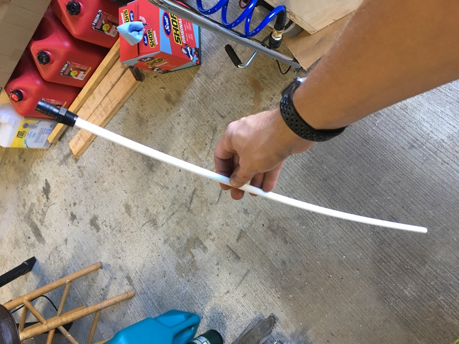

In my water tank, I have a piece of PEX tubing with lead wires down it that hooks into my circuitry.

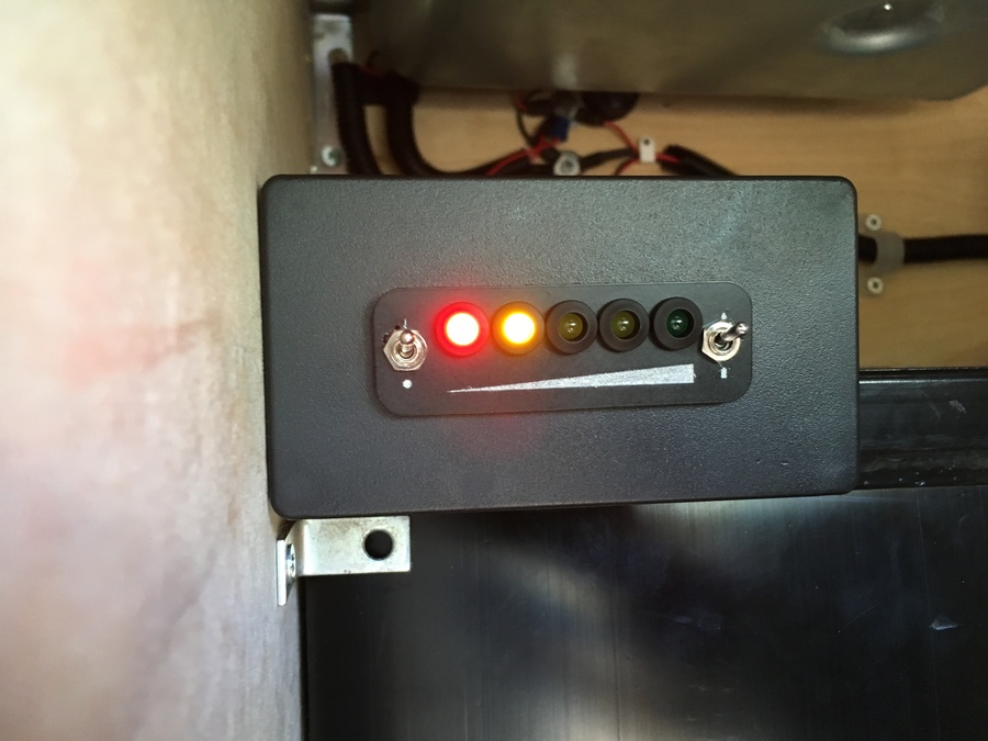

I wired and finished it up, but based on the fact that I’m expecting to make a nicer panel at some point, I just put it on an enclosure that’s hidden from view inside near where I fill my water tank.

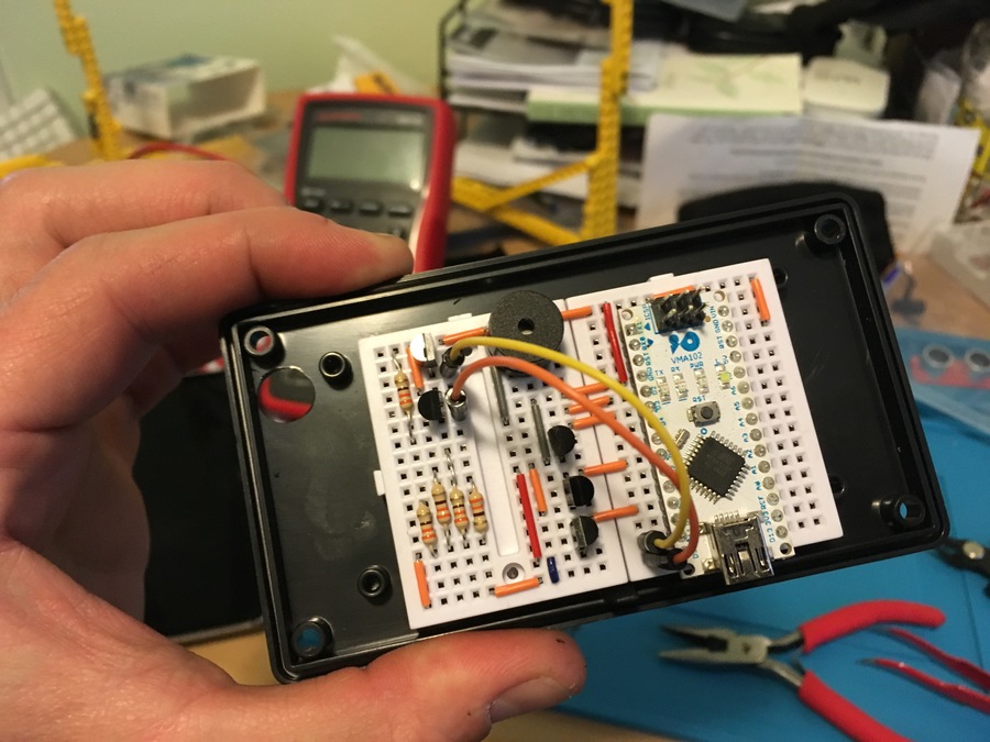

And then it’s all set. It powers on or off, and the right switch changes between showing either fresh water level or relative voltage of the aux battery (taking into account that “empty” is at about 50% since it’s a lead acid).
I also have a small buzzer on here and a program which can do things like blink various lights and make sounds for full or empty conditions such as filling or near running out.
It’s been fun and I hope to keep making it nicer! More as I get there...

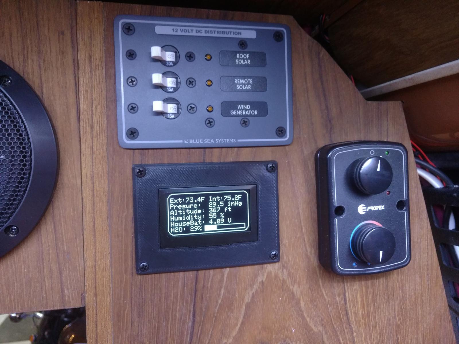

Not intending to hijack, but instead to augment, here's my camping oriented Arduino based screen system.
Intended for camping related info instead of driving, it runs from the house battery and is in the rear cabin next to the counter.[/img]

The project is still on the bench, mostly working. I have instead been building a pole barn and equipping it to rebuild my '87. Along the way, I got busy designing another board that will interest a number of people. You'll likely hear about those from a trusted source very soon. There are a number already quietly installed and we have just been refining the options and testing before releasing it publicly.
The InfoGauge isn't dead, I just needed a running van to install it in and further develop it. Along those lines, I will be picking up an '85 Westy in the coming days and that will become the test bed while I rebuild the Smokey, the SyncroWesty. I was going to leave today to go get it, but it was -7 here last night, and I'm driving like 7 hours to get it. Knowing the possibility of breakdowns, and the general misery of working in sub-zero temps, the owner and I decided to put it off a few days.
Thanks for bringing it back up. I hadn't seen a lot of interest and it became a personal project, but who knows, I may dust it off and put it out there after I have some time with it in a running van.
