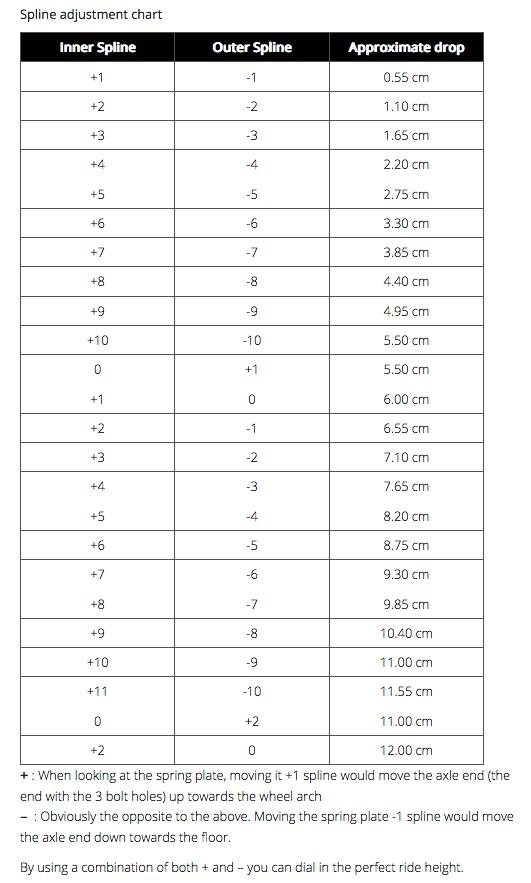

PostPosted: Sun Aug 28, 2016 10:02 am    Post subject: Re: IRS Bolt on Like BusBoys (Are They Out of Biz?) Reply with quote
sambaphil wrote:
Hey All,
Just as a sanity check here. Does +3 mean "clockwise?" And -3 mean counter clockwise?
In the middle of it now....
That depends on which side of the bus you are working.
Just make sure you do one in each direction to gain the change you want. When you have your hands on it, and think about what is happening, the light bulb will go on in your head again and it all becomes really, really simple.

PostPosted: Sun Aug 28, 2016 9:48 am    Post subject: Re: IRS Bolt on Like BusBoys (Are They Out of Biz?) Reply with quote
Hey All,
UPDATE: Found This Useful Chart

OK...looks like I have the math. My approach, do math, measure from floor, eyeball, make fine adjustments, and get as close as I can to stock height. Roll the bus around the block a few times, see if all is good.
Thanks again for all the input from the community. Super helpful. I love videos so I will make a video of the highlights and post it. Work slated with my friends for Sunday. Need to research the best way to get the spring plates off safely.
