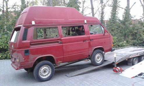

PostPosted: Sat Jun 12, 2021 7:59 am    Post subject: Re: Volkswagen Westfalia Joker 16" original does this exist? Reply with quote
I know mine is an original 16"...

PostPosted: Sat Jun 12, 2021 2:33 am    Post subject: Re: Volkswagen Westfalia Joker 16" original does this exist? Reply with quote
Dropped to the max Cool. (No other way to get it into my garage with the hightop on)
