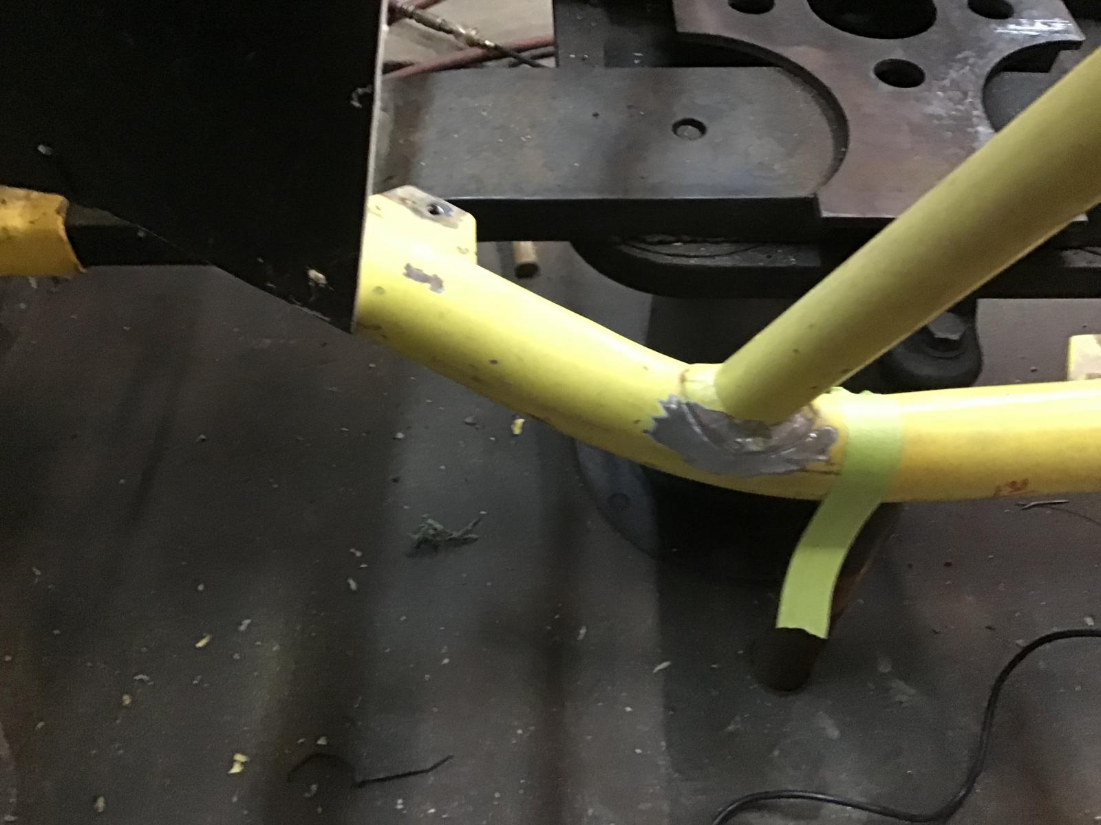

PostPosted: Sat Sep 29, 2018 6:45 pm    Post subject: Re: My 4 Seater Buggy Project Reply with quote
I suggest that to stretch the wheelbase, you move the torsion housing back to where it's right under the B-pillar.

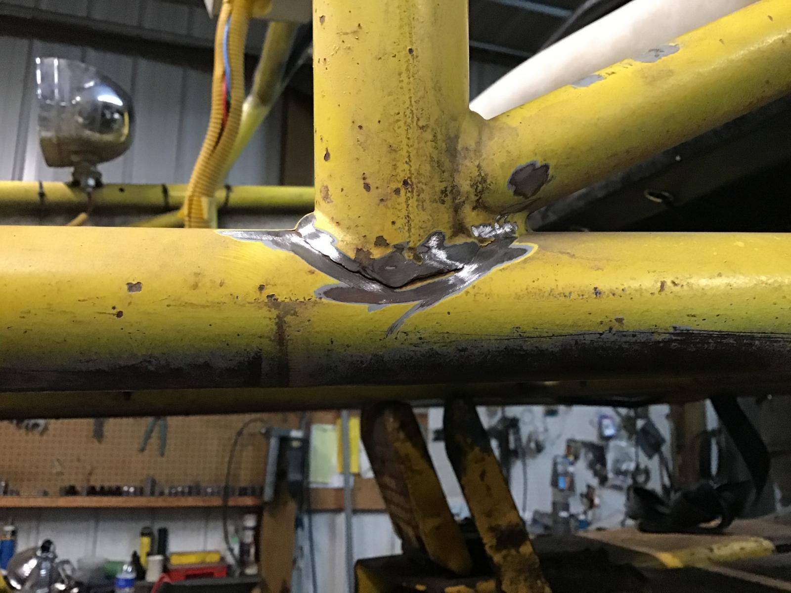

PostPosted: Sat Sep 29, 2018 6:37 pm    Post subject: Re: My 4 Seater Buggy Project Reply with quote
One thing that will help with that sort of break is to install the diagonal small diameter truss tubes so they are evenly cornered up. It is far easier for a fabricator to cut the ends of those tubes with one angle. But the correct way is to cut 2 angles.
Also, if the welder uses CO2 for welding gas, the weld will have deep penetration, but will be narrow. 75/25 will produce a wider heat penetration and will thus be less likely to crack. I'm not saying for certain that's the situation here. Just suggesting it's a possibility.
These suggestions are put forward with the thought of you doing substantial modifications to your existing frame.

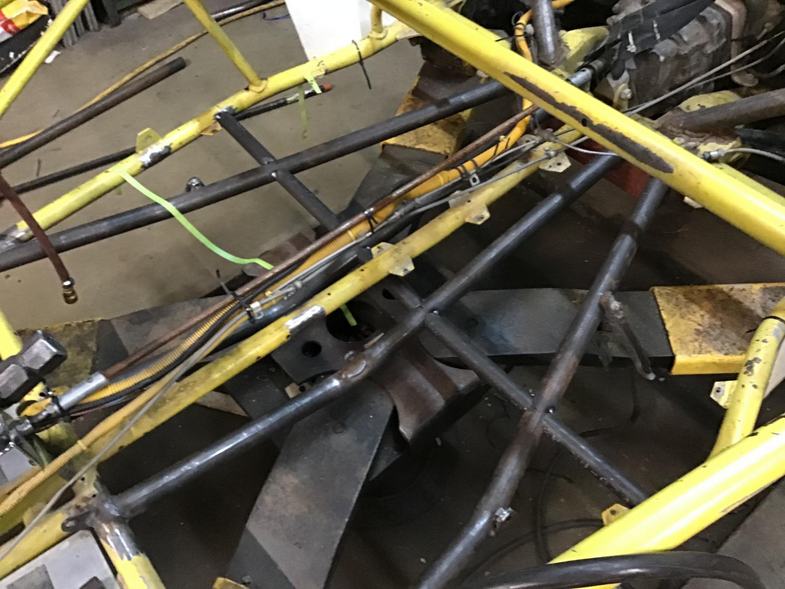

PostPosted: Tue Sep 11, 2018 9:46 am    Post subject: Re: My 4 Seater Buggy Project Reply with quote

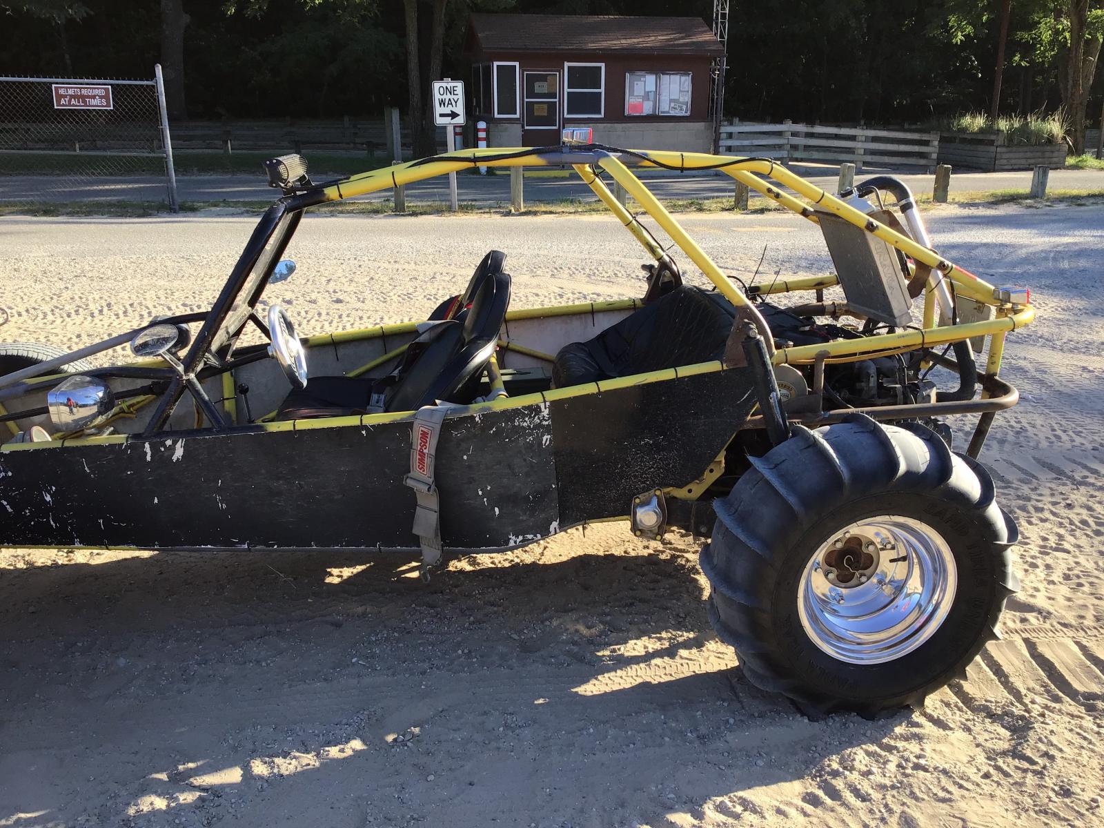

After countless jumps and abuse, my chassis braces are doing their job! I see little to no flex in the front end, and it seams now that the suspension is working better as well. Yesterday we planned a 6 hr round trip to the dunes, rolled in the driveway just shy of 12 hrs gone. Multiple trips from Appletree Auto near the highway to Duneland next to the dunes entrance, ended up with new wheels, tires, stud adapters and that ooooo shiney moment. Total bill close to $1400.

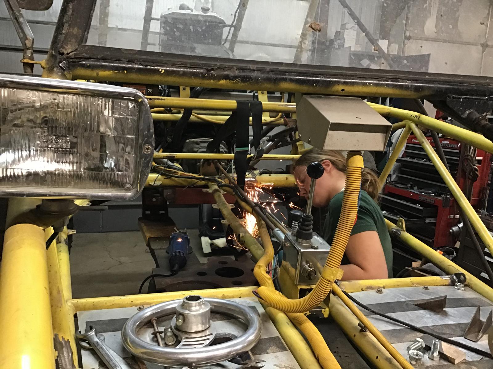

PostPosted: Thu Aug 23, 2018 5:31 am    Post subject: Re: My 4 Seater Buggy Project Reply with quote
We all had fun, the car came back in one piece, mostly! I think I ripped a tube in my right paddle and I need to upgrade the cooling system. Maybe another civic rad, and mounted/shrouded on the sides. It got hot and spewed some coolant after about 2 hrs of second gear, close to wide open. I still can’t believe the power difference in the sand with the Subaru mill vs VW. The front handles well, but of course could use coil overs still... but the rear NEEDS coil overs. It bucks hard and bottoms out frequently.

PostPosted: Tue Aug 21, 2018 5:35 am    Post subject: Re: My 4 Seater Buggy Project Reply with quote
The seat mounts will hopefully transfer power forward as well as support the seats... they are as close to the trailing arm / trans mounts as possible.

So, it’s been a while... I ‘spose. Last October I believe, we cracked the chassis at the dunes. Come to find out, almost every weld on the lower right rail was cracked at least half way around. I now have a bender, notcher, bigger welder and a nice shop with a lift. Plans are to eventually cut this car in half, stretch it, get it the way I want, then jig it and build new. But for now, the cracks are ground out, drilled, welded up, gusseted where I think they need more support, and a front brace built. Dune trip tomorrow for a shakedown! Oh yeah, suspension seats, harnesses up front, and more floor/subframe support. Our “German Kid” Jil, who was our exchange student 5 years ago, is in town and gave me some help in the shop! Sorry for duplicates if that happens, getting the hang of posting from an iPad instead of PC.

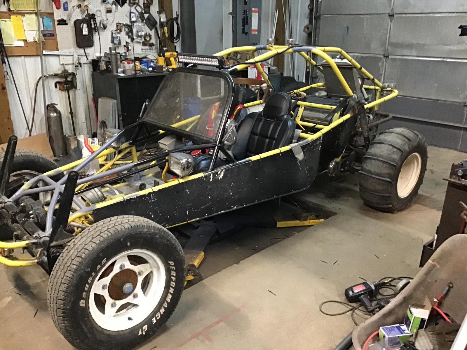

Good news... for a slacker! The noise was actually an exploded wheel bearing on the left rear. So, whenever I get around to popping that apart, I'll see if it's as simple as replacing the bearing and race, or if there is any other carnage. Otherwise, I bet everything in the trans is just fine.

Well, these Subaru donors couldn't have come in at a better time. My wife had a friend come over yesterday and asked me to take her for a ride across the field. Something inside the bus box sounds like a rock stuck in a brake rotor. It still moves, there wasn't any "big bang" or anything, it just came on. I was about 1/4 mile from the house when it really came on, so I took it easy on the way home and parked it.

PostPosted: Wed Oct 25, 2017 9:01 am    Post subject: Re: My 4 Seater Buggy Project Reply with quote
It rained for about 54 hours or so without stopping and the back field is a bit damp. We took a break from homeschool to spin a wheel this morning. The car likes 2nd gear the best. Reminded me of the days we had the waverunners and jetskis... no steer unless you're in the gas!

PostPosted: Tue Oct 10, 2017 7:18 am    Post subject: Re: My 4 Seater Buggy Project Reply with quote
Alright... camera's dead so sorry no pics right now. Though we moved 2 months ago, we can't find a thing and haven't really unpacked much but clothes. Some day my in-law's new house will be done and they'll move out. enough rant.
I started thinking, reading cbeck's build page mainly page 3 and getting ideas. I think I'll cut the chassis from the torsion tube and stretch the wheelbase 11-12". The new Appletree model is 115" wheelbase, my current one is 104" (stock). I'll also cut the top bars of the main chassis and widen them to build room for larger seats then rebuild the rollcage and allow for more headroom and maybe some storage too. I'll have to take some side shots and see about doing some ms paint work to see what I like. More updates some day...

PostPosted: Sun Oct 08, 2017 5:26 pm    Post subject: Re: My 4 Seater Buggy Project Reply with quote
cbeck wrote:
We would love to tell you how to spend money that isn't ours.
It's been a down hill slide since I got here, why would I expect anything different? Laughing
For now, I could probably repair and gusset the B pillar. Because the more I think about it, the more I think. Thinking costs money. I'm looking at only about $500 worth of tube, I could build a new chassis front to back. I could widen the frame, lengthen it, raise the roll cage and be back in business before spring. In a perfect world. But then I might as well lengthen my trailing arms another 2" and go A-arm front, coilovers, etc. See the downhill slide comment above.. my mind is caught in the snowball.
