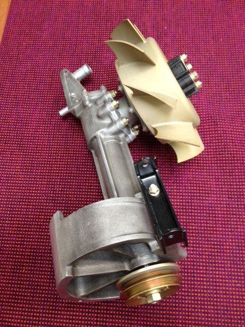

Both Chevy for their Corvair and Porsche used flat fans. For Porsche it was mostly a race car thing.
Corvair used belts and pulleys. Porsche drive gears.
I got the pictures doing a search of Porsche flat fans.
Chris

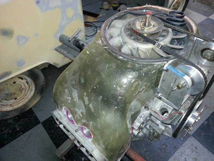

I want the flat fan version for a Type 3...
mock up...
beauty of a car you've got there Chris.
