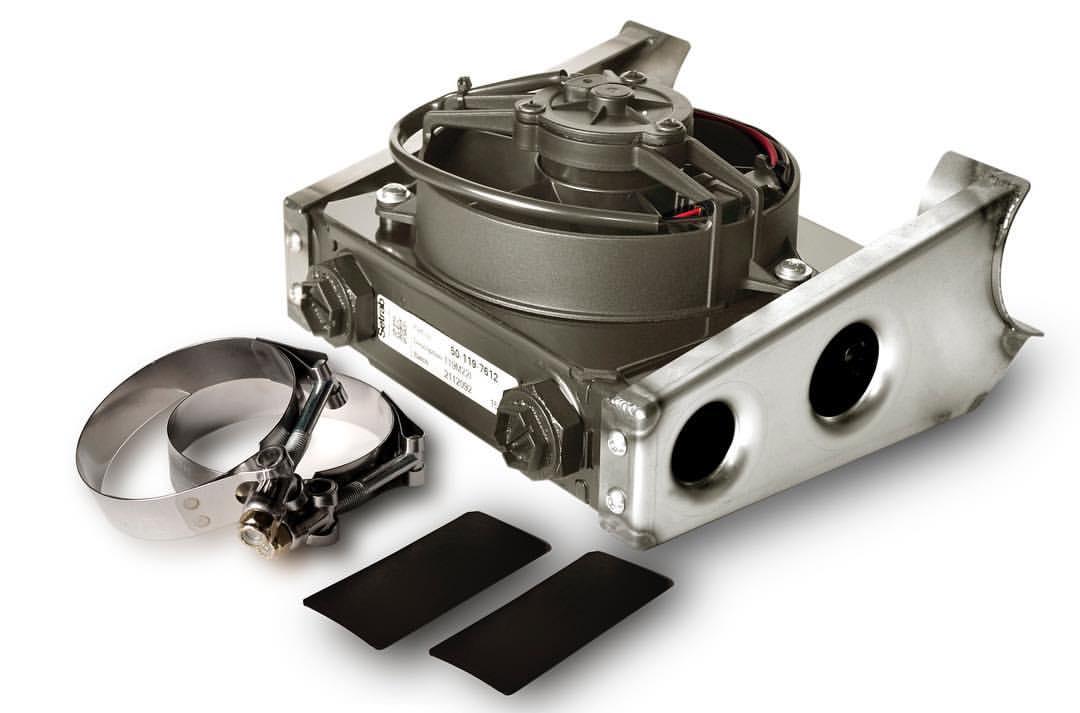

CerveloMikey wrote:
This is what I have. Setrab fan pack clamped to the torsion housing with a 180 degree switch. I don't know why you don't want to run a fan especially in the 909. Setrab makes the cooler without the fan too. $450 for the cooler, fan and brackets. The best part is no drilling holes in the body sheet metal!
Where did you get the mounting brackets? do you have a link for the kit?
TIA

PostPosted: Sat Feb 25, 2017 11:02 pm    Post subject: Re: Lowlight external oil cooler advice needed Reply with quote

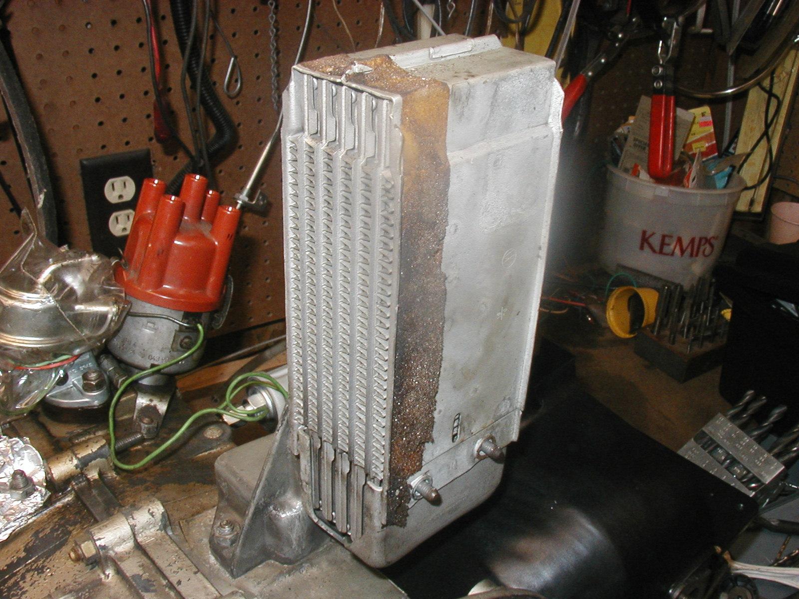

PostPosted: Sat Feb 25, 2017 3:41 pm    Post subject: Lowlight external oil cooler advice needed Reply with quote
Group:
I have a 1958 lowlight Ghia with the square support bar that's part of the underside of the package area, above the transaxle, where I would like to mount an external oil cooler.
A little background first. I've been running an EMPI 1/2" 8-pass cooler (part no. 9223, see link below) in the full-flow 40HP in my 1959 ragtop bug for over 20 years with no problems.
http://vwcatalog.empius.com/vwcatalog/2016/49.html
However, I noticed that the vertical distance in my lowlight is significantly less than that for the bug, so I took measurements of my 9223 oil cooler, made a cardboard mock-up of it, and tried to fit it in the space. Unfortunately, the mock-up is pressed right down onto the top of the transaxle.
So, I then repeated the process with a mock-up of the EMPI 1/2" 6-pass cooler (part no. 9276, see link above), and it appears to fit nicely, even with the support bar.
Has anyone any suggestions (other cooler, etc) before I buy a 9276, trash the fins on installation and find out it actually does not fit (I was very careful making the mock-up), resulting in something I can't take back to the store?
I'm running a 1600DP (stock doghouse oil cooler) with an EMPI oil pump/filter and want to change over to the oil pump full-flow cover, remote oil filter, and external oil cooler, as the Inland Empire area of CA gets very hot during the summers.
I would prefer to not use a cooler equipped with a fan...
Engine is tuned just fine, if you were wondering.
