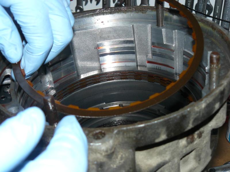

ALIKA T3 wrote:
I count 5 steel and 5 frictions on the drawing page 38.7 for the 1st/R brake.
With that info, you have it all for the number of plates/steel
Sorry for the huge letters, it's for the people who will skim the subject to find the useful info Wink
Edit: From another post on the Samba:
Auto Tranny - intermittent 2nd to 3rd upshift - Rebuild
The 1st/Reverse brake inner spline (friction) and outer spline (steel) plates. There are 4 of each on this transmission. My transmission did not have the wavy spring shown in the exploded view, 38.7 in the bentley. Page 38.13 explains the modification for my model of transmission and why it is not present.
So; I Dos' & I Don'ts !!!
I'm finding two different places in the Bentley showing
two different sets of numbers!
( Editing in here: Diagram in the Bentley shows 5 ea?
Looking at your pictures I could swear I'm seeing 4 ea? )
Depending on the Age and Modifications made to your particular transmission!
Just because our transmissions are from a 91 Vanagon Body
Don't mean a thing, I'm Finding !!!
Could be a 84 Trans in there a far as I can tell.
Of course, look at the number tag. But that only gets you so far!
What Modifications have been made inside that puppy
is anybody's guess !!!
Also,,, Previous re-builds !?
Don't rely on the plate count of what you find in there !
Or: Generic Manual Photo's Shocked

PostPosted: Thu May 11, 2017 2:40 pm    Post subject: Re: Automatic transmission rebuild+ custom oil cooler and problems Reply with quote
Energy Concepts wrote:
Now, to find out why I have such a large space on top of
the Reverse planetary ring gear/ Governor drive gear
( End Play adjustment )
To start, I'd better measure the height
of the Apply Shell ?
And back to my question;
How many 1st Reverse Plates
for a Vanagon.
I found most diagrams are generic
and covered All applications.
So, it's easy to have one too many plates in the assemblies !
At the present, I have No Wavy Plate,
and 4 ea inner and 4ea outer spline plates.
Is this correct?
Onward & upwards.
After thought; Maybe it Is Rocket Surgery ??? Laughing
Sorry you had a long monologue this morning, I was sleeping at that time in HI Laughing
I don't remember having seen a wavy steel at the end on mine, but look at 38.13, fig.17, they mention 4 each. I kinda remember having an extra pair left over from the job.
That wavy top steel might be missing on mine and creating my problem for driving on D from a stop. I'm glad you pointed it out.
I just noticed 38.7, for the D/R clutch, they say to look at 38.15 for assembly/disassembly, but it is actually 38.19, and for the Forward clutch, it is not 38.12 but 38.17.

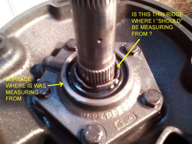

PostPosted: Thu May 11, 2017 12:22 pm    Post subject: Re: Automatic transmission rebuild+ custom oil cooler and problems Reply with quote
Real quick, from the waiting room at the doctor: yes, measure from where the spacer washer would sit on Wink

PostPosted: Thu May 11, 2017 8:14 am    Post subject: Re: Automatic transmission rebuild+ custom oil cooler and problems Reply with quote
OK, I may have figured it out Very Happy
Measuring Diameters, It looks like
I may have been measuring the wrong surface?
see pic;
That certainly would narrow the gap down for me!
The pictures in the Bentley are quite dark
and it's hard see the detail in them.
&&& My Transmission did not have a end play shim to compare Shocked
Thanks,
JC...

PostPosted: Thu May 11, 2017 6:38 am    Post subject: Re: Automatic transmission rebuild+ custom oil cooler and problems Reply with quote
One thing I'd like to mention, and I found it pretty easy to miss,
Is the Forward Planetary ring gear.
See page 38.17.
First, the Thrust Plate and
Then (1) Inner Splined Plate,
needs to be installed,
Under the Ridges on the Forward Planetary ring gear.
That's the little (bumps around the lower portion.
If you miss this note,
You may want to add all of the plates afterwards
or even at the beginning,
thinking they'll be sitting correctly
but that will probably chew everything up upon running.
Not to mention it will throw the pressure plate
adjustment way off.
I kind of wish Bentley would have circled these
not so obvious adjustments for dummies like myself ! Laughing
John C...

PostPosted: Thu May 11, 2017 6:00 am    Post subject: Re: Automatic transmission rebuild+ custom oil cooler and problems Reply with quote
ALIKA T3 wrote:
You're not measuring anything with that straight edge on that picture, or is it for illusration purposes?
Most likely you're measuring wrong somewhere, unless your clutch drum is not fully seated on the pump clips, but that would sit proud....
Yeah, Just for illustration Wink
So, Should it be 4 each & no Wavy?
On the first gear brake splined plates (B1)
Page 38.12 Fig 12 ?
So Near yet ... So far away Razz
Wow! Page 4 Already ???
Sorry about all of the dumb questions !!! Embarassed
