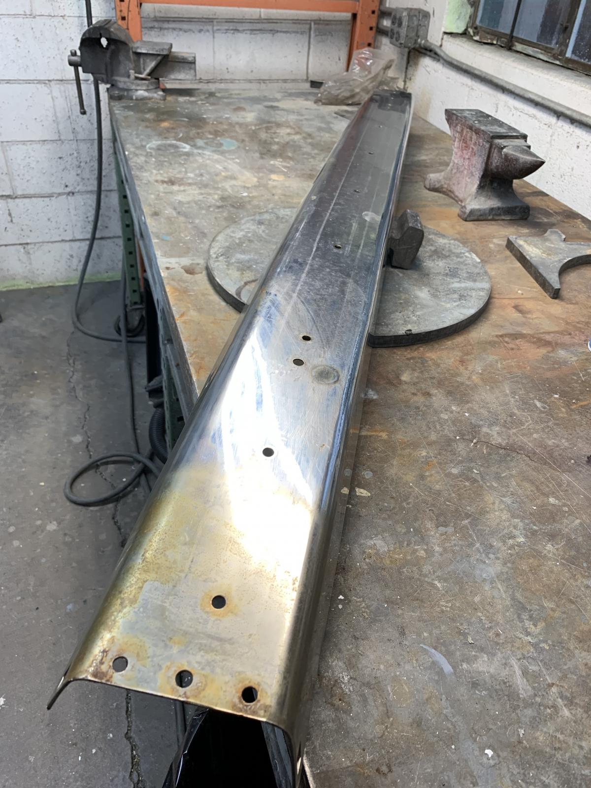

Prior to painting these things, I'd like to figure out a rear hitch set-up.
Was there an OEM hitch available for the Vanagon? Something which tucks below the bumper? Though I have a 2" receiver on the front for a bike rack, I don't see a need for something that large in the back. I'm not towing anything substantial, just my little boat.

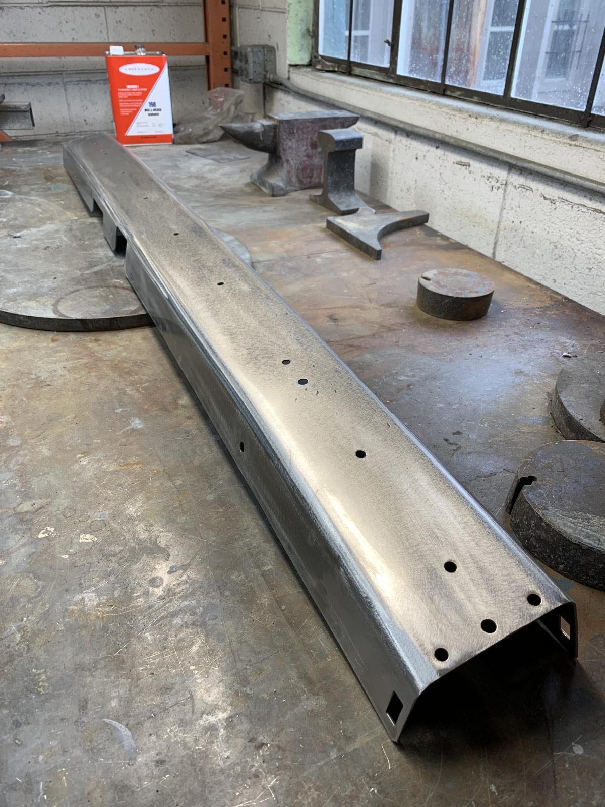

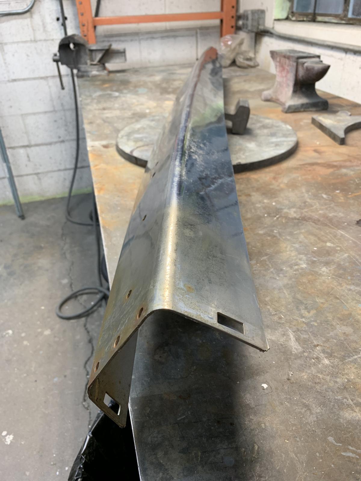

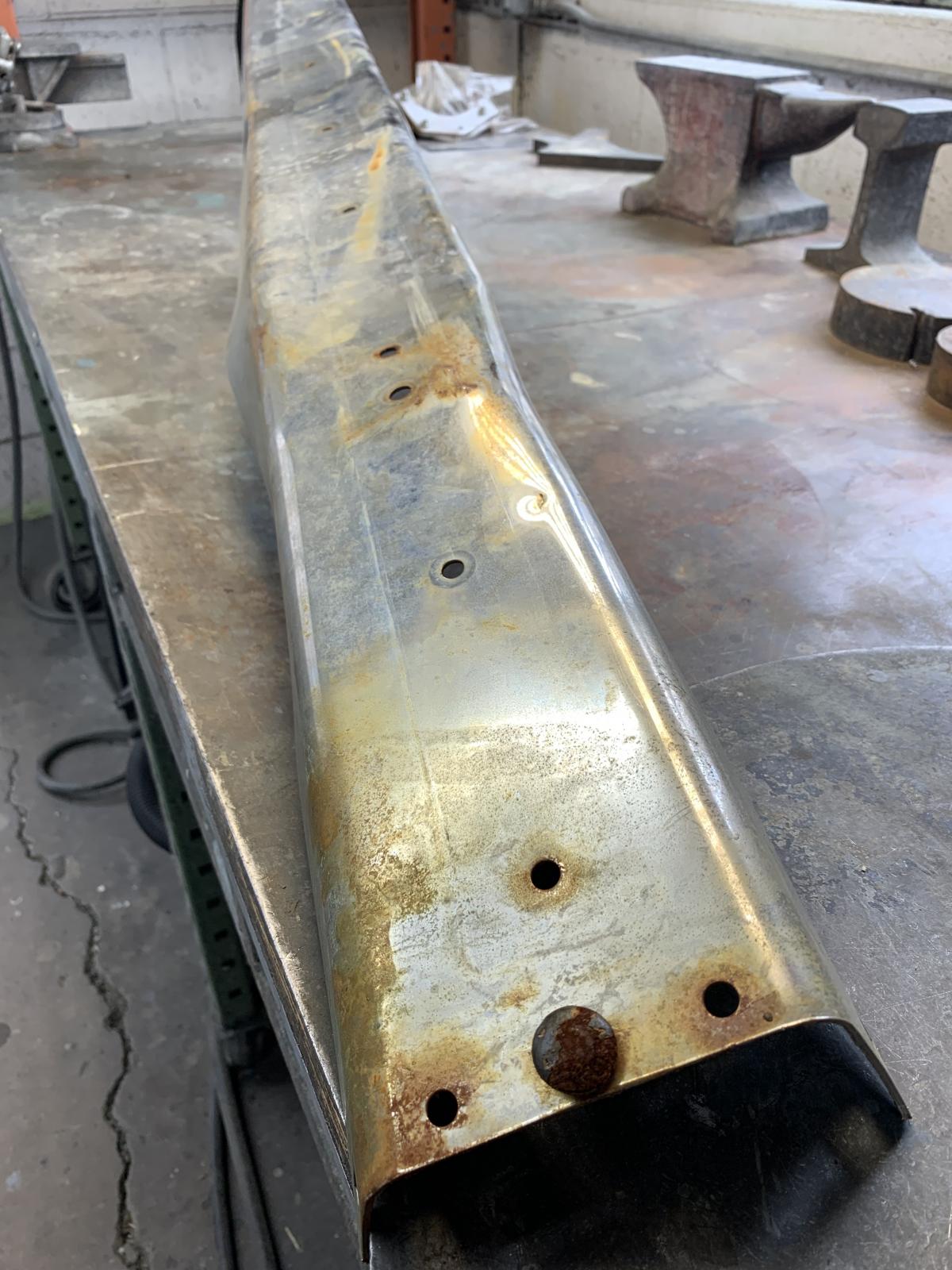

Followed that up with a 36 grit on the grinder, then 80 to clean up any surface imperfections.
Then did final sanding with a DA.
I kind of dig restoring bumpers. Lot's of metal to work with and it's fun to get brutal with the big hammers. Far less delicate work than metal finishing some 19 gauge.
The front bumper should be a piece of cake. A couple of minor dents and some paint prep.

PostPosted: Tue Jun 03, 2025 9:06 am    Post subject: Re: 85 Westy refresh. Plenty of questions to follow. Bulli Klinik Reply with quote

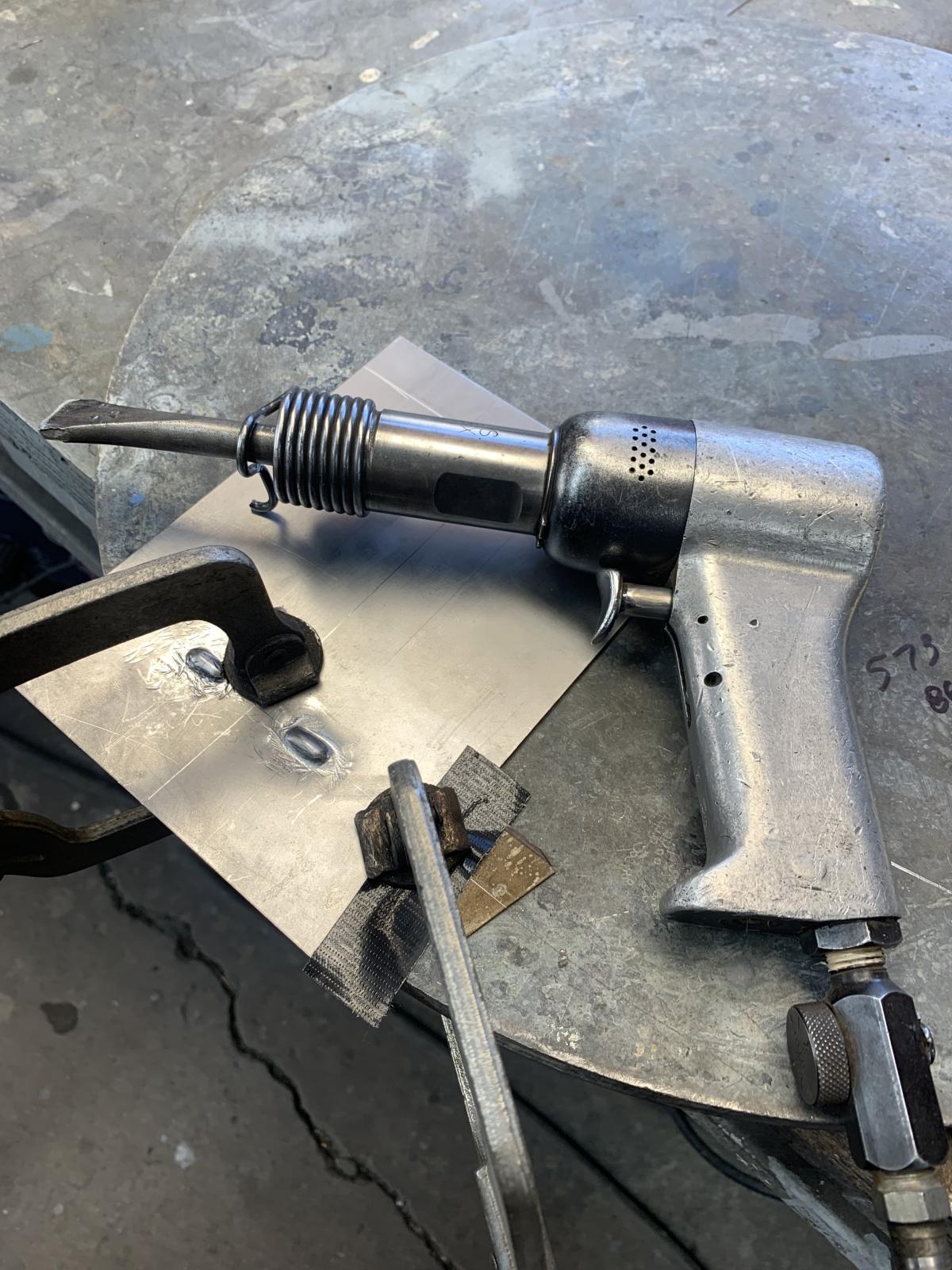

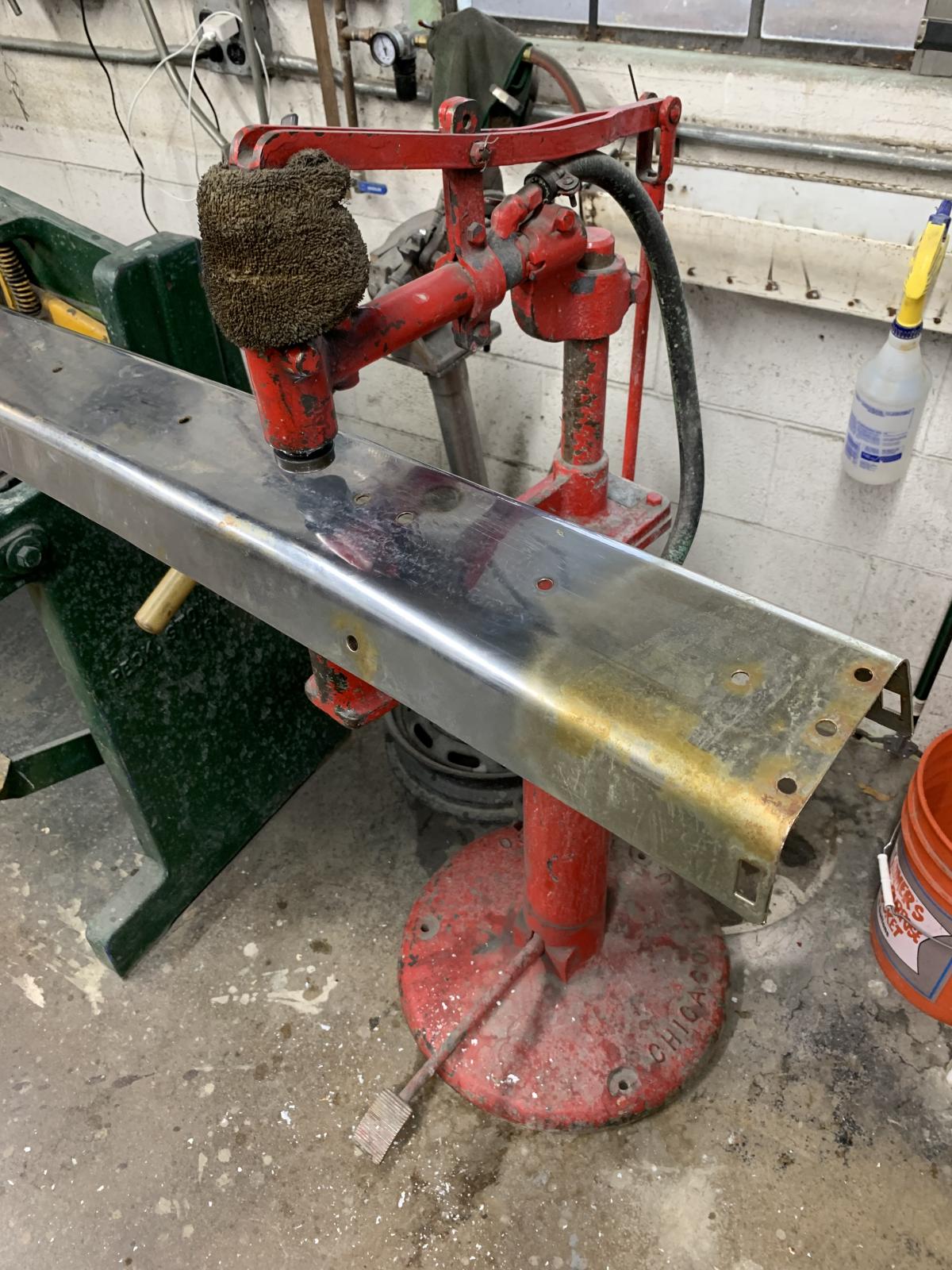

I had to shrink down a high spot that was stretched. Quickly heat to cherry red, smack it down into itself, then planish.
You can see a lot of hammer marks on the surface. A lot of hammer blows overlapping one another to get it nice and smooth. I also used a chisel on the back side to lift some sharp dents.
Once it was almost there, I ran what I could through the planishing hammer to get a smooth finish.

PostPosted: Tue Jun 03, 2025 8:59 am    Post subject: Re: 85 Westy refresh. Plenty of questions to follow. Bulli Klinik Reply with quote

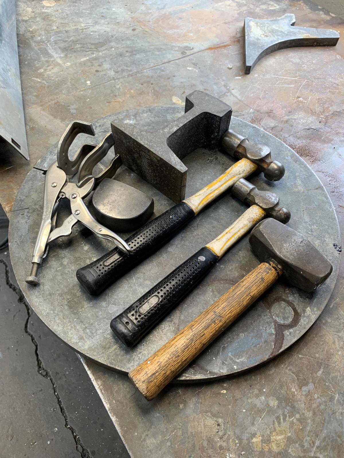

This is after the first round of hand work.
Here's the tools I used up until this point. The heavy blocking hammer was used the most, followed by the ball peins to get into the tighter spots. The welding clamps were used to make minor adjustments in the flange areas and the dollies were used to do some smaller adjustments. Regular body hammers are pretty much useless on this heavy stuff. I clamped the bumper to the heavy plate to do some planishing.

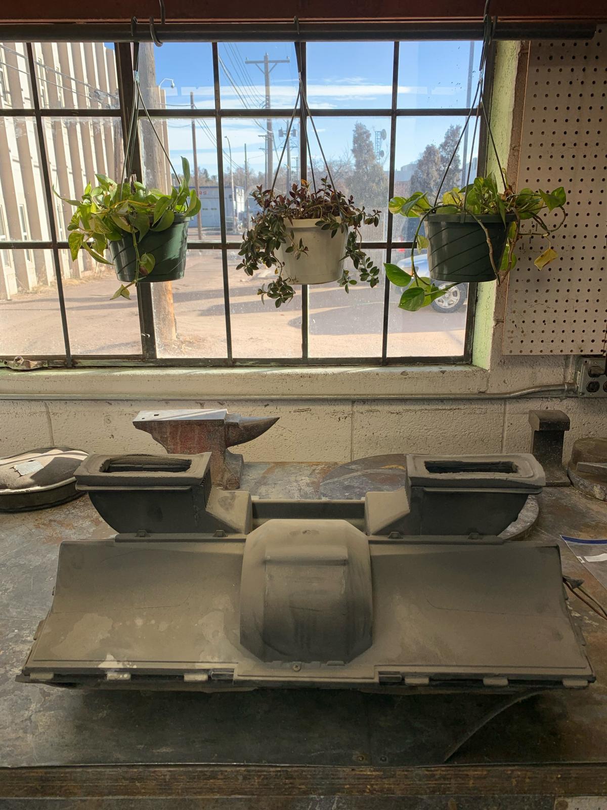

As mentioned earlier, there's still plenty to do. While I take a break on the dash, I figured it was time to address the bumpers. I want black bumpers and I was planning on buying some reproductions, but I'd rather have some OE thickness/quality units. I have a front bumper that's in decent shape and I have a pair of rubber trims, but my back bumper was pretty worked.

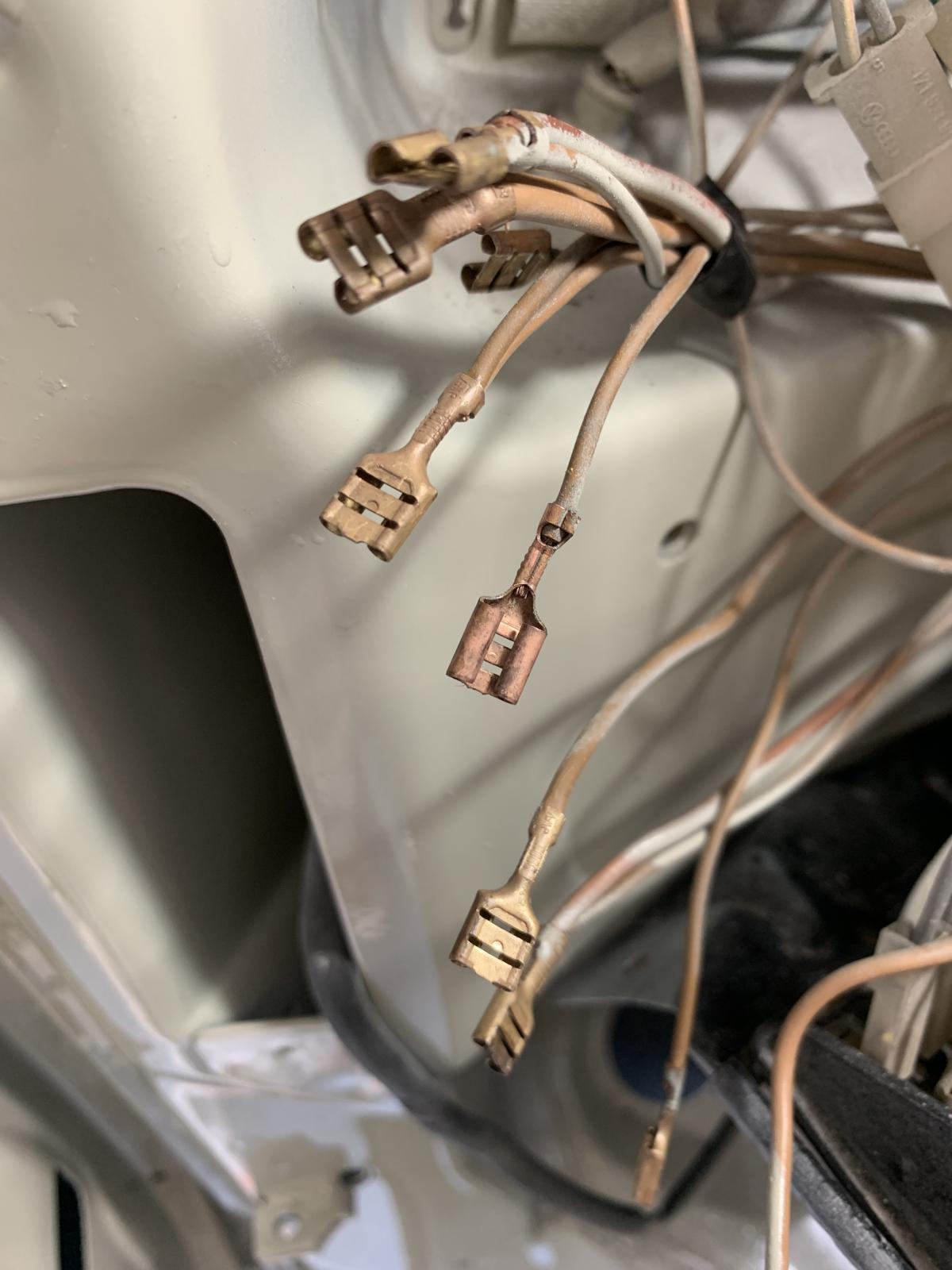

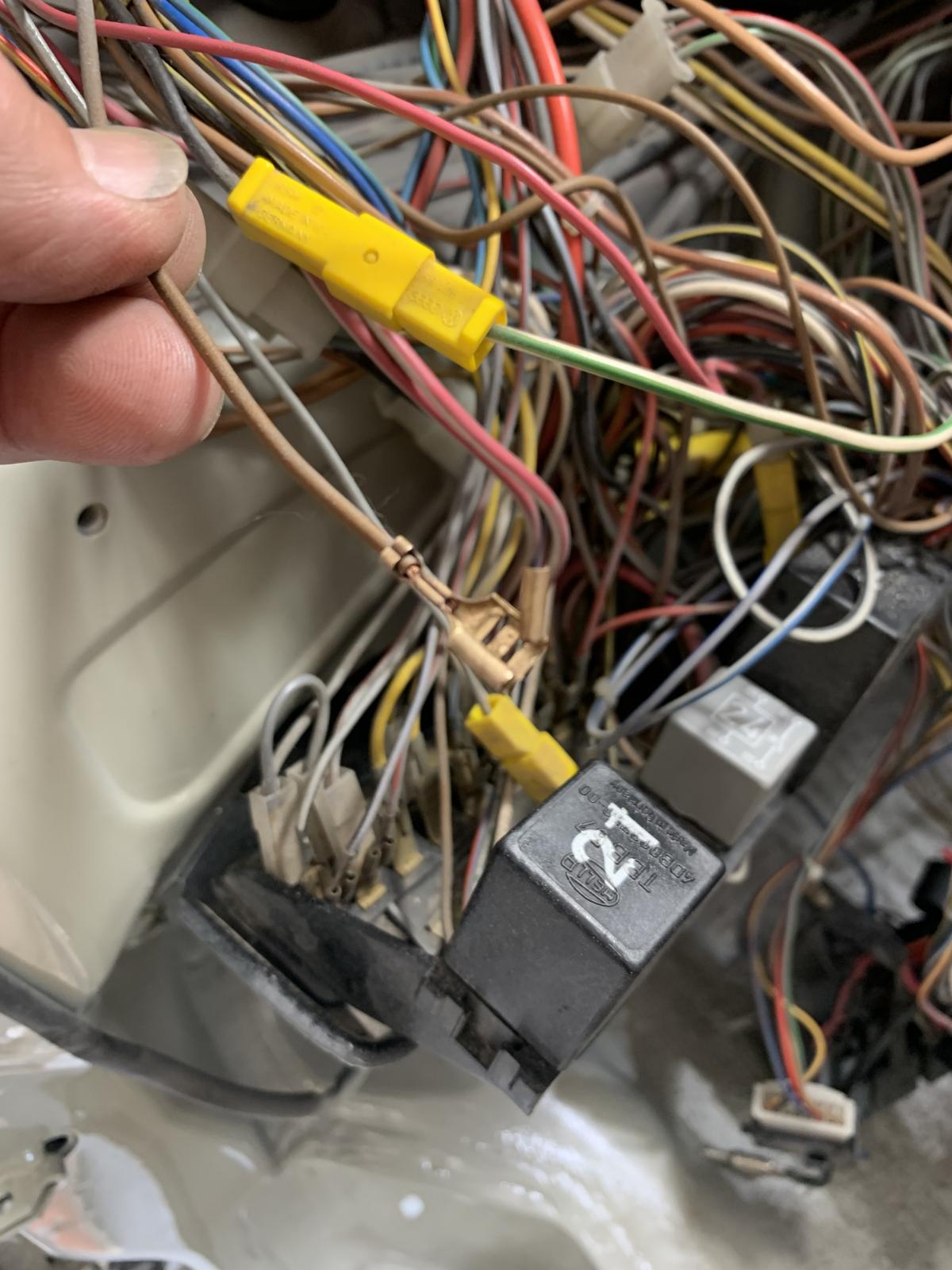

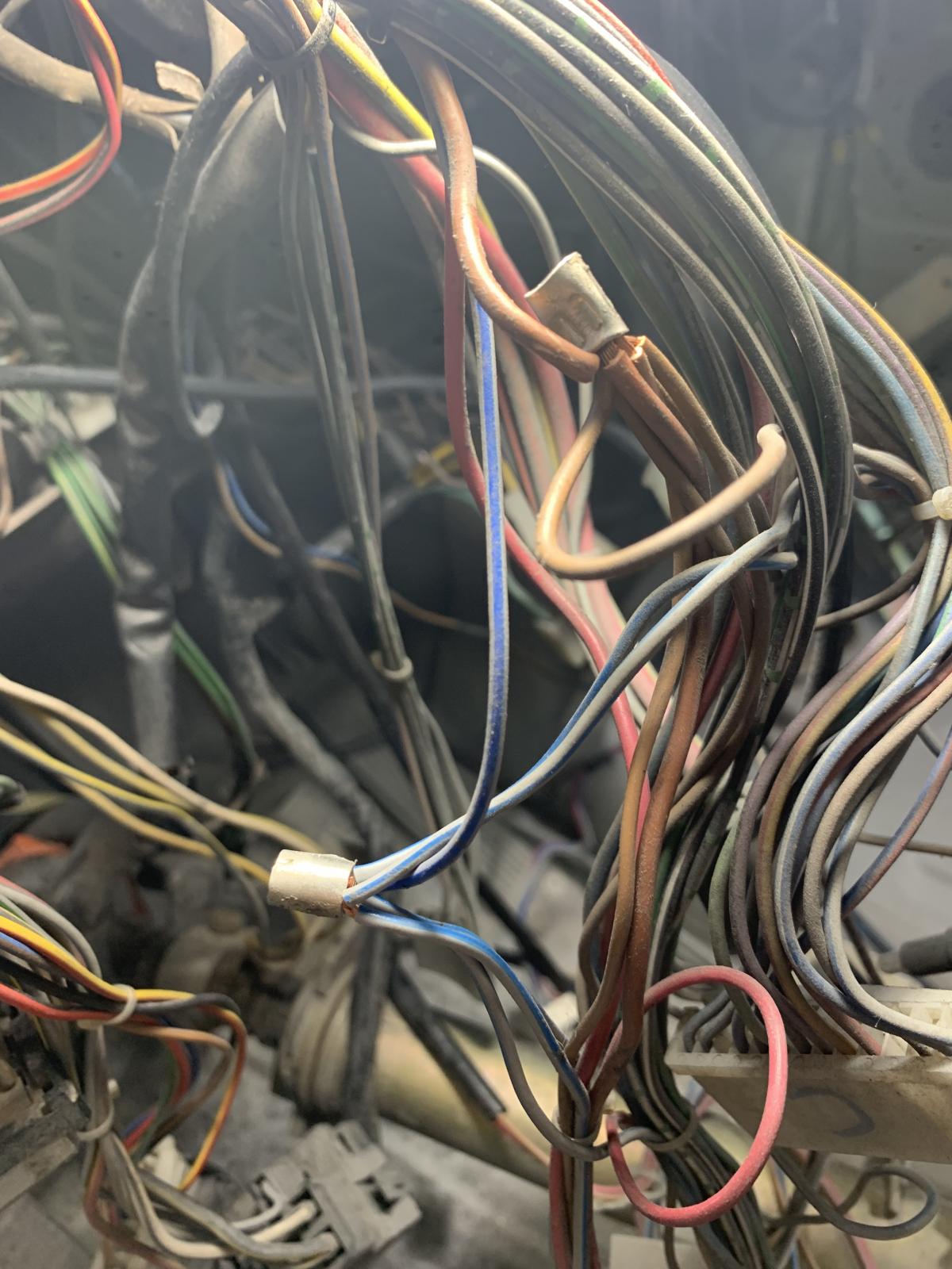

Inspected the harness and replaced a broken connector.
I noticed this brutal chopping and crimping of a group of wires. Electrical tape was unwinding from it and it looked questionable. I haven't looked at the wiring diagram, but I imagine that this was likely from the dealer installed AC. The wiring wasn't pretty, but was nice and tight so I reinsulated it and added a bit of strain relief to the wires.
Also replaced a melted down blue wire that was going to a group of three relays, likely the AC, and soldered some questionable crimps going to the master cylinder.
I think I have pretty much all under dash work completed; grounds, heater box build, control valve, lubed wipers, windshield squirters and hoses. Waiting on the antenna and then get the dash back in. I still have to install an auxiliary fuse box, but I want to get the dash in to get a better perspective on where to mount it.

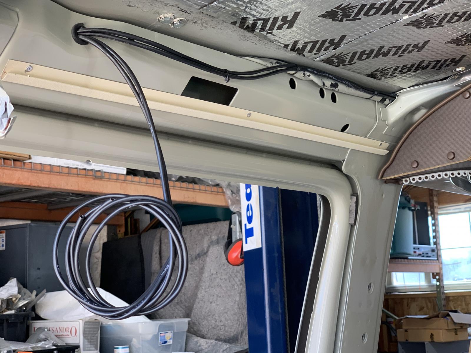

I wasn't really sure how to wire the mirror/cam, but I pulled a couple 16-2 conductors up the pillar and another pair to run to the back for speakers. If nothing else, I can use one pair as a pull wire to feed the cam cables to the dash.

markswagen wrote:
you don't need to wait on that one, it's not a difficult one to do with the roof lining in, l just did an 84 westy the other day, l put the mic for the stereo trough while l was at it, also a 10awg wire for just in case, it didn't add time to the job, and cost the customer a couple of $, better to be looking at it, that for it, IMHO.
to be sure l didn't lose the original wire part way through, l soldered a draw wire to one, it wouldn't have come off either way l don't think.
Bulli Klinik wrote:
I'm chomping at the bit to get the forward headliner installed, but I'm waiting on a back-up camera/mirror unit to arrive so that I can wire everyting prior to assembly.
I have so many other things to do on this Bus that I diverted my attention elsewhere. I also didn't realize how buried the antenna was, so I'm currently waiting on that and some roof hardware, screws, etc... before I install the dash and forward headliner. Thanks for insight, though.
As a side note, I ordered the Wolfbox, 12' unit from Amazon. It came the very next day but I realized that it was too big, so it's getting returned and I bought the 10" unit instead. I also bought a mounting arm for it, but I'm not sure that it's going to work. The plastic on my OG mirror is basically dust, so I'm going to have to figure out a way to make everything work.

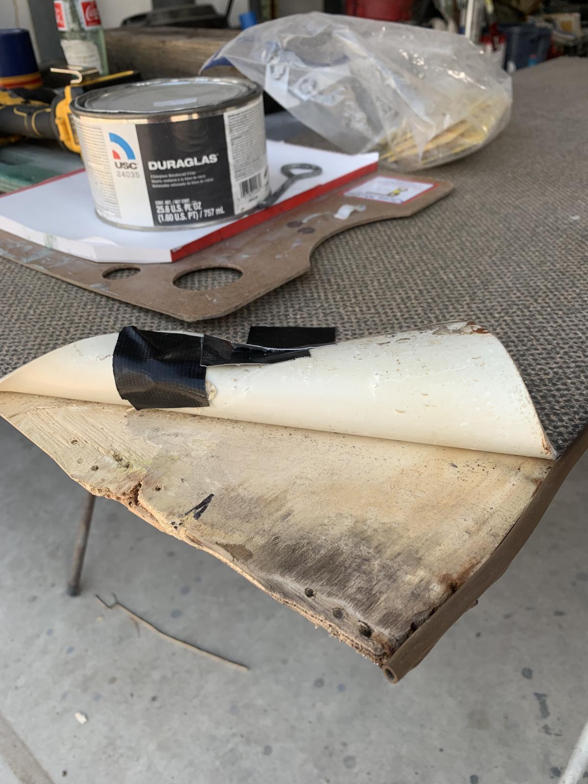

The forward, headliner panel was in decent shape with the exception of a big crack right above the driver. I know I've cracked my noggin on that panel in some of my old Buses while bouncing around off-road. Probably the same thing happened here with the PO.
I removed some of the loose plastic liner on the back, dug out the crack a bit and laminated a small piece of press board that I had around. With that secure, I re-laminated some plastic on the back side and scrubbed the panel. Glad that head shot didn't split the vinyl!

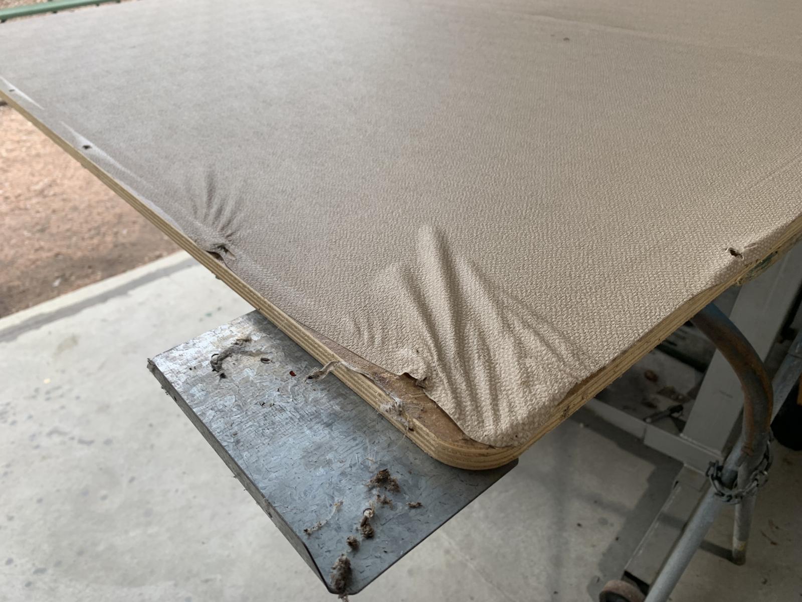

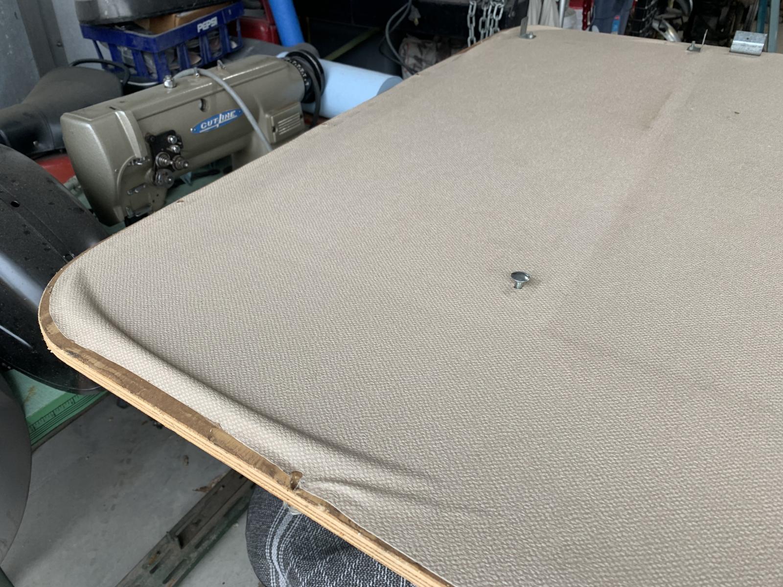

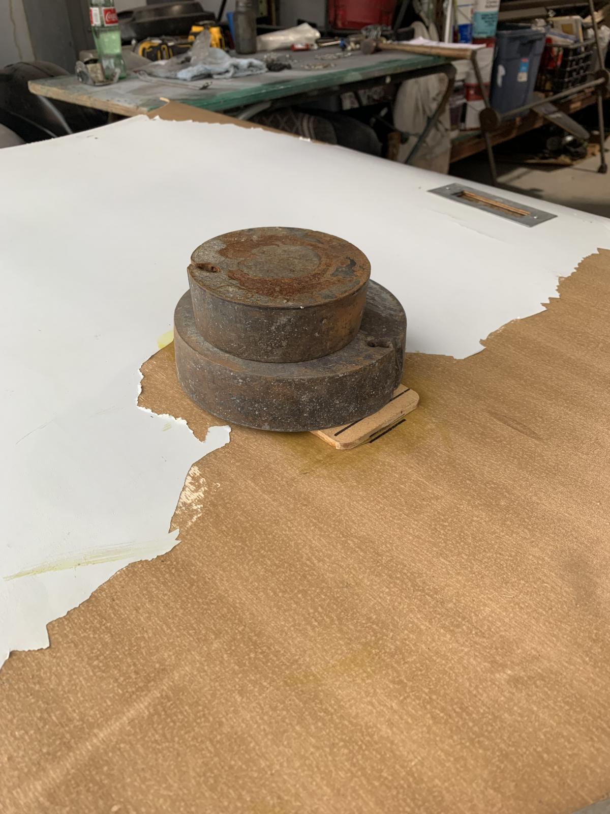

I've been trying to spend some more time on this and getting my head around the project. It's been apart and dormant for some time and I've forgotten what order some of the parts go back in. If you're doing a project like this, take a LOT of pictures and be attentive when boxing and bagging things. Much of what I'm doing now seems like two steps forward and one step back, but it's been enjoyable working on my own projects for a change and I'm in no hurry.
The vinyl on rear section of the ceiling was delaminating and shrinking. I carefully used some heat to lift the vinyl. It's delicate.
Then laid down some adhesive, re-heated it and stretched the vinyl back into shape.
Some of the bubbles on the vinyl were hard and set in their shape, but I learned that getting them good and hot, stretching the material to the outside of the panel and using a roller to push the vinyl back down gave me good results. A lot better, anyhow.

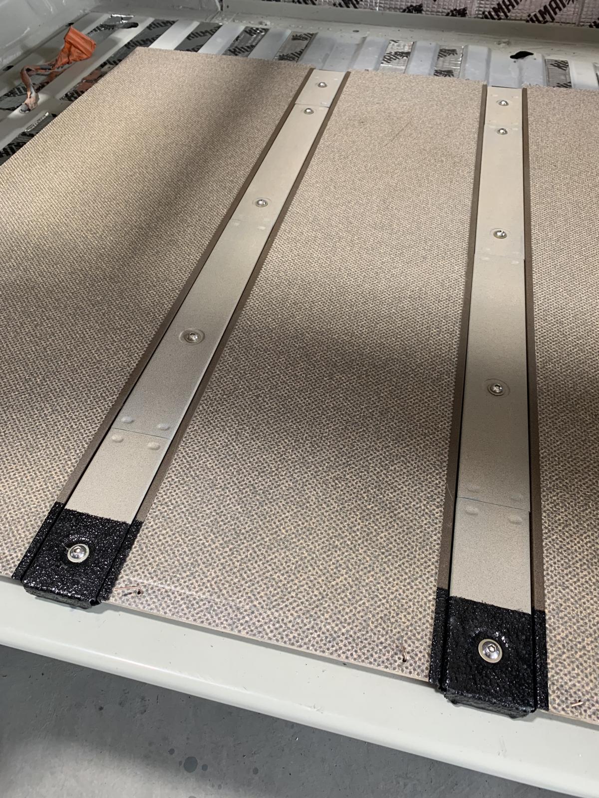

The lower portions of the floor received the Kill-mat treatment.
I painted the ends of the rails with some Dura-liner and picked up new hardware. I still need to pick up a threshold rubber before installing the outer rails, but I'm happy with it.

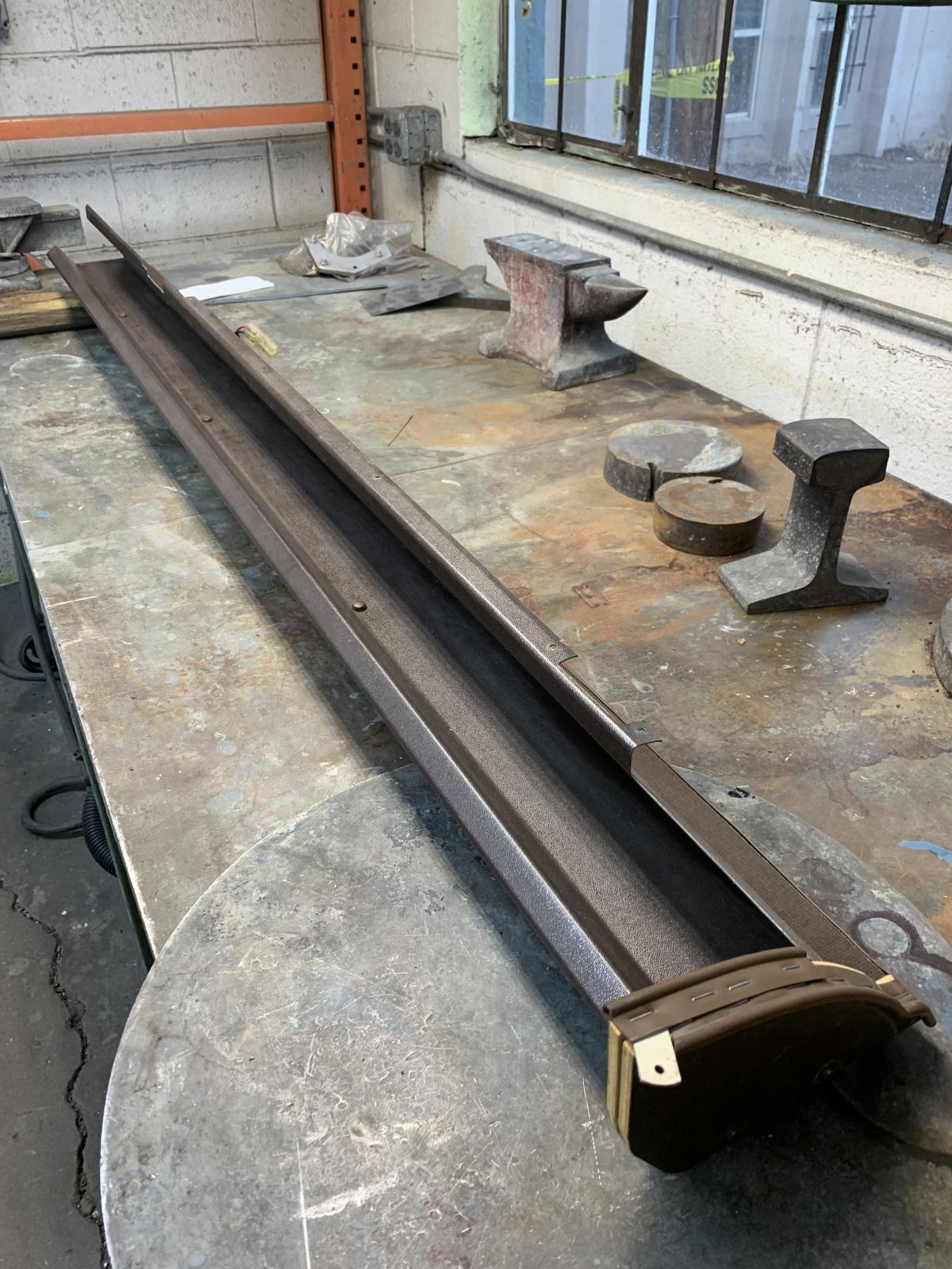

I prepped all the rails and shot them in a coat of epoxy, followed by some rattle can action. The original paint was some strange, plasticized product which wanted to lift in sheets, but I managed to get it feathered out pretty well.
There was little bit of wood delamination/deterioration happening in the sub-floor, so I repaired it with fiber reinforced filler. This stuff is tough as nails.
Got that feathered out and re-laminated the vinyl with some Landau top adhesive.

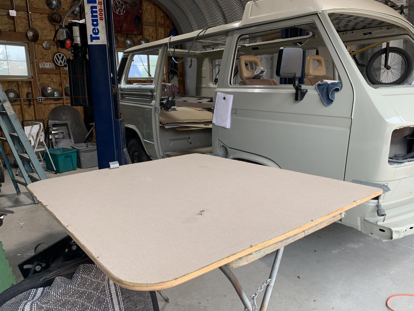

I thought that I had all the pieces, but it turns out I was missing a single panel and two of the mounting tabs. I knocked out a panel with some basic chasing over this weld bead and a washer for the center depression.
Did the final folds in the brake.
Then I made the two retainer tabs for the end of the channels.

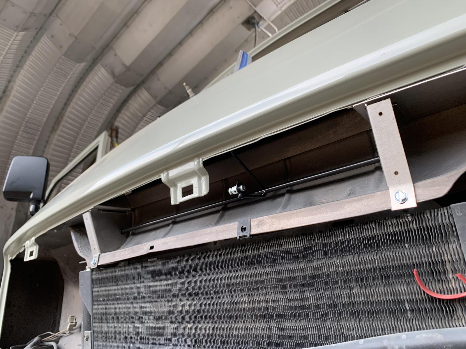

Been making a bit of progress on the Van. Heater box is installed. I put in the Vanistan heater control valve and got started on the Vanistan fresh air flap.
I wanted to re-make the floor in the back to eliminate the seat tracks, but I couldn't seem to find a suitable match to the original material. I ordered some samples from here: https://www.marinevinylfabric.com/products/marine-...&_ss=r Though they looked promising, they had a pretty heavy texture that I didn't really want. After spending way too much time trying to come up with a solution, I just decided to restore what I had. Stock never goes out of style, right?
