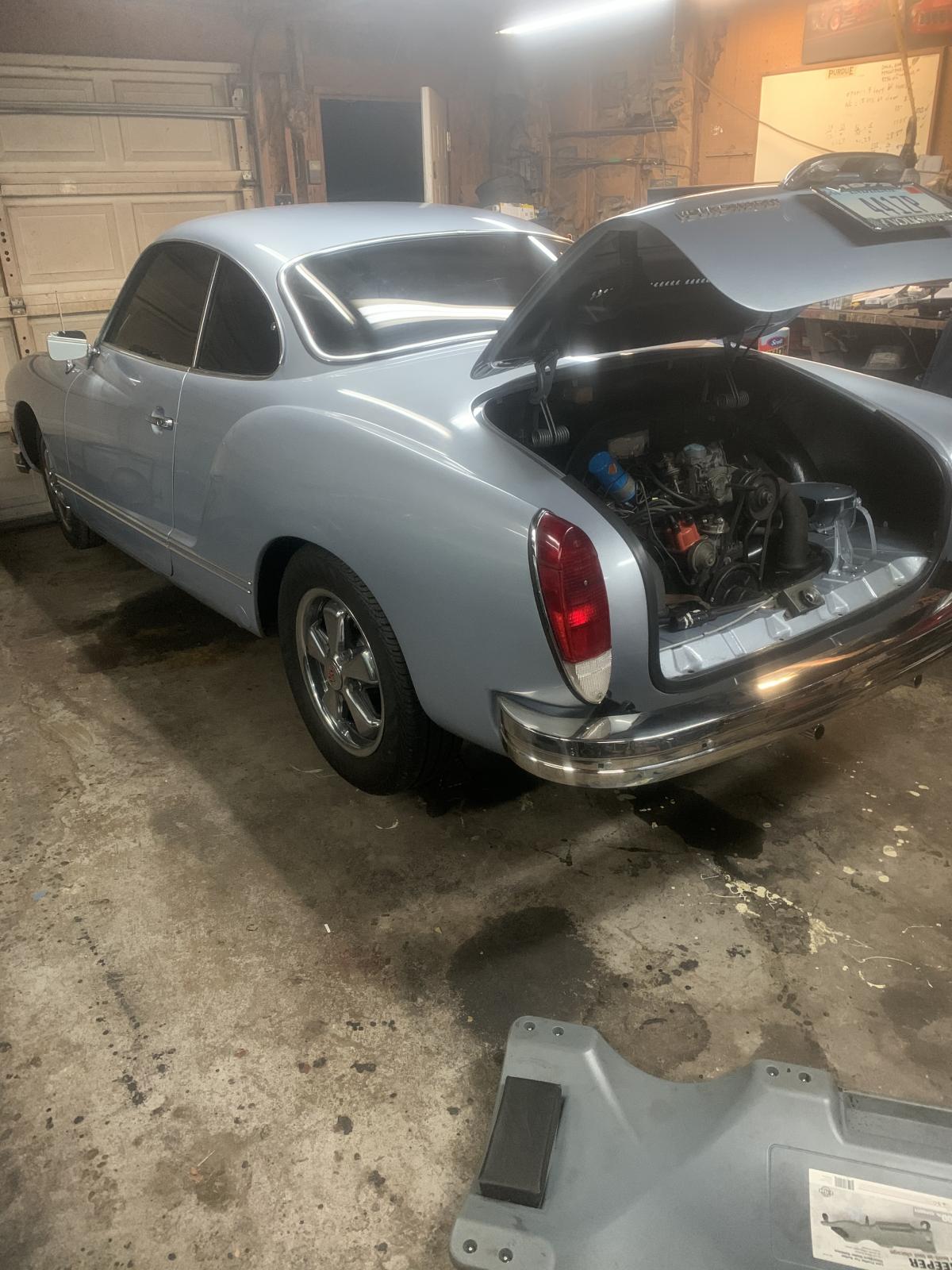

The lift worked great. Really helped due to the added weight of the aluminum case.
I’ve had it running for a couple months, it pulls really strong and is a blast to drive. I’m looking to install an aux. oil cooler cause with the full Hoover mod.’s and aluminum case the oil temp can get up to 240 pretty quick, heads stay nice and cool though.

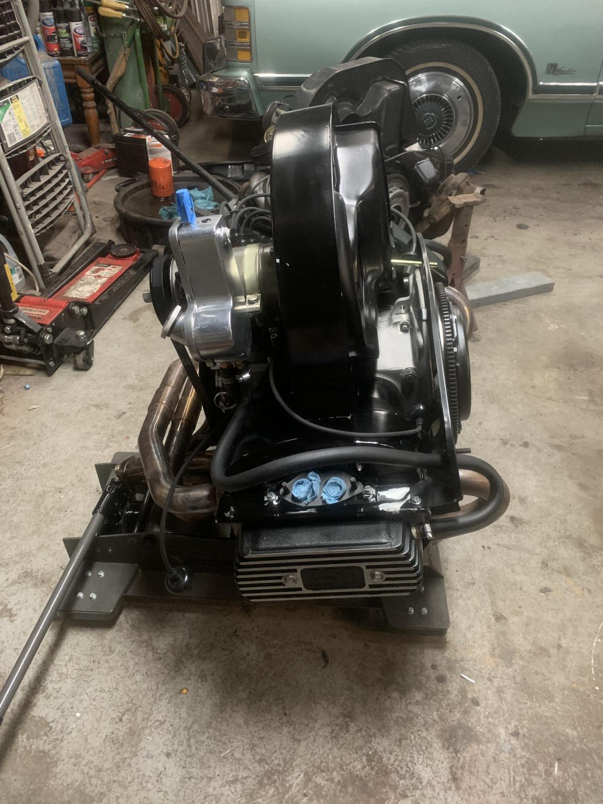

Oh wait, evidently I took another pic. I like being able to controllably tilt the engine, just hope it tilts enough.

Got the new Harbor freight trans. Jack hooked up and secured, I think it might be an improvement. In the mean time installed a sensorconnection cht lead, and modified the bodywork for the wider motor. Only picture I took...

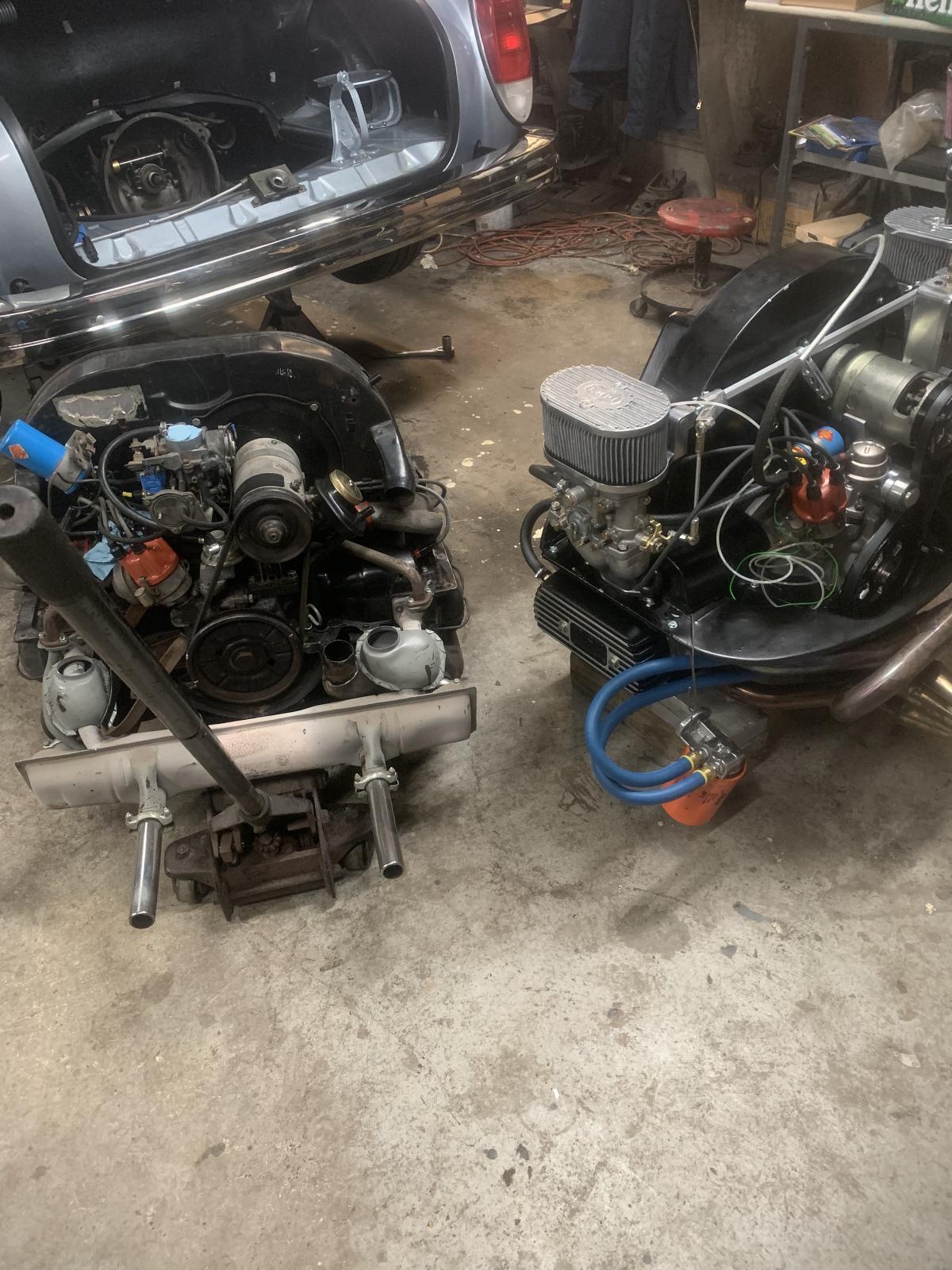

I figured I’d update my build for posterity’s sake. I finally got my 2387 built after 2 years of dealing with silliness.
Finally took the stocker out
The new engine is quite a bit heavier with the aluminum case. But I bought a transmission jack that I hope helps make r&r a little less straining as I imagine it’ll have to be removed several times to get things right. We’ll see.

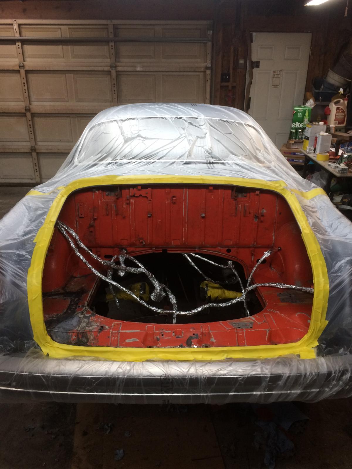

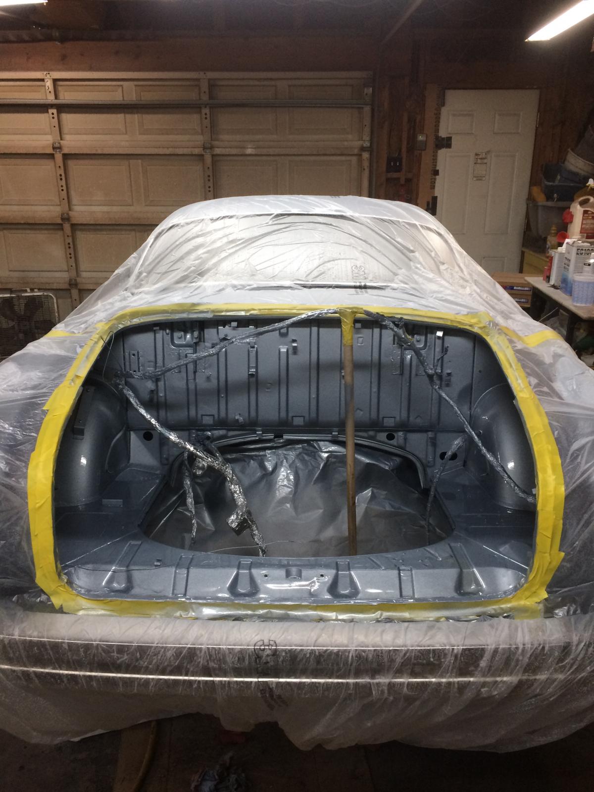

PostPosted: Mon Mar 04, 2019 10:15 pm    Post subject: Re: 1972 Internet buy Reply with quote
My phone keeps screwing up, so I’m not gonna try and type any more commentary, here’s pic.’s

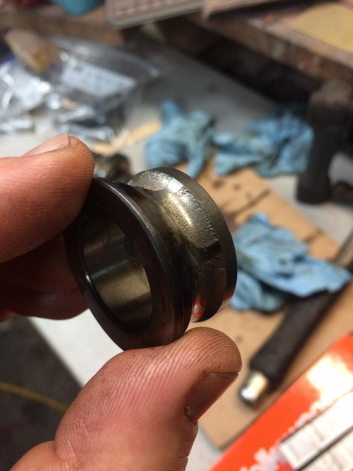

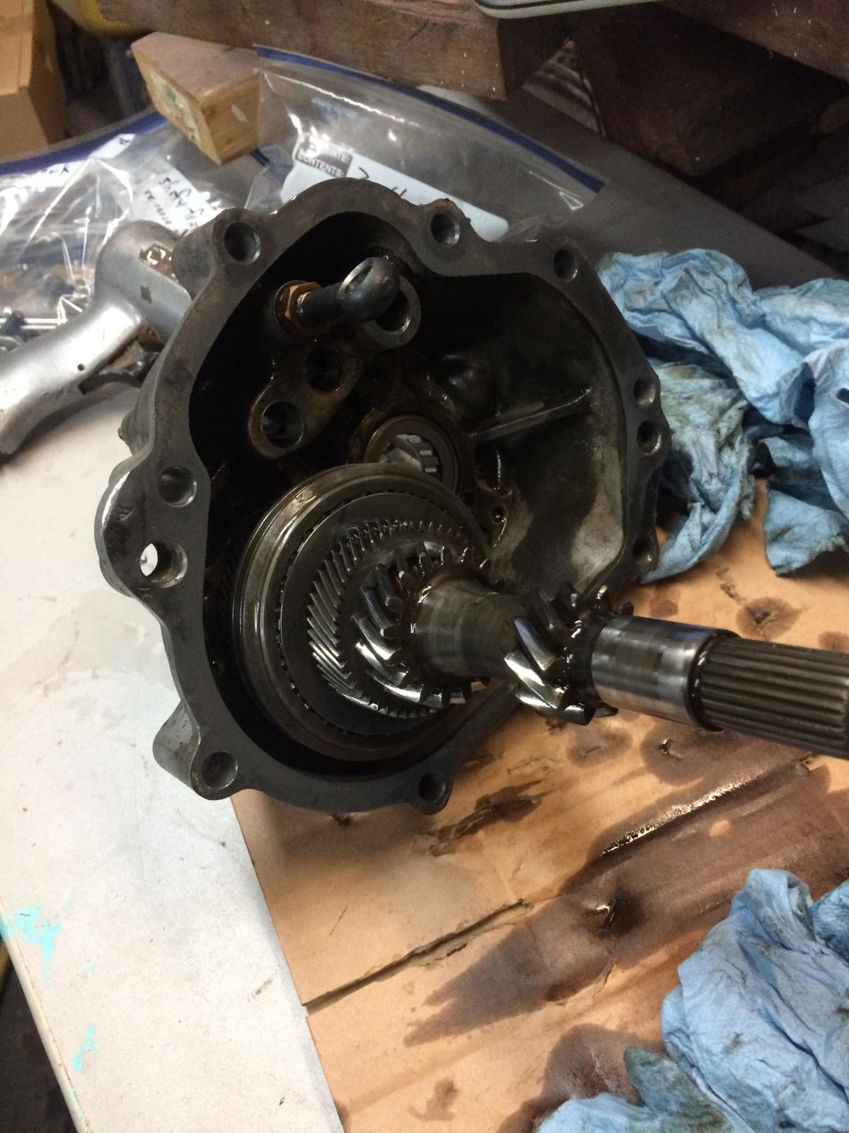

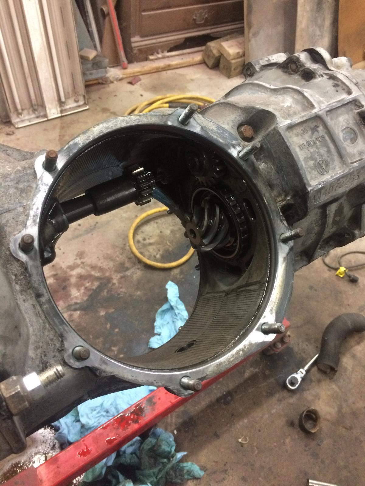

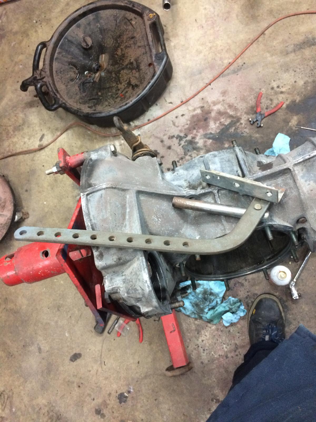

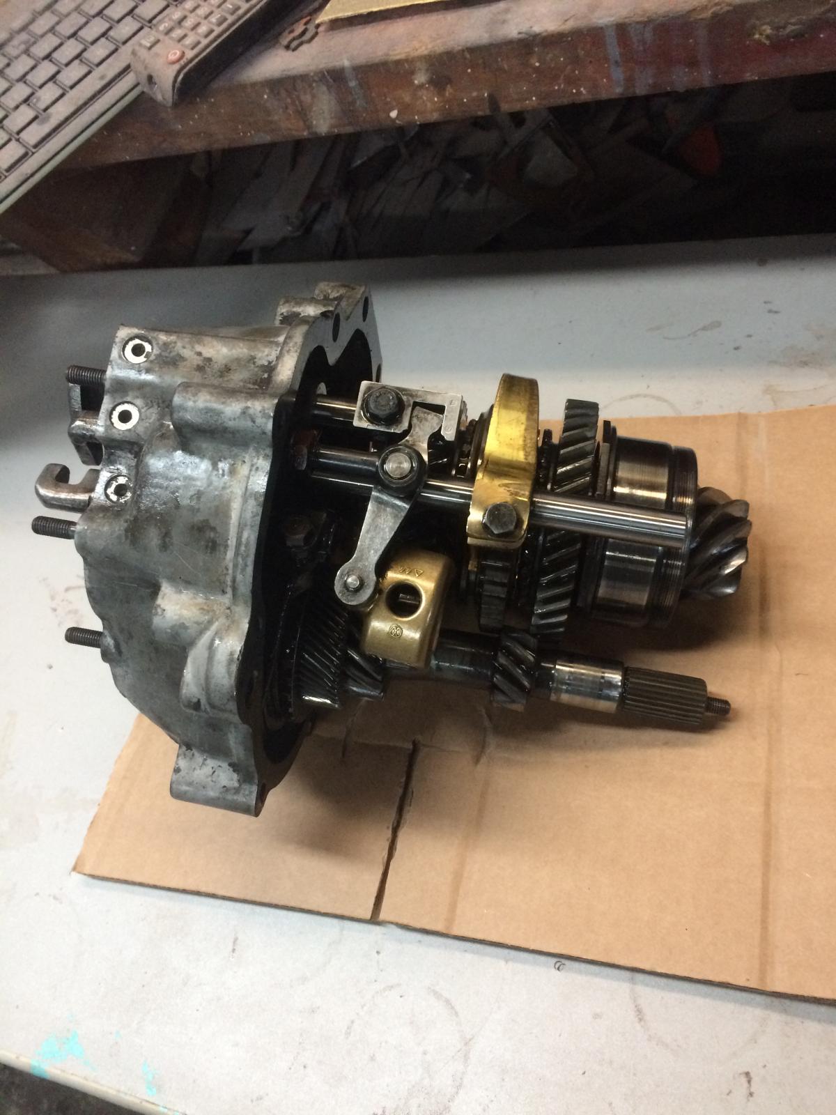

My iPhone isn’t letting me organize photos correctly, so I’ll just post pictures no telling what order they’ll end up in. I made a tool out of garage door parts to press out the pinion. Then disassembled the shafts from the housing. The only bearing that didn’t feel right was the mainshaft bearing

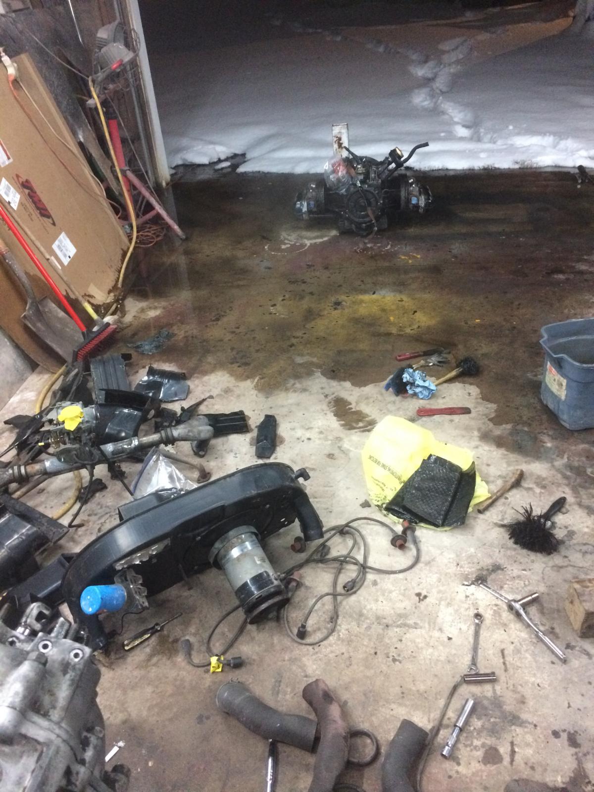

Degreasing parts in Indiana

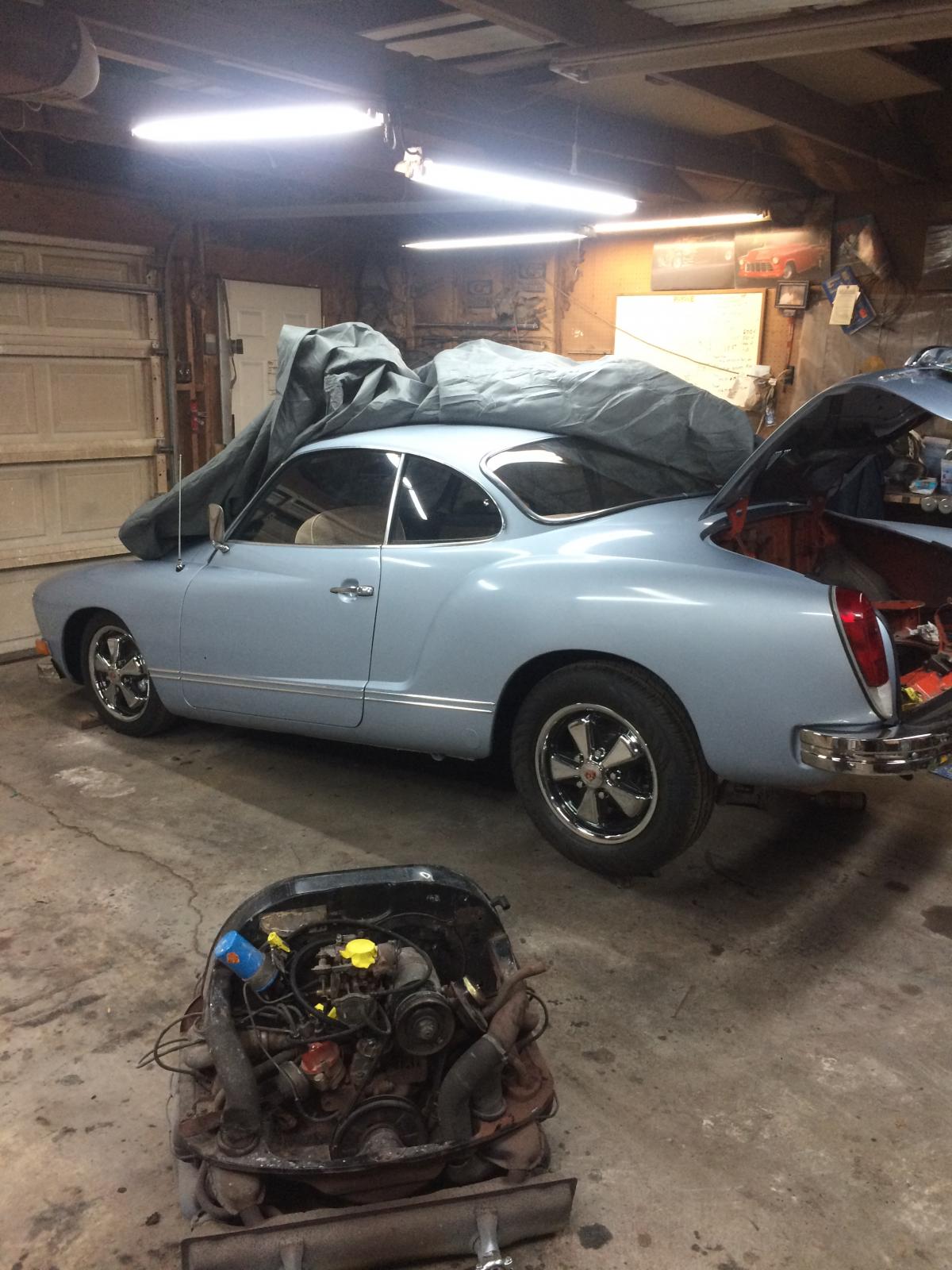

So much for an empty garage bay 🙄
My plan is to just degrease and replace gaskets/exhaust
And address the annoying trans. Whine, just waiting on a pinion nut tool

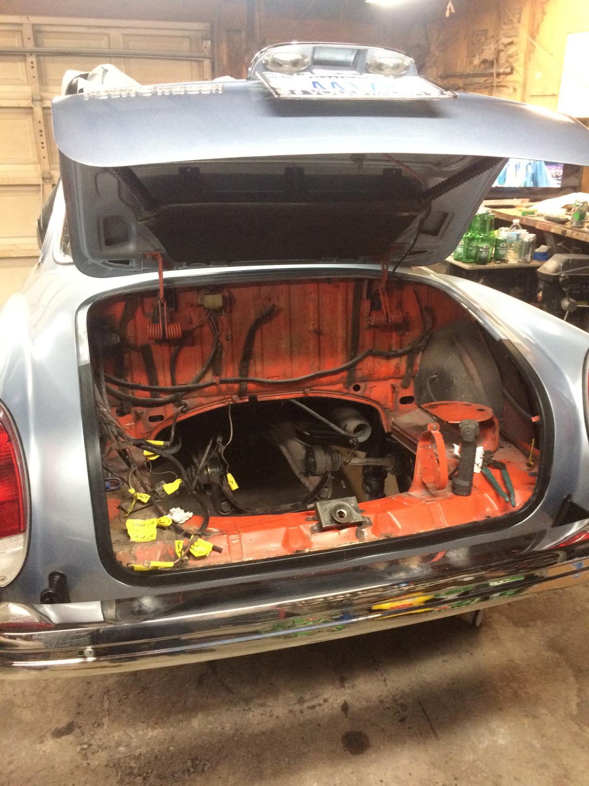

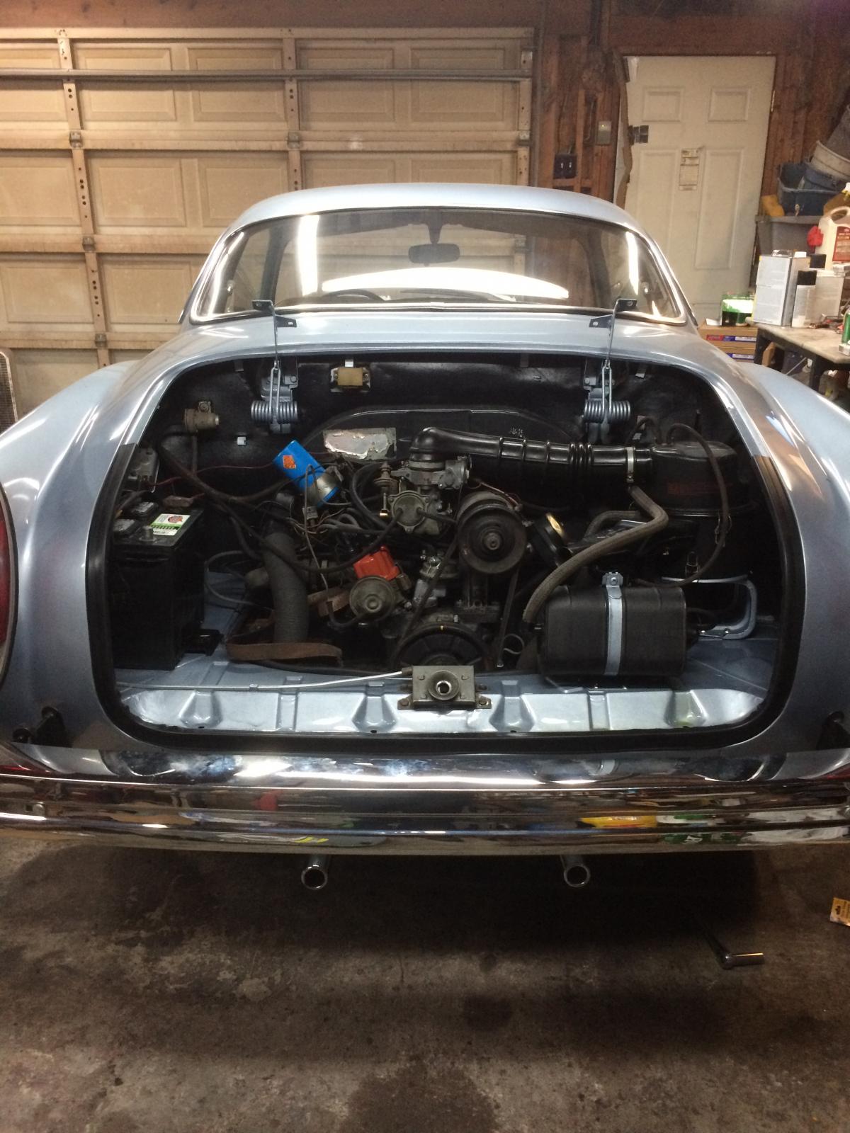

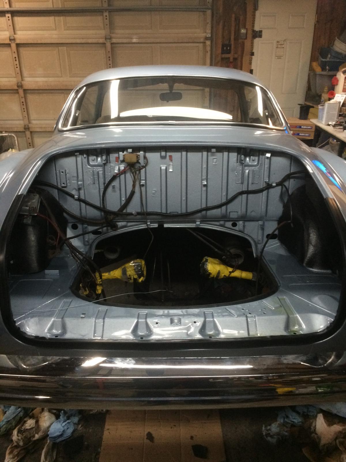

Been working on pulling the drivetrain. Figured I’d address the engine compartment paint, tidy up the engine, and need a new transmission, but i might tear into this one and see what kinda trouble i can get into. It’s got a whine but shifts good.
