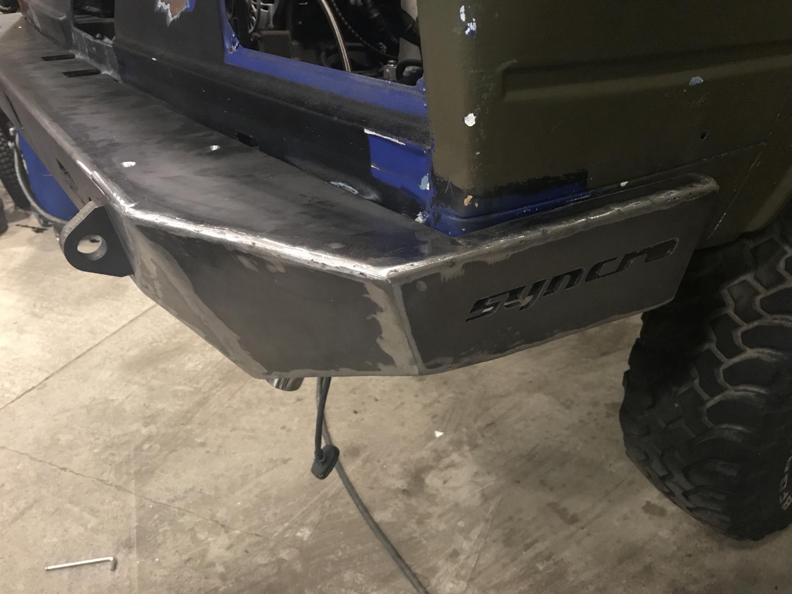

This is what I built out of 2", 1/4" wall steel. It was originally intended to go under a factory bumper, but I liked how it looked so I added the side extensions and caps. The clevis mounts are 1" thick and use the two factory bolt locations, while 3/8" strap extends from there to the third hole. Heavy and overkill yes, but shopping at the steel yard remanent rack keeps the costs down substantially. I have about 100 bucks into it and have no doubts about it's strength.

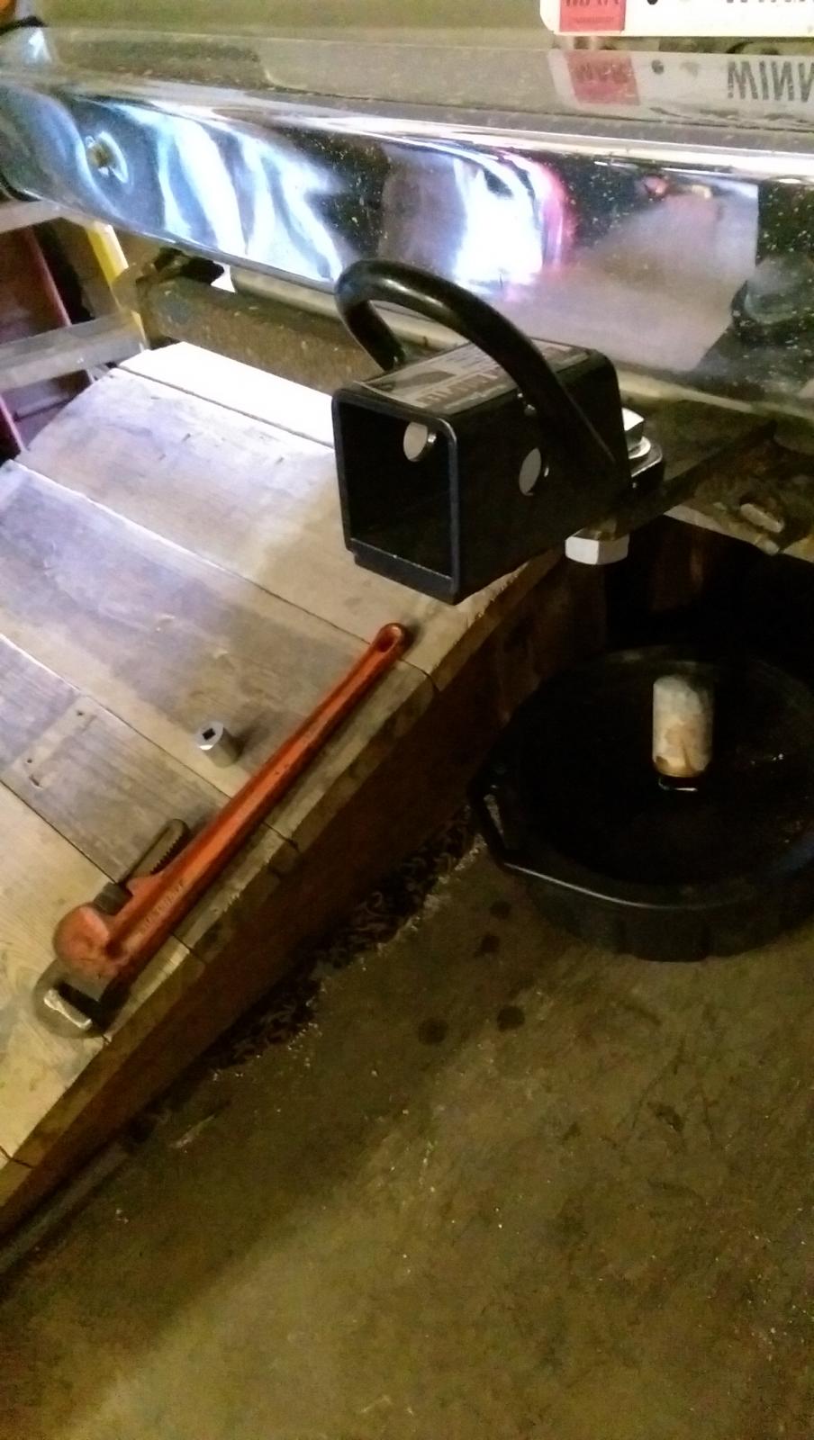

That add-on box to the stock bar works for me... I don't pull a trailer much tho.
Bike rack bounces a little in the rear view mirror when I have bikes on it... I've come up with a bit of a sling that I attach to the T ends going to the top of the hatch, to keep the bouncing from alarming me too much.
Also, you can flip it over and put the Ball back on, like this:

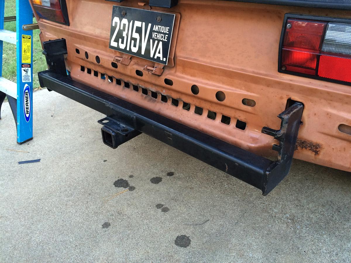

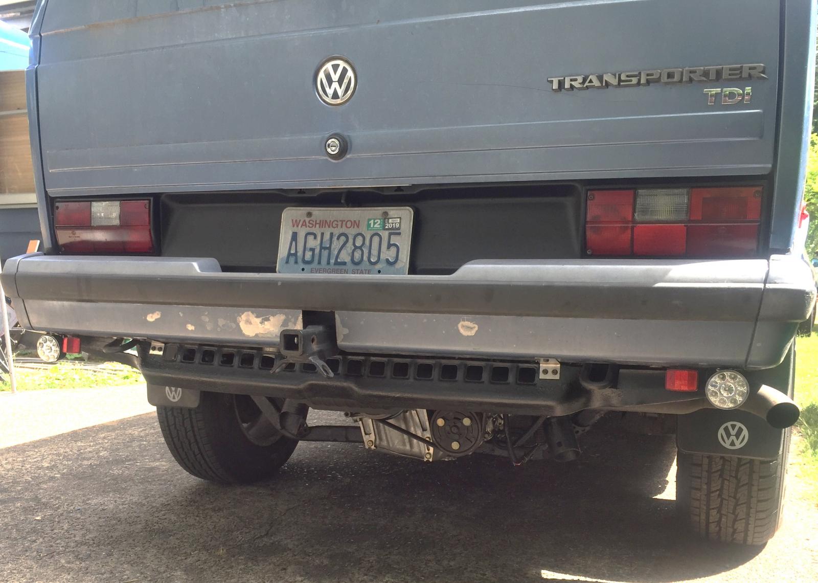

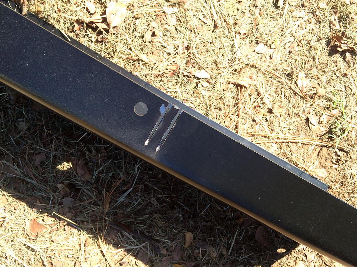

Here are some pics of the hitch Dennis Haynes used to sell (maybe he still does??). First is from the samba image gallery, the rest are pics of the hitch that came with my van.
Two slots need to be cut in the stock bumper so it fits over the vertical supports:
Hope this helps!
