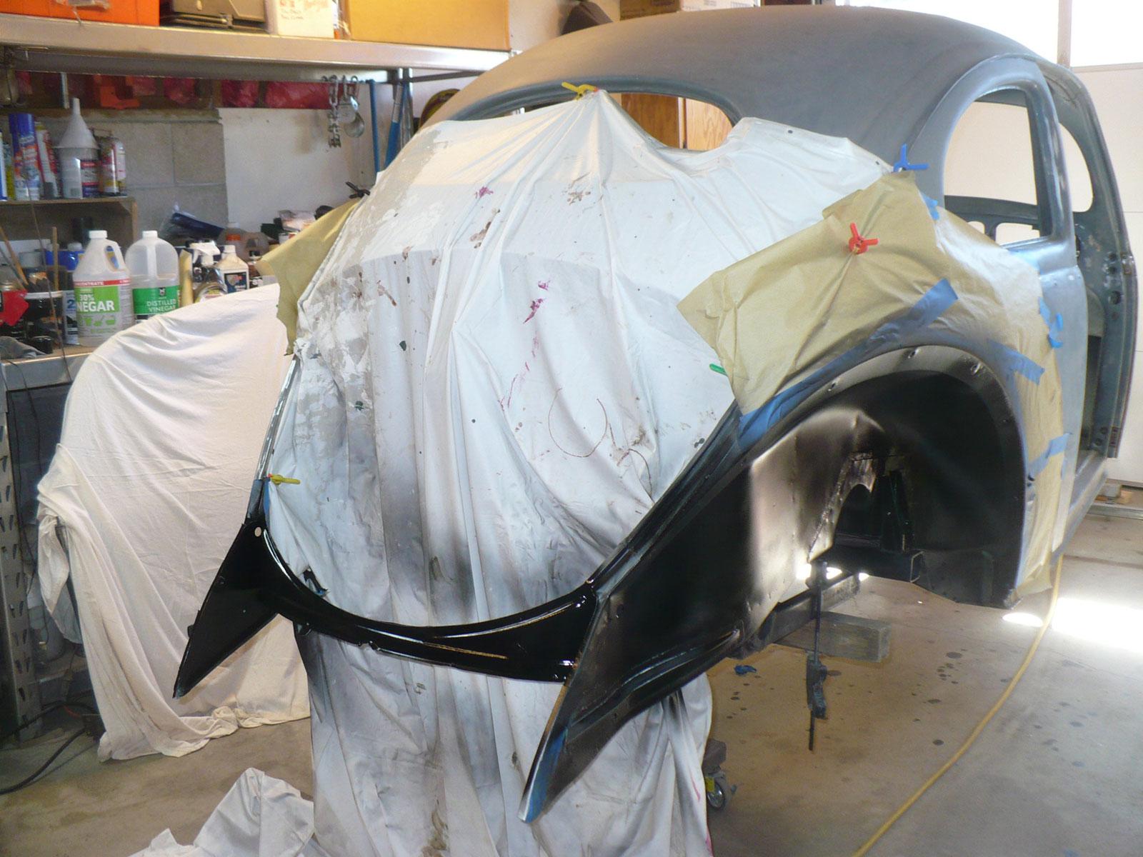

PostPosted: Fri Oct 25, 2024 11:47 am    Post subject: Re: The 'Ol 55 Reply with quote

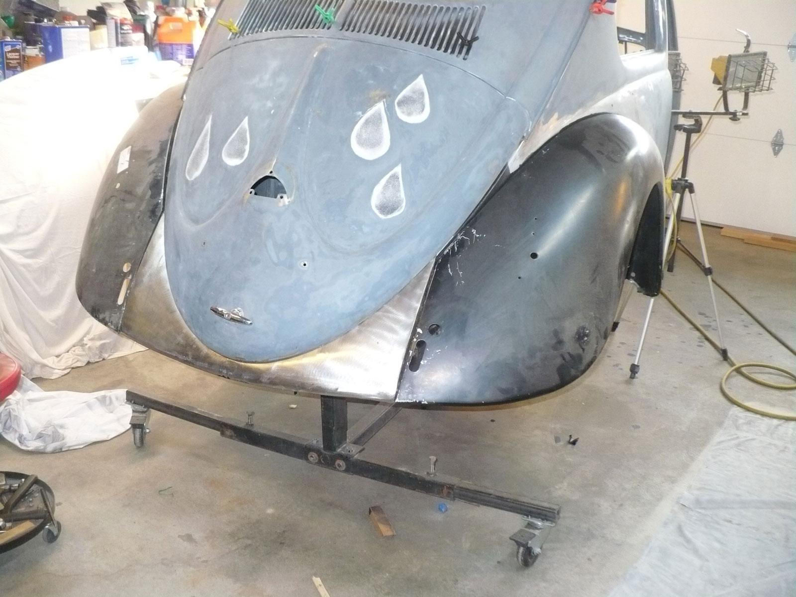

I got the rear apron primed in epoxy.
and moved the rear engine stand/rotisserie out to the bumper mounts. Now I can get everything prepped for primer/sealer on the bottom of the car.
I can now see a few places that'll need attention, most notably the nose under the spare tire well is pretty beat and mis-shapen and has a few popped spot welds. I'll try to remember to have a camera handy when I get to these next bits.
The rest just looks like clean up, prep and spray. My challenge at this point is keeping the shop warm enough to spray and cure the epoxy.
28 degrees when I got up this morning. Beautiful fall weather.

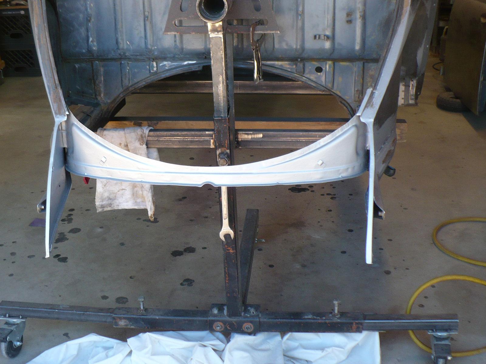

PostPosted: Tue Oct 01, 2024 1:46 pm    Post subject: Re: The 'Ol 55 Reply with quote
Serious props to all the build threads out there that keep things up to date...Figuring out how I'm doing what's next overrides the documenting of what's going on... I get caught up in the scenery and forget to document the road trip. Summer has come and gone. October already. Where'd 2024 go? We've still got some beautiful fall days happening and the nights are getting nice and cozy.
I've finished all the necessary prep on the rear apron, rear fender wells and valance areas. Fixed all the little pin holes, welded up a few new spots needing some help, pounded out what need attention and scrubbed everything up for paint.
All the while it was a summer of classroom work, reading everything I could get my hands on regarding the successful application of epoxy primer.
Like everything else there's a learning curve that's been pretty but I finally got the gumption to jump in with both feet. Painting 101. I moved from the paint classroom to the paint shop (very loose description of the place where I'm applying the product).I'm a sprayer at best at this point but everything is moving in a productive direction. Mixing, spraying, fixing the low quality results of my lesson subjects (running board, rear apron inner, rear wheel wells) and re-spraying. Learning the doing by applying what I've read.
I got the back side of the valance as clean as possible and sealed it up with MasterSeries.
Then I sprayed the back end of the car with a couple of coats of epoxy primer.
And a couple of coats of epoxy primer on the backside of the apron I got from Larry.
Fitted and tacked the apron and then did a quick fit up of the fenders and rear deck lid. After some pushing and pulling and making everything line up satisfactorily I got the apron welded back in place on the car.
Everything fits up right.
I'm gonna move the rear end of the rotisserie back to the bumper brackets to better facilitate tipping the body up to access/prep and epoxy the bottom of the car.

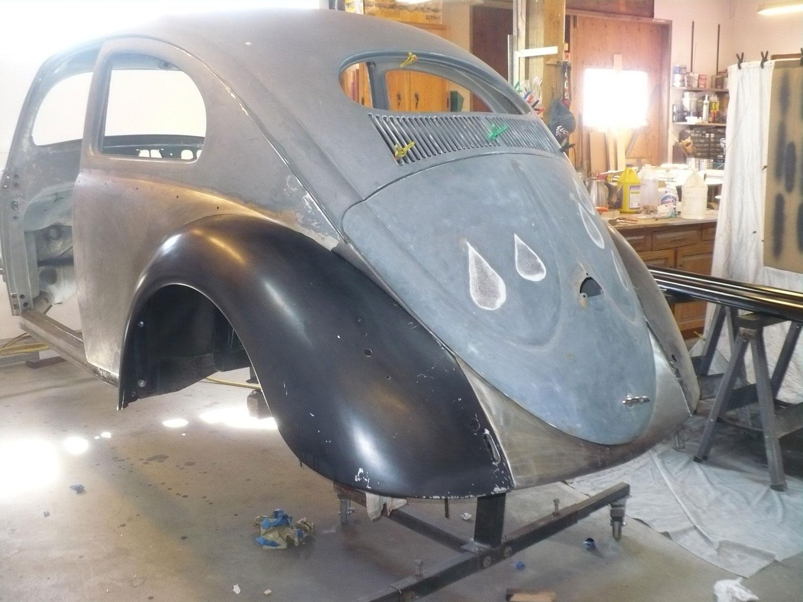

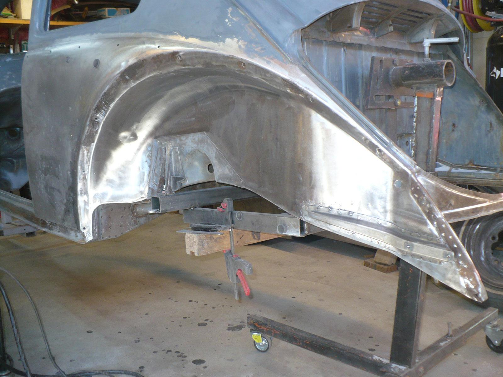

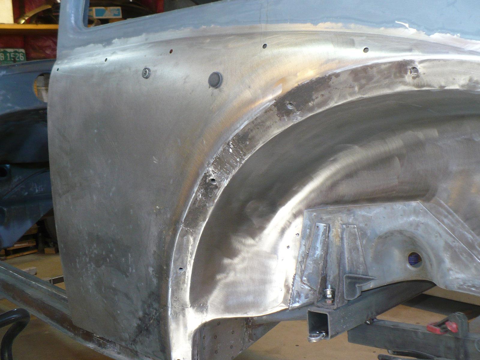

tehillah1
Joined: August 23, 2009
Posts: 308
Location: Colorado
tehillah1 is offline

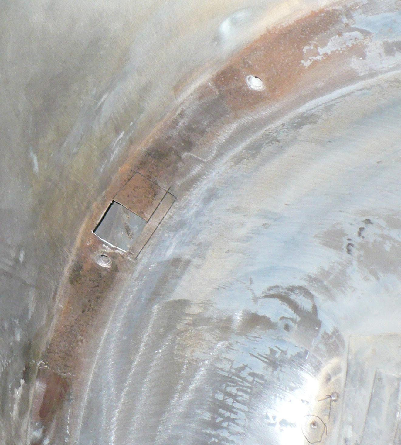

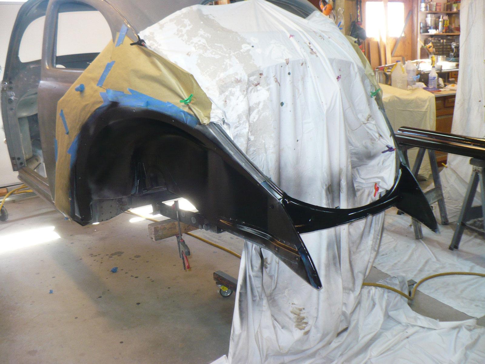

PostPosted: Thu Jun 06, 2024 7:24 am    Post subject: Re: The 'Ol 55 Reply with quote
This spot failed the icepick test...so more rusty metal to cut out and replace.
Done
Left rear wheel well ready for primer...
