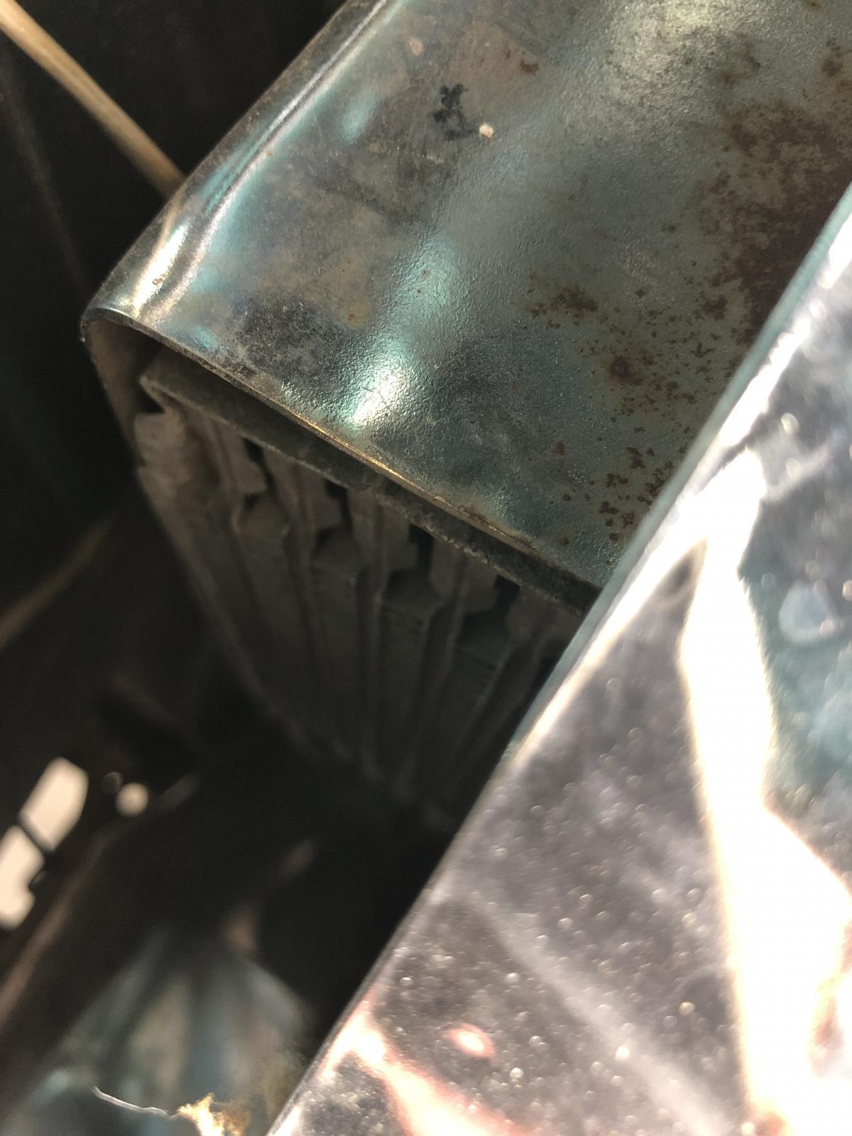

PostPosted: Thu Aug 15, 2019 9:33 am    Post subject: Re: 1974 Muffler Change-Help Please! Reply with quote
That bottom photo shows an exposed oil cooler, which means more missing tin work.
Your best bet, as others have suggested, is to remove the engine and get all the tin on it properly.
I know it seems overwhelming, but it is not terribly hard to do. We aren't trying to overwhelm you, we are all just pointing out problems that are solvable, and that will help your experience be enjoyable! It will take a little bit of work to get there, but then you'll have a bug that is dependable and fun.

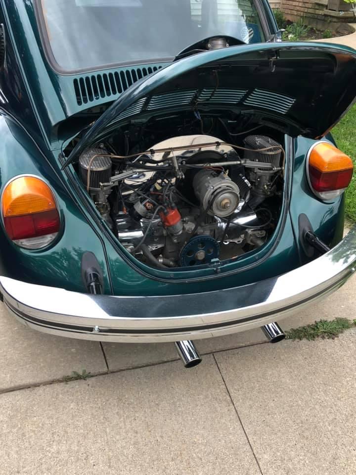

PostPosted: Wed Aug 14, 2019 7:06 pm    Post subject: Re: 1974 Muffler Change-Help Please! Reply with quote
Rome wrote:
OP, you photo'd the right side of the engine and shroud. The oil cooler and cover tin are on the LEFT side towards the front of the car. Just stand at the left rear fender and aim inwards, mirror image of what you did on this last set of photos.
Ok not sure if these pictures did the job or not.
I also think I have bigger issues then the Air Tin and muffler swap. Took her for drive tonight and lots of sputtering when accelerating in all gears with gassy smelling exhaust after the sputters at times. It’s much cooler tonight here then any time I’ve driven it if that matters at all.
For more reference, I found out the seller restored the body but the engine was in the car when he got it.

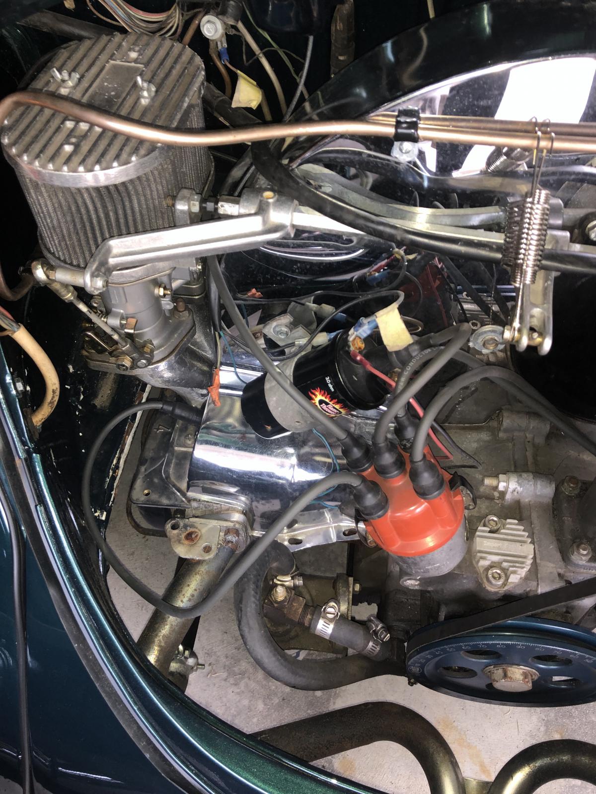

PostPosted: Wed Aug 14, 2019 8:18 am    Post subject: Re: 1974 Muffler Change-Help Please! Reply with quote
AlmostHeavenWV_VW wrote:
imsjry wrote:
73SlowBug wrote:
Your aftermarket exhaust has heat risers, but they aren't blocked off. I think that's part of your noise problem. I have the same muffler, and it is pretty loud, but yours isn't completely "muffled" with those ports open. Block off those ports and see if it helps the noise at all.
That's something easy to try first.
Thanks! So sorry to be dumb, but where do you see the heat risers not blocked off?
In this picture, just left of the large black hose. See the silver 'plate' which has two holes through it on each side with a rust colored center spot? It is connected to the silver exhaust pipe. Just to the rear(towards rear of the car) of the shiny chrome cover seen in this picture as well.
That's the heat riser. Also there is one on the other side.
heat riser block off plates:
https://www.jbugs.com/product/3447.html
Lots of times, on aftermarket headers, these risers are there but have to be drilled out to be open. It also looks as if they have been welded up. THe lack of carbon/soot suggests that these have not been drilled so there is no reason for the block off plates.

PostPosted: Wed Aug 14, 2019 7:19 am    Post subject: Re: 1974 Muffler Change-Help Please! Reply with quote
No front engine cooling tin either, or thermostat linkage, likely no thermostat or flaps. Again, your first stop should be http://awesomepowdercoat.com/. There's no avoiding this.

PostPosted: Wed Aug 14, 2019 7:04 am    Post subject: Re: 1974 Muffler Change-Help Please! Reply with quote

PostPosted: Wed Aug 14, 2019 6:13 am    Post subject: Re: 1974 Muffler Change-Help Please! Reply with quote
@Rome,
Wow thank you so much for your informative post! I did try to take some pictures aiming down the back of the cooling tin but not sure what you can tell from these. I will try to get my arm down there to feel for what you mentioned.
I think I will attempt the stock muffler i bought. Any ideas what to use to plug up the holes for the heat risers I wont be using? Or if you even have to plug them?
