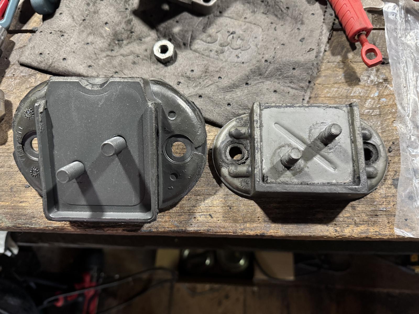

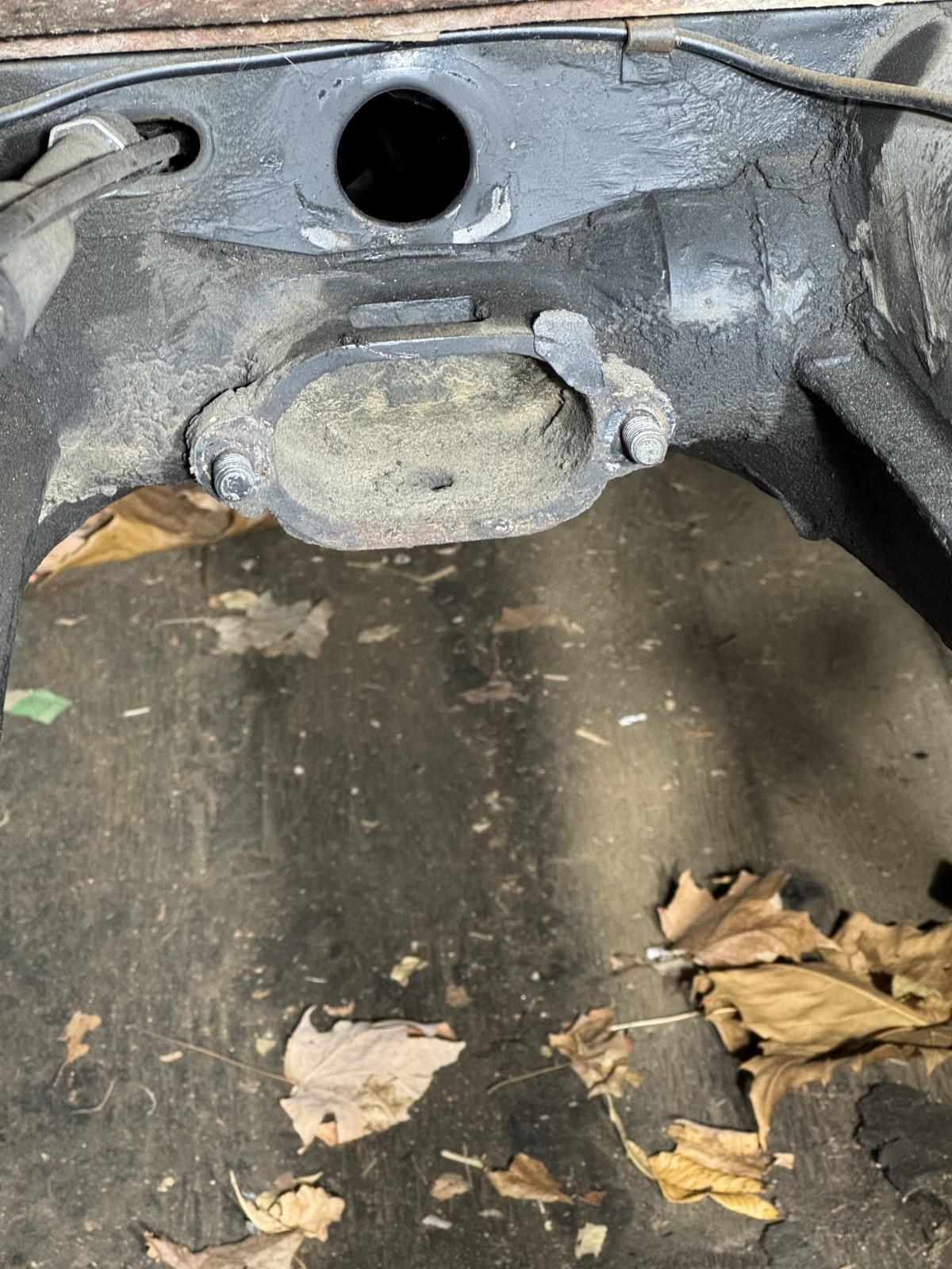

PostPosted: Wed Jul 30, 2025 7:54 am    Post subject: Re: '59 Karmann Ghia fever Reply with quote
Your car would have came with a split case trans and was converted to the later tunnel trans. You need the same style mount that was on the car (not a split case).
The new mounts suck. The rubber splits in weeks in some cases. I take my old mount, drill a hole through them and run a 10mm acros the flats bolt and nut through them. Never have a problem after that.
Other guys have started running mid mounts because the problem is so ubiquitous.

PostPosted: Tue Jul 29, 2025 12:51 pm    Post subject: Re: '59 Karmann Ghia fever Reply with quote
The mounts look nearly the same as far as the studs and holes in the bracket goes.
The overall shape of the new bracket looks larger than the original.
I would think the new one could be used.
Maybe mount each bracket to the frame and take measurements to compare the overall depth of each.
