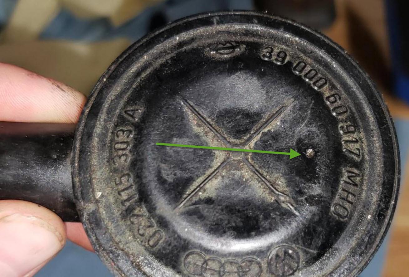

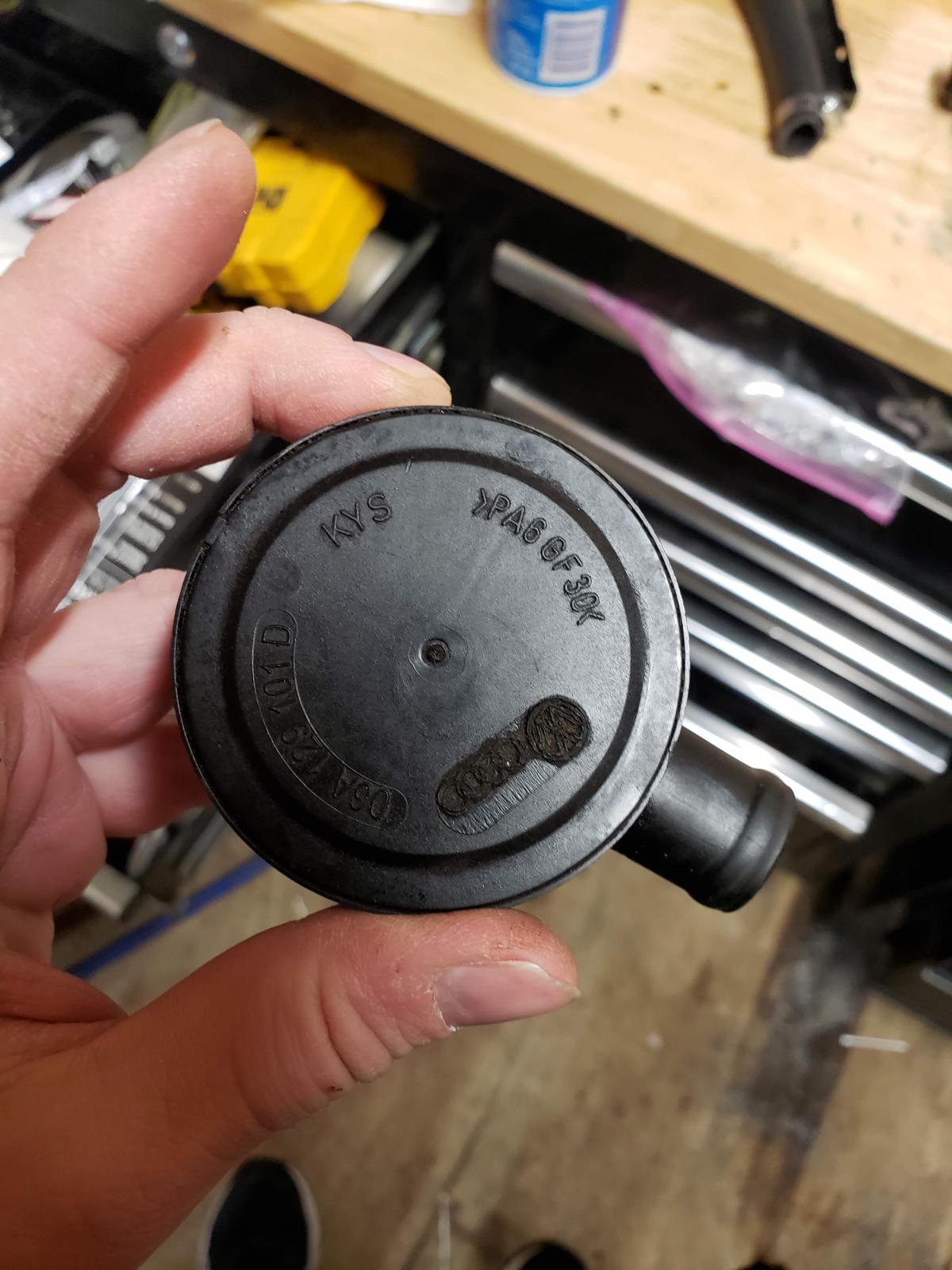

baumer99 wrote:
Hope this helps, I will report back when I get around to testing them out.

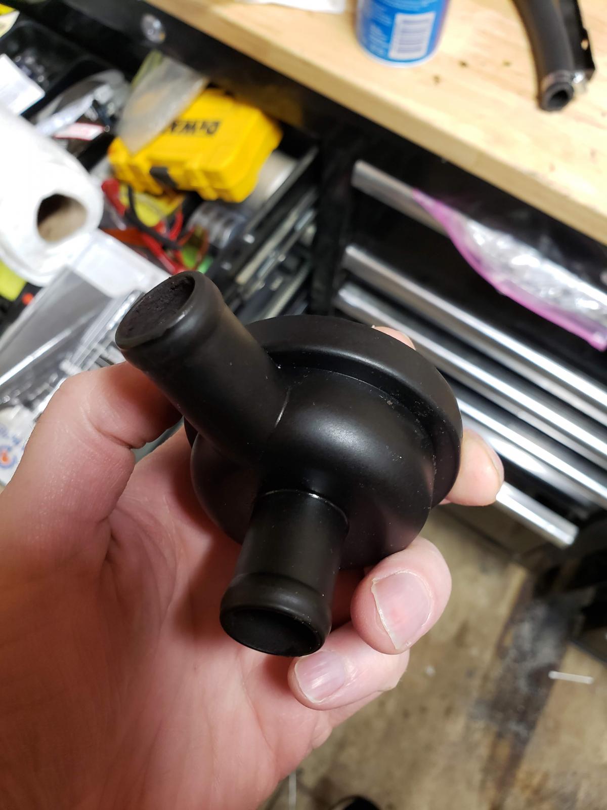

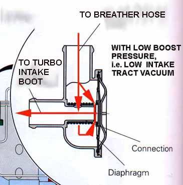

Checking in to see if anyone has been able to take time to test these PRV's. I'm hoping to replace my OEM part soon.
I recently tried to use part 06A129101D but I put it in the wrong orientation (didn't notice this thread mentioning that it was in a different orientation compared to OE). I'm embarrassed to admit I assembled it wrong but my oil dipstick leaked a bunch after an extended drive.
Here is diagram also confirming the flow path for part no 06A129101D.

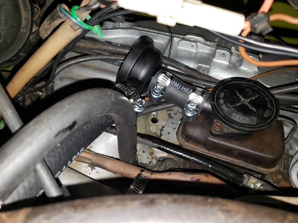

smitty1976bus wrote:
Loving the 3d printed stuff bummerbus

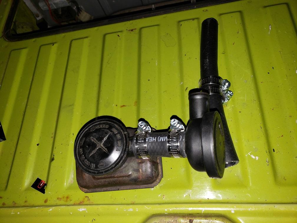

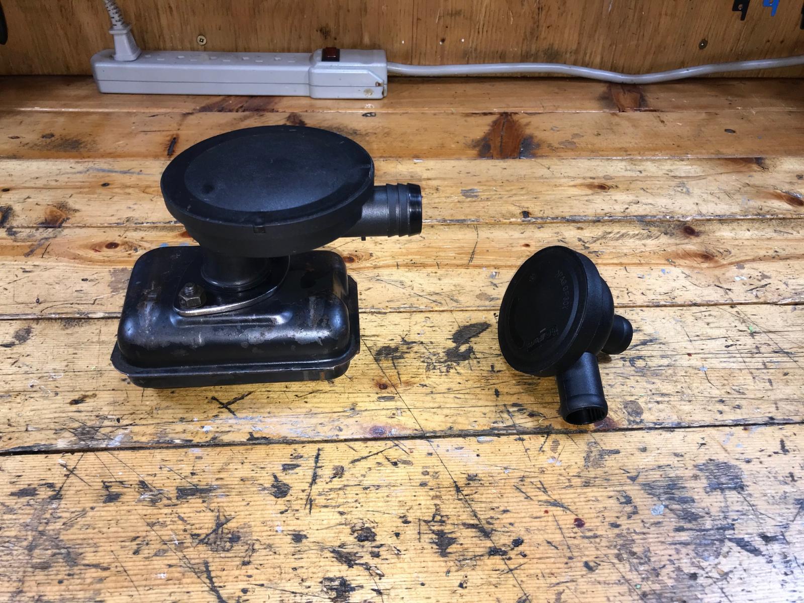

I mounted the VW golf PCV, and from the part description I find online, it should operate the same way as the VW PCV: "This valve is responsible for venting crankcase vapor into the intake manifold so the engine can burn it"

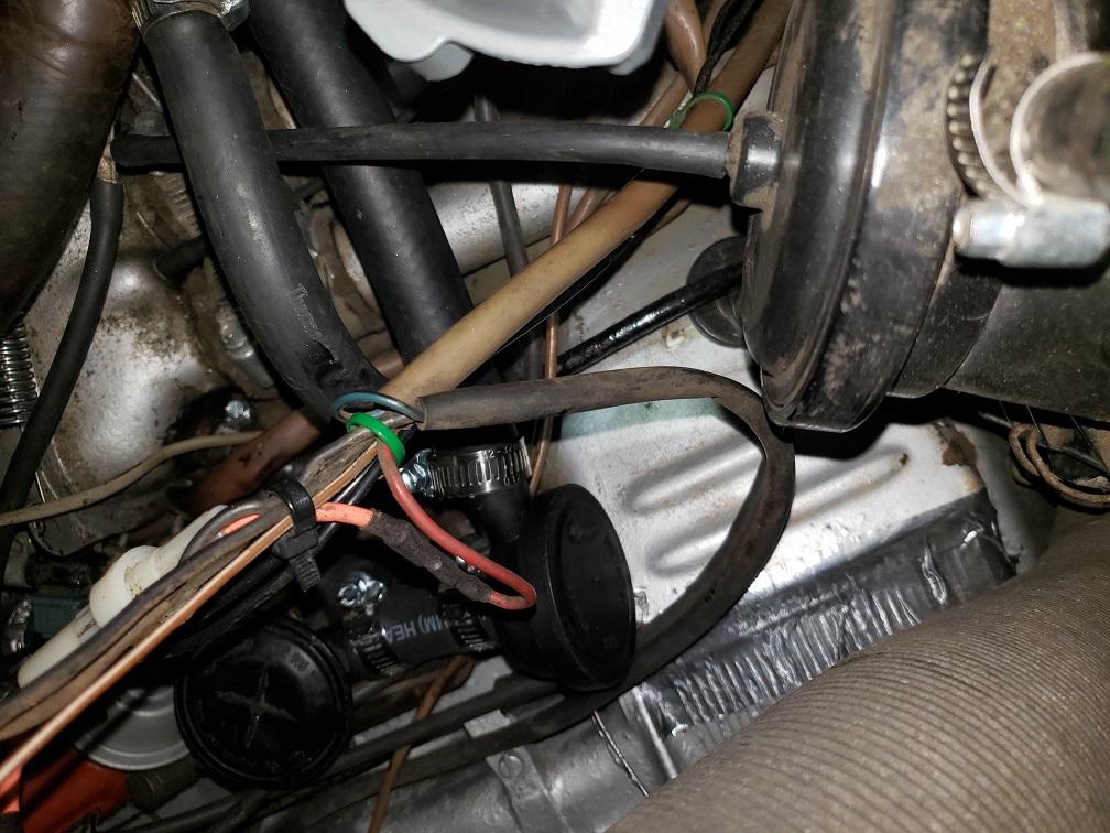

Placed the unit in line from the original PCV and the S-Boot:
Unfortunately, I didn't have time to drive around tonight to test the oil levels, but the bus did idle much much better. I actually had to screw out the idle speed screw. The real test will be is if the PCV actually vents the crank pressure into the plenum... Any signs to look out for if it isn't venting properly? Is this when I suck in a valve cover gasket?
We'll have to see what happens. bummerbus, you mentioned something about needing measurements, i have an extra oil breather and PCV laying around if you need me to break it open for measurements or anything Wink
SS

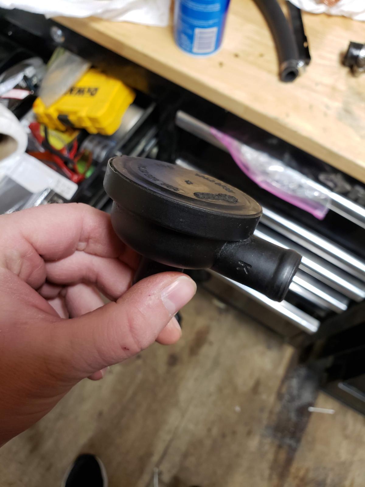

Did you note the flow direction of the PCV when you removed it? The 06A 129 101D looks similar, but operates in the opposite direction to the stock PCV. Top is from engine and bottom to intake. I can kind of see more of the carbon buildup from the crankcase on the top part of your 06A 129 101D PCV.
I have been slowly working on a replacement for the stock PCV. I have an operating used one (of the 3 I have), and will be testing out the options.
The 06A 129 101D has to go backwards to function properly. On some applications the bottom plugs right into the s-boot, others it is connected by a hose, but the bottom always goes to the intake.
The 023 129 101 is in the correct orientation, but doesn't look as stock.

smitty1976bus
Joined: January 21, 2013
Posts: 369
Location: Cape Cod
smitty1976bus is offline
PostPosted: Wed Apr 01, 2020 6:38 pm    Post subject: Re: '78 EFI burning oil - oil breather issue Reply with quote
SS

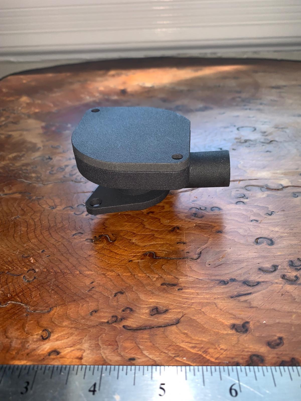

bummerbus
Joined: April 12, 2009
Posts: 64
Location: Portland, OR
bummerbus is offline
PostPosted: Wed Apr 01, 2020 10:35 am    Post subject: Re: '78 EFI burning oil - oil breather issue Reply with quote
SGKent wrote:
[quote=You need a small hole in the top that allows it to hold ambient air pressure. That is what allows the diaphragm to move.

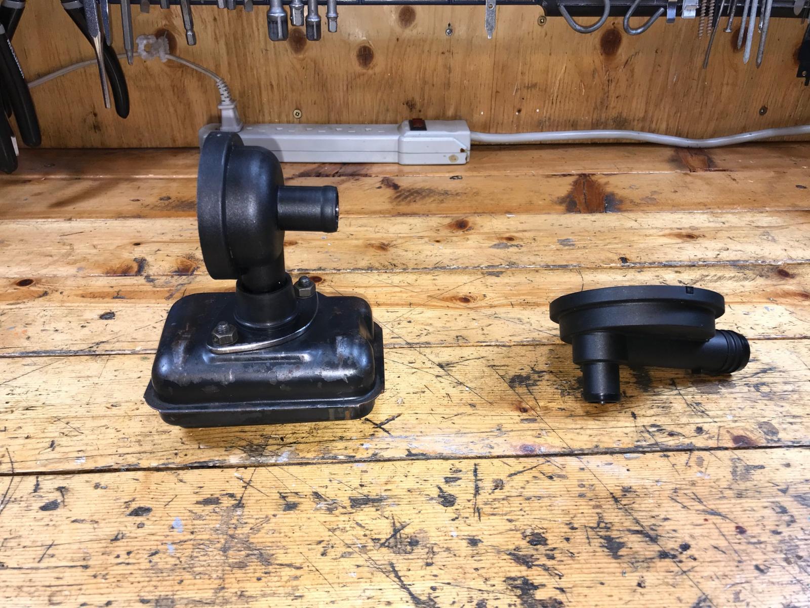

Totally, its not pictured as these are pre-assembly, I did add a hole before putting it all together. 3D printing doesn't do really small through holes very well so I opted to drill it myself. The result is the same, this may be due to the fact that I cannot provide enough suction to close the valve manually (maybe need a heaver plate? but the one pictured weighed close to a diaphragm). I can tell you from the good working original I have that when sucking on one with a diaphragm in it you can feel it seal and unseal. not super scientific but that is where I am at with it.
Pat
‘75 FI-1800cc.

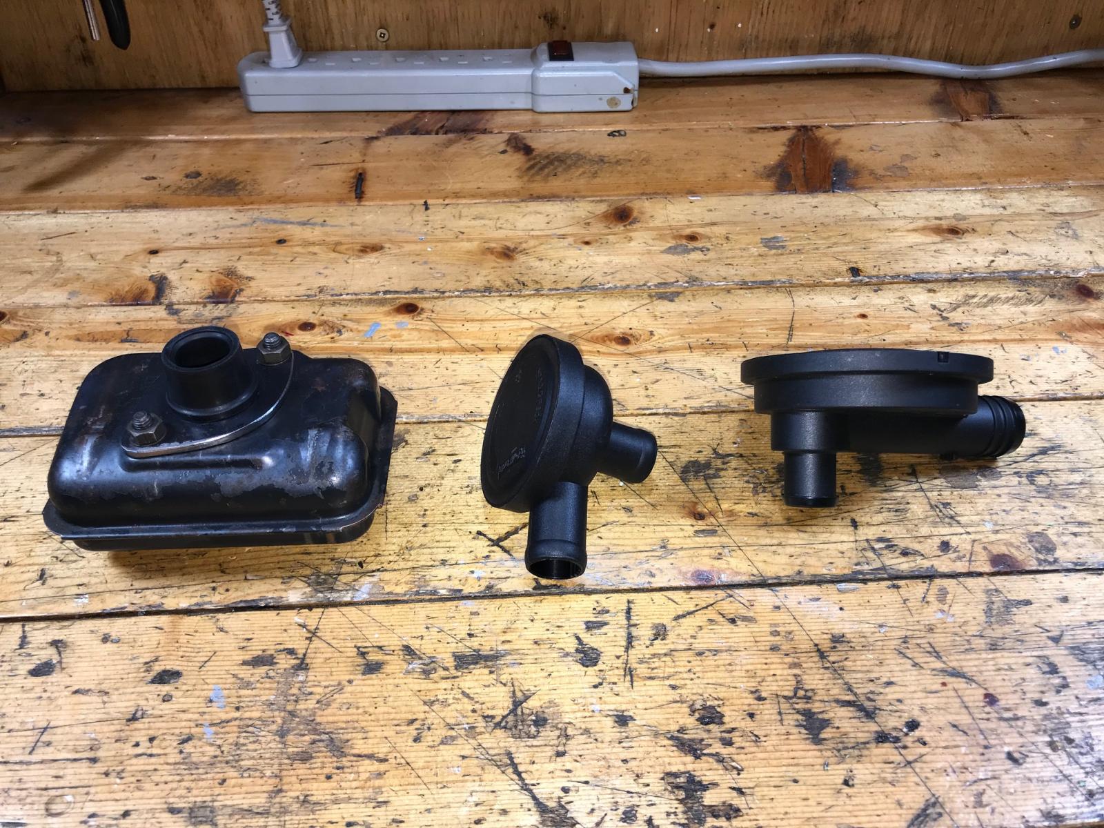

Here are a couple pictures of the 3D printed body, this one was specifically made for a plate instead of the diaphragm so it does not have the seat around the opening for a diaphragm, but I do have a model for that ready to go.
I also mocked up an "adapter" plate style block off for the baffle/breather box, in hopes to drill out an opening and try a couple more traditional PCV valves that mount with grommets. Just got a shipping notification for that and it should be here Saturday. will post some pics and maybe start looking for suitable options soon.
SGkent- unfortunately being a broke grad student, and school got in the way of me investigating those options, in person. I did email a seller from ebay at some point about getting a measurements, as I think they are a bit larger, but I got no response.

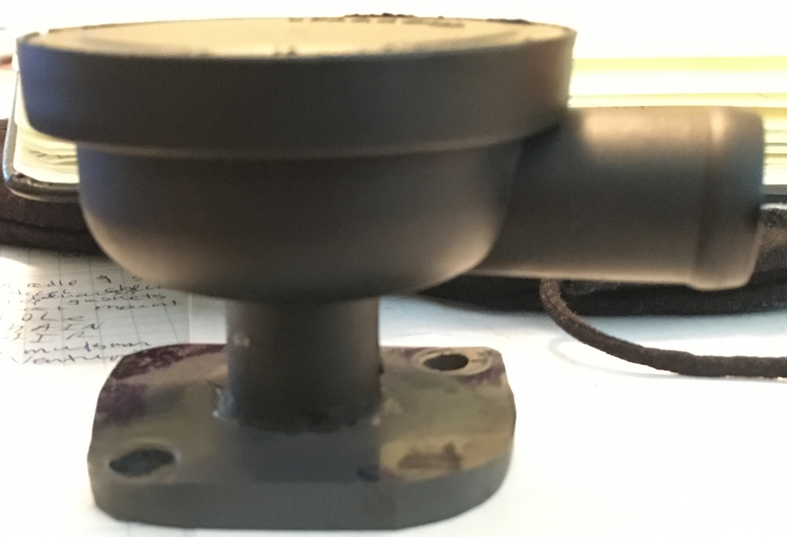

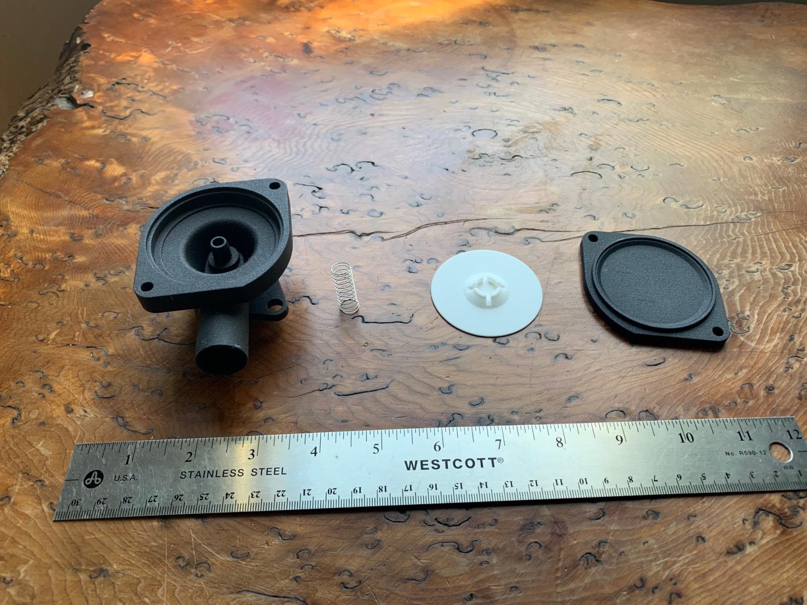

SGKent Premium Member
Joined: October 30, 2007
Posts: 42921
SGKent is offline

I work at a salvage yard and grabbed a PCV off of a 1.8L (maybe it was 2.0L) VW engine (think it was a Golf), and plan on plumbing it in line from the oil breather to the S-Boot. The 90 degree angle of it will back it fit nicely. I'm just not sure if the valve in this has the same resistance as the stock bus PCV. Pretty sure they're both just a spring on a diaphragm.
Of course I grabbed the PCV but I can't find any rubber hoses to plumb it onto my bus tonight. All auto part stores are closed in my state, so hopefully I can find some hose tomorrow and see if this works[/quote]
Some VW style PCV valves hold pressure in the crankcase and some put the crankcase under a bit of vacuum. I can't off hand remember what the Type 4 Bay PCV valve does. The difference is on which side of the diaphragm the spring is. Whether it forces the valve shut or holds it open.
As for the valve you have you could probably make a flange that would bolt to the breather where the original PCV mounted that would accept your replacement PCV valve and a grommet to seal it.
bummerbus
Posts: 64
PostPosted: Tue Mar 31, 2020 8:24 pm    Post subject: Re: '78 EFI burning oil - oil breather issue Reply with quote
Cheers,
Pat
‘75 FI-1800cc.

the plastic valve is ultrasonically welded. The top can be carefully taken off, and someone here on the forum 3d printed a new diaphragm. There aren't enough bus owners to justify making new valves. It is like the EGR thing. We've been working on it now for 10 years. I still don't have anyone who can make a true replacement diaphragm for less than about $2K for the first one. Ray said he could but he destroyed a really good part trying, and in the end we had neither a new one or the rare old one. A commercial shop has been promising me for a year they can do it but they keep flaming out. I suspect the PCV diaphragm would be the same so that guy here who 3d printed one is the best bet.
