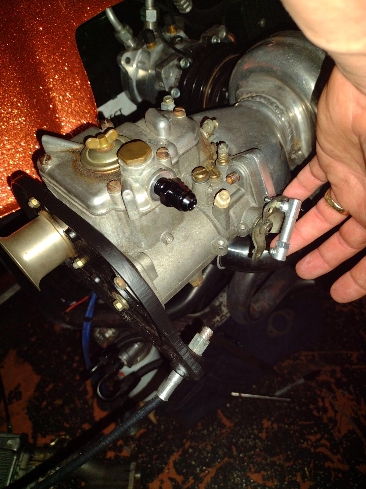

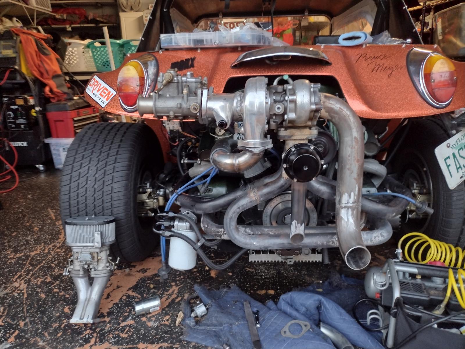

oprn wrote:
You welded that carb manifold to the compressor housing?
No the turbo came that way. It was a kit for a bug but the header would hit the manx body. Funny thing is the header was well built with thick flanges and nice TIG welds, but the manifold welded to the turbo looks like a 4 year old did it lol.

PostPosted: Fri Nov 22, 2024 2:44 am    Post subject: Re: New classic manx #93 Reply with quote

Been a while so..... Here's where I'm at. Going single turbo as the twins took up to much space to work on things that should be easy on a buggy ( like starters, clutch adjustment and so on).
So now we have a 40 Weber side draft and T3 turbo on the 2386. Still got a lot to do but it's getting there.
By the way an EMPI progressive throttle linkage ( uni link) kit looks like the ticket with the CB air filter base that hold the cable.

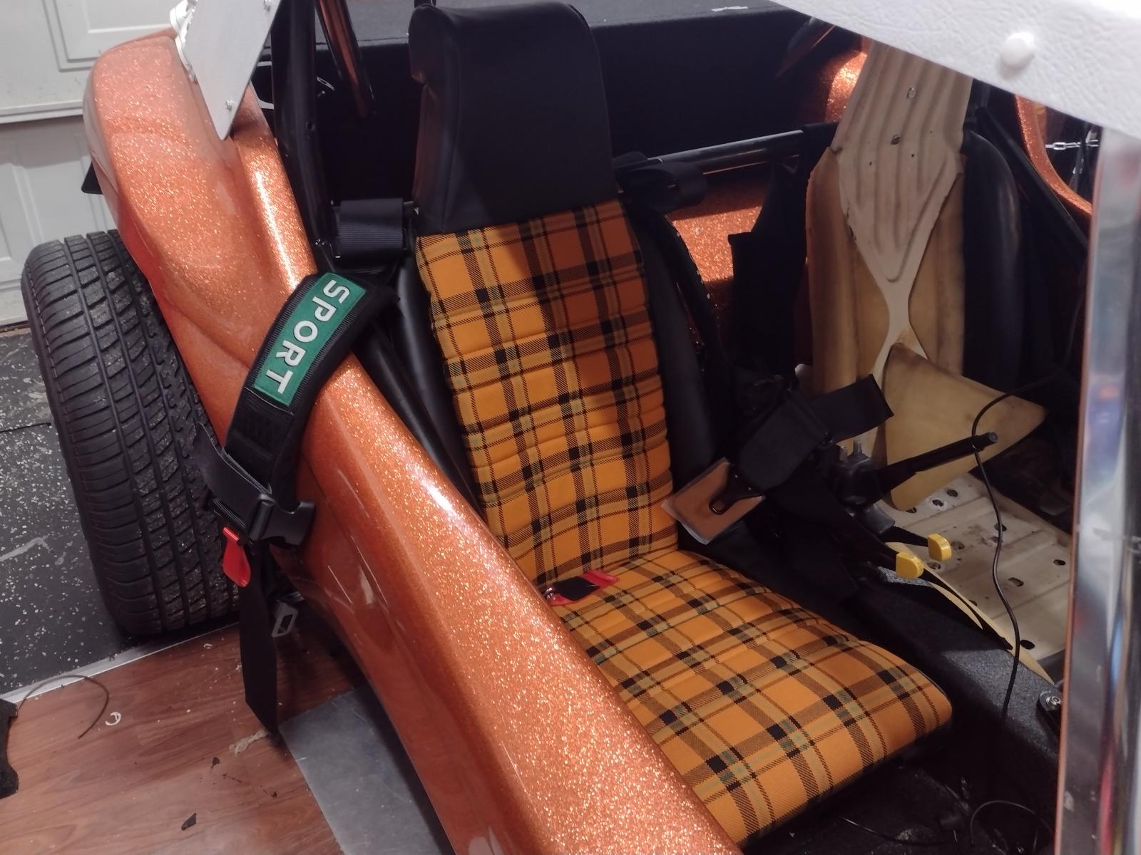

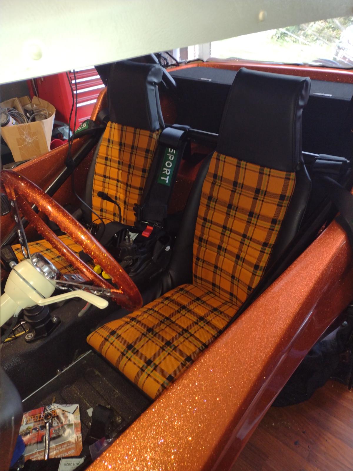

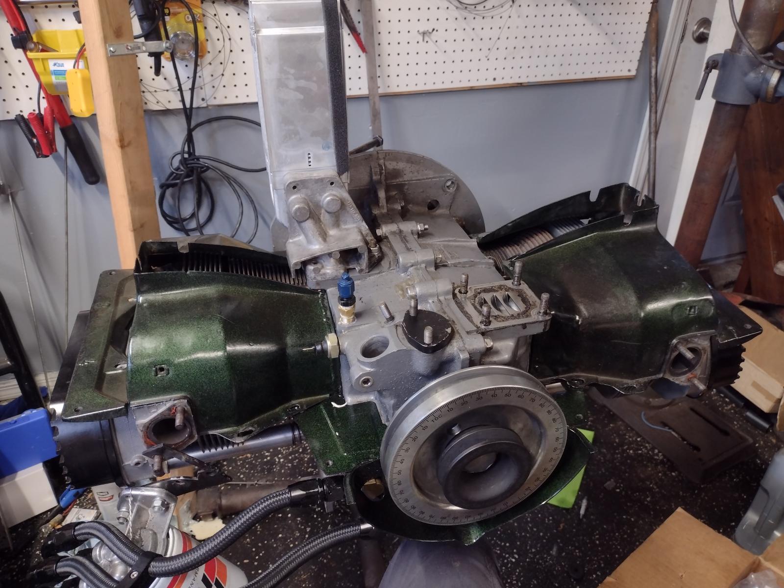

Well the big motor is back in. I had the twin turbos on it, but the starter went out several times and it was such a pain to work around the turbos that I took the system off. So it is just carbureted for now.
So I finally put the seat covers on and boy does it look so much better. Been putting this off as I didn't want to get them dirty with oil and grease

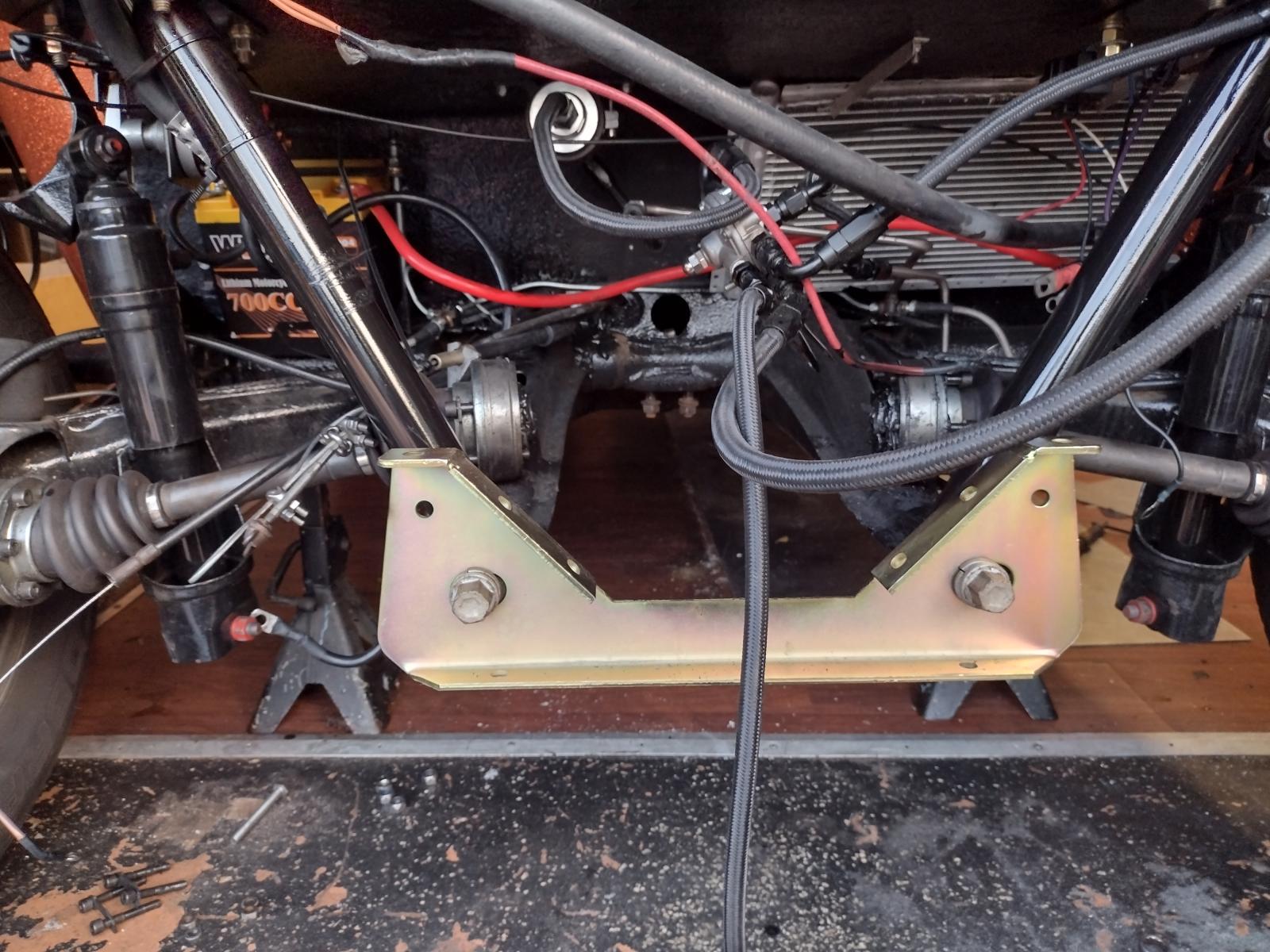

So got the broken transmission out and put in the solid trans mounts and pro street box. Started putting the 2386 back together.
Hopefully it will be running next week.

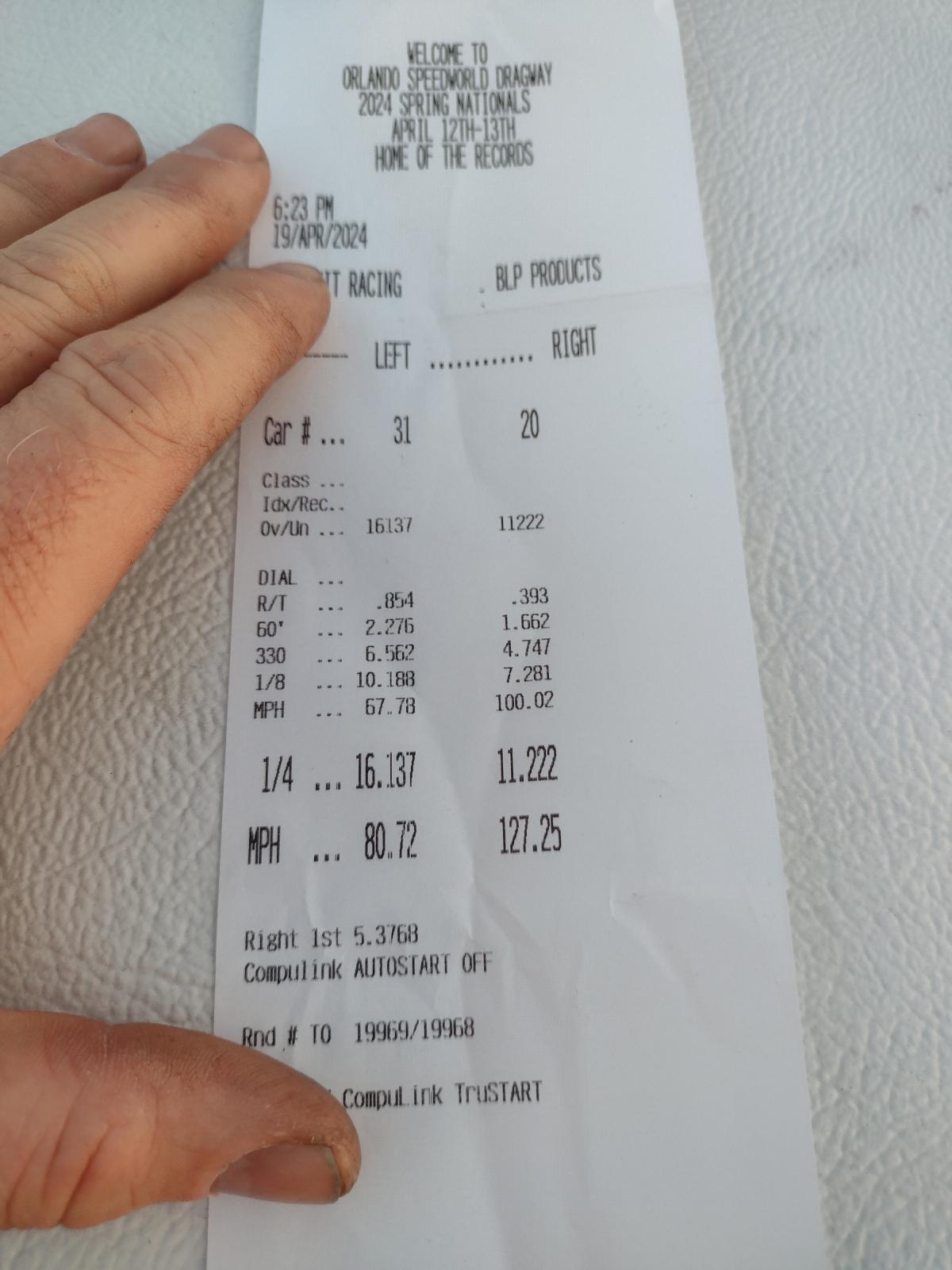

So I put the twin turbos back on the buggy. It still has the stocker on it, so takes a bit to spool as expected.

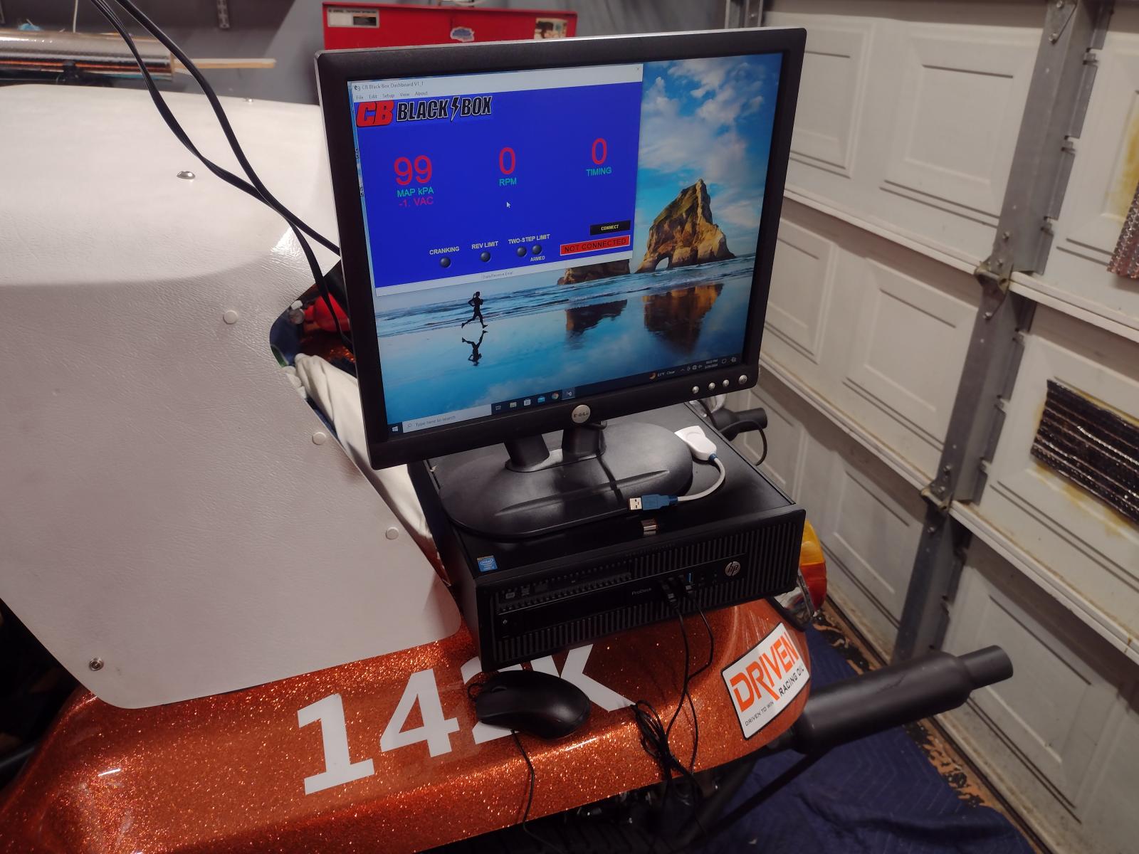

Had to get innovated to set up the CB black box as the software was on a disc and all my laptops do not have a CD drive.
Setup the two step for 3200 and a rev limiter of 5000. Should have went higher on the
Rev limiter as she is really coming a live at 4000 and pulling hard at 5k but it still has stock springs so better safe than broken LOL.
Tried to hook up the two step to a momentary switch , but it was not a momentary switch as advertised just a push on and it locks push again and it turns off. Not what I wanted but what I had and we were off to the races.
The switch was a real let down as it would stick and I thought I was hitting the over rev limiter in first gear. But I was hitting the two step again and that really killed the ET, I was in the left Lane.
She went a full second faster than it did just carbureted tho.
So at the end of the night I got a fire lit in me to make it stand on the sump or break trying lol.
So I pulled the wire off the two step switch so I could manually ground it. Let it. I let it sit on the two step to build boost 9# of boost ( for some reason when it build boost on the two step it blows through 3200 rpm and goes to 4000) and side step the clutch. Well the stock transmission has been taken all my stupidity well but the spider gears have had enough and left the party. Leaving me sitting 10 ft from the starting line lol. So a friend of mine went and got his truck and tow bar to take the wounded Manx home.
So I have a rebuilt pro street transmission that needs installed , now I have a reason to do it hahaha.

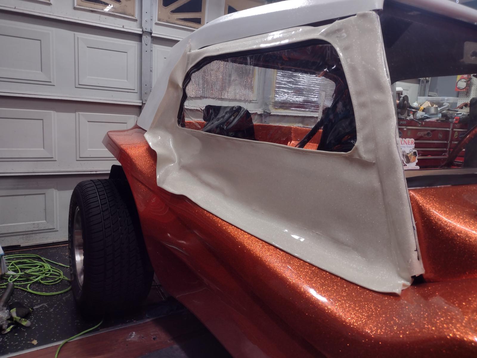

So it RAINS ...........a lot........when I drive the buggy.😒😒😒😒
So it is time to make some side curtains.
Not perfect by a long shot but should keep most of the rain off me.
