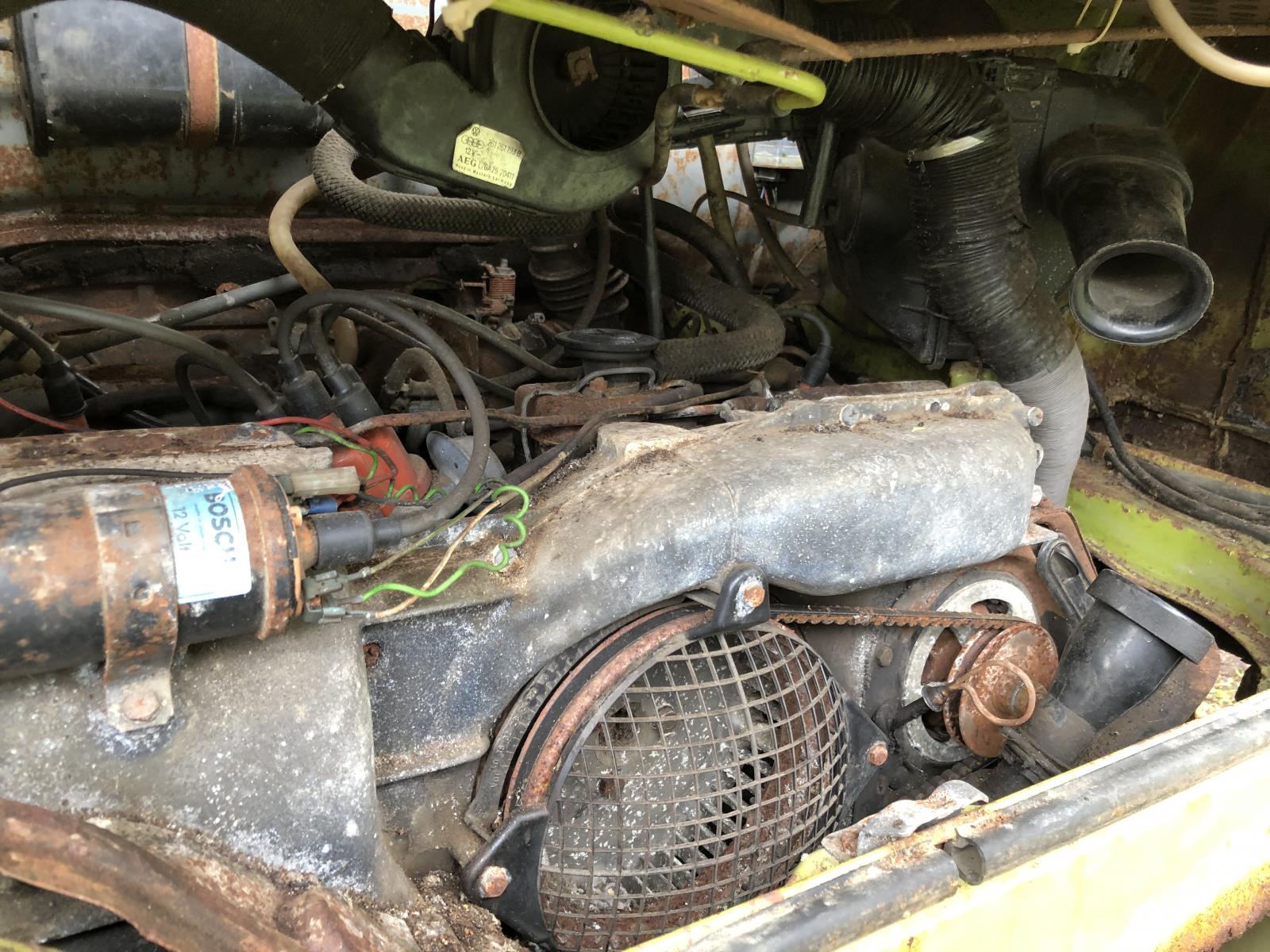

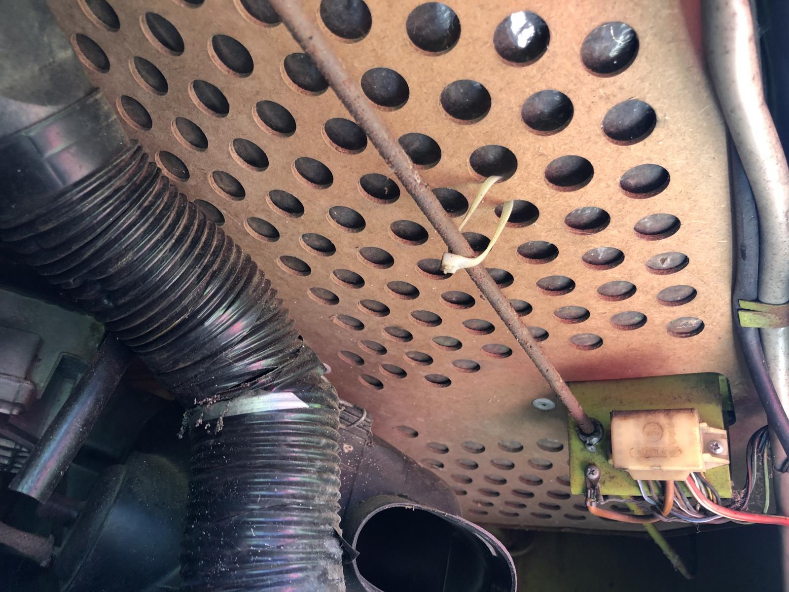

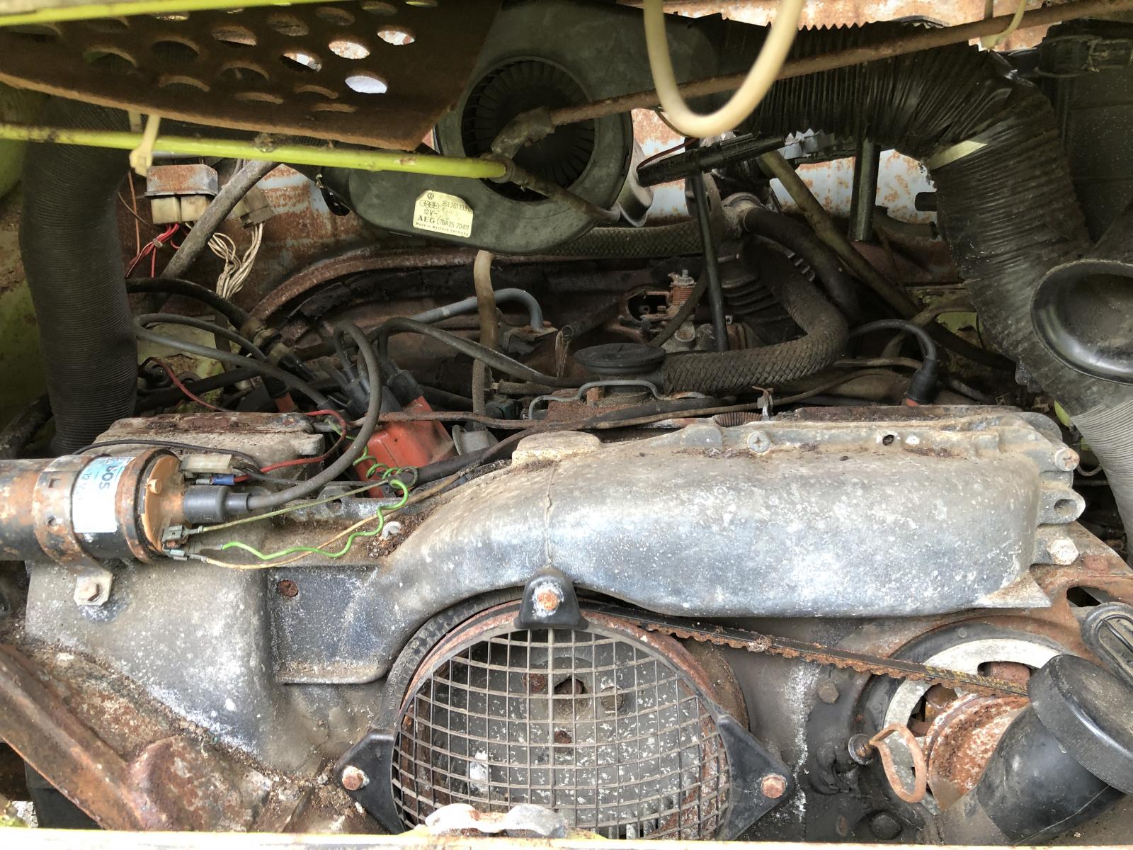

Not a whole lot to update on.
It seems like the new rubber boots/seals I installed in 2020 on the motor only last about 4 years. Had to replace the oil dip stick boot, brake booster to intake boot, and alternator cooling boot. The alternator cooling boot was actually shredded up in a couple different places. All these new boots seemed to lower the idle RPMs a little bit, so I guess I had a vacuum leak.
Moral of the story here, don’t think those rubber boots and seals in the engine compartment last forever, they just don’t make them like they used too. Guess they should be replaced every 3-4 years.

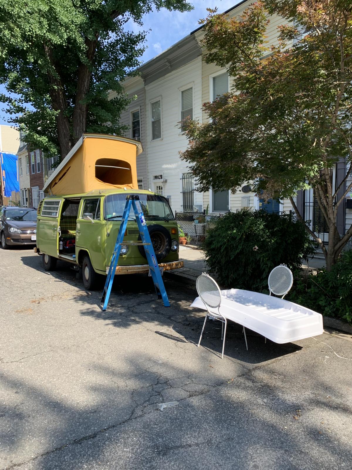

PostPosted: Thu Aug 05, 2021 5:28 pm    Post subject: Re: 77 Cape Cod Sage Reply with quote
Finished the pop top today. Anyone out there wondering if you can do it with the top on? Yes… I’m not sure if it would have been faster to remove top or not. Reattaching the metal strips to the body is by far the worst and hardest part of the job. On a scale of 1-10, where 1 is easy and 10 is hard, this job would be about a 5. There’s easy and tough parts. Time consuming to do on your own. If you had a helper you could probably knock it out in one day.

PostPosted: Tue Aug 03, 2021 2:11 pm    Post subject: Re: 77 Cape Cod Sage Reply with quote
Almost there with the new pop top canvas. Doing it myself so left the top on during install. The lady I bought the bus from included the canvas with the sale. It’s a BD canvas from 10-15 years ago. The windows don’t seem to be in the best locations but I’ll take a free canvas any day of the week. Good practice for if I have to do it again.

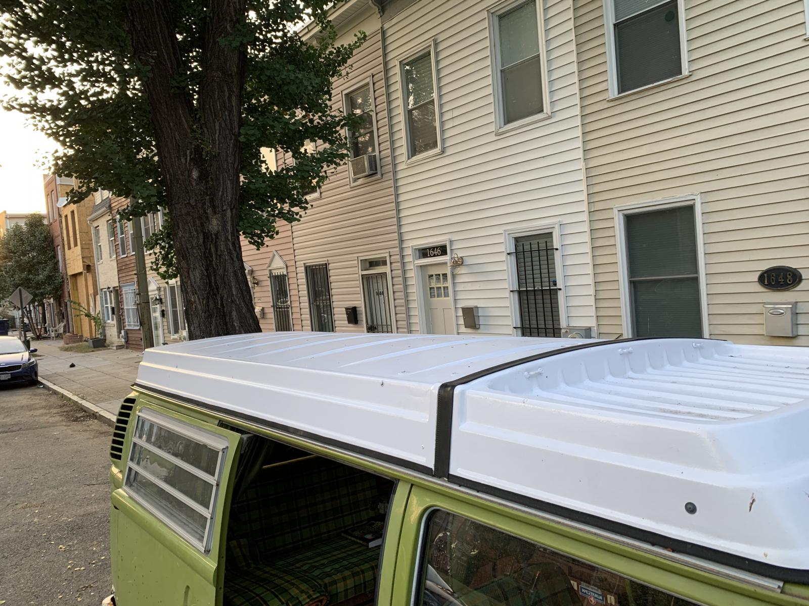

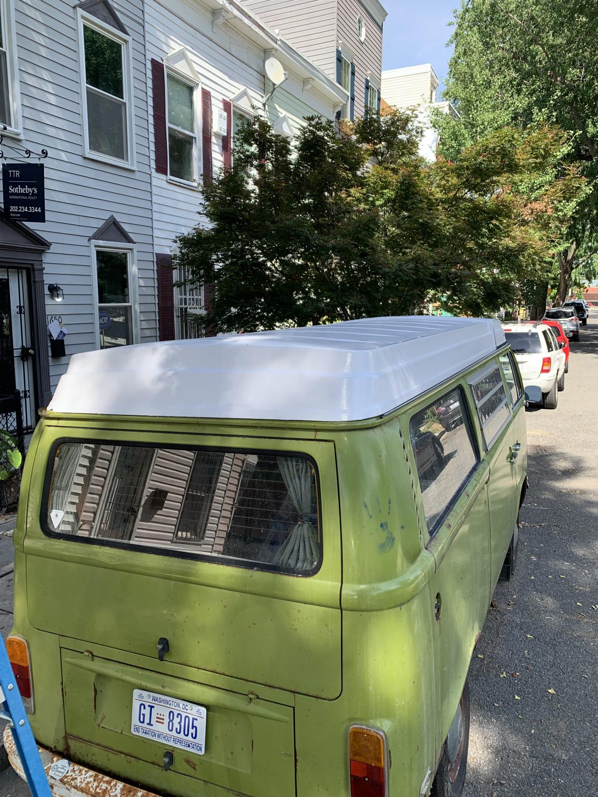

Weather was super nice today and I got to finish painting the roof.
Used the rustoleum top side marina paint from the local hardware store. Good enough for me! Will do new seals next weekend.

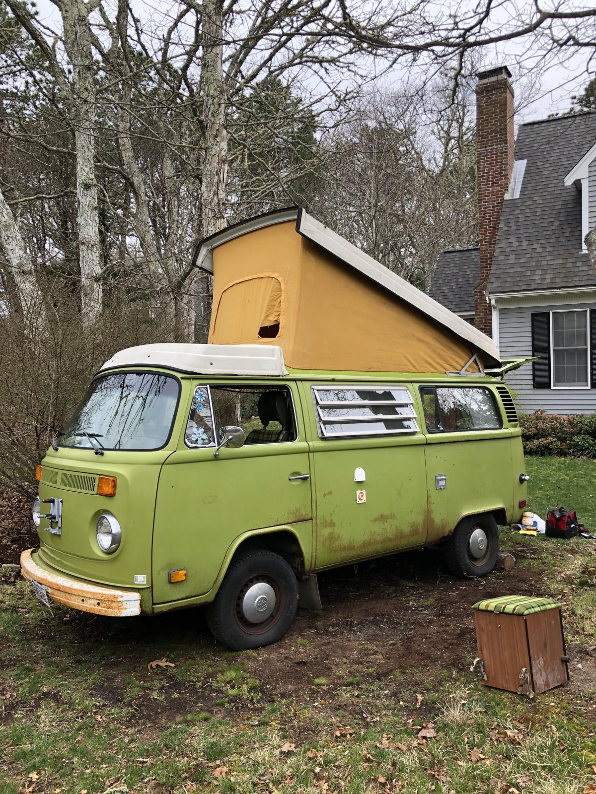

PostPosted: Sun Jun 20, 2021 11:39 am    Post subject: Re: 77 Cape Cod Sage Reply with quote
For Father’s Day I asked for some time to work on the bus and my request was granted. When I purchased the bus, the lady threw in all new pop top seals and canvas. So I spent about 5hrs this weekend cleaning, painting, and refreshing the pop top. Used the rustoleum marine paint. Looks great so far. Will use the next few weekends to do the back part of the pop top.
Don’t have garage in the street so it looks like I’ll be leaving the top on for the canvas install. I’ll chip away at it slowly when the kiddo and mom dont need me.
