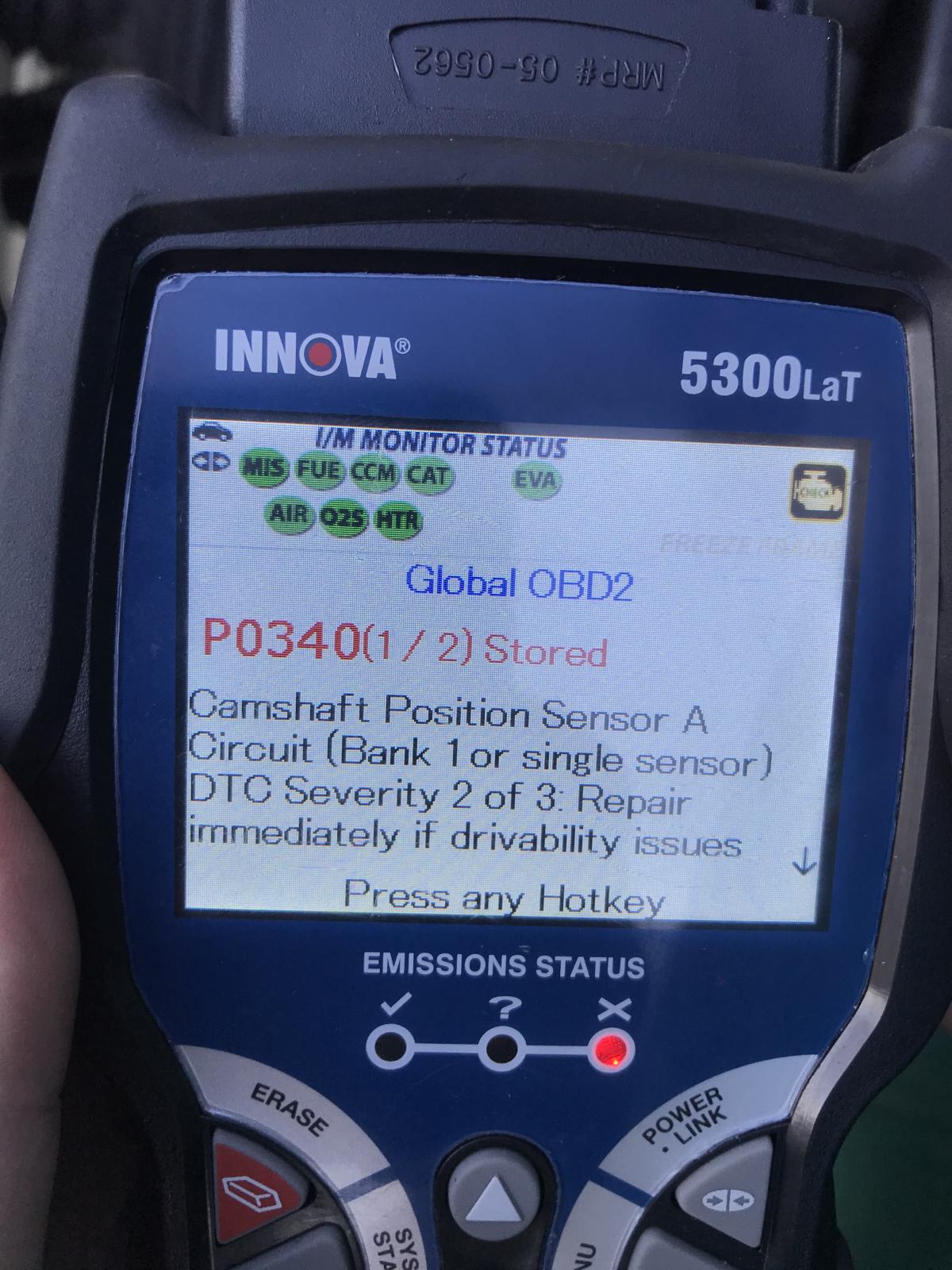

Got the recent code(s) read at Oโ€™reillyโ€™s since I donโ€™t have a good code reader yet. One says โ€œpendingโ€
Any thoughts on my next move? Just keep driving it? Get the fancy code reader?

Thanks for the continued input! I decided to take the van for my first campout. No CEL since my first post on this topic but it is not a daily driver. Got it all packed up to head up into the mountains to get out of the heat. As soon as I started it up, the CEL came on, of course. With my code reader still notโ€œtalkingโ€ to my van, my daughter and I headed up anyway. 6,000 ft of climbing and about an hour plus of driving. Some dirt roads. It did great. No funny noises that I could tell.
Camped overnight, did some hiking, came down about 2,000ft in elevation (Now 8,000ft) and stopped at a state park visitor center. When I came out 5-10โ€™ later. The CEL was gone. Drove to visit a friendโ€™s campsite nearby. When leaving 1-2 hours later, CEL was back on for the whole drive back home.
I may drive it over to Auto zone this week to have them pull the code(s).
Iโ€™m really happy to finally camp in it.
Can someone post a link to the good code reader mentioned above?
Why would my code reader โ€œtalkโ€ to my โ€˜11 Subaru but not this โ€˜03 Eurovan?

I got a little lost on this thread also, so let me try to bring it back on track:
First, Vanagons rule - I don't think I'd bring it back to that shop. The P codes are generic OBDII scan tool codes. I'm going to sound like a broken record but you really want a VW specific scan tool. The information it gives you is night and day.
One quick thing to try is to swap the coilpacks and see if the misfire moves.
If you're getting misfires on 3 and 5, swap 3 to 4 and see if it moves. Same with 5 - try moving to 6.
It's possible the misfires are a timing chain, but it's a lot easier to move the coilpacks and inspect the plugs than it is to pull the upper timing cover.
For reference, if you're facing the engine, cylinder 1 is top left. Cylinder 6 is the right most one.
So it'll look kinda like:
1 3 5
2 4 6
I'd get a proper scan tool such as VCDS, or find a local VW person who has one, and swap the coil from 3 to 4. See if the misfire moves. if it does, your misfire is the coils. If it doesn't, you can dig further by inspecting/swapping plugs.
This is very doable from above in a parking lot without removing a bunch of stuff if you're willing to get your hands dirty or have someone help.
If you aren't comfortable doing it yourself, look for a VW specific shop - or better yet, one with proper Eurovan experience - and bring it to them for diagnosis. A lot of the common problems on these vans are very easy to diagnose for someone familiar with them and with the proper tools.
Finally, if it IS the timing chains, it's an expensive job. But definitely don't have the shop that pulled those codes do it. If they don't have the proper VW scan tool I wouldn't trust them to properly do the timing chains on that engine. I've done it myself several times and it has a few gotchas.

Zeitgeist 13 wrote:
I may be wrong, but it's my recollection that the later 24v engines are less prone to t-gear wear than the 12v. Mine was perfect @ 160k.
This is definitely a myth. I've seen many 24v timing chains/gears worn first hand.
Zeitgeist 13 wrote:
I installed a trans dipstick kit, which I think was purchased from Poptop Heaven.
Can you confirm where you got this?I thought the dipsticks were no longer available.
If still an option, it's definitely something I'd recommend jmciii pick up. It's easy to drain excess fluid but otherwise pretty tough to know if you're low.
jmciii - I definitely recommend getting a proper scan tool or getting in touch with someone who has one. The generic readers give you generic codes like "cams out of sync" or "O2 sensor failing" whereas the VCDS tool will tell you which sensor is failing, and where. It's a LOT easier to pinpoint issues. Often times there are other issues that might not be obvious, like transmission codes which may signal some other impending problem.
Looking at the shop invoice and hearing about your dripping I'd be a little worried that it's the torque converter seal. But the best thing to do is to clean the area very well and then see where it's dripping. It could be as simple as a drain plug that needs to be snugged.
Remove the belly pan if it isn't already removed, and then it's pretty easy to slide underneath. Being able to work on the Eurovan without jacking it up is one of its many charms. Smile

So, that is not the actual invoice of work that was previously done to your van by the shop in question?
I have a set of detailed codes. I've shared them elsewhere in the forums. here. I came into this thread to ask about transmission fluid and I appreciate the guidance. -John
Allow me to be a bit more dismissive: Start your own thread. This thread has never been about transmission fluid. Your comments related to the engine timing components were initially on-topic, but the whole transmission discussion is off-topic and not related to the original poster's inquiry in the least.
