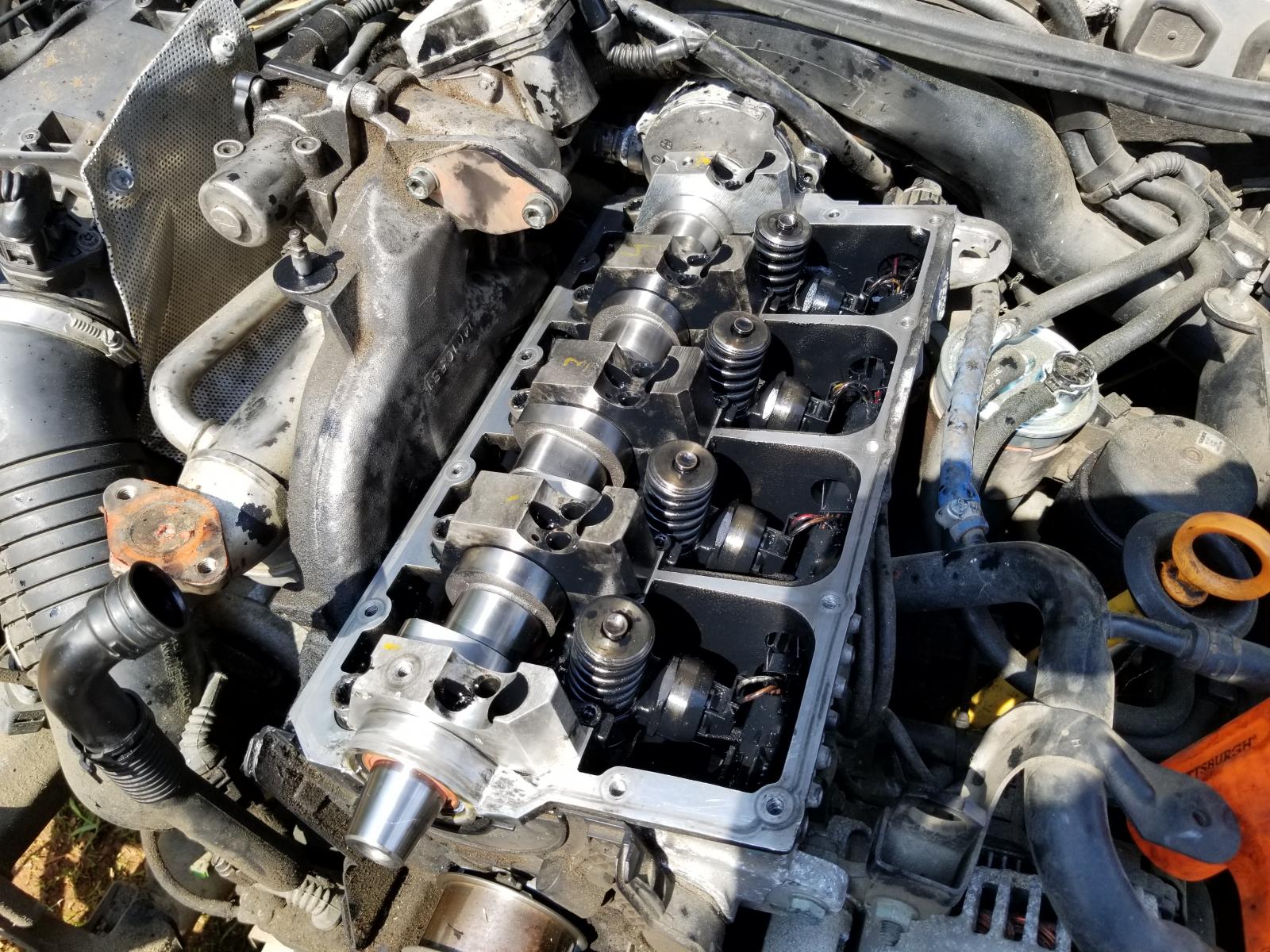

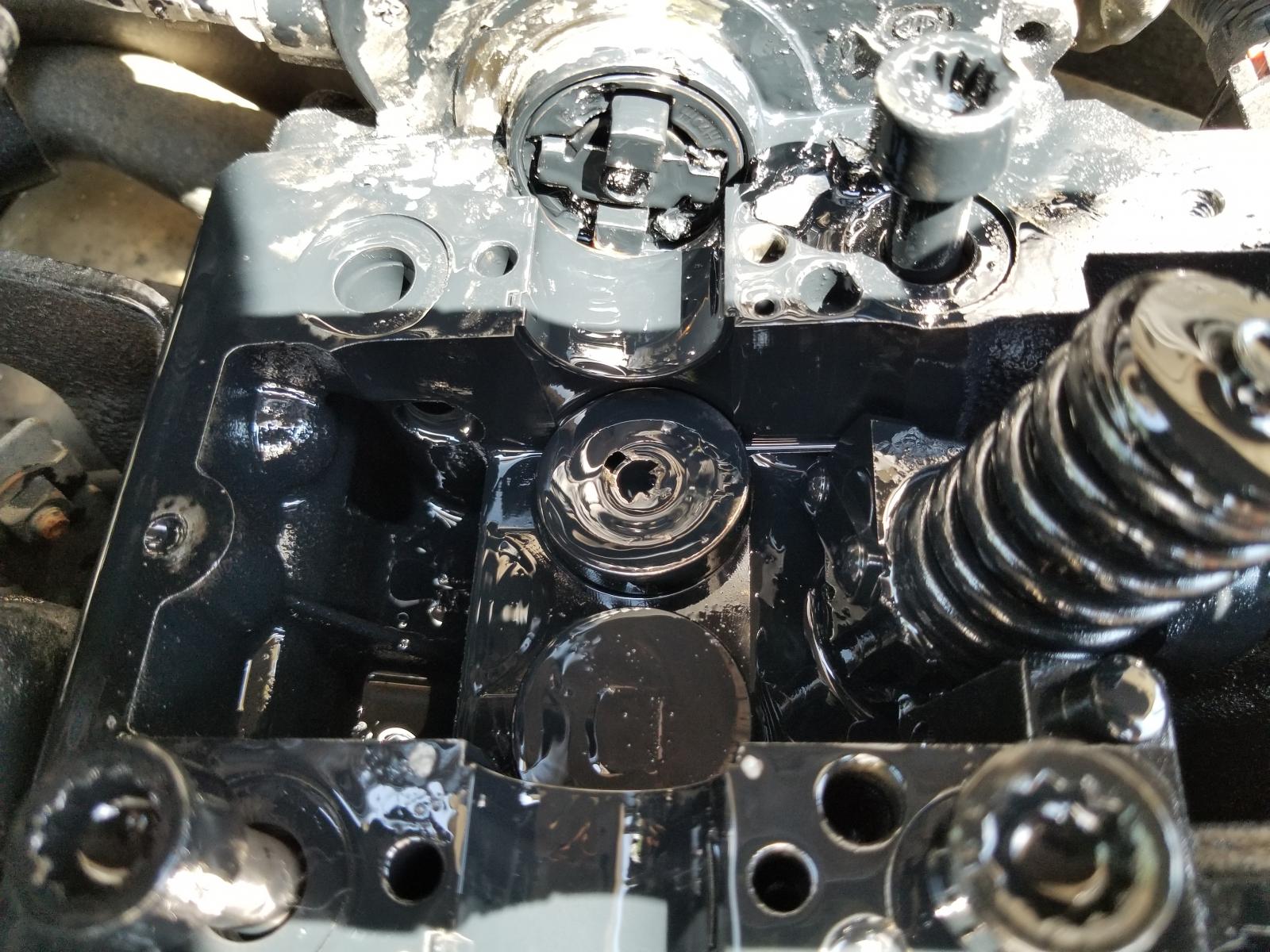

well i was nearly ready to fire up the passat and break in the cam. i just need to tighten the timing belt and hook the accessories back up. I should have it running again 2marrow.
new cam, lifters(the black oxide style), cam bearings, water pump, tensioners, belt, etc.
im posting on this b/c i did something really stupid 2day... I tried using the cam pulley puller backwards and stripped a thread Shocked Crying or Very sad good news is, only the very first thread got goofed up. So all is good now.
i dont know why the video i was watching had me do this. but i did it any way. The factory timing marks were still on there thankfully so the timing is exactly how it was be 4.
Well damn! that boy messed up.
and it being a deisle, your gonna get FILTHY.
I was hungry and didnt want to digest oil, so a banana worked out well.
nearly back together.
