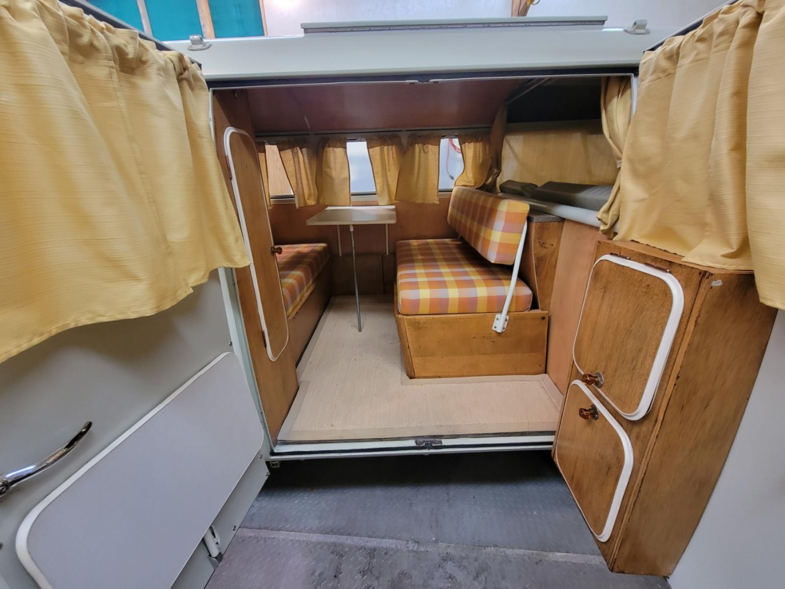

We are very happy with how the sub-hatch turned out. Since the body was practically rust free, it was a relatively easy restoration. The only thing left to do is to install the lower panel below the dash - held off on that in case I decided to install a cylinder temp gauge and need to run wiring.
Much of my enjoyment with this bus and other vehicles comes from restoring them. Now that this bus is done, I could use the garage space. I have a few more VW projects that I may get to, including a nice 1961 single cab and a 1957 camperized bus - not too mention a few beetles. In the meantime, I've also taken on two Toyota FJ45 trucks that need a fair bit of work. Not much time for camping.
It might be time to pass the sub-hatch on to the next owner. I'm wondering how the market is for restored VW buses and what might be a good way to go about selling it. It's located in Canada, which might help with selling it, seeing as the Canadian dollar is weak at the moment. Any tips will be appreciated.

We applied a coat of stain to the Baltic Birth before applying several coats of a clear urethane finish. It took some experimenting with different stains and mixing of several to come up with a color that matched the old cabinets reasonably well. Redoing the cabinets was tedious, time-consuming work. It brought back memories of many years ago when I spent several years refinishing and rebuilding wooden furniture as a business. This type of work involves nasty chemicals and dust; that requires good breathing and skin protection.

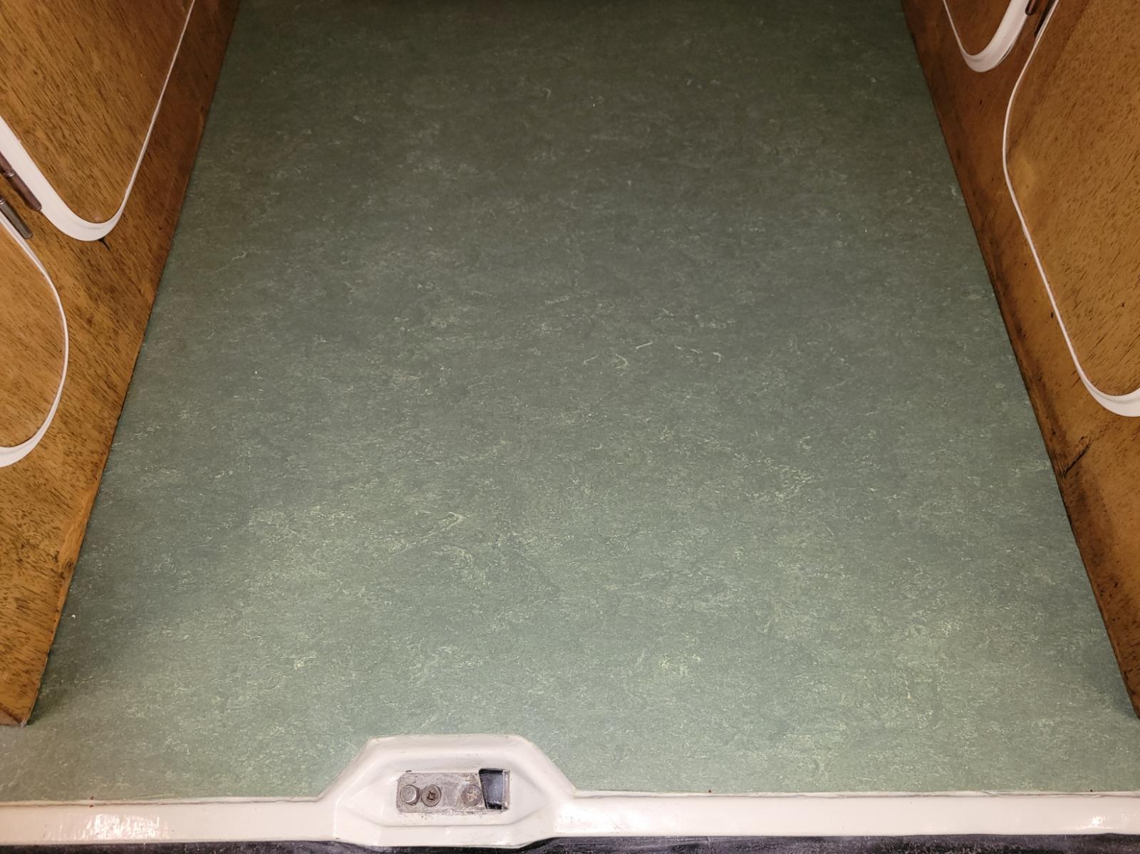

Thanks for the info on the green marble flooring for the rear floor area. I had no idea. An internet search does not turn up much that resembles the original material in the images on this forum. The closest we came was at a local flooring store that had some really old stock upstairs. What we came home with is in the image below. The color looks about right, although the marble streaking is more mottled than in the original material. Although this does have a directional grain in the material, it isn't that easy to see. Anyway, since most posts seemed to agree that SO33 campers had the grain running across, we installed it that way. As installed, it runs the full width under the cabinets and about five or six inches down the front edge.
Certainly not a perfect replica of the original, but close enough for now.

Thanks for the kind words and advice regarding the marble mat. I don't suppose anyone has a source for something close to the original?

And I'm not sure what to put over the floor area in the rear between the cabinets. We thought of making a two inch thick foam mat, covered with matching upholstery - or just placing a loose mat there. Maybe someone can tell me how Westfalia finished that detail.
Originally there was a marble mat back there.
There is a good thread on Westy Marble Mat's that go over the engine firewall. It can be found here
It looks like Jacek was looking into repoping the marble mat back in 2020 but he disappeared off of this site. I was told he can be reached via Spacebook? I would reach out to him.

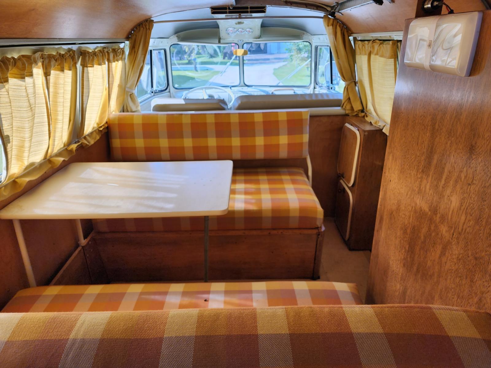

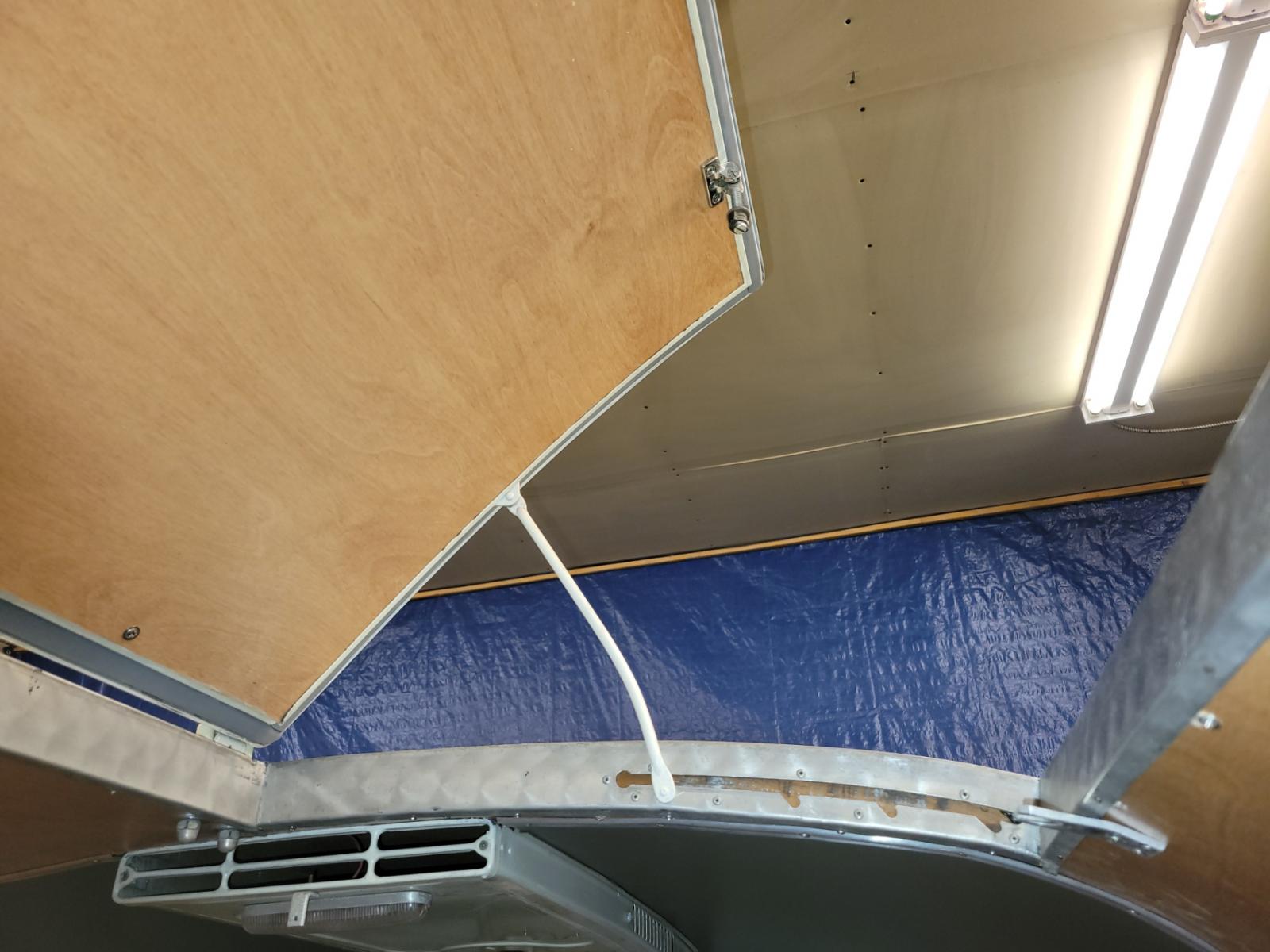

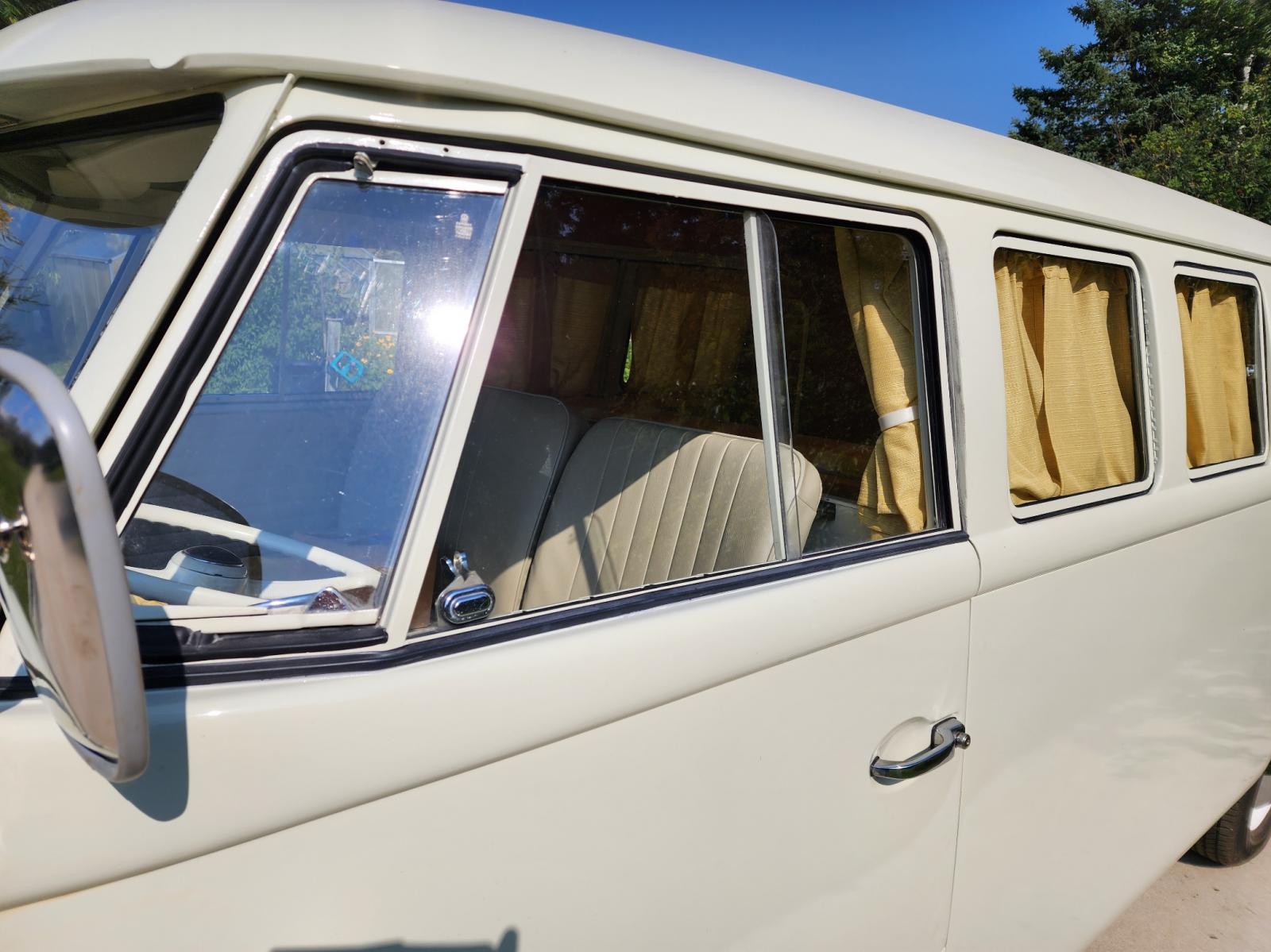

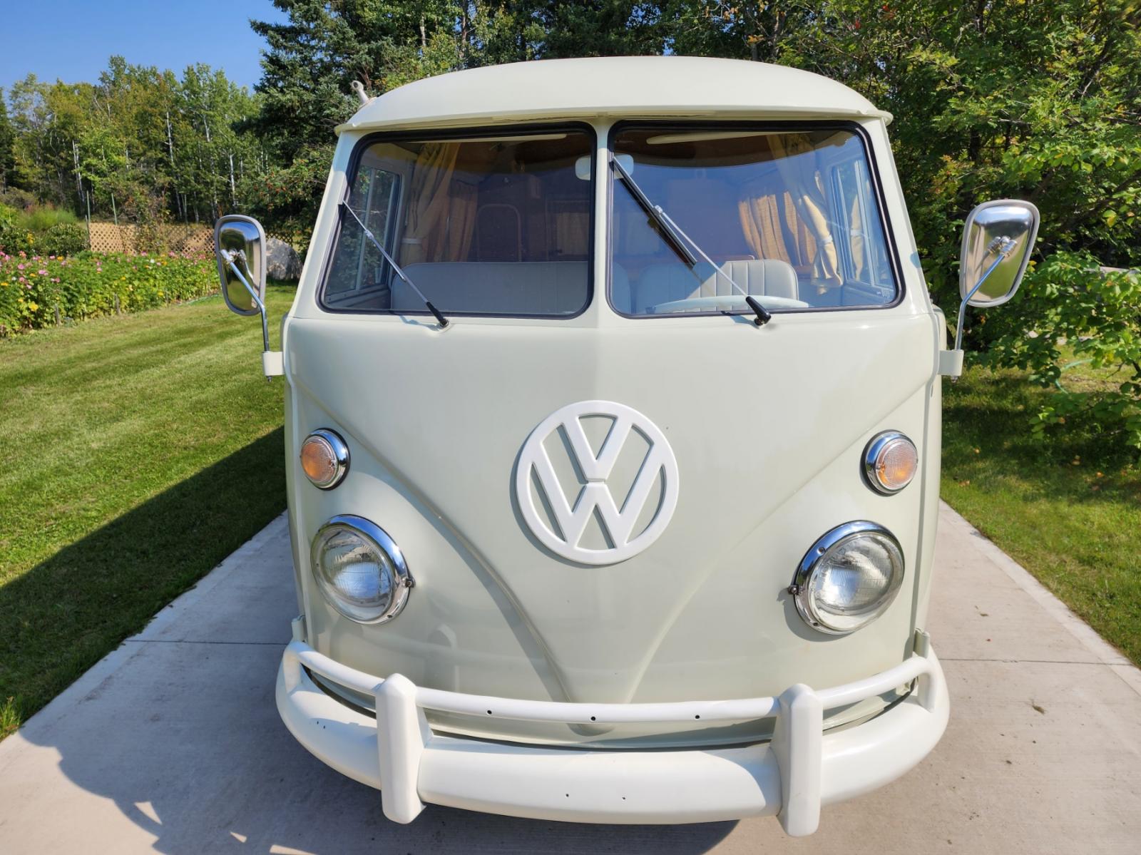

Thought that I would provide an update on this SO33 sub-hatch project. The previous owner had begun the restoration maybe 20 years ago, but then the work had stalled. It was about as rust free as I have seen, and had been kept inside for much of its life.
I didn't do everything myself; my wife helped make a lot of the more tedious jobs (stripping cabinets, for example) go better. And we have to give credit to TheSamba forums and the many active members for the wealth of information contained in threads and other resources. Without this, many things would be much more difficult, if not impossible.
Since we bought it, work continued on and off over the past two years and is now more or less complete. Lots of mechanical work happened, including bearings, seals, brakes, wiring, and minor work on the engine. I did try a few different carburetor and distributor combinations. It's a dual port engine. Since a lot of wiring was disconnected and left hanging, sorting out the wiring and getting everything working proved challenging.
We stripped the dark stain off of the cabinets and refinished them. For the walls and ceiling, we used European Baltic birch, available at Windsor Lumber in Canada. We made up a piece of sisal carpet; not a perfect replica of the original but close enough for now. The entire cab area underwent refurbishing and restoration. The entire underside underwent cleaning, some minimal repair, and repainting. The original paint on the underside, which had never been tampered with, was much the same color as the pearl white on the body.

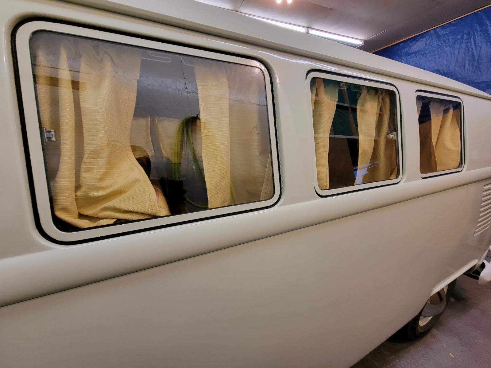

The exterior and interior paint, in the original pearl white, went on in early 2021 - base/clear in my paint booth. It turned out well with very little buffing required. Wheels powder coated.
It runs well, and we drove it around some, with the rear curtains and upholstery still to do.

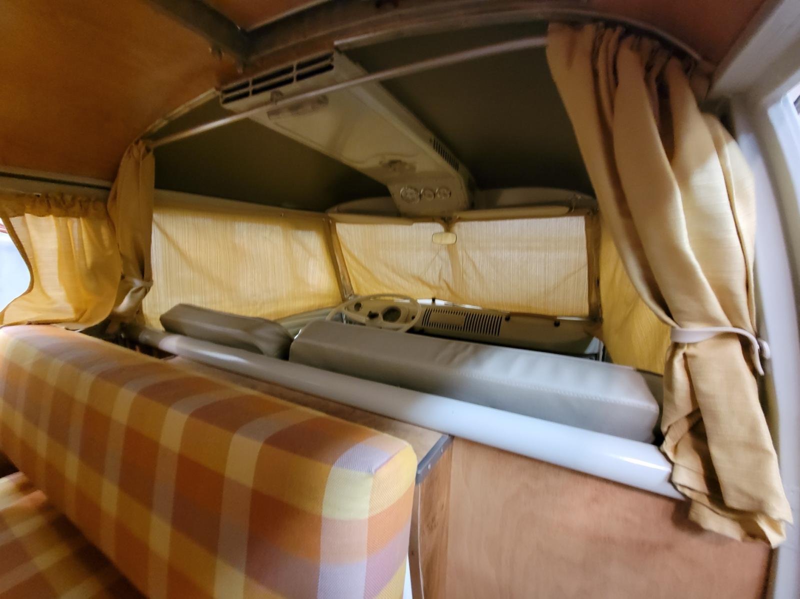

With the drop in value of the Euro, fabric for the curtains and rear seats from BBT became more affordable. We had bits and pieces of the original fabric, which helped with knowing what to buy. We bit the bullet and bought that in the summer. Then, this fall, we made up and installed the various pieces. A few years ago, we bought a commercial Juki sewing machine, which makes sewing much easier. I do the layout and cutting of the fabric, and my wife sews it. Snaps hold the curtains for the cab area in place when installed, as original.
A few things are not 100% correct, but can be easily changed. For example, it had two new non-correct radial tires when I bought it. So I bought two more identical tires. They may be bit too flexible and I may change them some time. The bungees and other parts for the curtain retainers are close but not exact reproductions; maybe better will come along. Also installed a few non-original gauges; the removable panel above the windshield was cut previously for old gauges.
Overall, we are very happy with the result. It helped a lot to start with a solid bus that required minimal metal replacement. Even so, it was a lot of work.
A few minor jobs remain. I still have to install the panels at the front of the passenger compartment below the dash to cover up all the wiring, etc; they stayed off in the event of more wiring work needed. And I'm not sure what to put over the floor area in the rear between the cabinets. We thought of making a two inch thick foam mat, covered with matching upholstery - or just placing a loose mat there. Maybe someone can tell me how Westfalia finished that detail.
Not sure whether to keep it or move it on to a new owner to enjoy - if we could find a good new not-too-rusty project, that would make me feel better about letting this one go.
A few pics follow. These were taken before installing the bungees that hold the curtain bottoms in place. Doors, lids, and windows with all new seals/weatherstrips fit well - some are not completely closed in the photos.

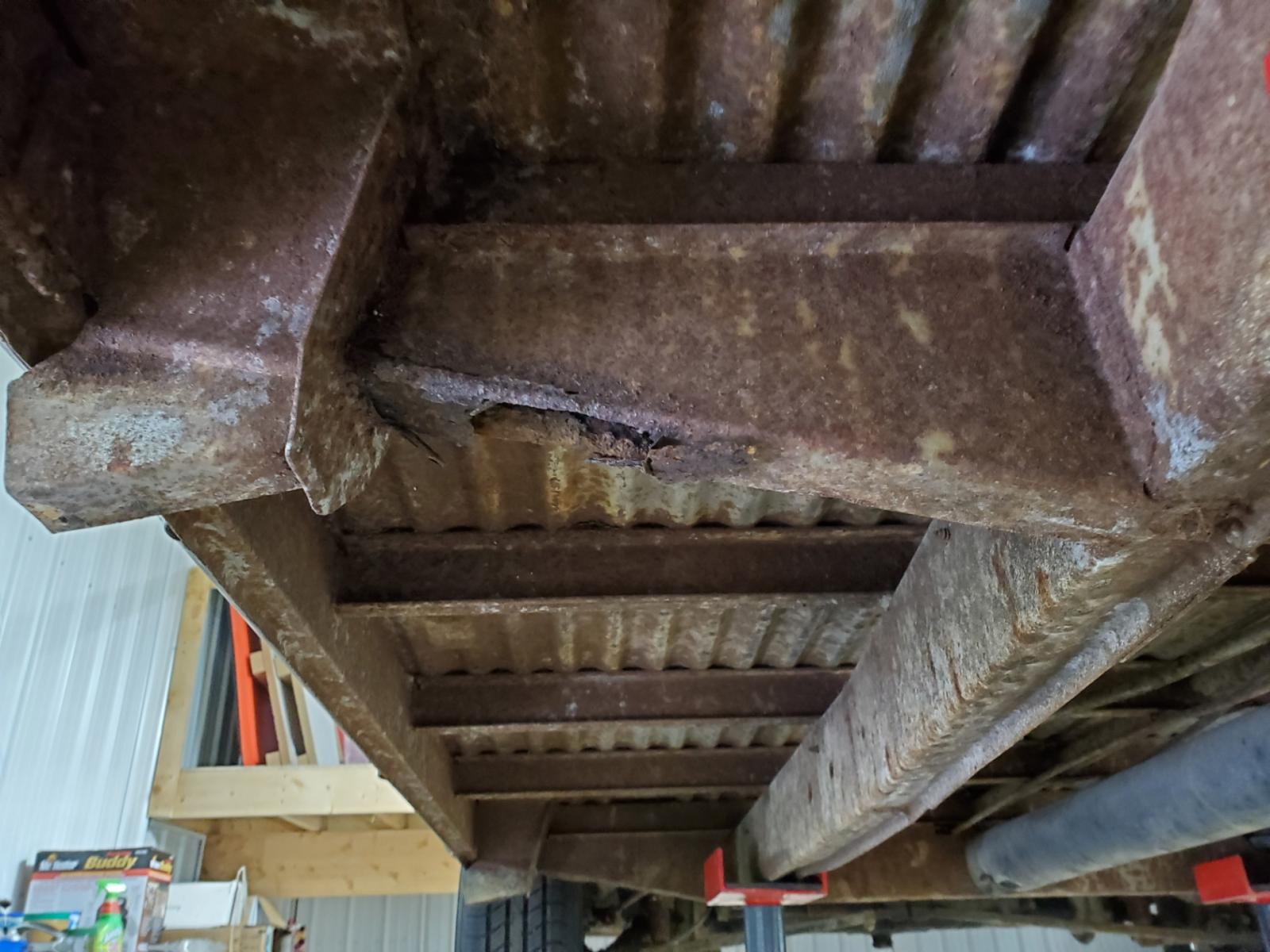

Just thought I would share more about what I'm seeing on the underside of the '64, now that I've spent a number of days under there.
There does seem to be contradictory evidence about the original color of the bus undersides. A search on this forum turned up lots of threads and information about that. After reading all that, it seems possible or even likely that until 1962 or 1963, VW painted the undersides in a medium grey color. Beginning in about 1963, many of the buses mentioned in the threads appear to have much of their undersides painted body color.
So far, I've put in lots of hours so far cleaning up the underside of this '64. Lots of scraping, wire brushing, and rubbing with scotch pads, and several types of degreaser on the greasy areas at the front and back.
It seems clear by the amount of surviving paint under the grime that the bottom of the main (cargo) part of the floor and some other parts were painted an off white - probably the same Pearl White as the body. Under the cab is a somewhat different situation. Parts, such as behind the front valance, the front frame sections, etc. are the off white color. But the underside of the cab floor is either a light grey or a light blue (my wife thinks it's grey, while I see light blue), with some areas having a black coating over that. The white paint on the frame sections under the cab has survived in nearly perfect condition, while the frame and inner rockers behind the cab have virtually no paint on them. It seems that the frame and inner rockers received a different paint process or less paint than much of the rest of the underside. I'm confident that no one cleaned or repainted the underside of this bus before; the hardened grease that was caked on under the cab and towards the transaxle had been there for many decades.
I also suspect that VW dipped the undersides somehow. Especially the bottom of the floor has hundreds of dried paint droplets protruding down from the floor. Maybe the floor and underside was dipped before the body went on??
Unlike restorations of some other makes of vehicles where getting the underside paint right matters a lot, this doesn't seem to be a big deal with VW buses. Maybe that's a good thing.

Pretty sure VW didn’t paint the underside, Ive never seen evidence of it on any of my buses, it’s probably just the epoxy primer which sometimes looks white.
Once that primer is shot it’s shot, it will rust again there with any moisture exposure. When I paint a bus I shoot a couple coats of epoxy primer under there and leave it. You can get light grey and even white epoxy primer.

After spending a little time scraping and wire brushing the underside of the bus this evening, I'm rethinking the POR15 plan. Most of the underside does not have nearly as much surface rust as it first appeared. Most of what looked like rust comes off with scraping and wire brushing. Scrubbing with a cleaner and pads likely will help further. Underneath is much of the original Pearl White paint. It seems a shame to put POR15 over much of that. A couple of pictures below:
Any recommendations on how to handle this? After further cleaning and prep, POR15 on just the areas that need more protection and then spray a coat or two of Pearl White or similar paint on all the surfaces under there? Just clean it and leave it as is? Cover with a clear coat of some sort? .....Or??
looks good to me. I'd not re-paint or re-coat it underneath.
Honestly, if you park it dry and give it a bath and clean where the sun don't shine once a year it should last a long time.
Wash out the rockers and doglegs and jack points where dirt collects in crevices and holds moisture against the metal.
Then again, looks like your bus needs a paint job at this point, so maybe do the underside when the bus gets painted?

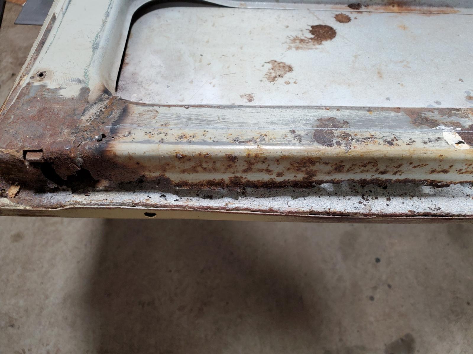

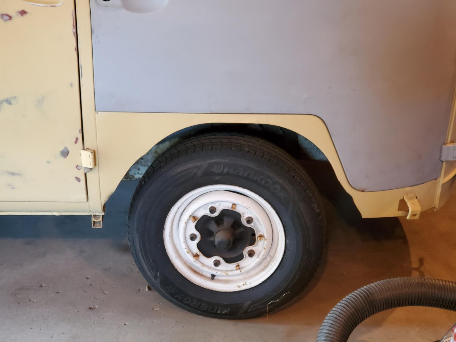

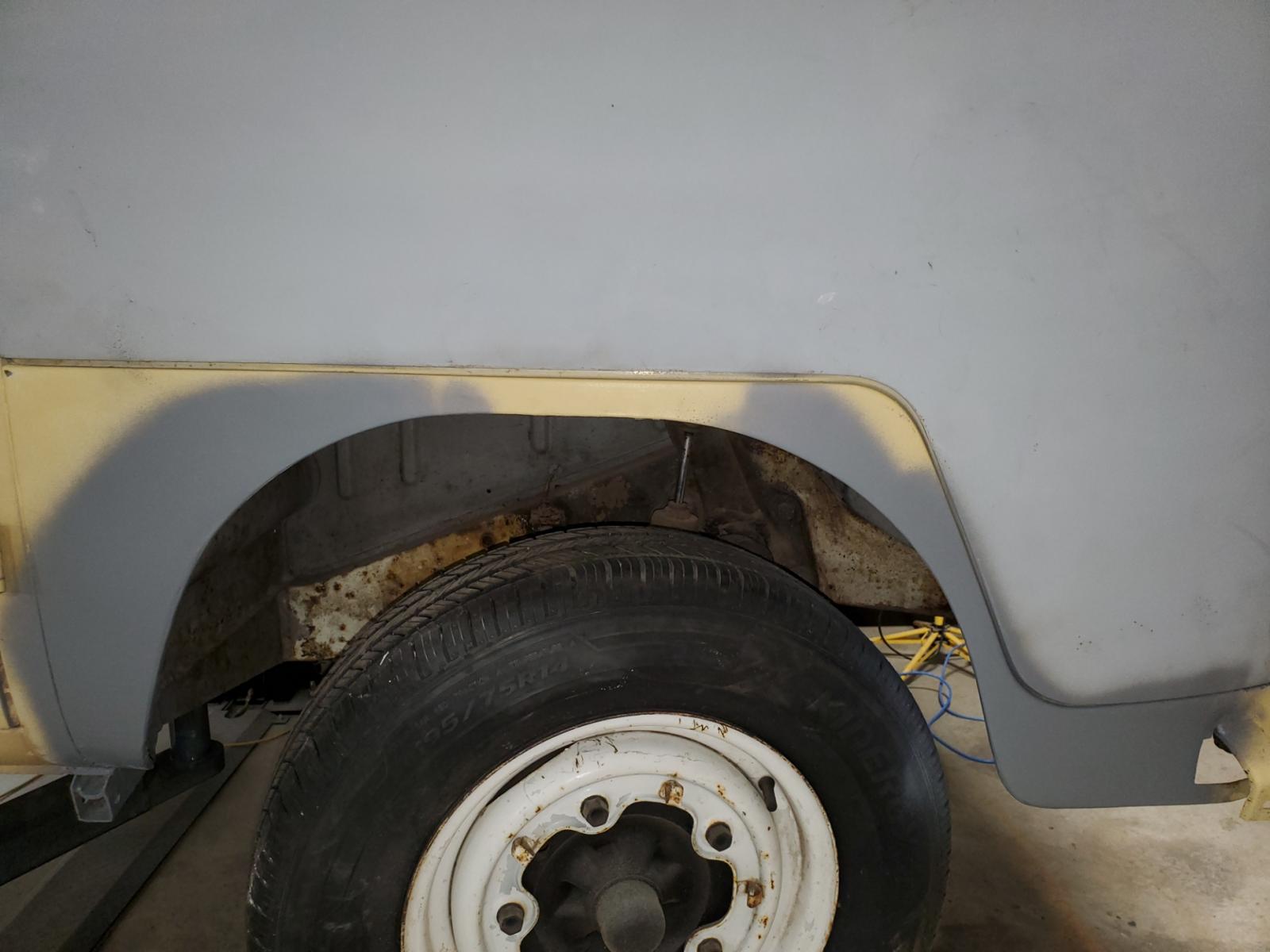

Thought that I would post a few pictures of "progress" since the last post. Main attention is to some of the remaining body work jobs. All four wheels wells had been cut to accommodate larger tires, so metal replacement there was a priority. I am posting a few before pictures and a few of the arches after repair. All four are done. They still needs more finishing; just sprayed a little acid etch primer on those areas for now. (The Klokkerholm panels used for the rear wheel well arches are rather light; I would have preferred heavier gauge panels. For the front, I made up my own repair panels, rather than cut up the new dog legs that came with the bus. They might come in handy for another project some day.)
As seen below, the left rear outrigger had rust through, so I replaced that outrigger and jack point. The inner rocker next to the jack point also developed a small hole as I worked on the area, so I added an 18 gauge plate over that; strength over beauty. Still a little grinding and clean up work to do there. The rest of the underside looks very good, with just fairly light surface rust. The bus never had undercoating, so no peeling undercoat to deal with.
My plan for the underside is to clean it up and then coat with POR15. I've done that before, many years ago, on non VW projects, and it has held up well. I like the POR15 a lot better than Eastwood Rust Encapsulator, which I also have used. Considering the relatively good condition of the underside, I'm not disassembling everything, putting it on a rotisserie, and media blasting it. A clean up and repaint seems like the better (and much easier) option. I'm also shooting non-hardening rust preventative solution of several types (Lloyds AD2000 and RustChek) into cavities that can't be cleaned or painted. That, and the dry garage and dry prairie climate here, should help prevent future rust issues.
Two other rust issues found on the body. Of course the battery area had a hole rusted through, so I replaced the recessed section. And one side door panel had rust through on the lower inner structure. That was an odd one, as the bottom edge and outside of the door was very good. Someone had attempted a repair previously but had not dealt with all the issues. Anyway, it's now rebuilt. I was more concerned with making that solid than with making it look pretty as it will be covered by the door panel.

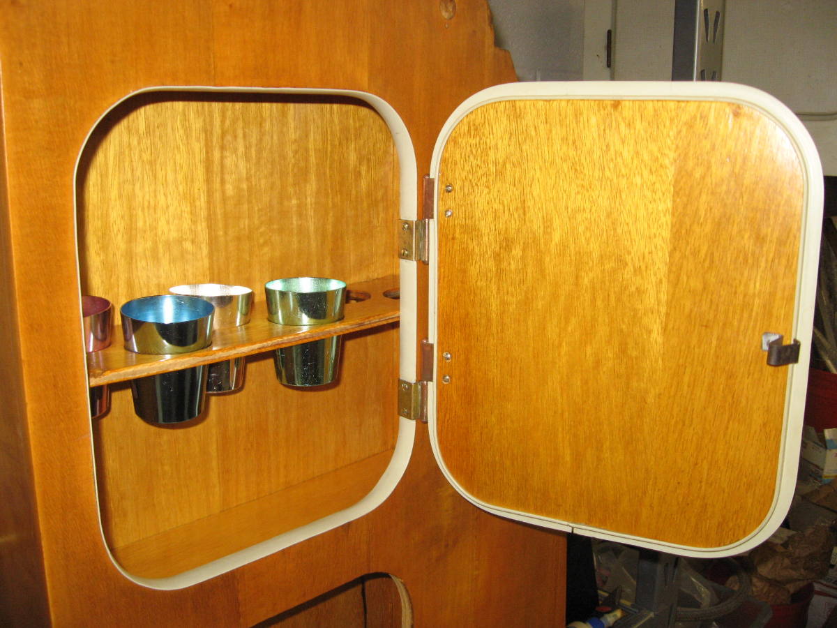

This was the before pic I was looking for :
after scraping and re-finishing and new repro triangle knobs
booze bottle bracket:
