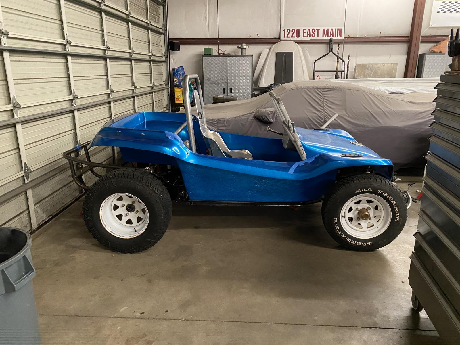

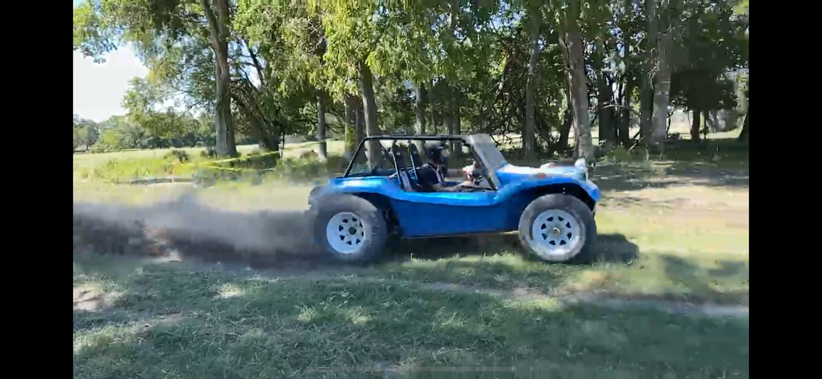

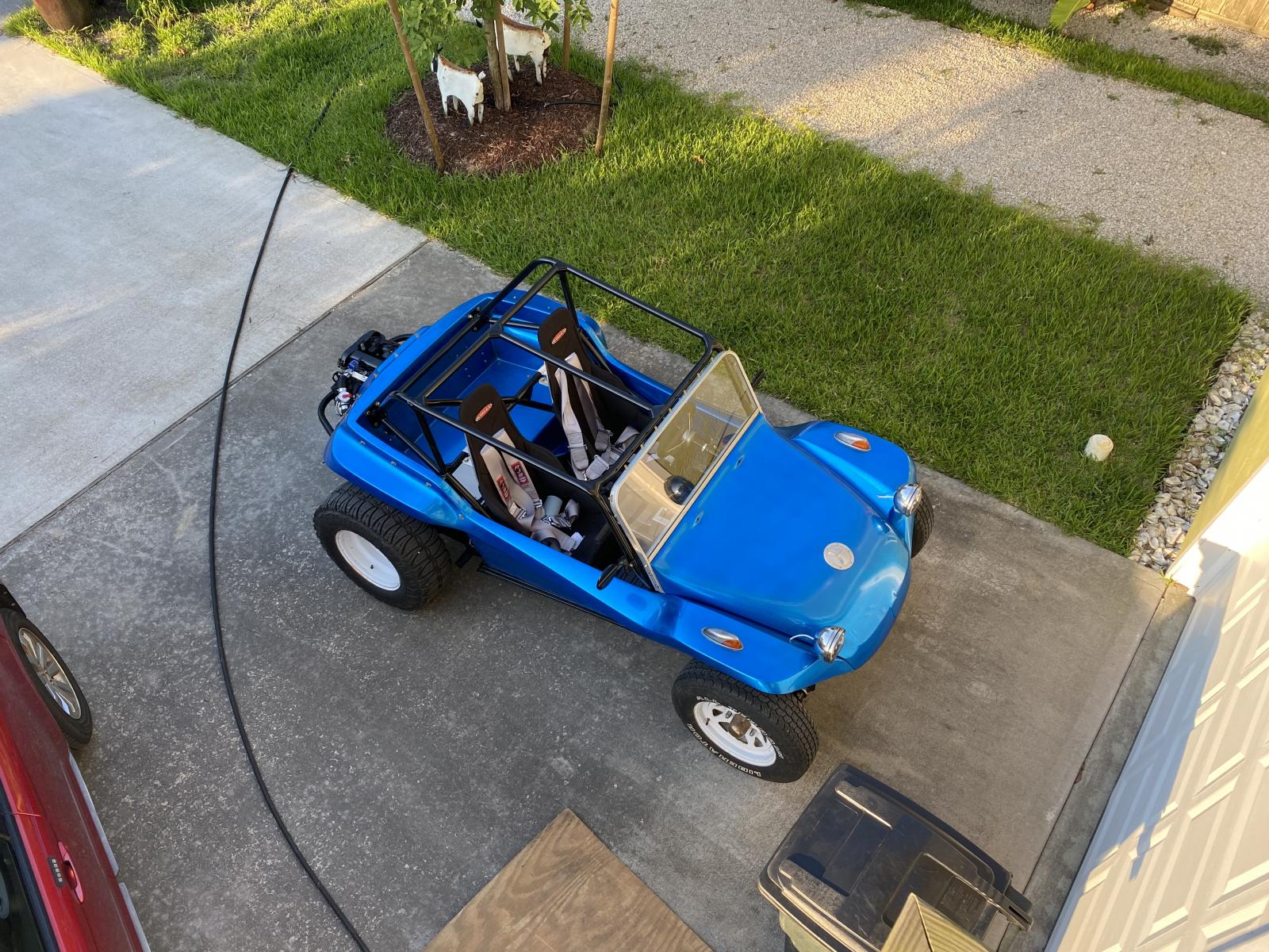

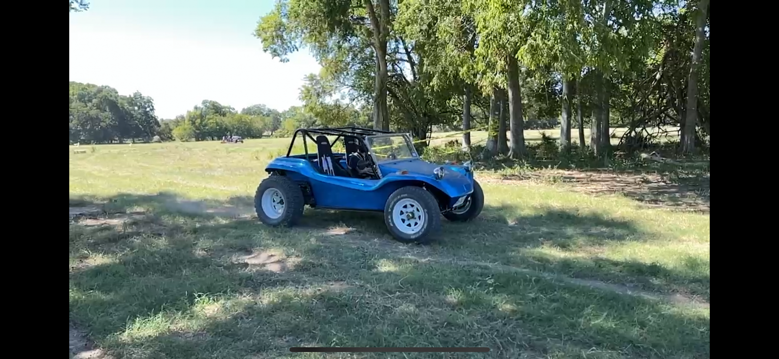

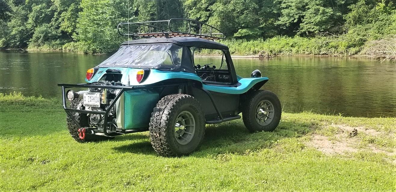

Finally got off the pavement! I I got into some serious whee hop while I was on the throttle, and scattered a type one cv which was no surprise. The reason I run them on the outside is they are cheaper and easier to fix than anything else in the drivetrain, like a mechanical fuse.
Some action shots:

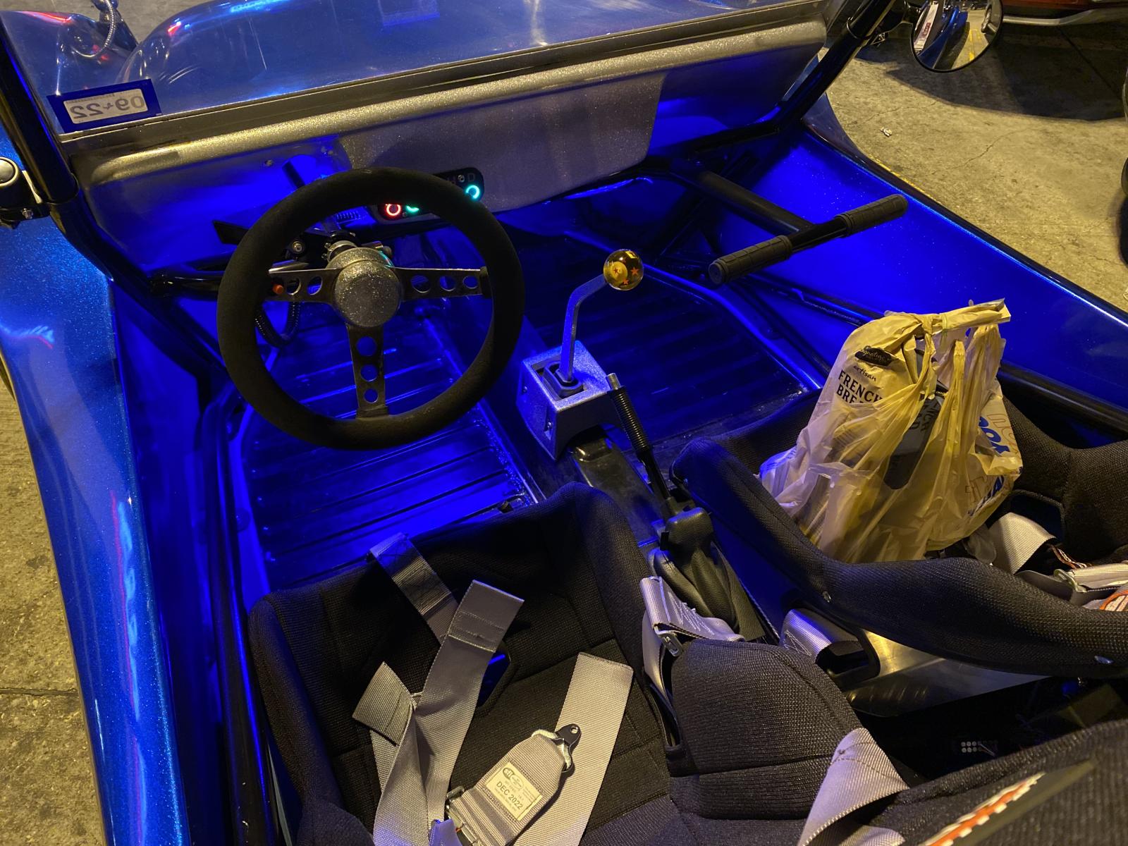

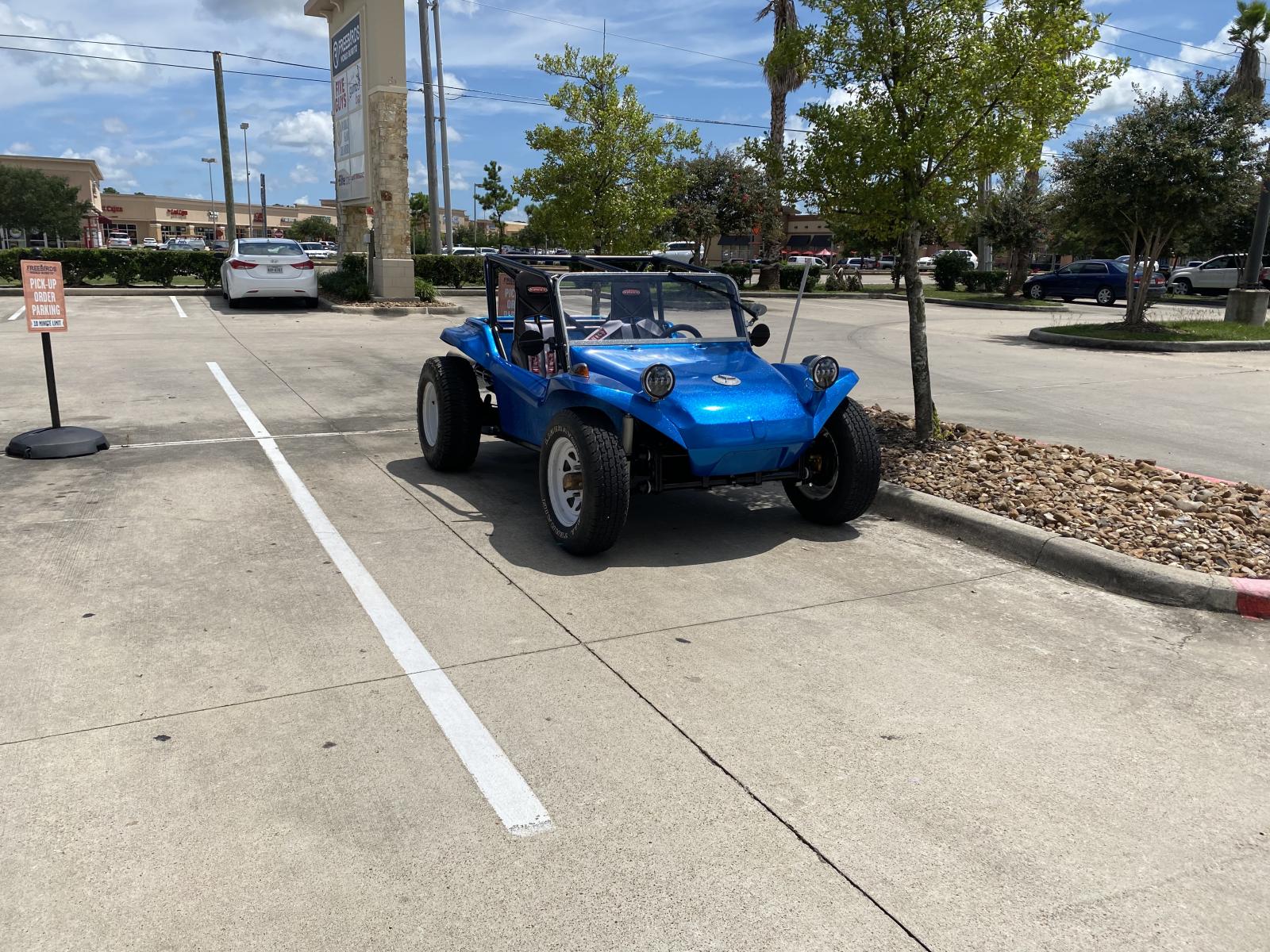

Running great still, trying to drive it more
Grocery getter:

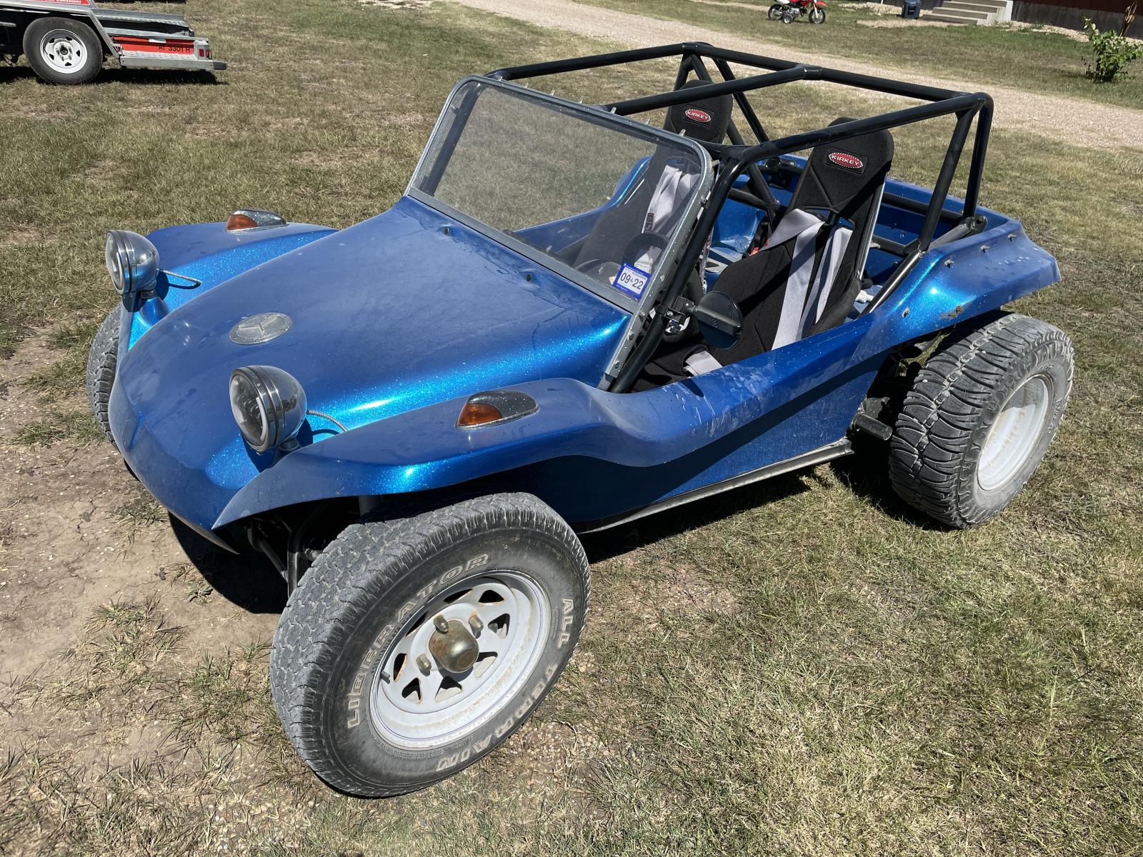

After much delay and chasing paperwork, I have plates/registration/title!

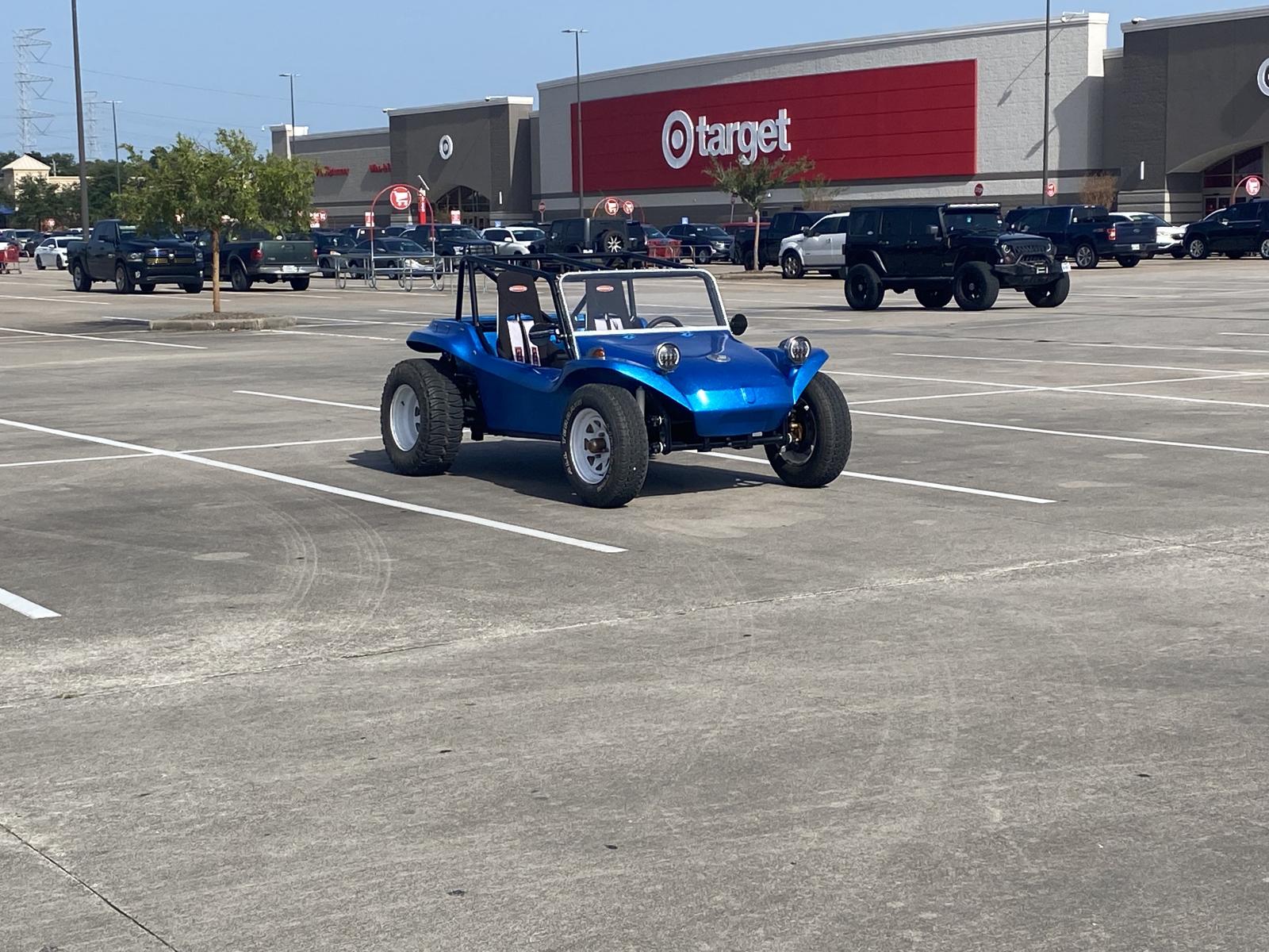

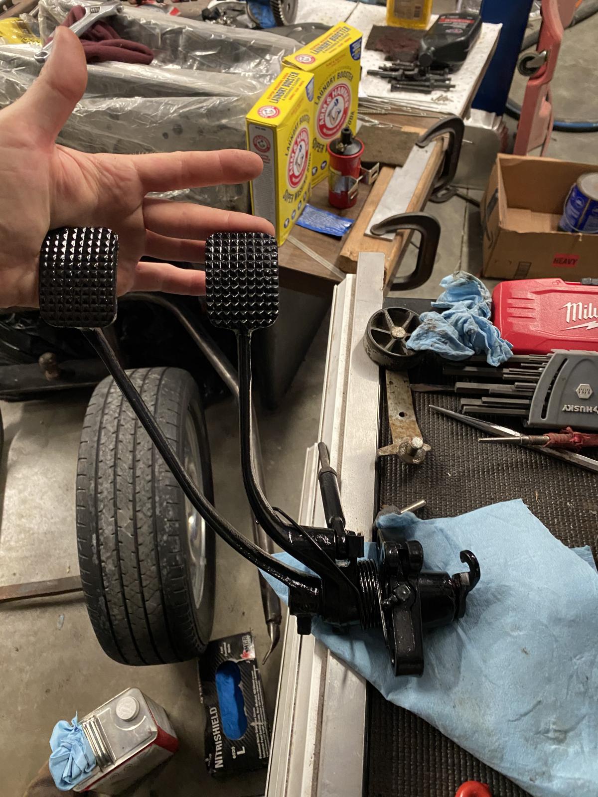

Going through some teething now that I’m putting some miles on it. Clutch cable splice was slipping but some better clamps fixed that issue
It is slowly working the remaining air out of the cooling system, the horizontal radiator with bottom inlet hoses makes it hard to bleed the air out. Now it’s running 173-174 at 50mph cruise.
I finally sent my info in to Winnie, and she confirmed I have a genuine Manx 2 which is exciting!

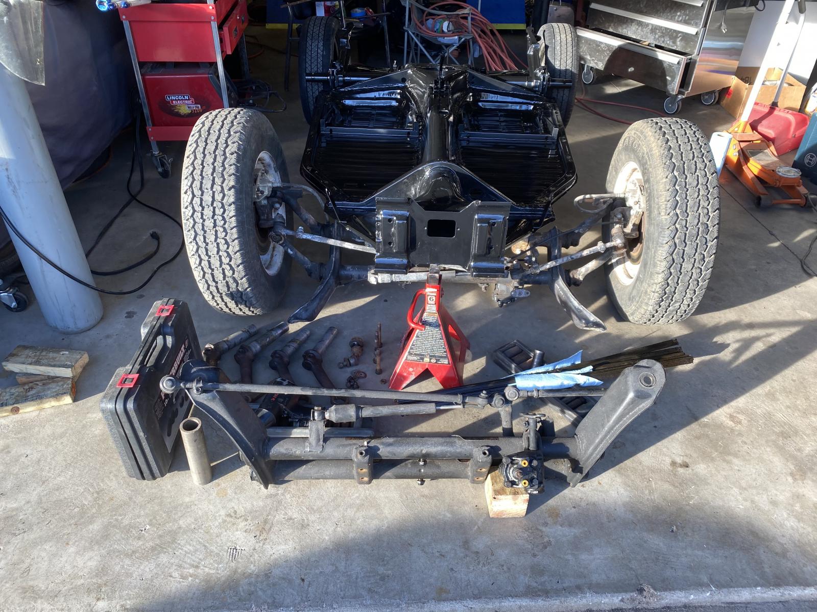

Don’t be too jealous, I have played with air cooled low HP stuff and I’m not sure this is better, but it certainly faster for the same $. The radiator is something I could live without.
I’m concerned about the radiator surviving long term on its side. That along with Suspension seats, skid plates, type 2 outer CVs, window nets, helmet air, radios, gps, better intake, different belts, and needing a bigger fuel cell to race LOL NEXT WINTER

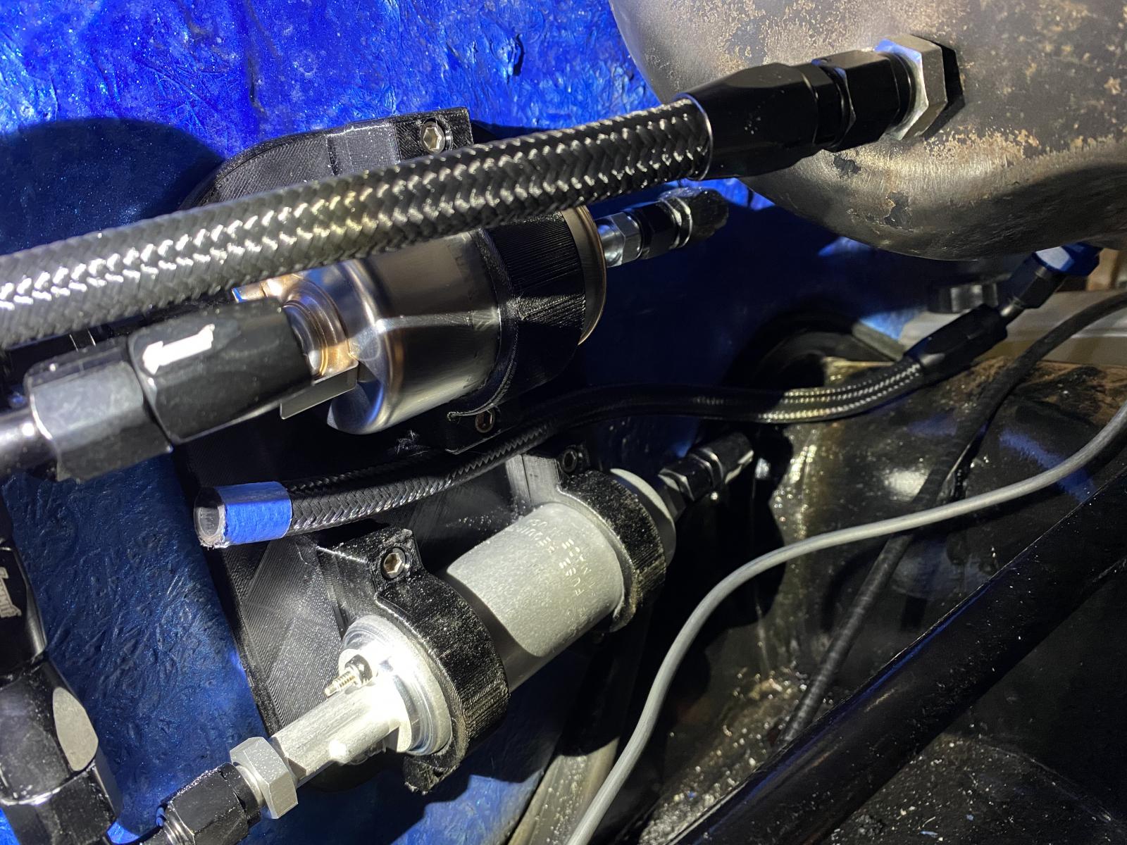

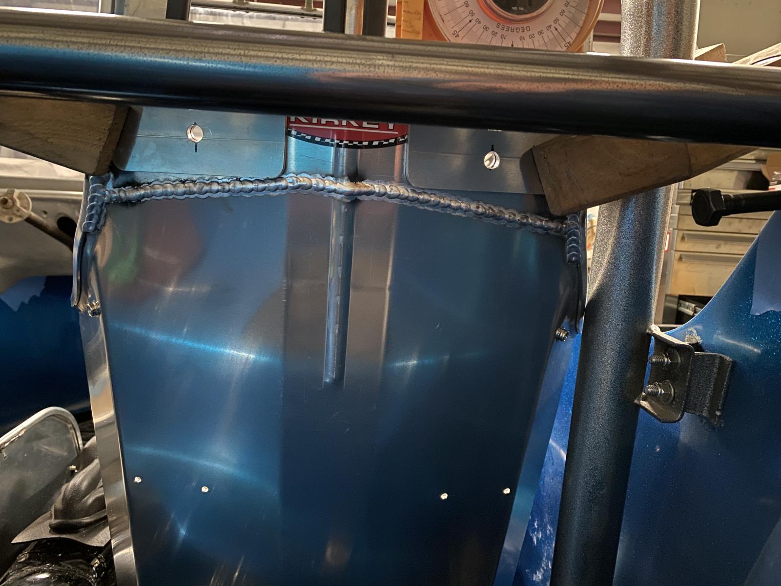

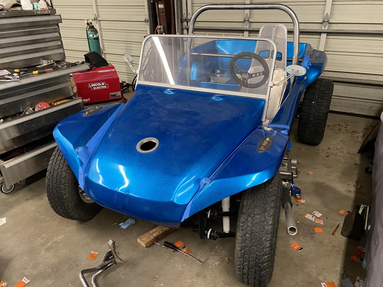

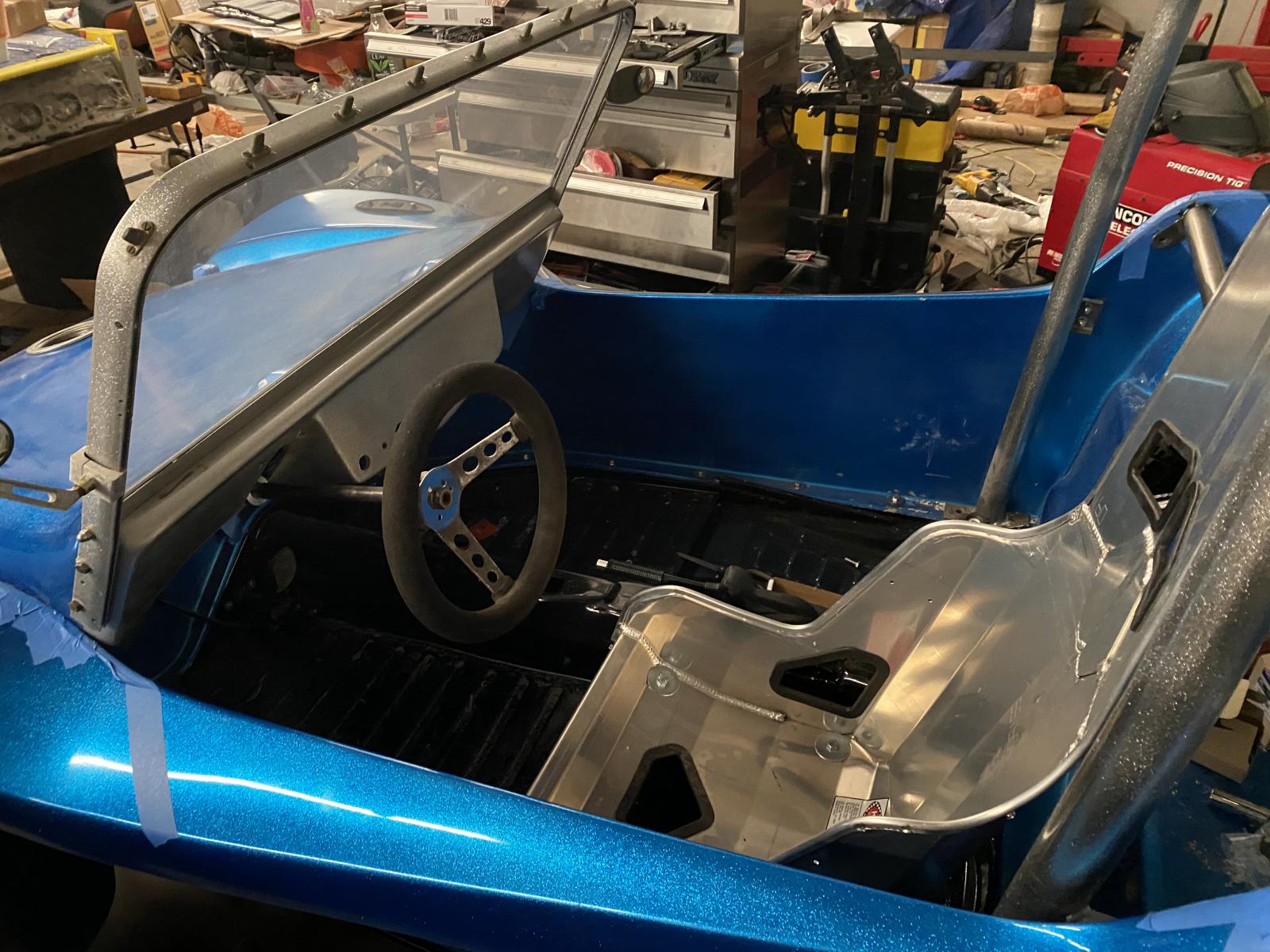

Modified one of the old rear view mirrors to mount a cheap manual wiper, which is required in Texas of you have a windshield.I need to trim the extra arm and mirror off but it works like it is
Fixed a small oil leak on the water pump cover, otherwise it’s running great. The fans don’t shut off once they come on due to the lack of a vss signal so I’ll have to come up with one and pin it to the ecu and tweak the tune, but it’s staying cool so far
