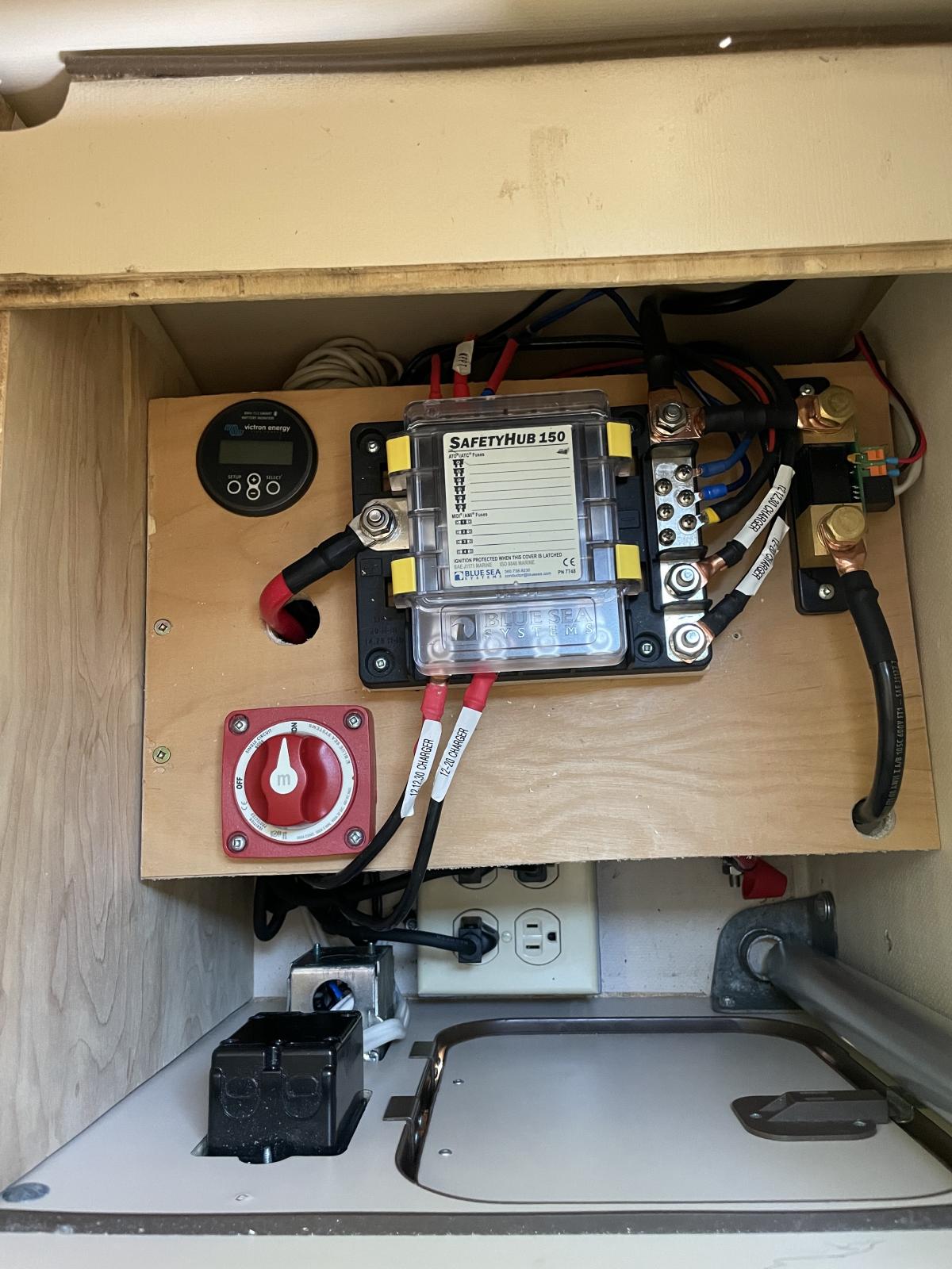

I've seen 160F on the surface of my DC-DC, which is under the driver seat. I don't know what the surface temp would be if it was operating in an open, well-ventilated space, but they clearly get warm regardless.
Wood is not as risk of combusting at temps in this range. For the wood to burn, something else would have to ignite first, and if that were to happen you've got a big problem regardless of the mounting surface!

I'm replying to this thread, simply because I have it booked marked and admire the initial posters install.
In the installation instructions of the Victron solar charge controller:
Mount the solar charger vertically on a non-flammable substrate, with the electrical terminals facing downwards
How hot is this unit really getting?
Are they being overly cautious?
I'm planning my install, but I see many are mounting their controllers directly to
cabinets and plywood.

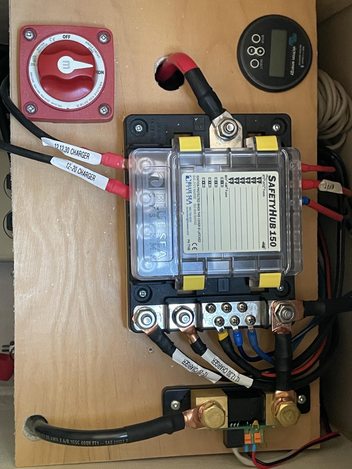

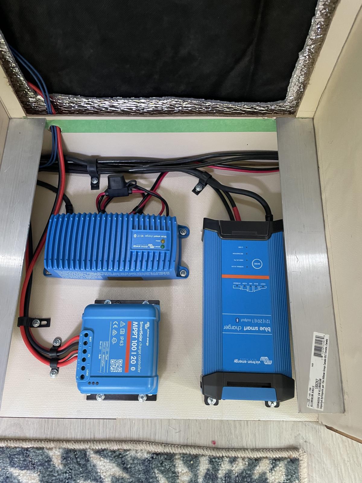

PostPosted: Sun Sep 24, 2023 10:49 am    Post subject: Re: One more auxiliary battery installation – ’85 Westy Reply with quote
Nice clean install!
One question, can you access the Victron' buttons under the fridge?
On my Victron shore charger I cut an access panel so I could change the charger to LiFePO4. Will the charger remain in that mode?
If it stays in that mode then I went to a lot of extra effort for nothing Confused .
Also, FYI, my shore charger gets pretty warm.

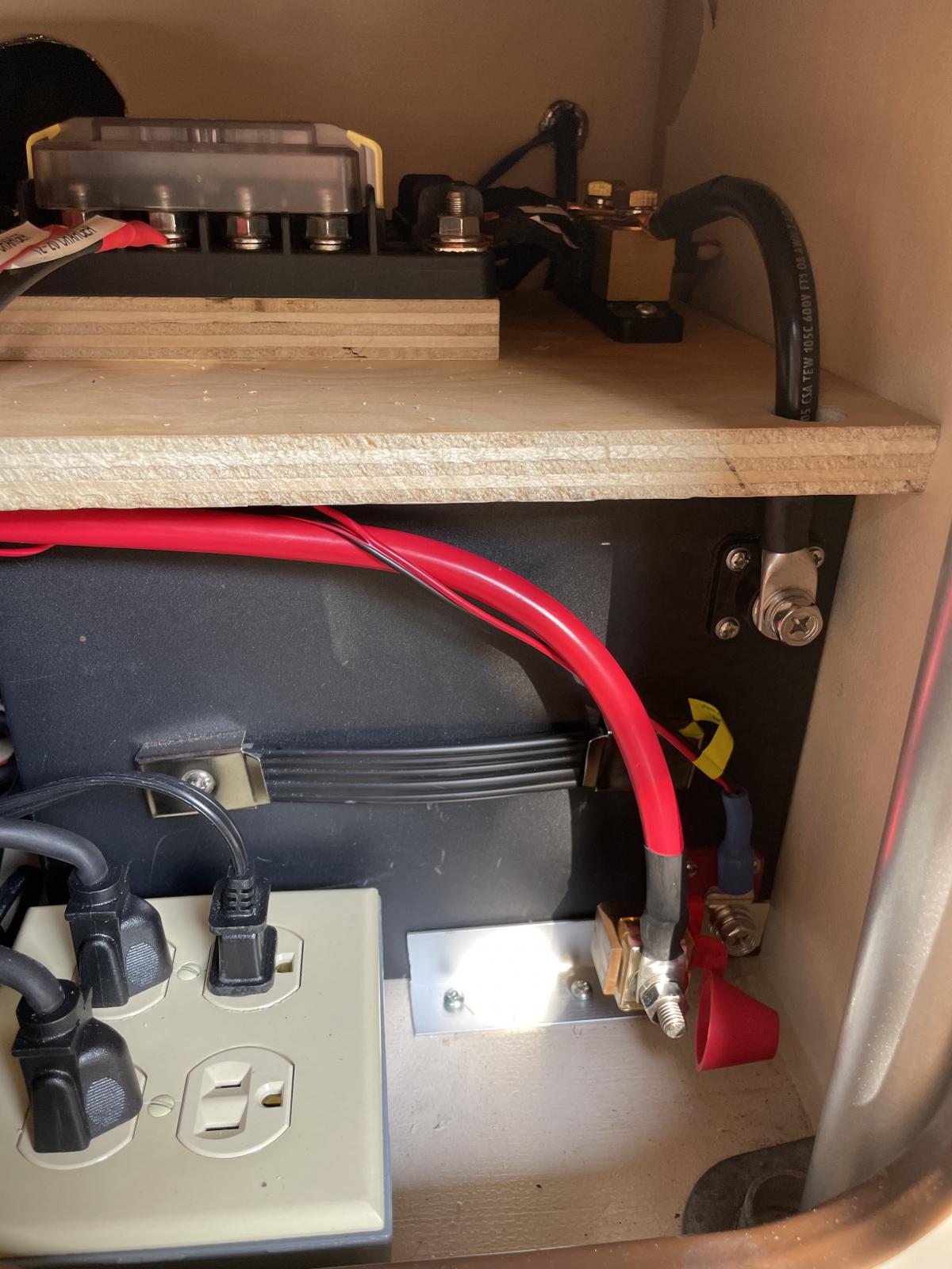

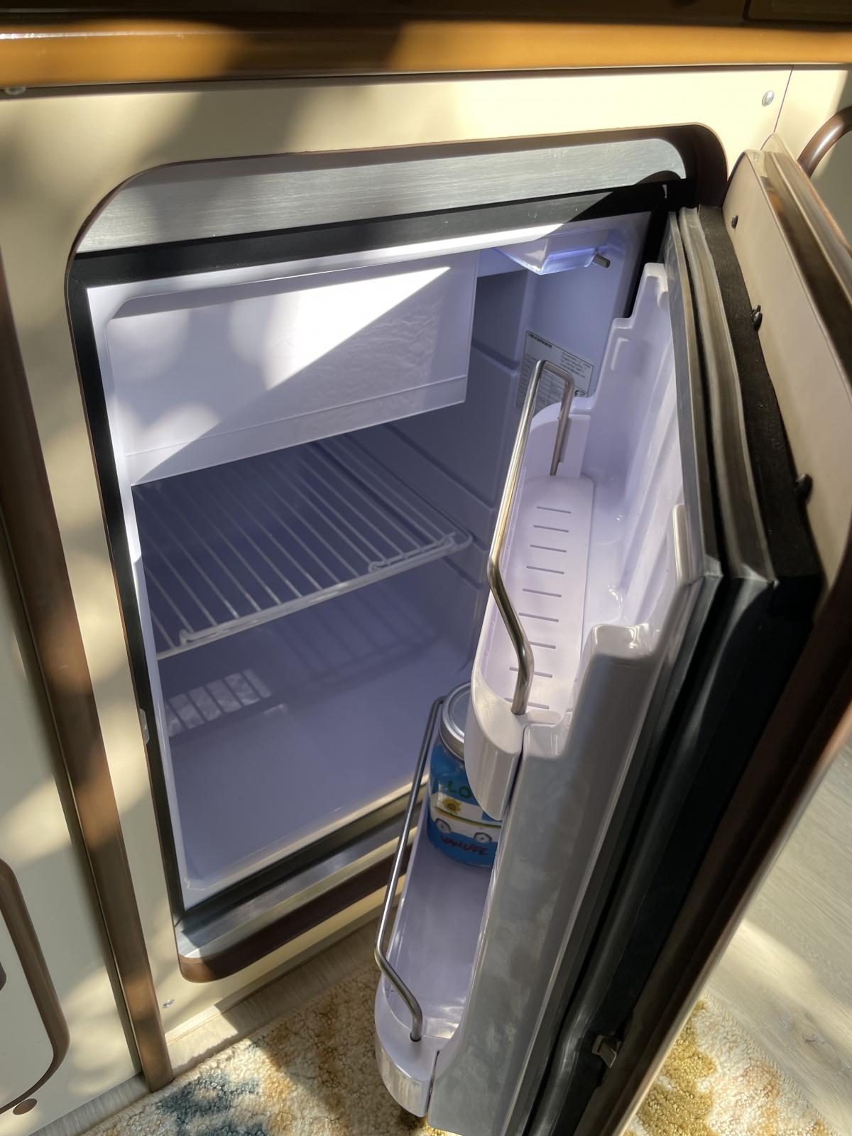

Vanuber - thank you.
This post took me a while for a bunch of reason. But here it is. It took me a while to install the TF49 in stealth mode.
That was no small task as I had to modify both the fridge door and back of the unit to accommodate the metal horizontal brace bar running across the van body. But I'm very happy with the result.
I'm running a 100ah lithium SOK battery and get three days off it to run the fridge and charge phones, etc. I don't have an inverter and don't intend to use one anytime soon. So as you'll notice my battery is wired with 2 AWG which is more than enough to handle the load of my fridge, lights and iphone/ipad charging.
I put the MPPT, trickle charger and battery charger under the fridge.
I ended up putting the DC/DC charger under the sink. You had mentioned that it generated a lot of heat - but I'd already installed it there so I'm going to see how it goes. So far it doesn't seem to generate that much. I wonder if it's because my alternator is not as powerful - it only generates 65 amps.
The switch is for the DC/DC charger. The horizontal wire (white to black) is the wire connecting the van battery to the trickle charger. I need to add an on/off switch there. What would you recommend. It doesn't need to be greater than 20amps from what I've figured out. But switches for that amperage seem small and cheap. Thoughts?
As to the house battery I've put it to the left of the fridge. It's not my final set up. I don't have a water tank in the original space so this seems to work. I'll put a protective plexiglass sheet on top. And then I cover it with the regular shelf for that space. As you'll notice I put in a 4 prong plug for when connected to shore power to charge the batter, run the fridge and also the trickle charger. I could not put in an on/off switch for the trickle charger and instead simply unplug it too I guess. I haven't yet fully secured down all the wires as I'm still thinking this through.
I'm not fully settled with this part. So I'm happy to hear any suggestions on how you might modify this part of the setup. Be blunt!
For now it all works! Thanks. I definitely think I've ''over engineered" this thanks to your inspiration. But here we are. Thanks for the help!

PostPosted: Tue Jul 25, 2023 1:39 pm    Post subject: Re: One more auxiliary battery installation – ’85 Westy Reply with quote
openroad65 wrote:
I just fished the wires under the van, above the gas tank for the DC charger and winter battery charger. I learned that you really can't be claustrophobic if you're going to work on a van. That was a total pain.. Question. I'm not building out a board behind the driver seat the way you did. I'm thinking of placing the DC/DC charger inside the cabinet under the sink to keep the look clean. What's your experience with heat? Is that going to be ok in there? Or should I mount it on the outside of the cabinet behind the driver seat? Thanks..
I can't speak to all DC|DC chargers, but the Victron Orion gets HOT. I would want to keep it out of the cabinet for better airflow. I am sure it would still work in the cabinet, but I would assume its efficiency would diminish as heat builds up. And maybe longevity? It has a big heat sink for a reason.
Check out the user manual. If I recall, they have pretty specific mounting requirements.
