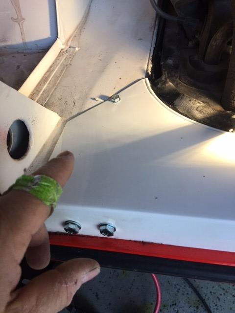

PostPosted: Fri May 07, 2021 8:49 am    Post subject: Re: 1966 dash knobs (photos included) Reply with quote
Checked out as not stolen.
I'm thinking more that it used parts of a 66 and 67.
ToolBox
Joined: January 27, 2004
Posts: 3439
ToolBox is offline
PostPosted: Fri May 07, 2021 8:45 am    Post subject: Re: 1966 dash knobs (photos included) Reply with quote
markeaton wrote:
Oh boy.... I found it. Not good. Third digit a "7".
Might want to run the VIN through NICB's VINCheck to see if it is hot. Would suck to put a ton of cash into it if it is on the hot sheet.
https://www.nicb.org/vincheck
peecee69
Joined: January 27, 2005
Posts: 1592
Location: Annapolis, MD/Bloomfield Hills, MI
peecee69 is offline
PostPosted: Fri May 07, 2021 8:09 am    Post subject: Re: 1966 dash knobs (photos included) Reply with quote
That is your actual VIN. Time to send off for a birth certificate to figure out what it used to be.
Then ignore most of it, repair what needs repairing, drive it, and enjoy it.
1973 Standard Beetle - running maintenance thread - https://www.thesamba.com/vw/forum/viewtopic.php?t=675712&highlight=
1966 Doublecab - Starting resto - https://www.thesamba.com/vw/forum/viewtopic.php?t=668518&highlight=
View user's profile Send private message Send e-mail AIM Address Yahoo Messenger Facebook Gallery Classifieds Feedback
markeaton
Joined: July 09, 2013
Posts: 686
Location: Seacoast NH
markeaton is offline
PostPosted: Fri May 07, 2021 7:14 am    Post subject: Re: 1966 dash knobs (photos included) Reply with quote
Okie Adam
Joined: November 07, 2003
Posts: 1347
Location: OOOOOOOOOOOOOOOOOklahoma
Okie Adam is offline
PostPosted: Fri May 07, 2021 6:55 am    Post subject: Re: 1966 dash knobs (photos included) Reply with quote
The diagonal edge of the apron, that is
Oil Capital Air Cooled
55 Wolfsburg Kombi
60 Walkthrough Kombi
62 Single Cab
66 21window
67 so42
76 Westy
64 Karmann Ghia
Okie Adam
Posts: 1347
PostPosted: Fri May 07, 2021 6:54 am    Post subject: Re: 1966 dash knobs (photos included) Reply with quote
Other side, above the edge with the screw through it.
55 Wolfsburg Kombi
62 Single Cab
66 21window
67 so42
76 Westy
64 Karmann Ghia
markeaton
Posts: 686
PostPosted: Fri May 07, 2021 6:37 am    Post subject: Re: 1966 dash knobs (photos included) Reply with quote
Is it under my finger?
Okie Adam
Posts: 1347
PostPosted: Fri May 07, 2021 6:24 am    Post subject: Re: 1966 dash knobs (photos included) Reply with quote
widehatch wrote:
Shouldn't be under the apron. In this pic the rusted area is what the apron covers. The vin should be right above the edge of the apron.
55 Wolfsburg Kombi
62 Single Cab
66 21window
67 so42
76 Westy
64 Karmann Ghia
