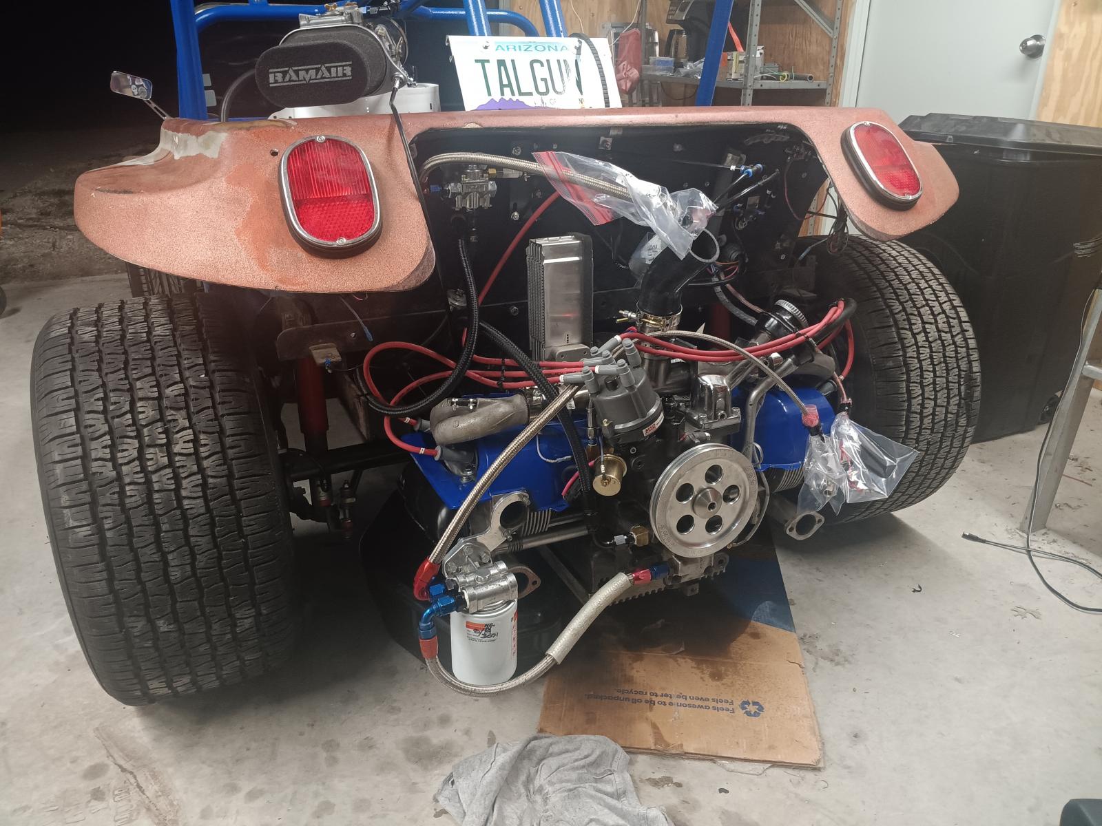

So, a bit of an update... I guess.
I've had a hell of a time trying to tune the carb on this thing. Pig rich, fouling plugs on the low speed circuit, difficult to start no matter what jets are in it Mad I was ready to give in and called Ron Lummus about a 4bbl carburetor and would it be any better on the street? He asked about my turbo and says I have the wrong turbo, not the wrong carburetor! It should be able to sit there and idle all day with carbon seal turbo with a 3" compressor inlet. Long story short, there's a new Garrett turbo coming from Ron Lummus.
The last couple of times I checked the valves, most of them were tight. Dammit... The valves are tuliping or the seats are being pounded into the heads. Either way, they won't last, so I got on to the waiting list for Greg Tims to make me a proper set of turbo heads. My credit is resting for a while Embarassed

Update, Sunday afternoon.
I made it back to the shop and cleared up the wreckage of my morning attempt to get some gas. Removed the damaged cord and sensor element. I plugged the port in the exhaust and taped up the lose wires associated with the afr and set off to try again.
This time I saw the boost gauge hit 5.5 psi. (Keeping in mind that the boost controller is set to 7 psi right now) This is just stupid fun. Like an old dope fiend, I've had my first hit of a mind altering drug, and I want more! Evil or Very Mad
Sadly, no more "tests" until I get a new afr gauge.

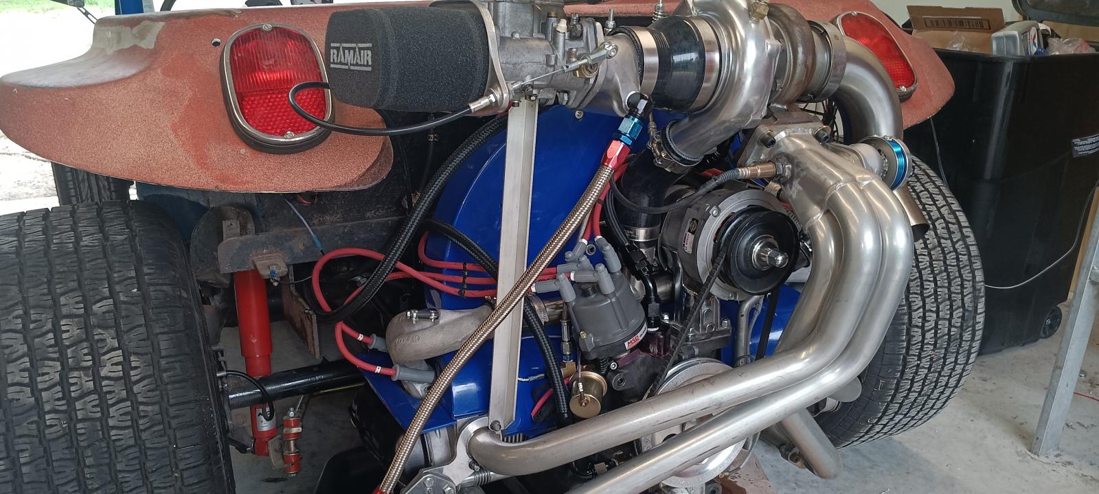

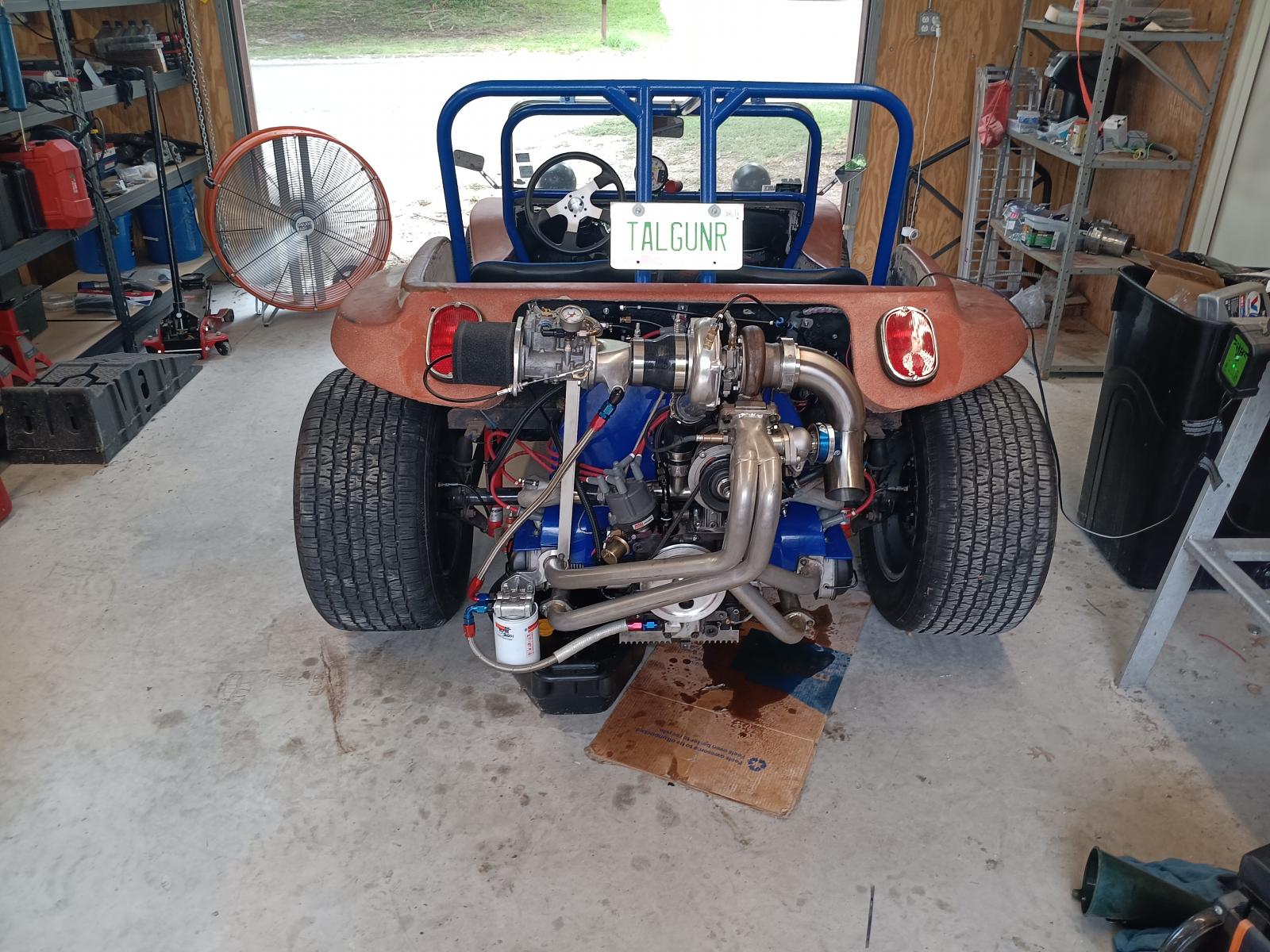

Sunday morning update!
I've been struggling with the jetting of the 45 DCOE on the turbo. At idle it peaks out the afr gauge and dies. I've upped the idle jets to "almost there", but it ran pig rich once i get it off idle. I put in some smaller mains and, again, it's "almost there". Enough so that it's time to go to the gas station, before I run it out of gas in the shop Confused
Gently and quietly Shhh down the street, and out onto the highway. In second gear with 3 pounds of boost it's spinning the back tires and hauling ass... I get third gear and instantly a huge racket that matches engine rpm. I know this can't be good... Mad
Turns out it sucked the afr cable into the fan!!! Aarrrgghhh! I mean YYAAAYYYY! It's not engine damage! Trouble indeed, but easily fixed.
Be well guys

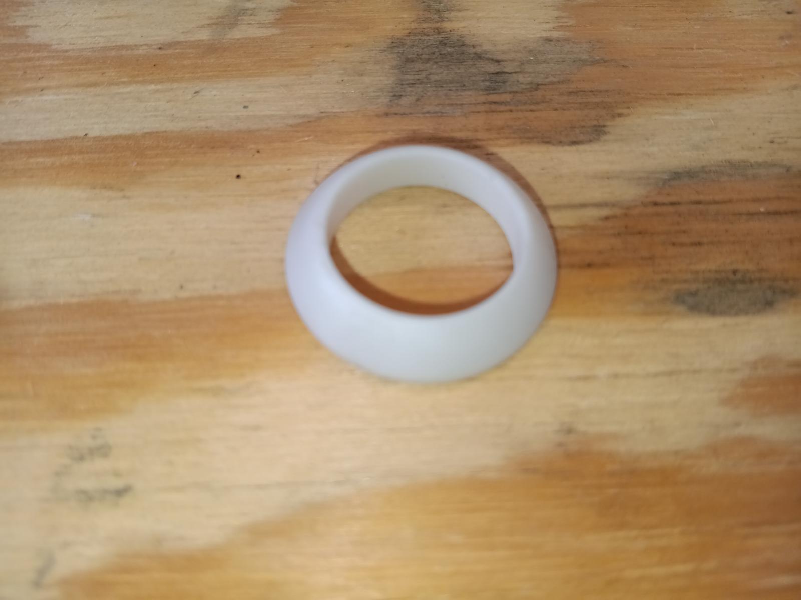

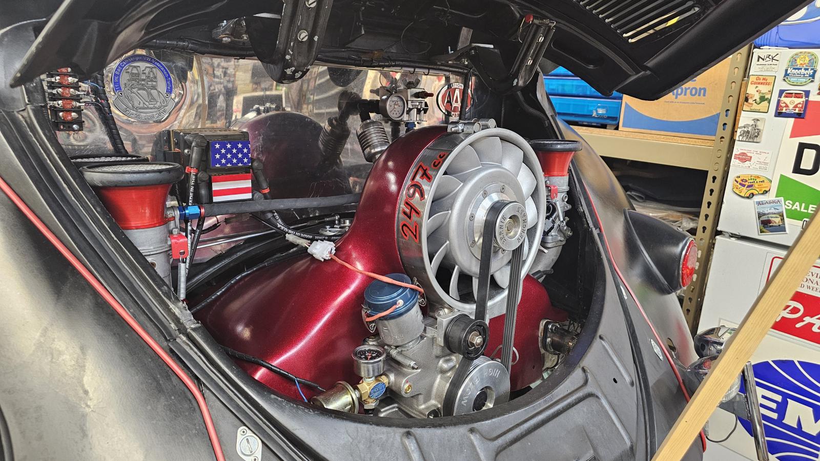

slayer61 wrote:
67rustavenger wrote:
Good job getting the PR tube to seal.
I did try to explain the process you used above. I guess I didn't do a very good job of spaining. Confused
That's 'zactly why I kept trying! Perseverance and all that!
I was a buddies shop in Portland Saturday night.
We were there for a pre-Bonneville get together.
While looking at his car on a lift, I noted the PR tubes were leaking/weeping a little and commented on it. My comment got kinda blown off.
There was no way I was gonna touch that 2497cc engine without the owners permission well, at least until we get to Bonneville then, I can get my hands on his car and fix things that need a little help. But there's not much help needed on that well sorted car,

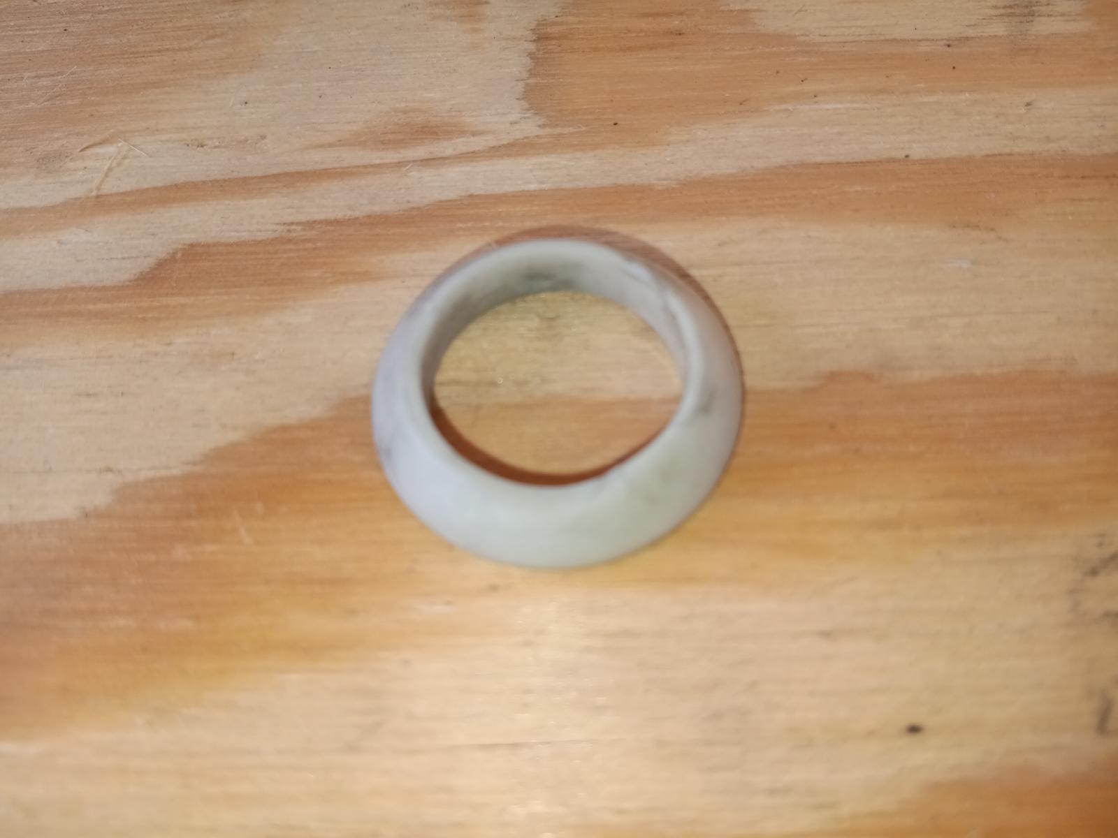

PostPosted: Sun Aug 31, 2025 12:21 pm    Post subject: Re: slayer61 finally has a Dune buggy! Reply with quote
So it seems that getting push rod tubes to seal, is just a matter of holding your tongue right. Rolling Eyes I used my patent pending push rod tube compression tool (a short length of mule tape half hitched onto the tube) to compress and re seat a couple of tubes with enough success to stem the flow of oil hemorrhaging out! Huzzah Very Happy
Now I just need to sort out my DCOE accelerator pump's failure to do it's intended task.

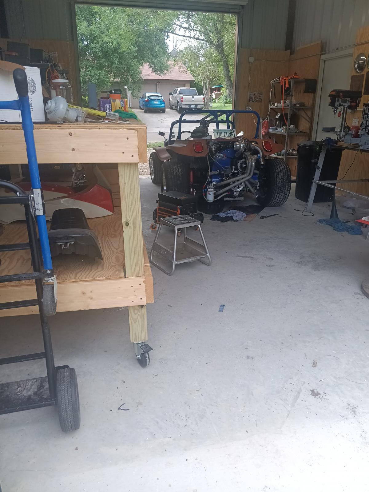

I have a suitable work bench my engine stand is on, I just don't have a run stand yet Confused
And yes. My work bench is almost as tall as the buggy roll bar. Very Happy

Thanks for your input. I have JayCee push rod tubes. One of them wasn't seated when I experienced the first leak. I replaced the seal and reset the tube, but the leak continues. I pulled the fan and shroud to inspect the dog house cooler and it's clean and dry.

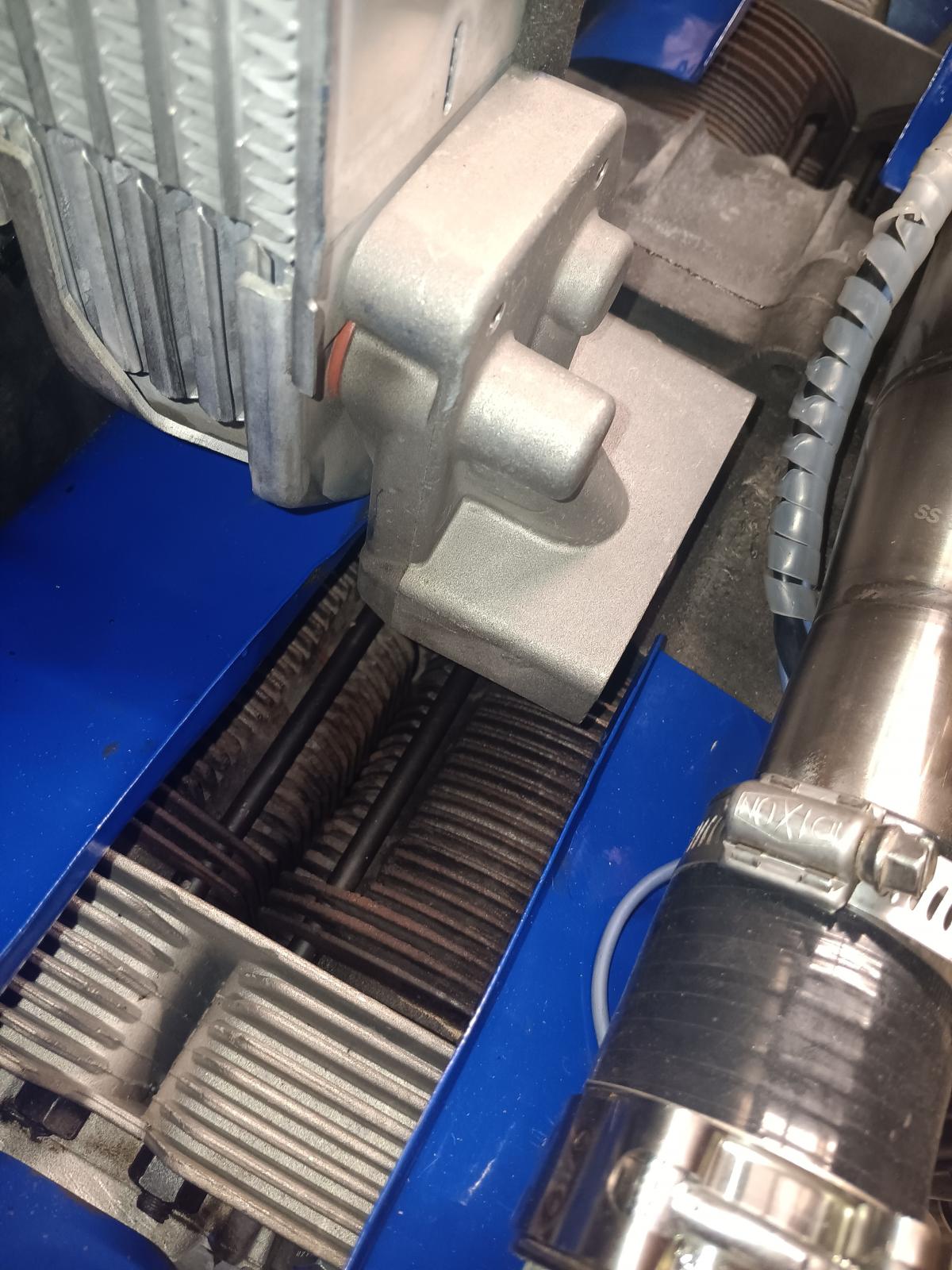

Well, the oil leaks are disappointing, as you well know.
What pushrod tube are you using?
My 2276 leaked like a sieve when I fired it off a few years ago. The pushrod seals were leaking.
I use JayCee PR Tubes. I pulled the tubes loose against the springs and wiggled the tubes and seals a bit to get the seals reseated. No more leaks.
Unless you didn't tighten the oil cooler well, you may have jostled the seals a bit but, that's not a likely scenario.

Turbo update
My turbo drain hose, from RAD showed up yesterday and got installed this morning. Check. Game on.
Motor filled with Valvoline's finest 10-30. Done.
Removed plugs and disabled the ignition. Done
Turned on ignition to fire the fuel pump and bench set the fuel pressure regulator to 3 PSIG. Also tightened up fuel inlet so fuel leak would stop.
Cranked engine over until oil showed up at the end of the turbo oil feeder line and hooked it back up.
Plugs back in and ignition enabled.
Time for test fire Laughing fingers crossed
It fires and sounds bad ass! Cool it has an oil leak... dammit Embarassed
It appears to be running out of one of the push rod tube seals
Smoking gun found and replaced
Now it's leaking like the Exxon Valdez
Double dammit
Now I'm wondering if I didn't upset the oil cooler seals when josteling the fan shroud on and off... Evil or Very Mad
ALSO dammit I found that the rubber 45 degree hose from the turbo collapses under vacuum
Long story short, I expect it's coming back apart to redo the cold side tubing and inspect the oil cooler and seals
