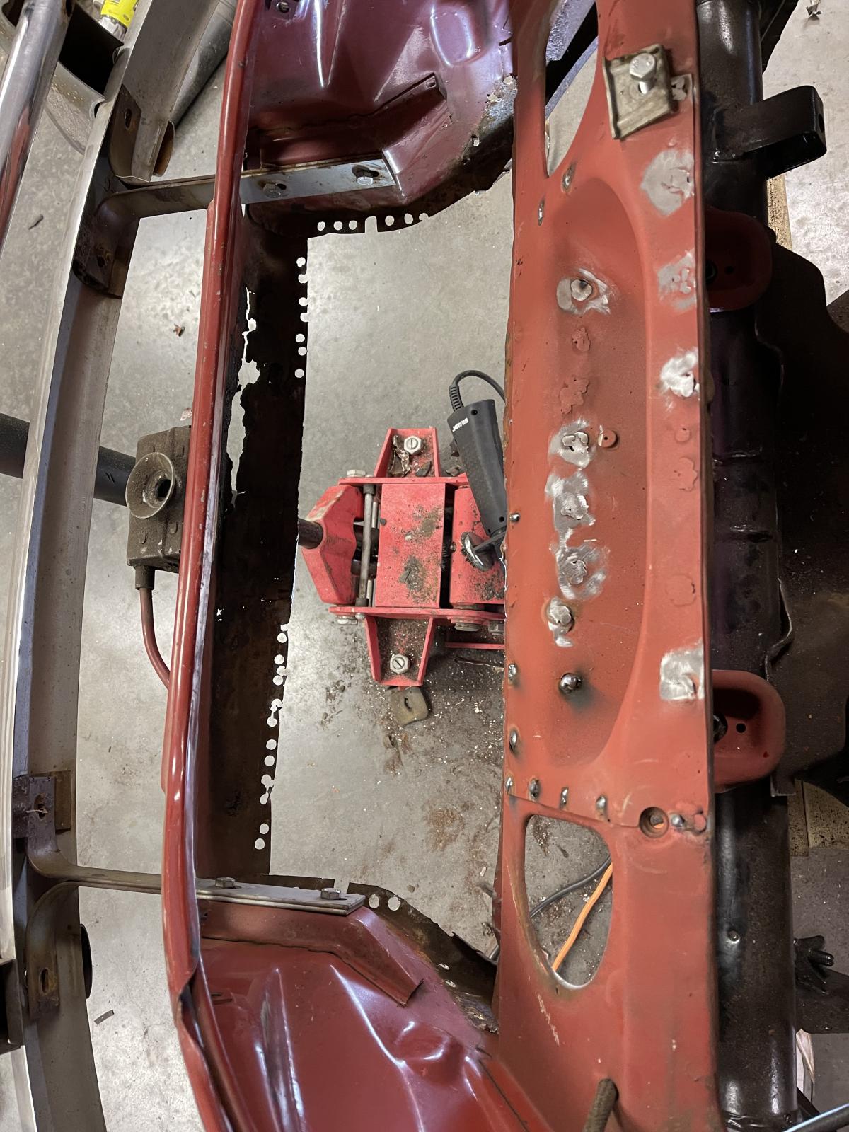

Had some early days at work the last few days, so I’ve been working on getting the channel in place, as well as the rear cross members.
Went out to the parts car and took a few of these off of it. I don’t plan on using them, just needed them to align the car properly.
That was the first day. Got it trimmed up and sort of fitting.
Second day I played with the cross member and package tray area.
Close and almost ready to weld.
When I was done I decided to weld up some extra holes in the decklid that have been bothering me since the day I bought it.
