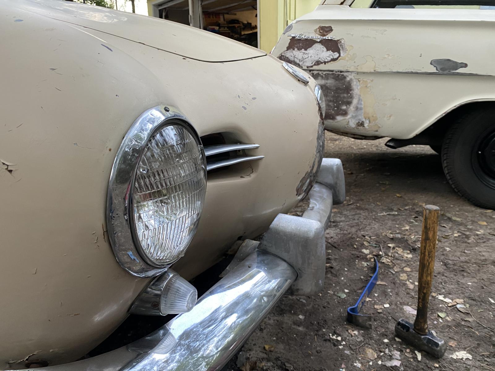

OTO X58 wrote:
Last weekend, I left bright and early to drive the Ghia out to the 1st Saturday EASY Porsche gathering out in Emeryville. I left at about 5am with very little traffic over the hwy17 mountain pass. The 6V headlights did their best!
If you find yourself wanting to drive your 6v Ghia at night often these LED headlights are well worth the investment. Because they work down to 3.5v there is no flickering at idle, and no need for inline resistors or anything else, just plug and play (you will need domed 7" H4 headlight housings). They are very bright, like close to modern car headlights bright. I love mine. They do give off a white light instead of amber, so they're not for the purists (at least they're not that annoying blue-white). They're out of stock at the moment but they do get more.
https://vintagecarleds.com/shop/bulbs-only/vcm3-bulbs-only/
Not the greatest photo, but between the steering wheel and the dash you can see how well they light the road, even at sunset. No photo editing, but it wasn't as dark as the photo makes it seem. Dash lights are also LED.

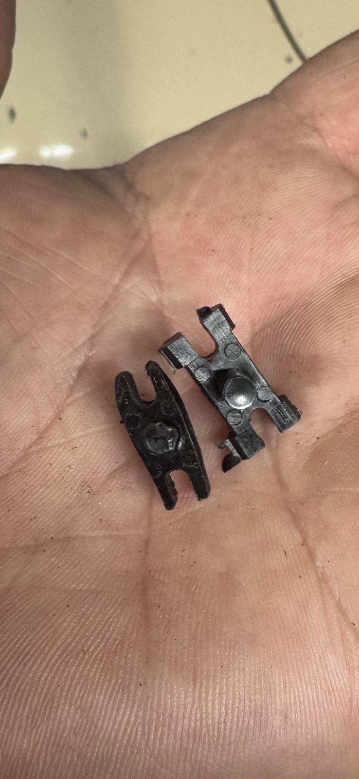

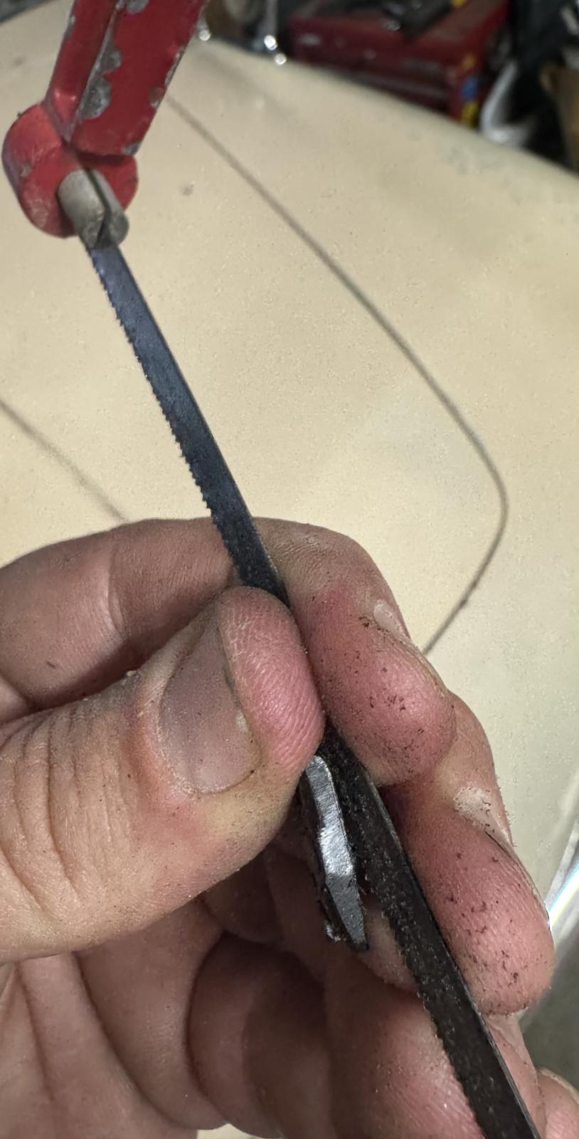

Another small job. I tackled installing the trim molding on the interior under the quarter windows. The car came with the molding, but the clips have been on back order for many months. So I decided to just make some spare extra body clips work.
Rear without molding.
The body molding clips did not fit into the interior molding because they’re too big. So I had to modify them to work. I’ll outline what did here in case anyone needs to do this too.
I used a sanding disk on my drill to shave the nubs off the corners.
I also shaved a taper onto the ends so they’ll
Met esr slide into the molding easier.
You may notice a groove at the base of the cylindrical “peg” as well. I had to place that groove because they’re too big interior molding is tighter than the body molding. I added that groove with a hacksaw blade.
There’s has to be installed differently than the rocker trip. I had to press the tensioning leg down first, then file the clips to the right shape. Then slide them into the molding and space them correctly to pop into place. And then Snap! They popped in.
It worked!
Turned out fine. It’s good to have that trip on place instead of a bunch of holes.

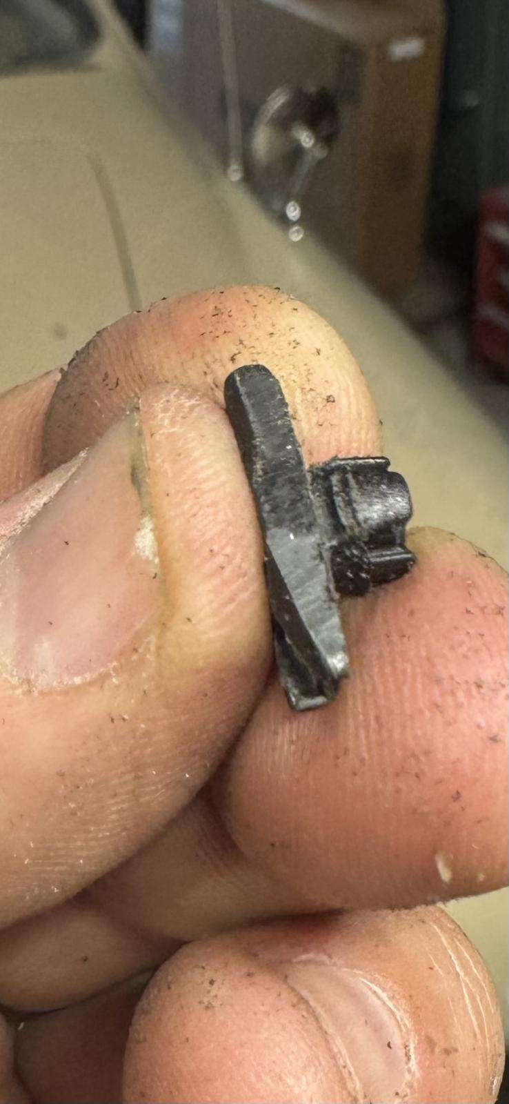

I changed the worn out striker on my drivers side door. It’s nice to have the door sitting properly now and not rattling. Kind of a shame to lose the original style striker, but I guess now it matches the passenger side.
I got this from KGPR/ Airhead.

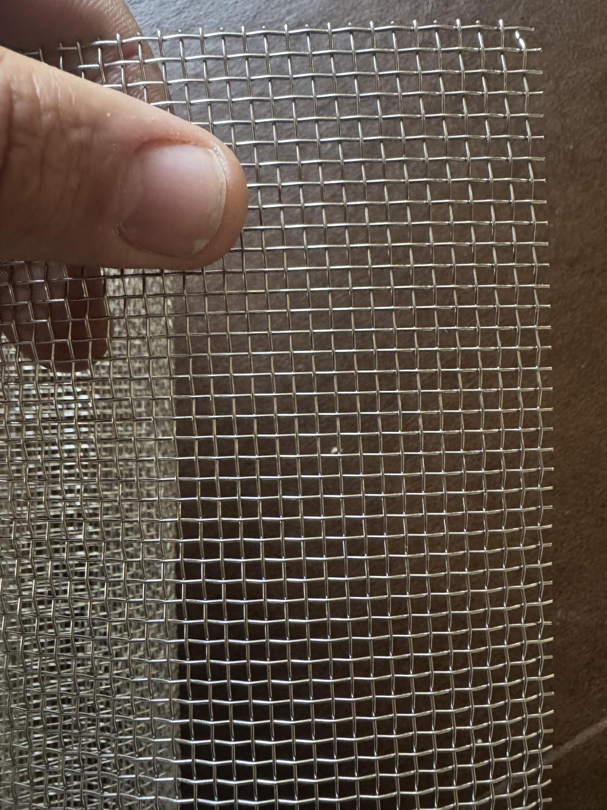

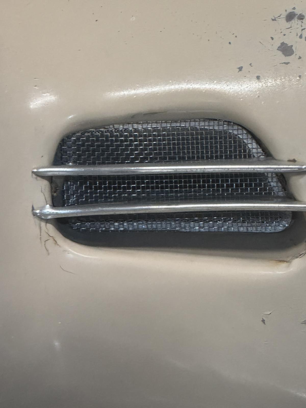

I also wanted to find some mesh screens for my fresh air grills, but prices seem a bit steep.
https://www.thesamba.com/vw/classifieds/detail.php?id=2710033
So I searched around for a while and found some thick wire 1/8” stainless mesh that looks pretty close. Maybe I’ll get lucky and find the correct mesh at a swap meet someday.
Here’s the real deal:
This is my budget solution:
I paid $12 for the roll and could probably make 10 more pairs, if anyone wants some- just pay shipping.

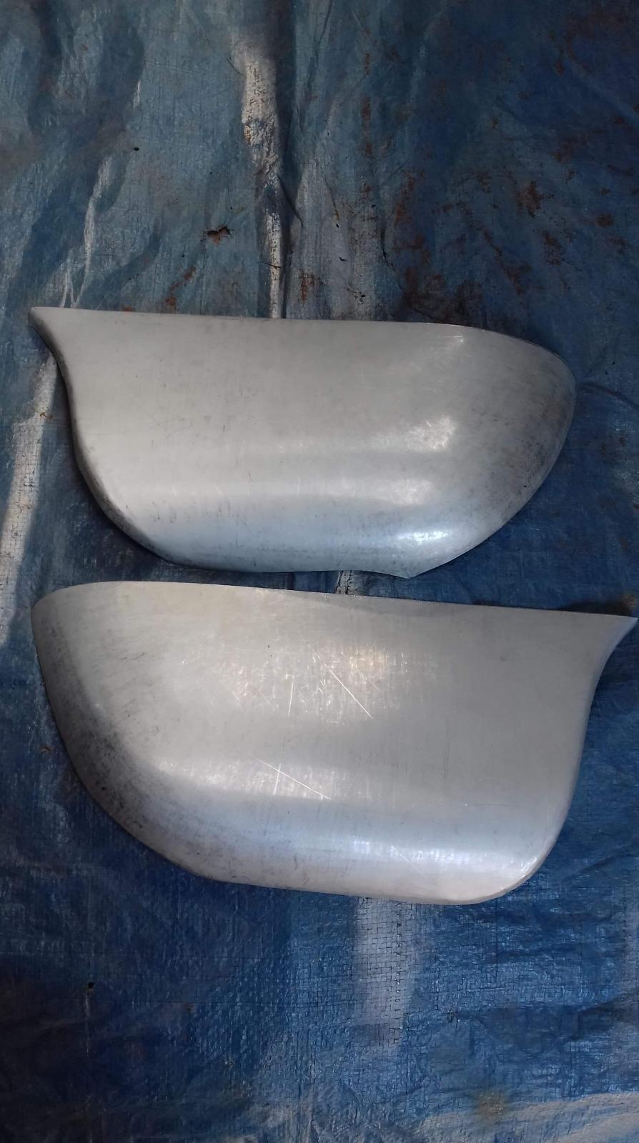

Yeah, you said it. It's not the end of the world, but it's pretty annoying. I only planned to use the lower half of this panel below the body line, but I did specifically want to replace that fender lip section. I don't think that I can snip around that and keep my fender lip- that area will probably end up too thin to weld up that way. And I am nowhere near that skilled of a welder.
To return it, they want to charge shipping and 20% restocking, sigh... I'll end up paying $40+ to send it back and only get $25 in return. I guess I'm done with CIP1.
Does anyone sell better replacement metal? Maybe KGPR/Airhead? None of the pictures of this panel online show the fender lip portion.
I'm trying to decide if I should eat the restocking fee to return this junk or not. I'd hate to order another one and it's the same, just burning money. Laughing

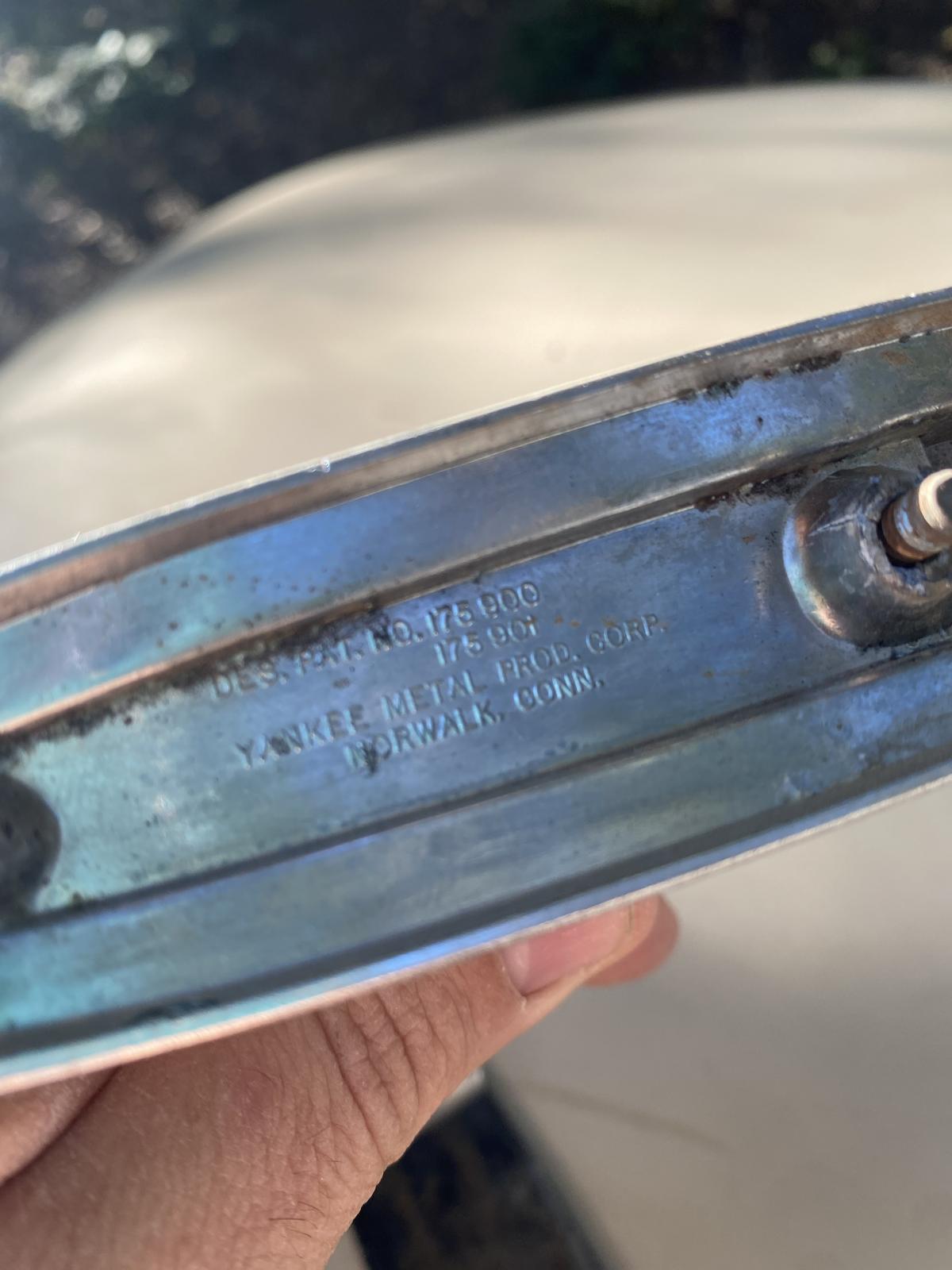

PeteSC wrote:
That appears to be a mis-match. The earlier festoon housings were mounted on the inside of the panel using that soft gray seal, the later 58-59 housing is mounted outside using that thick black rubber gasket you have. Later models have a horizontal brace inside the opening that the housing attaches to (and would prevent mounting from the inside unless removed, part #80 on the chart below). Were your housings mounted inside or outside of the fender? The link below is a good comparison of the exploded parts for each type.
This is a huge help, thanks! I didn't realize that early was mounted from the inside. Now it's clear.
My car is an April 57, Body 17794, so it should have the early style assembly in the lower diagram. But I have half and half. I have the correct early 2 piece lenses (#72 and #77) , but I also have the later bulb holder with the horizontal bar and wingnuts (#69 and #80).
I bet someone upgraded the bulb holders back in the day, maybe to have brighter lights. I think I'll just keep that in place, since it's already done. I'll just get some of the later molded black rubber gaskets for the body (#73), and I'll also keep these flat gaskets for the lens (#66).
Thanks again. I appreciate the information!
Not the best shot, but I bought a reproduction housing several years ago and it wouldn't fit with modifying that inner bracket - the housing didn't have a deep enough relief to accommodate it. But it gives an idea of how the later housings go on the car.

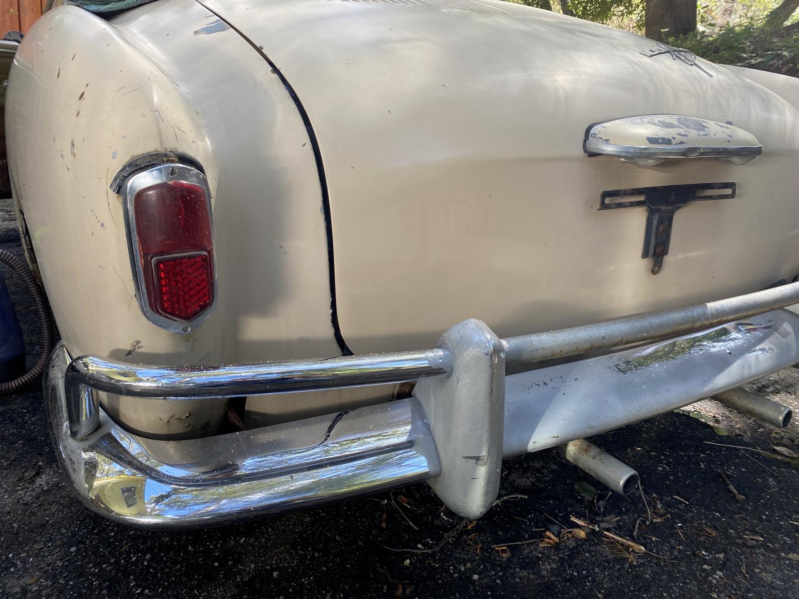

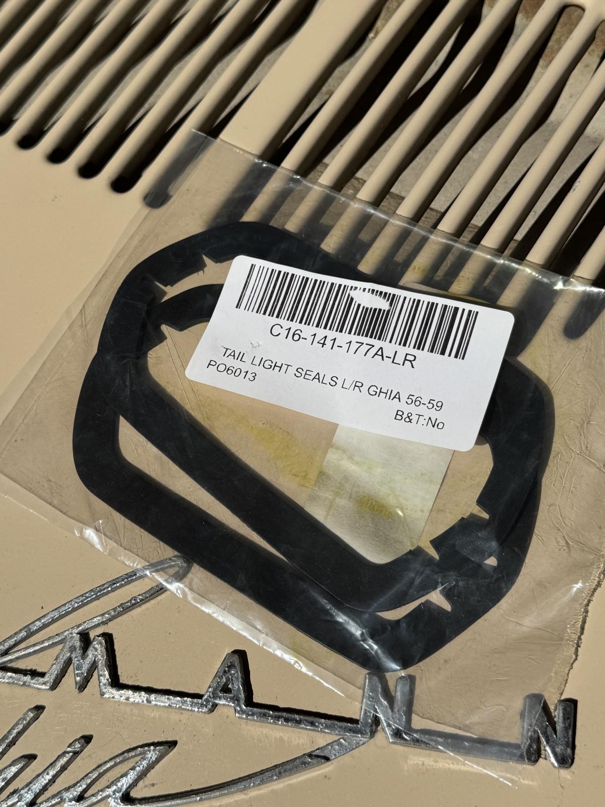

I think I bought the wrong tail light gasket. The one I bought goes in between the red lens and the chrome ring. The one that I wanted goes between the chrome ring and the body.
Is that correct?
I keep reading that the grey body gasket is like a foam material and is very rare. And if so, that’s probably best used on a restoration. I need to find an alternative.
My car has two piece lenses - (the chrome is not attached to the lens)
But my housings are the regular bulb type, not festoon bulbs.
Does that mean I have a mismatch? And if so, can I just use 58-59 body gaskets like these:
https://www.thesamba.com/vw/classifieds/detail.php?id=2198171
