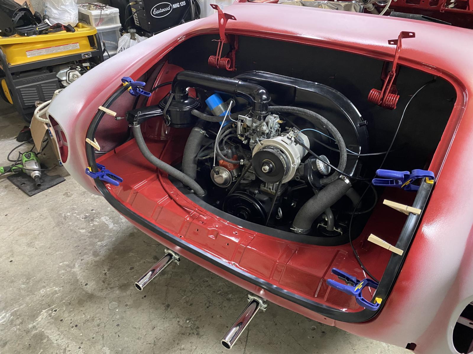

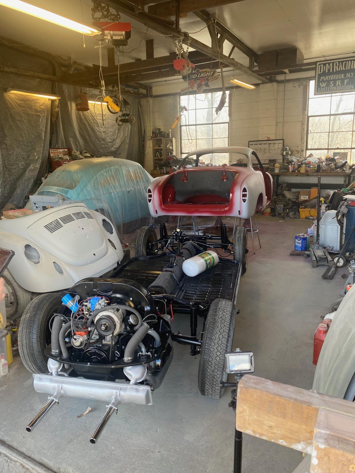

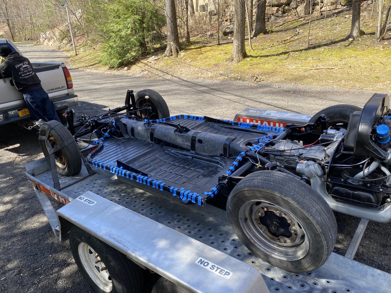

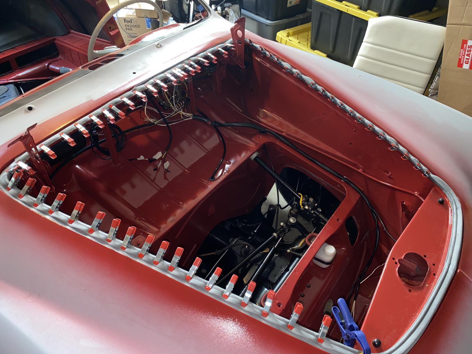

I haven't posted an update in a while but after meeting Trylon and MarcDeb at the Terryville show I thought I would share my progress on my project.
Here it is in primer after the body work was completed by Dennis Manning of Vintage VW.
So, Manilla Yellow is definitely out. I just couldn't fall in love with it so I decided to go with Ruby Red and a black roof. The trunk, engine compartment, interior and underbody were all jammed out.
I had to trailer my chassis about an hour from home on the interstate so my gasket is all taped down along with the carpet padding on the tunnel. I wanted to rear seat bar to go across and over just like it was from the factory.
Body and frame about to be re-united at last! The engine compartment wiring is already in place along with the tarboard.
I've had it home for about three months and have been picking at it here and there. Wiring wasn't as hard as I feared but space is very limited behind the dash. Getting the vent control mounted... absolute nightmare! The dash is mostly assembled with a rebuilt speedo from AirHead and a tach I put together. I'm still waiting on a rebuilt gas gauge from Orange Empire speedo. I got the glove box mounted with felt lining I bought on Amazon. The hood and decklid gaskets are glued on. I have four original smoothies and new white walls. I insulated the interior with a constrained layer from Second Skin. Instead of factory padding in back I put in their "luxury liner pro" product which is foam with a rubber layer glued on top.
The steering wheel is a really nice repro from AirHead. It came with a half moon horn lefer but I decided to use the original lever I had chrome plated.
The hood gasket came from CIP1 and is supposedly made in Germany. It fit very well and has cutouts for the drains in the corners.
I added a USB port in the glove box for my radio.
I used some high temperature adhesive for the rear gasket. It looks like yellow snot and is equally as messy. The corners of the gasket are screwed in with washers so they don't pop out.
I still need to bleed the brakes, get the doors on, assemble the door glass and hardware, figure out a custom mount for the battery under the back set, get the gas tank mounted, hood and declid bolted on, and then it's going back to the shop for paint. So stay tuned for all of that!
My son was in elementary school when I started this Ghia project and it is now the summer before his Senior Year in High School. I'm hoping to have this done before he hits middle age.

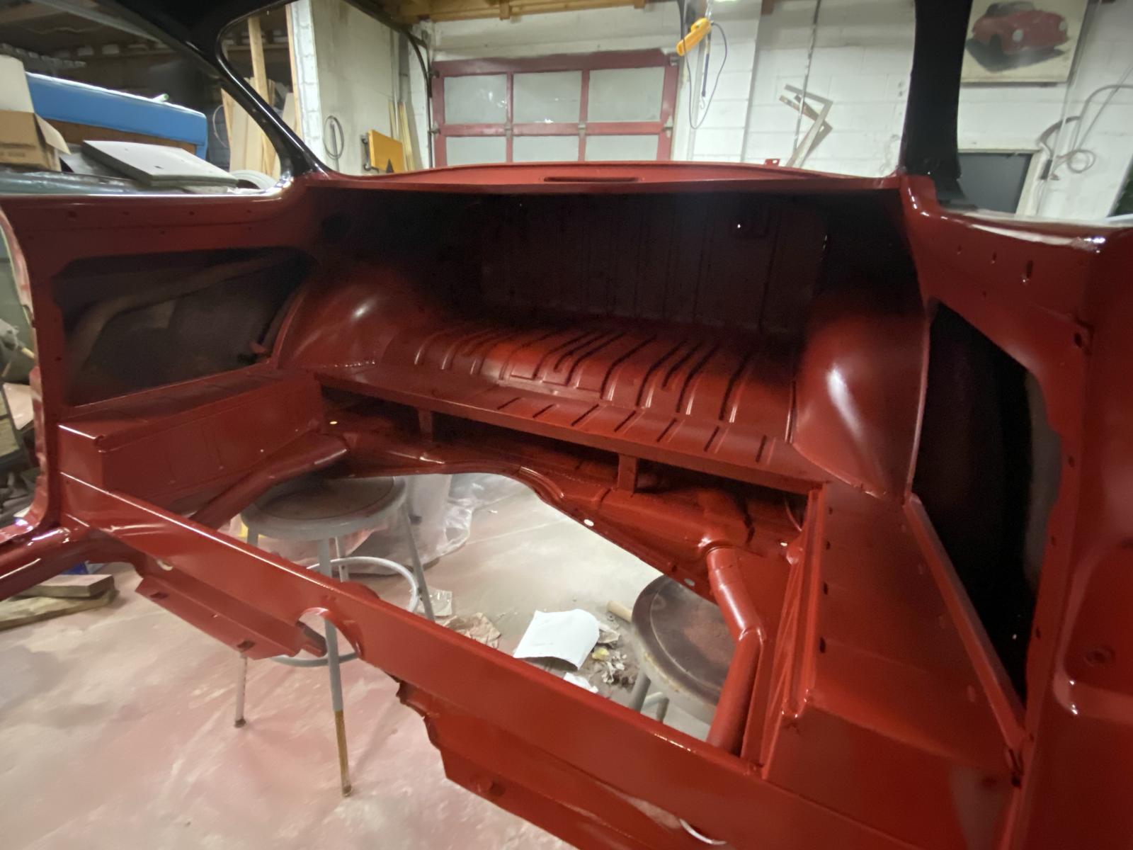

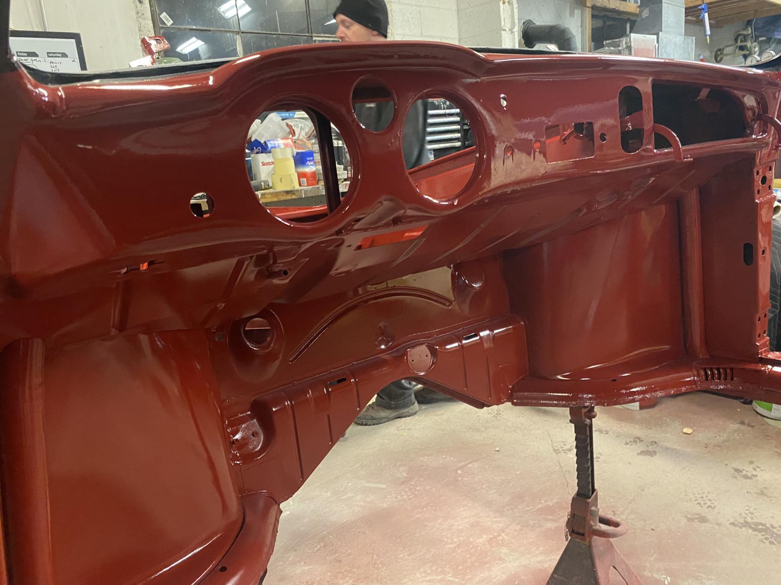

Okay, well now I'm leaning towards Ruby Red with a black roof. After thinking about Manila for a while, I don't think it will look great with a black roof. I just don't think this particular shade of yellow is saturated enough to contrast with a black roof.
The body has been sitting under a car cover for almost a year and the painter is ready to go within a couple of weeks, but I looked underneath and there's still old paint and surface rust in the wheel wells and under the package area in back. He explained that most of his customers aren't as picky and insane as me and he normally just treats with ospho and sprays undercoating.
The blaster in our area is all backed up and the dustless blaster guy wanted $1500. So to make a long story short, I went over to his shop and he let me use his portable blaster (holds a 50pound bag) to blast the under-body.
I spent the last two days in 40 degree weather, crawling on the ground in a tyvek jump suit blasting my brains out. The air going into the machine was damp so I clogged every five minutes. Did I mention that blasting on your back in the winter really sucks? Despite my PPE, I have dust in my eyes and ears. Anyway, my under-body is blasted and looking great. Miraculously, only surface rust, undercoating, and paint. No rot or holes. Going to probably spray with SEM chip guard and then paint.
No pictures because it's impossible to document and get the work done at the same time. But I saved $1500!
