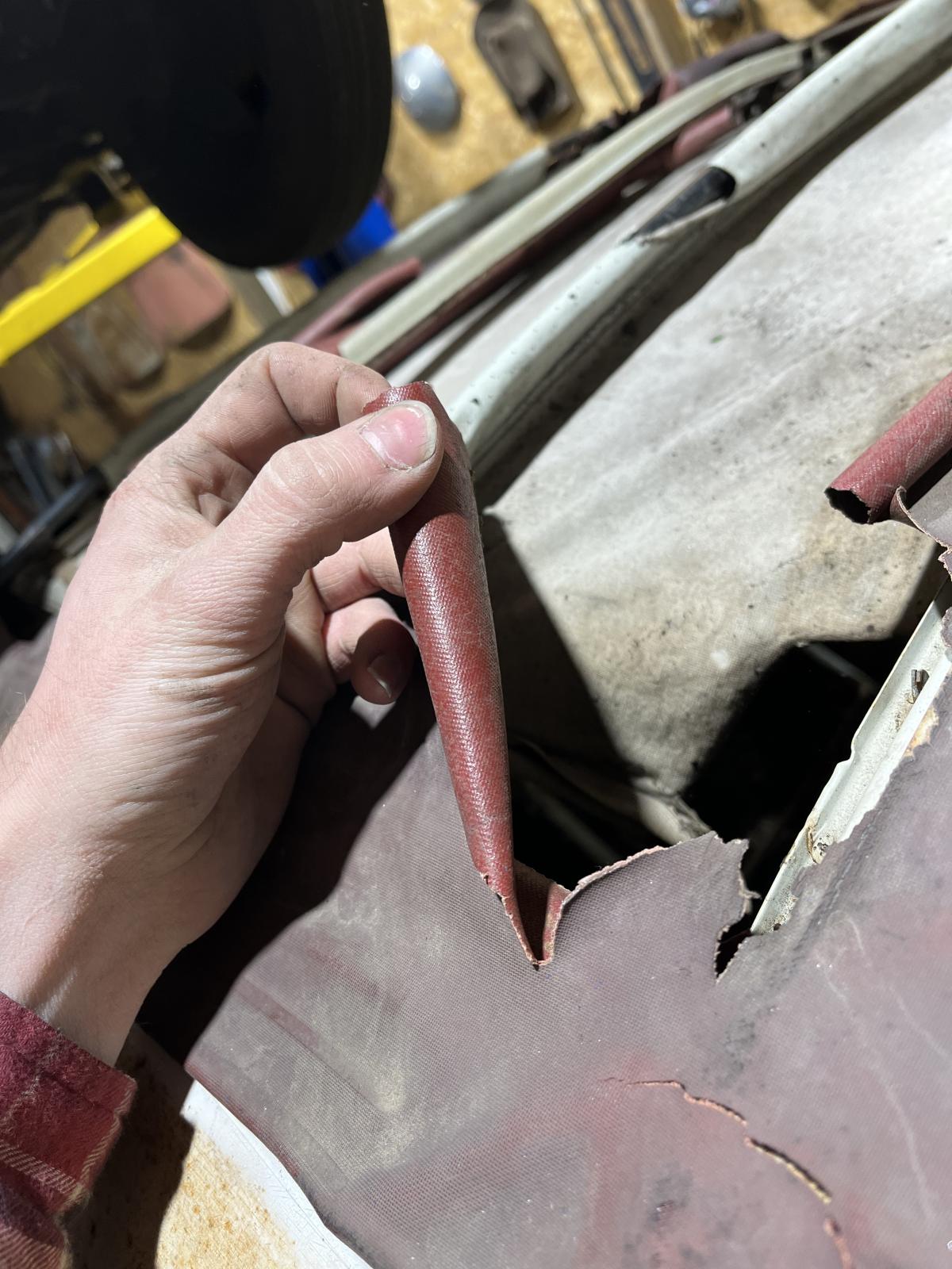

Thanks Avenger, 80 grit can hide some stuff LOL. I’ll tell you, it’s times better than my ‘67. I’ve been cracking on still. I’d like to get it primed before winter. I’ve got my passenger side bumper mount fit where I want and have started modifying the rear body mounts. I didn’t like how they didn’t match the originals at all so I’m trimming them to better mimic them. As usual, aftermarket parts are not the best. I’ve also cut and fit replacement firewall corners and have new engine bay shelf’s. My standards for this car are extremely high, nearing concours. I’m trying to do all of the things I wish I had done on my ‘67. I stripped and phosphoric acid'd the package tray. I have a few pinholes to fill and would like to remove the heat tubes before master series and then epoxy+ highbuild. Does anyone know how those are removed? I recently picked up a hood on Facebook Marketplace to help with the front end. Unfortunately it does have some rust and I won’t be using it, which is more sad when you realize it was a NOS hood that was left out. Still has the VW primer inside and a sticker halo. Anyhow, here are the pictures.
Trim lines showing how far off the new panel is.
The Passenger side trimmed showing the new more original shape.

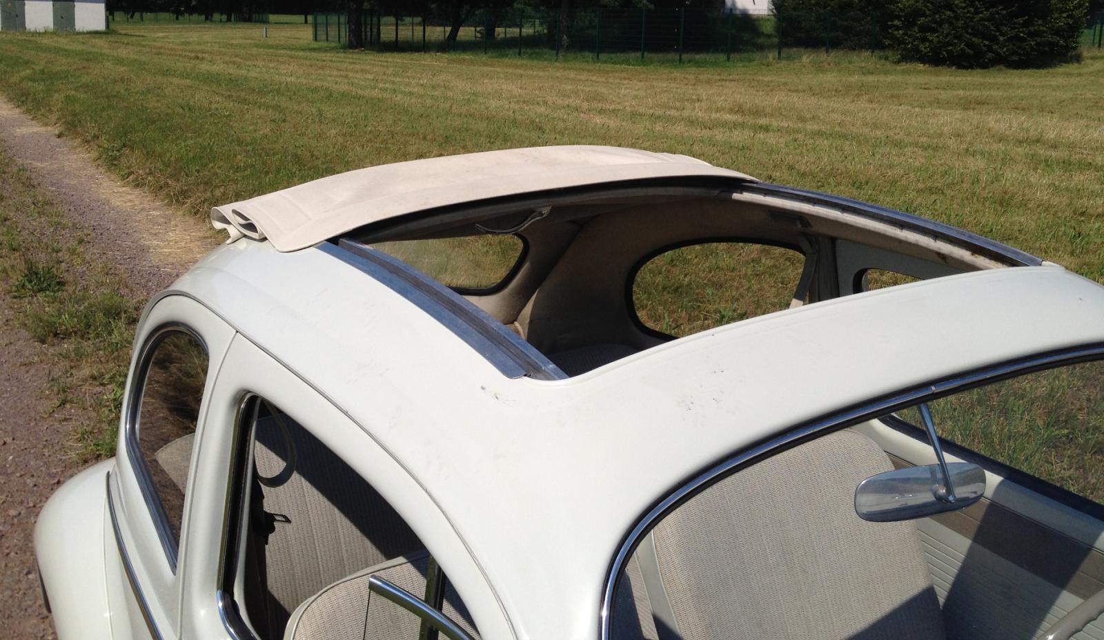

PostPosted: Sun Feb 05, 2023 3:15 pm    Post subject: Re: 1963 Ragtop Restoration Reply with quote
MeeferMadness wrote:

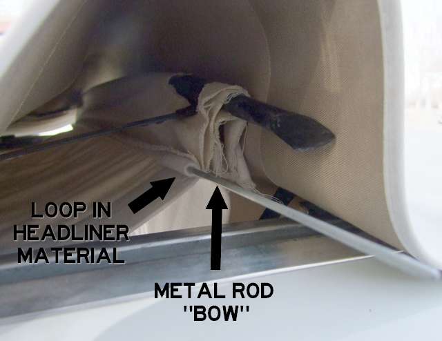

So from what I read you believe the sunroof top is original. I was looking at the photo of the sunroof bars and how they were connected to the inside headliner. Is that a vinyl strip that goes around the bar then sewn to the headliner? I have always wondered how the factory attached the inside headliner to the sunroof cover.
Thanks
Bruce Ebling
Sorry for missing your question Bruce! I have to go look to confirm, but yes I believe there are loops of headlining sewn around the bars. Almost like they had sewn them and then inserted the bars right through when assembling.

MeeferMadness
Joined: June 14, 2004
Posts: 306
Location: Eugene Oregon
MeeferMadness is offline
PostPosted: Thu Nov 24, 2022 11:31 am    Post subject: Re: 1963 Ragtop Restoration Reply with quote

pastellgreen wrote:
Here some pics of the car with the new ragtop
The direct link to the company and the product:
https://www.cabrio.de/en/softtops/car-models-price...ded-detail
I had three examples but possibly chose one, that was too tan. I would first paint the car and then order the samples. The material is pinpoint vinyl made by Haartz corporation.
If you like to have a ragtop as stock, the german company is the only way for you.
