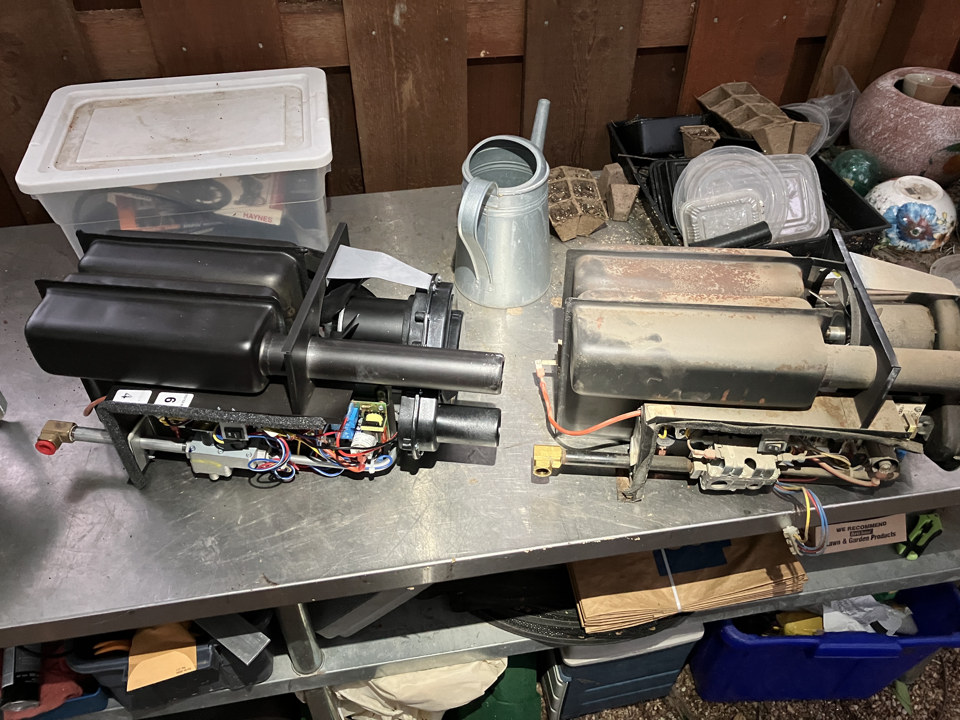

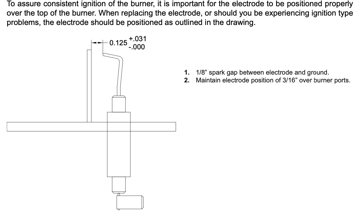

The new furnace is installed.
It was pretty straightforward. If you bump the igniter and push it out of calibration, you'll need to Suburban literature to fix that:
Testing the sound:
Baseline (nothing on): 33 dB
Furnace on and blowing: 55 dB
That's not an empirical improvement. It mostly sounds the same to me, but there is less high and midrange howl. We'll see how it works. I am thinking of eventually putting some sound deadener around the outside of the steel heater cabinet. My van is a 2001 EVC and maybe the furnaces of that year were already quiet by Suburban's standards. The important thing is that, when someone complains about the heater noise, I can say it's the quieter model, and we'll pour the whiskey and accept our outcome.
I'm still pleased with the work. I was able to clean up the furnace cabinet, and the old furnace was very rusty.

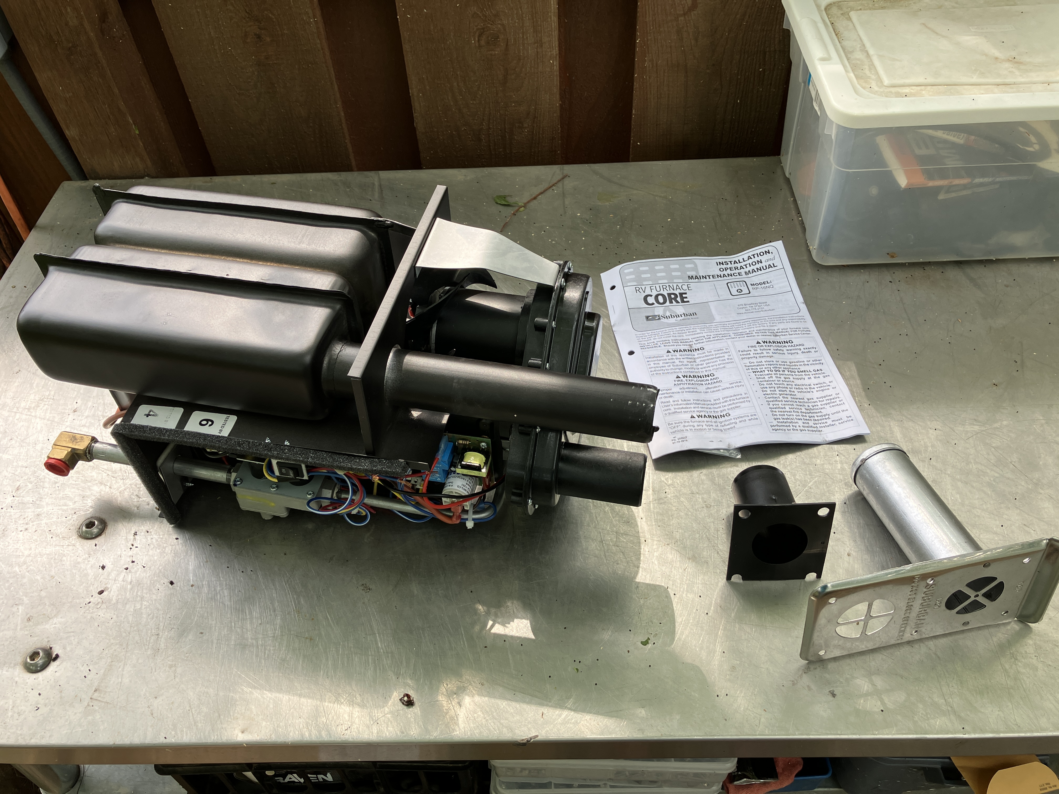

The new Suburban 2611A furnace core arrived at Home Depot yesterday, and I picked it up today. I took the sound reading on the old furnace today. The van was closed up, and sound was measured near the aft sliding door of the rear closet, where my head would be.
The baseline (furnace off, nothing running) measurement was 34 dB.
When the old furnace was running the measurement was 54 dB.
Honestly, I have my doubts about a big improvement in sound reduction, because I think a lot of the noise is conducted energy from the furnace body, through the bedding, and into my head. But I hope I'm wrong. This is still a new and more powerful furnace, so it's a win either way.
I hope to get the new furnace installed this weekend. As stated earlier in this thread, this appears to be a simple slide-in installation. The heat exchanger intake and exhaust are slip fit, and I doubt I will be using the included chrome vent cover.

Update - Hi Folks
I was able to order a replacement core for our '97 EVC furnace (Suburban Model NT-12S) from Home Depot for $444 delivered. It's actually the core for the NT-16S, which has an output of 16,000 BTUs vs. the 12,000 BTUs produced by the NT-12S unit. Note that the Suburban stock number for this replacement core is 2611A with a corresponding part number of S6U01-1722.
The new core has plastic fan blades rather than the metal ones in the NT-12S--I'm hoping it's a bit quieter. (Note that I have not yet fired up the new installed core because my van is still dry docked for the winter.)
The search process was maddening, particularly because Suburban repeatedly told me that no furnace core upgrade was available...or that the NT-16S unit would not fit in the installed metal furnace cabinet, which housed the OEM NT-12S unit. Wrong on both accounts.
I also installed a new cabin thermostat from Suburban, which shipped from Amazon for under $20. You can find other references to this upgrade elsewhere on the web.
In case anyone is interested, I'll be glad to sell my old NT-12S core, which is in fine working order--I did this upgrade to get a bit more heating power (we reside in the Rockies) and a quieter furnace fan. So feel free to ping me if you are interested. I don't have a price in mind at this time.
Thanks for listening. I'm happy to answer questions!
