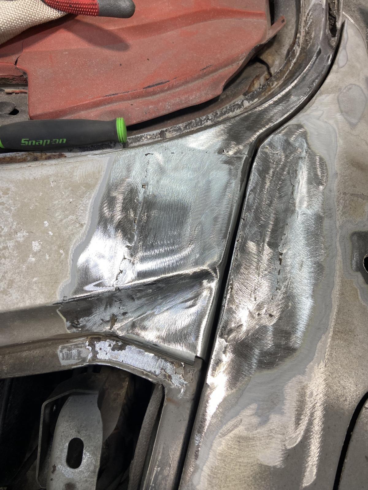

PostPosted: Mon Jul 22, 2024 9:40 am    Post subject: Re: 1979 Porsche 911SC Build, lots of body work and photo heavy Reply with quote
One more step closer to tightening up the metal work. Im super happy with how this front cowl and lower door turned out.

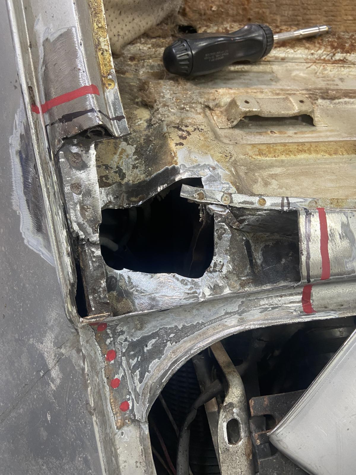

PostPosted: Mon Jul 15, 2024 7:01 pm    Post subject: Re: 1979 Porsche 911SC Build, lots of body work and photo heavy Reply with quote

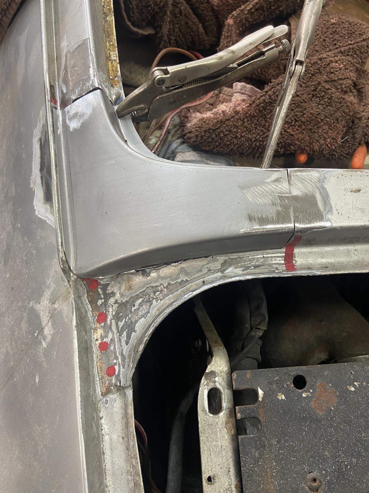

Its amazing how many nights it takes to fix these corners. Much like donkey said "its like a parfait, got layers". Tonight im hoping to weld in the drivers side rear window lower and the drivers side lower door repair. BTW the lower door had the same foam filler in it. I would really like to talk to the tech that did that. Such an rookie move.
I also started on the passenger side repair

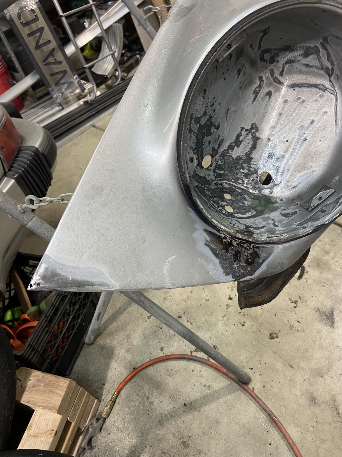

PostPosted: Thu Jul 11, 2024 9:38 pm    Post subject: Re: 1979 Porsche 911SC Build, lots of body work and photo heavy Reply with quote

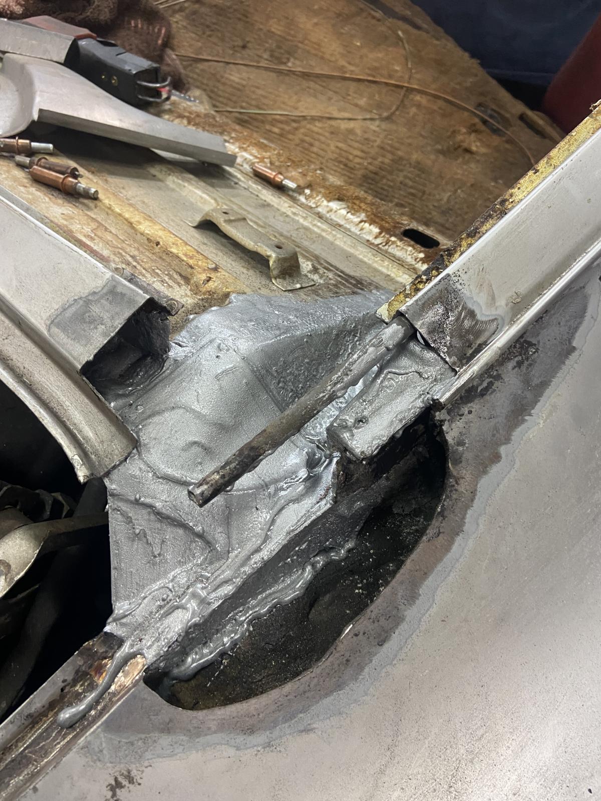

Working my way to the back of the SC, these area's are pretty tough to do. Not a flat area or easy access for sure. I continued to cut out the rust and prepped it for fresh metal. Once the metal is installed i will be coating it to help with future rust prevention. Who are you all using for the moon roof drain tubes?
I think using steel on these were a silly idea for sure!

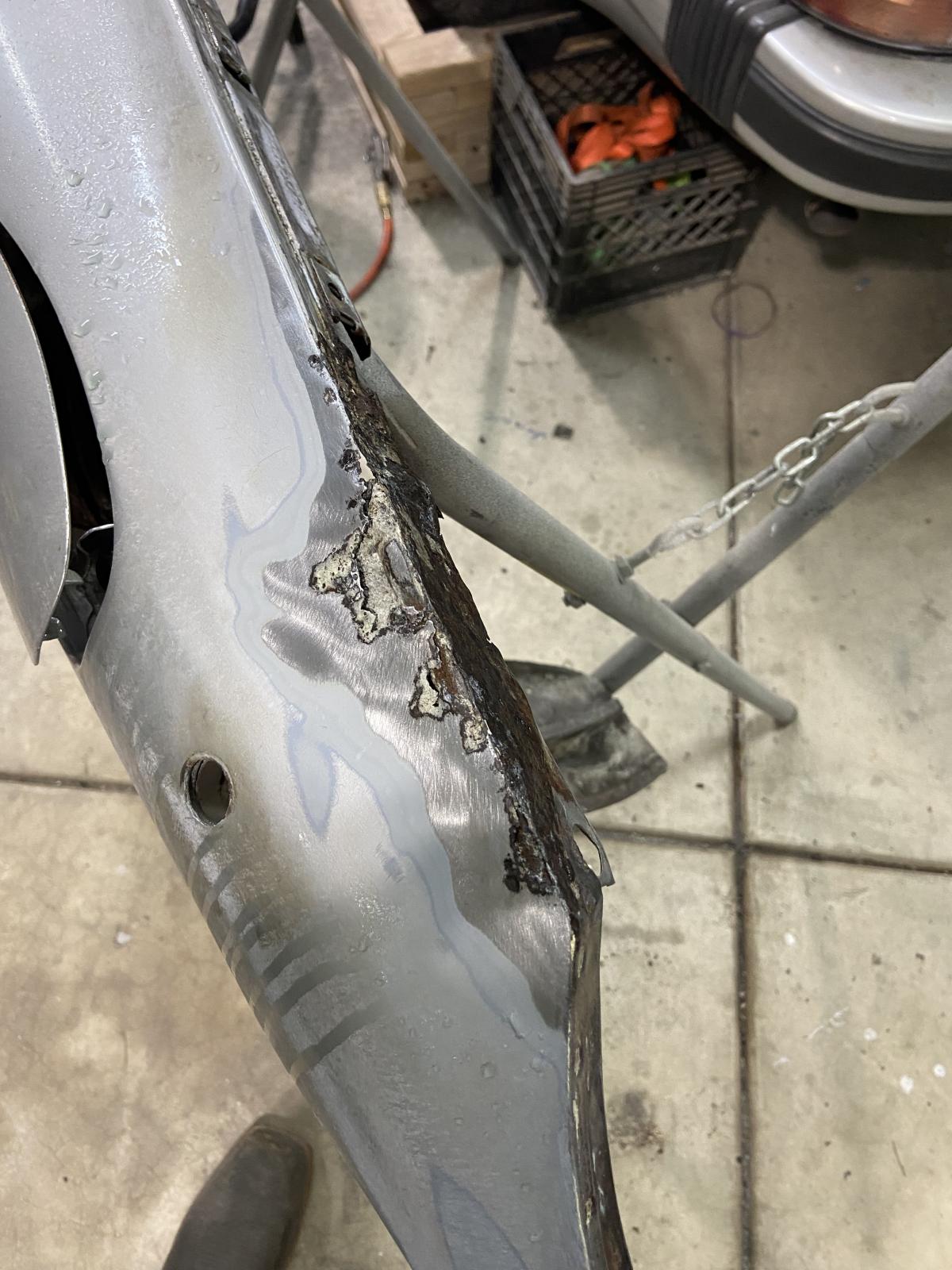

Good evening all, I have not posted much lately but here are some of the updates. I was able to salvage the original DS fender with a bit of metal work. Any chance i have i try to keep the original metal i do my best to do it. This time it worked out well. Now onto welding in the panel just inside of the fender.
From this
To this

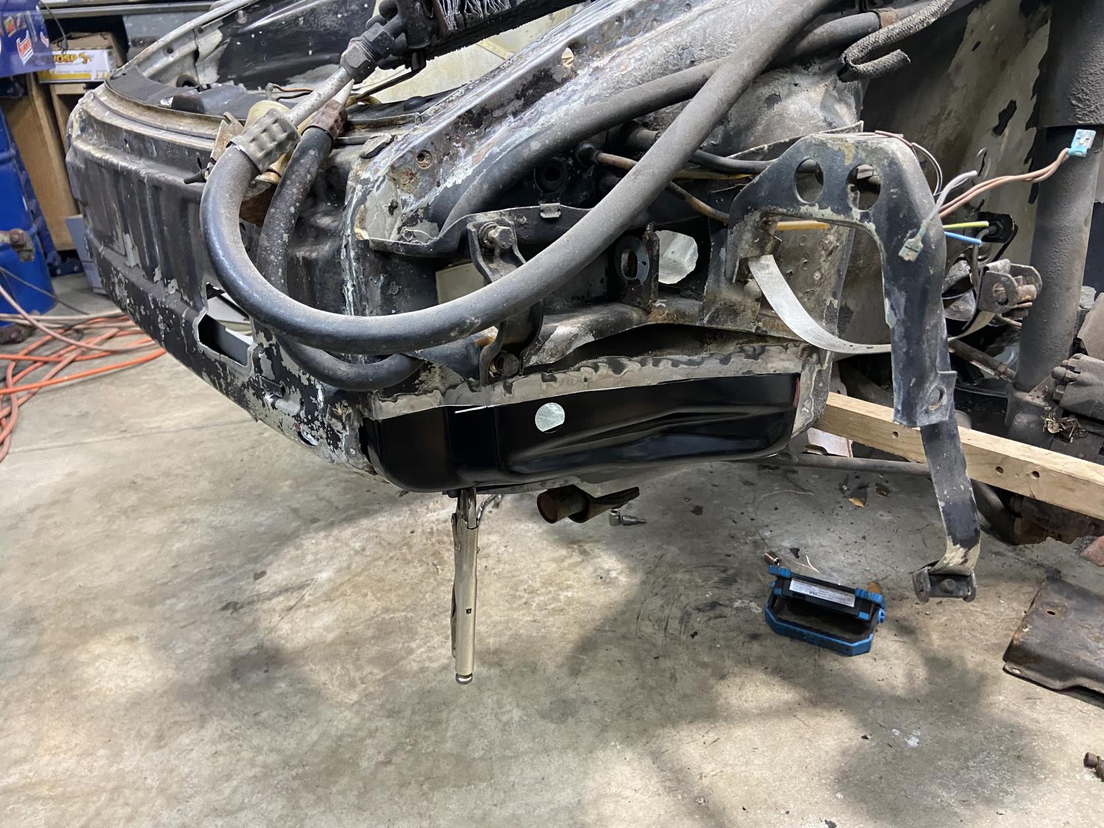

Making some great progress over the last few days. All the metal for the lower front skirt has been massaged and secured against the front panel. I am going to let the panel bond cure over night then i will start spot welding around the edges. Since each piece builds on the one below this process will take a couple of days to complete.
