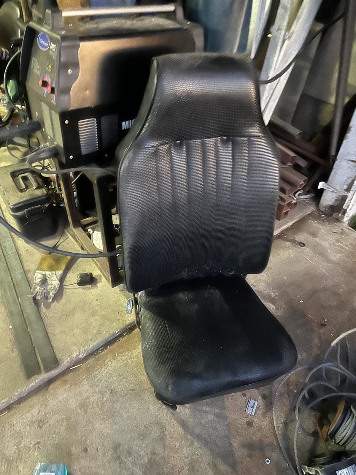

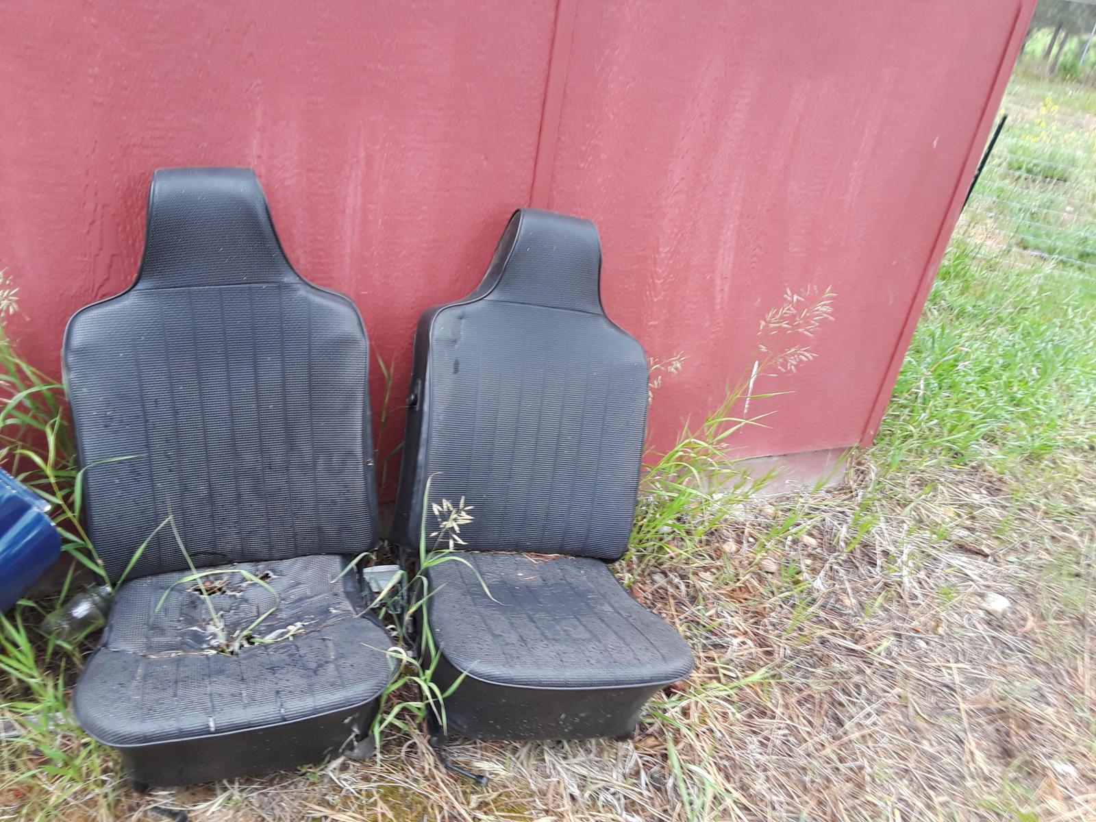

You might consider high backs seats and/or shoulder belts. Unfortunately headrests would eliminate stock looking front seats (stock ‘68 to early ‘70’s seats could be used). Shoulder belts should keep heads off the windshield in a frontal accident.
I fully agree about using factory seats with the integrated headrests, but careful with those seat years... '68 & '69 had the wide headrests (bikesndbugs gallery)-
'70 - '72 had the narrower ones, which I find very attractive (Bob Brugge gallery)-
But- and this is critical- starting with the '71's the seat retaining tracks and thereby also the chassis' seat rails were modified for safety and seat retention (VolksBitz gallery). Your '66 has the seat rails as on the left.
So for your '66, the only years which will fit correctly will be '68 thru '70. The '70 seats are therefore a "one year only" but IMO worth the effort to find and redo because their headrest shapes are less bulky looking.
