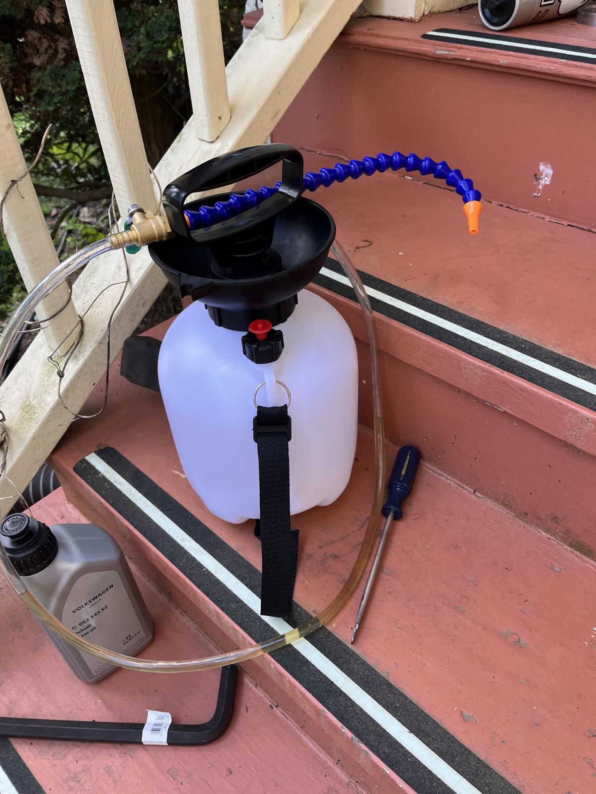

PostPosted: Tue May 06, 2025 11:38 am    Post subject: Re: Servicing the Automatic Transmission Fluid/Oil (ATF) Reply with quote
Well as usual I "measure a thousand times" before I make my first cut ...
Finally tacked a DIY transmission service. Have had all the parts and fluids since late last summer but just kept putting it off.
This was for the 2003 Weekender - it had 47,740 on it today when I did the job. This was the van I purchased about 15 months ago (when it had 38k on it) and brought it home to NC from California. It had an External Cooler installed but none of the records ever showed a Transmission Service. The A/T fluid was topped off when the Cooler was installed based on the receipts charges.
After draining the fluid and removing the A/T Fluid Filter, I could see that the date on it was 2002, so I'm 99.9% certain this was the original fluid. Very happy that I finally got around to tackling it. The old fluid was very dark and there was a fair amount of very fine metallic sludge / build up the magnet -- nothing on any size to note -- pretty much looked like what I have seen in videos I've watched.
One of the impetuses that led me to finally tackle the job was I had been noticing the van would exhibit a sort of "winding up" sound when moving away from dead stop in first gear - as if the transmission was straining every so slightly. I still had good torque but I didn't like the sound.
Happy to report that after doing the fluid drain and fill, that particular sound has gone away and the van is shifting as smooth as I've ever felt any of the vans I've driven. No lags, no jumps, no hard shifts ... just nice, easy transitions between the gears.
Volumes:
-- I drained about 3.5 liters of old fluid. Refilled it with not quite 4 liters of fresh A/T sold by VW (from FCPEuro) and then about a 1/2 liter was drained out during the leveling procedure at 100 degrees F.
Since this was the original A/T fluid, I'll probably do it again in 10k to 15k miles, to flush out some more of the original fluid that remained in the gears, then after that will stay on top of it every 20k.
I did NOT tackle the Differential as I'll need to learn a bit more about removing the Pendulum Mount - no idea what's involved for that job. But I do have the fluid, a syringe-style extractor, and the 17mm hex key for the day I finally get there.
Thanks to everyone who offered tips (and to those unsung heroes of YouTube that post helpful video tutorials.
I purchased all the parts for the job from FCP Euro - gonna try and take advantage of their lifetime replacement on everything. Bought the pump from Amazon I think.
