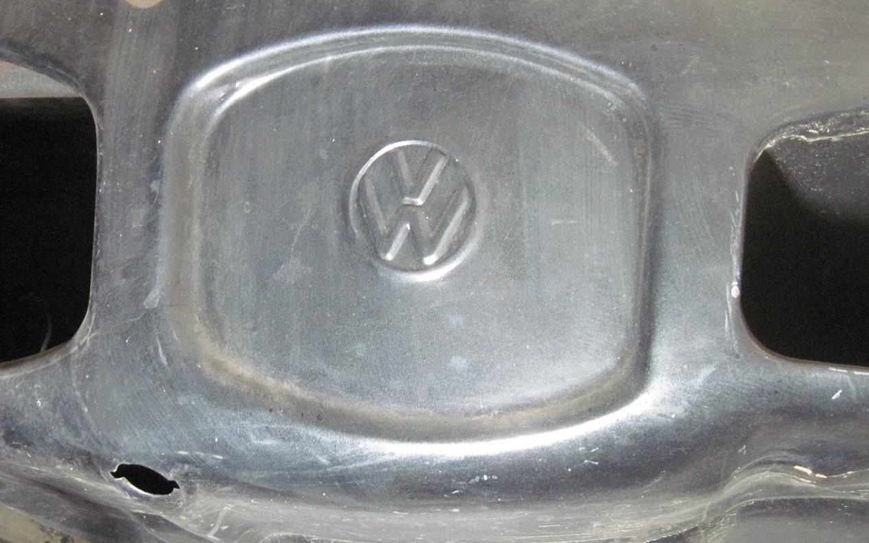

interesting that they felt the need to centralise the logo pressing, I wonder why? the slightly elevated one follows the good design practice of using the optical centre rather than the geometrical centre.
I was wondering that myself. Perhaps if it was a little less optically centred, it would have gone unnoticed. I'm going to assume some higher-up, not privy to the finer details in life, had the embossing mechanically centred.
Imo, it´s like this:
First the KdF 303, VW 38 etc. had 2 instruments in the same size at the same "high" level. (harmony, looking good)
While War, the cog wheel logo had about the same size outside diameter as speedo, the centers of both still at same level.
After WW2 the cog wheel was deleted, so outside diameter of VW-logo decreased, but still both centers on same level. (looking good???)
Between April and mid of July 1946 the VW-logo-pressing on right hand side of dash was relocated and centered. (looking better?)
Mid 49, the Exports and 14 A, 15 got the clock, same size and level as speedo. The same style as on VW 303 and VW 38 etc. (looking good again, Standards got no logo)
(probably they, H. Nordhoff had tried around 1948 with a larger VW-logo on dash, similar in size to the large logo on wheel caps 1948 to mid 49, but were not really satisfied)
Very German to say "but mathematically it must be in the center"; contrast with the Brits: The vertical slats of the classic Rolls Royce grill are not flat. They are ever-so-slightly convex. Truly straight lines would appear concave, which is not a strong look. To the human eye, the convex lines appear flat. So they made the adjustment in the design.

Finally, another photo of that lovely offset VW emblem in the dash pod.
For years I've wondered when this VW dash emblem became centred, rather than offset north of centre, as seen in this picture.
Rod's car, of very similar vintage, has it centred, and I'm reliably informed that this change occured in April/May of 46. Are there any other views out there to point to when this occured?
Finally, don't anyone let on I posted this here. This is just between us. Wink Your secret is safe with us!

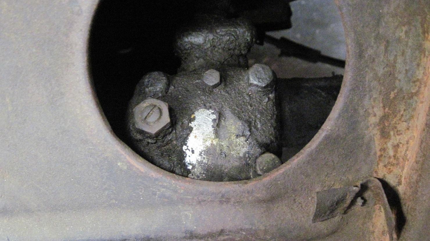

I'll start off by saying there is a major city between where I live and where the car is located, making my access time extremely limited,
but I was able to do some forensics, and will share some of my discoveries.
First, I spent time trying to decypher chassis numbers from the information on this site, and from what I understand, 1946
chassis numbers ran from 1-053815 to 1-063796. The chassis number on this car is 1-0624XX.
The body number appears to be 118XX. There appears to have been work done here. It may be a factory remanufactured car, as discussed here:
https://www.thesamba.com/vw/forum/viewtopic.php?t=...onditioned
The front axle had no number at all. As 1946 seems a bit of a mystery, could it be a replacement beam, or could it simply never have been stamped?
Here's the number on the top of the trans bellhousing. I have no reference to compare it to. (Or at least I couldn't find one on this site.)
I noticed some cars have numbers immediately behind the right trans side plate. I should probably look there next. I also noticed
an aluminum "lid" on the steering box. When did those run until?
