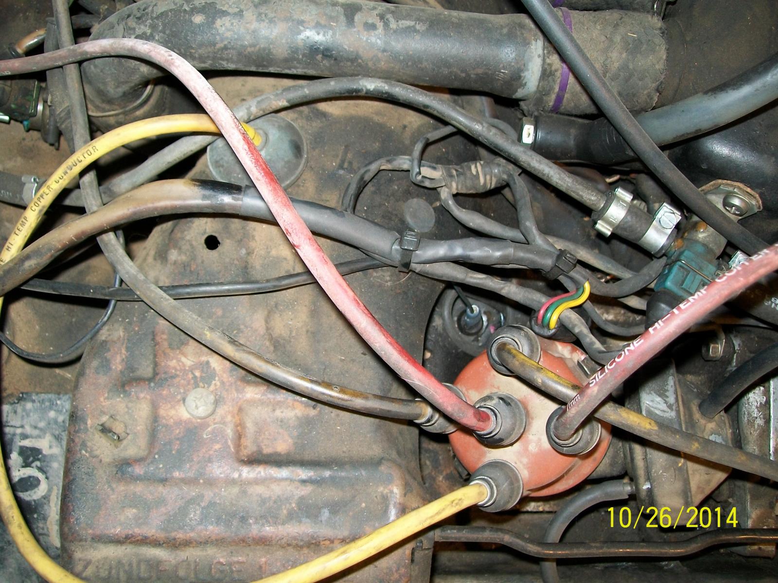

PostPosted: Yesterday 3:35 pm    Post subject: Re: 1980 Cali Westy starting issues Reply with quote
I’d guess that you’re right. Or it’s sourced from something else. It’s the distributor that the PO had in in, and I drove the van for years with it in so at the least, it does work.
I rotated the drive gear I think one tooth CW. Sounded more like it wanted to run, and did if I was actively giving it gas. Though the moment I lifted my foot, it died.

PostPosted: Yesterday 1:28 pm    Post subject: Re: 1980 Cali Westy starting issues Reply with quote
[quote="LordHuron95"]First image shows position of the drive gear at TDC. As far as I can tell it is within the range the book says to install it at. If it is say on a clockface, 11-6 in my image, and you’re saying to rotate it by one tooth CW, so in the direction of 12-7, yes?
My guess is your distributor is built with an incorrect part or two. Just rotate the drive maybe one or two teeth either way and see how that works.
Here are a few pictures from the gallery:

PostPosted: Yesterday 9:17 am    Post subject: Re: 1980 Cali Westy starting issues Reply with quote
Second image shows where exactly the vacuum can is making contact
