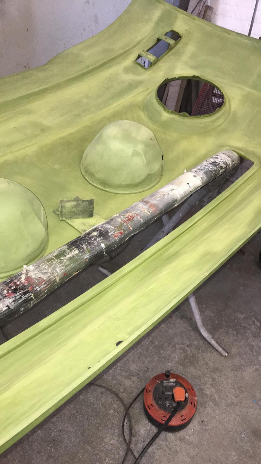

PostPosted: Thu May 29, 2025 6:20 am    Post subject: Re: Long running Custom Bay project - the Rebuild Reply with quote
and before people ask, the interior is templated... final colours to come!

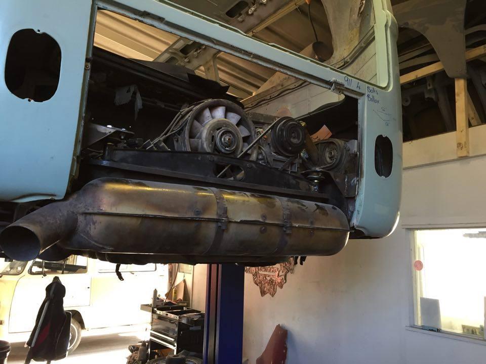

PostPosted: Fri May 16, 2025 9:45 am    Post subject: Re: Long running Custom Bay project - the Rebuild Reply with quote
Here's a pic of the motor install and when I had to get it up and running after 12 years of sitting. My dad had dementia and so he tinkered with it with not so great results but it gave him things to do. As you can see, it's not show quality at all. Just for function.

PostPosted: Wed May 14, 2025 6:15 pm    Post subject: Re: Long running Custom Bay project - the Rebuild Reply with quote
dpetteng wrote:
So.. let's start talking about putting a flat 6 in a VW van.
Some people tell you it is 4 bolts, really easy - they are idiots.
A few challenges are - dry sump so you need an external oil tank, cooling a big flat 6, and that it is about double the weight of a VW engine. That would lead you to ask "why bother?" and the answer is, because its hard!
It's actually not that hard. I know. My 68 Bus has a 911 engine in it. It's mated to a bus transmission. Installed back in 1977. My dad did it and just with basic tools and no over the top fabrication. For example, the rear engine mount is literally a piece of angle aluminum and bolted to the chassis of the bus. Really simple. No rubber mounts either, just solid.
Oil tank. Sits where the battery used to. He cut out the profile of the tank on that sheetmetal. Put some sliced fuel hose around it (so it doesn't chafe the tank). Then the tank is held up with threaded rod and if you know about old 911's, the slider used for the air pump (the emissions one).
Bumper mounts were slotted and found out the Ansa muffler fit perfect (the bumper gets really hot though). Sides of the bumper use more 911 air pump brackets to mount it to the body. Heater boxes are from a 914 (they clamp right onto 911 heat exchangers). Has two oil coolers in the middle of the bus along with a Troutman thermostat housing.
Here we are 48 years later and it is still going strong. Back then he did it because he wanted to. Plus we traveled the US in the summer camping out in it. In addition to that, we were doing SCCA Club racing with a 1957 Speedster. Thus it made many trips to races and the Runoffs in the late 70's and early 80's.
Back in the day there were lots of busses out there. Thus he loved to stalk them, wait for a long hill and then go blowing past the other busses. He really loved doing it to Vanagons.
Only real change was in 79 when he put in a brand new 79 Bus transmission. He got it from the dealer he used to be a service manager at and we did all of their cylinder head work. Thus, I was doing that cylinder head work for him (child labor at it's best) and he bartered out head work for the transmission. The transmission came out of a 79 camper that fell off the car carrier, thus totaled. The motor from that bus went into another one that was in for a 1K inspection but someone stole the engine out of it the night before (stealing engines out of busses and beetles was common back then).
See, my bus comes with many stories as I grew up with it.

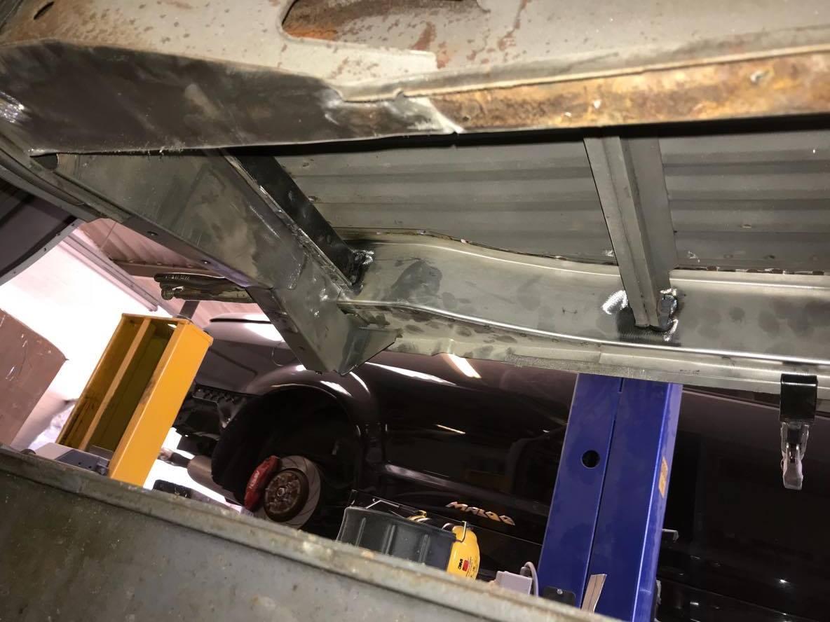

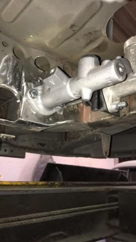

PostPosted: Fri May 09, 2025 2:39 am    Post subject: Re: Long running Custom Bay project - the Rebuild Reply with quote
More rust repair, panel fitting, air ride, Porsche 915 shifter etc. This van has had every major panel replaced. You will also notice some work on the Porsche 911 dash!

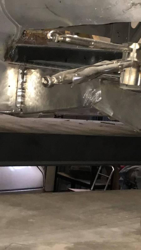

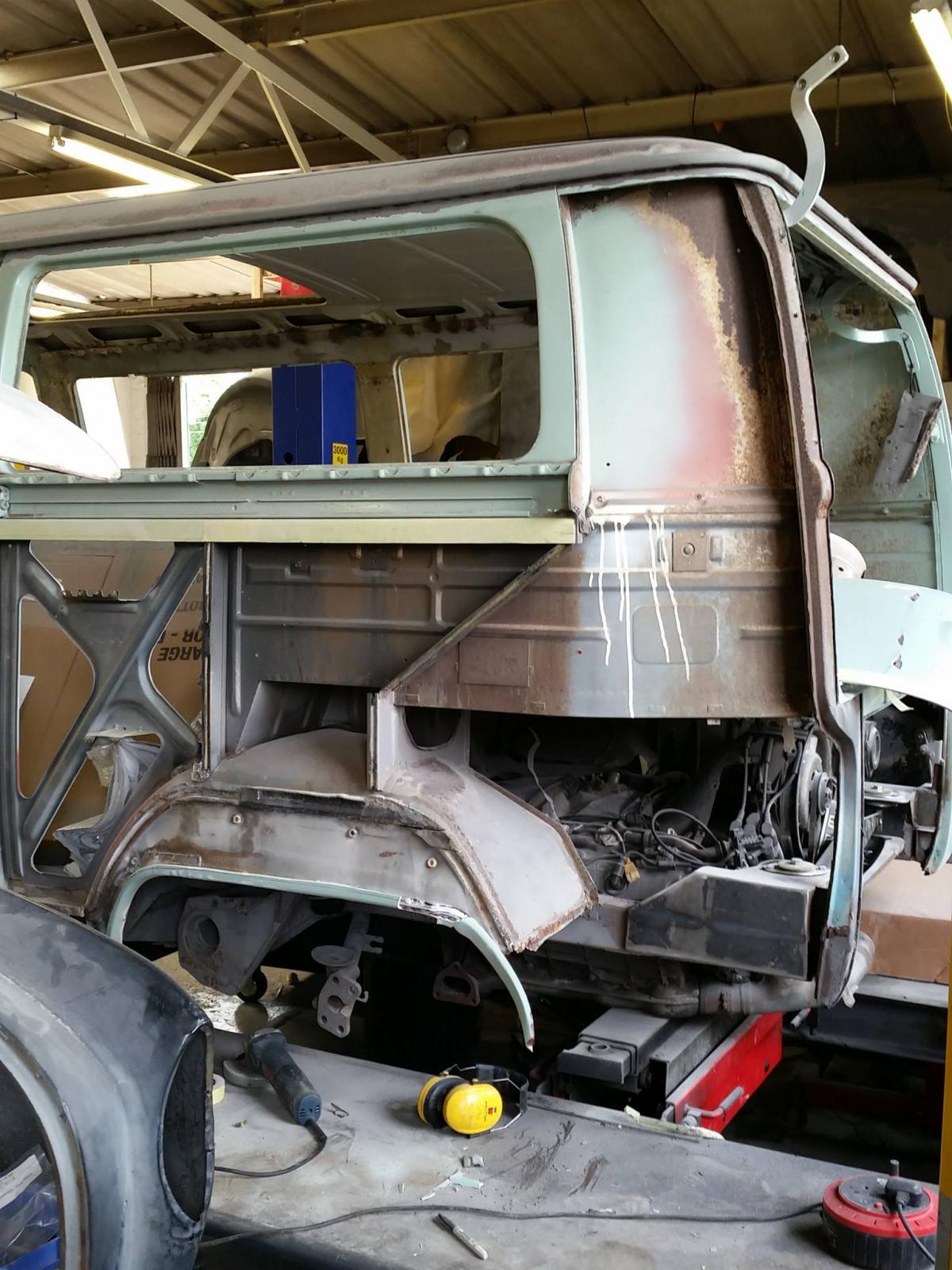

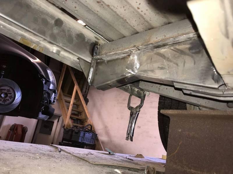

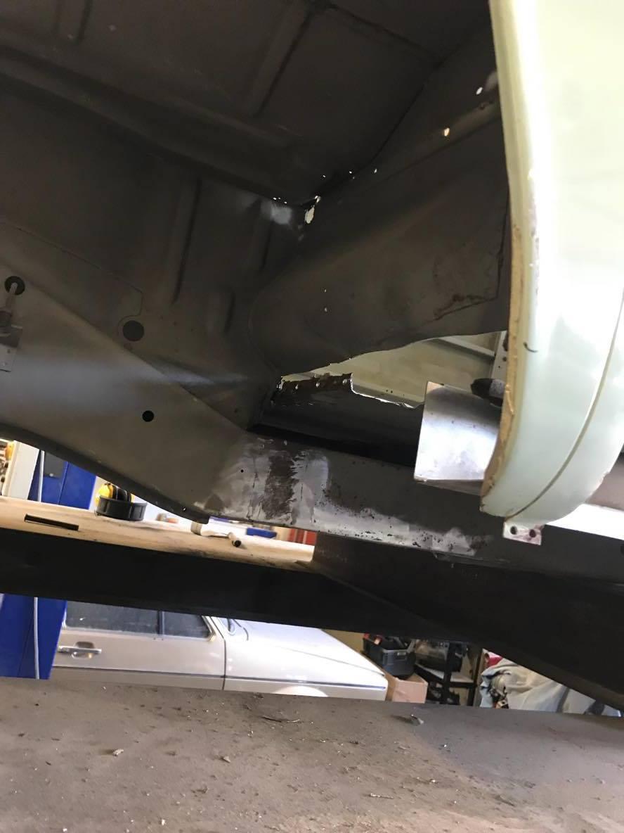

PostPosted: Thu May 08, 2025 8:28 am    Post subject: Re: Long running Custom Bay project - the Rebuild Reply with quote
So, as you can see, we had significant rust repair to do. Not the sexiest subject but definitely
part of a great project:

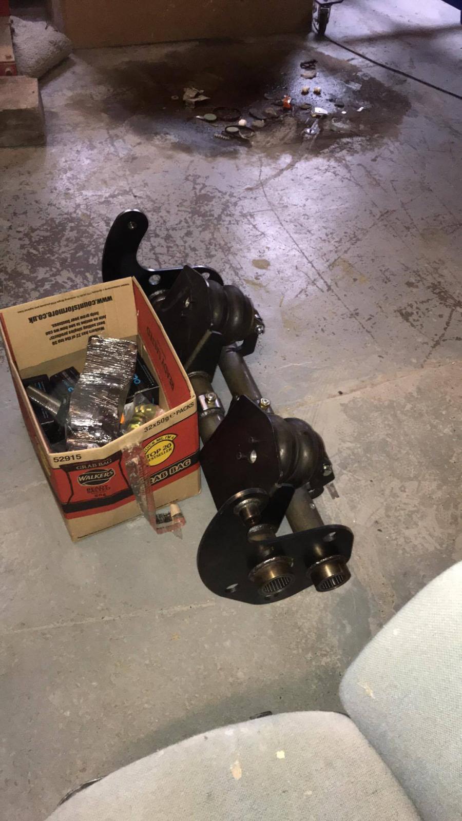

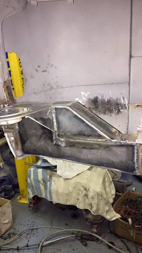

PostPosted: Thu Apr 17, 2025 1:30 am    Post subject: Re: Long running Custom Bay project - the Rebuild Reply with quote

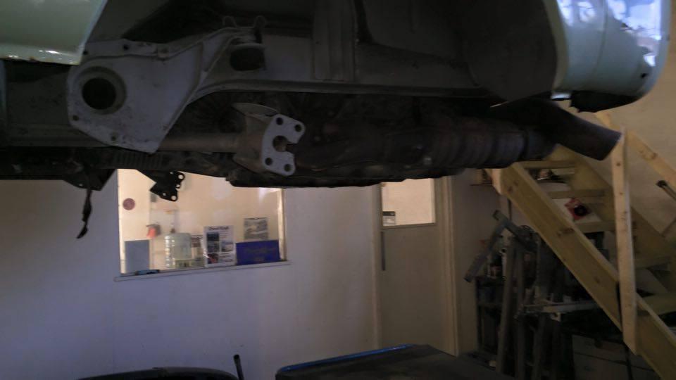

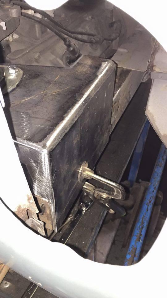

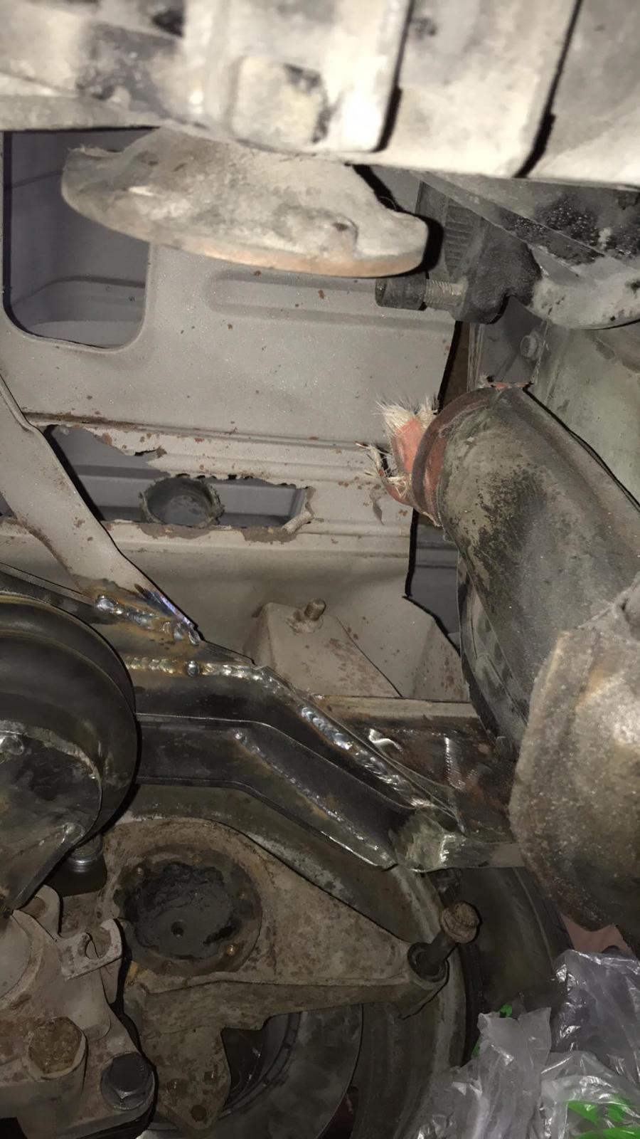

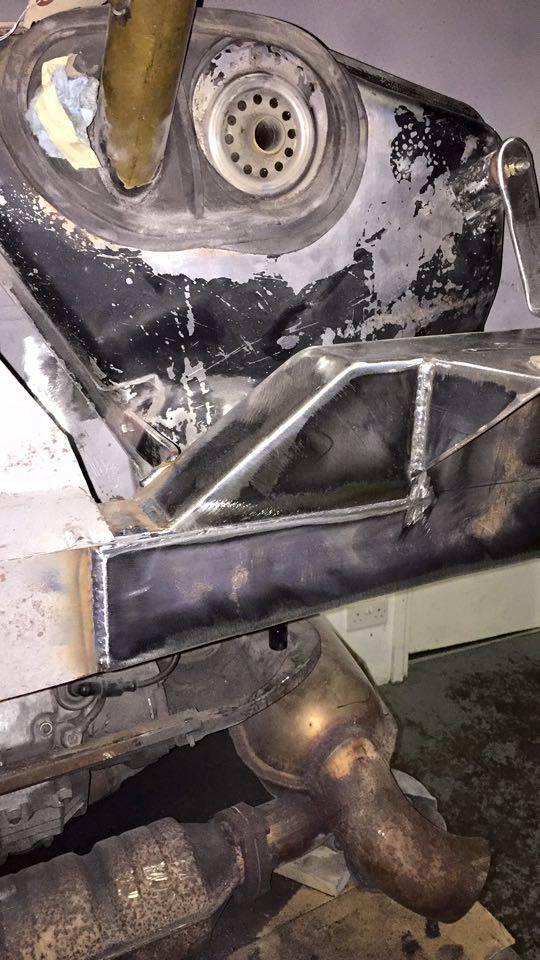

I am not trying to make the fastest van as you could do that with a turbo type 4 VW engine most likely. I love trying things that not many people have done properly, which means rebuilding the chassis to handle the extra power and weight and combining with brakes that will stop the thing!
The other challenge is using a 915 transmission with a gear shift that is in an entirely different place to a VW.
What you need is a genius fabricator which I am fortunate to have!
So a few teasing pics:
