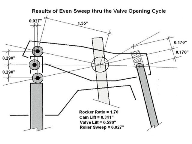

Here is the next video about setting up swiper style ratio rockers, with the adjuster on the pushrod end.

Great video, thanks for doing this. This engine novice has struggled understanding the whole lift thing and know I got it all wrong on my '74 w/a 1679. I'm going to try and correct that following this.

One question.
The point you are concerned with... is where the arc motion of the rocker assembly turns into the reciprocating up and down of the valve... the exact intersection of the two motions.
With stock rockers that's the valve tip, same with slipper feet... but with elephants feet, it's not at the valve tip.. is it? Same with roller rockers, or the devil's design, the swivel balls.. not quite the valve tip.. slightly further up.
Again. Fantastic video. Probably.. no.. definitely the best one out there for the average vw guy. You have righted so many wrongs!Smile
