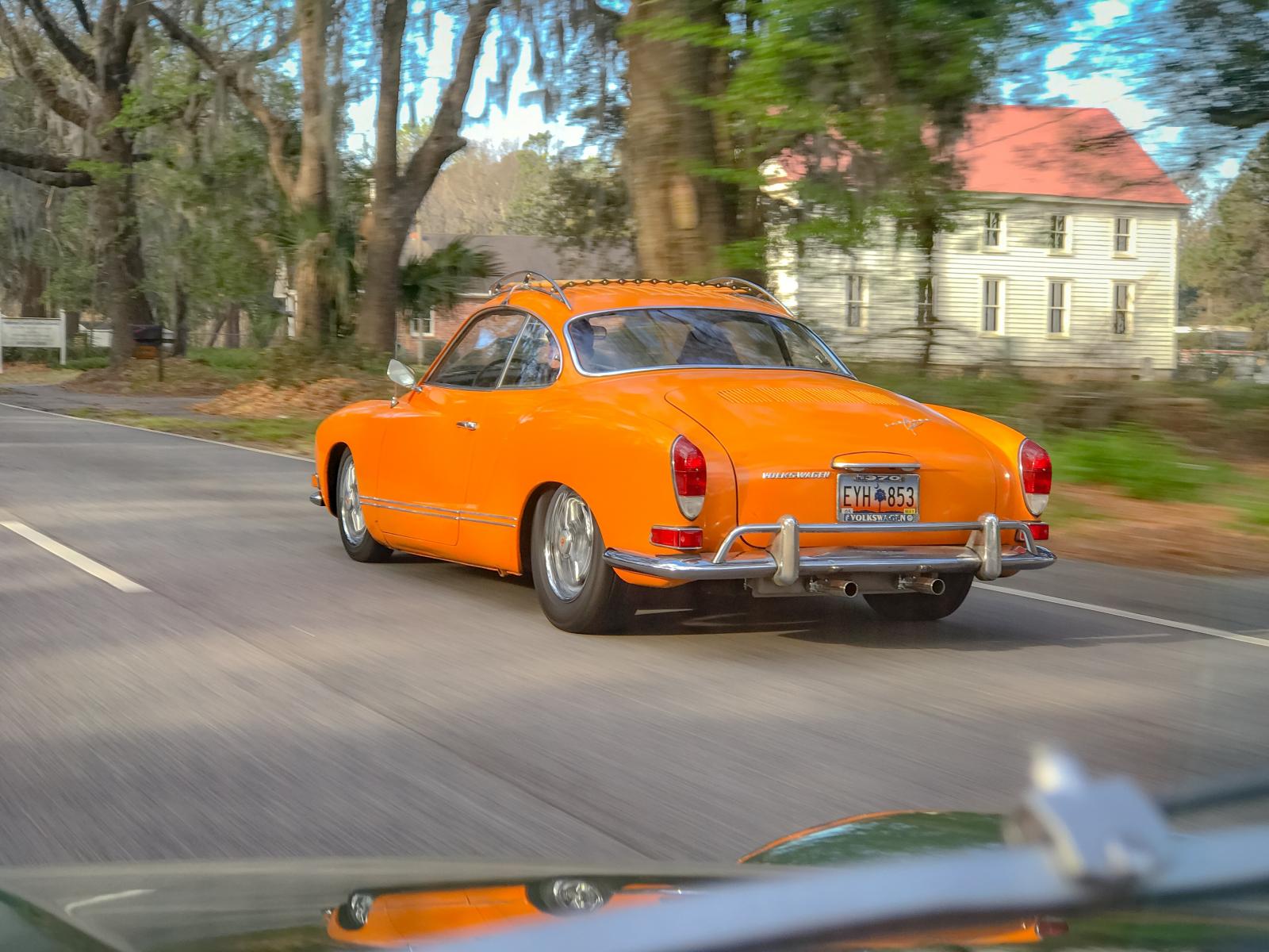

FWIW My wheels are 15x5.5 with 5” offset, 195/45 tires and 2.5” drop spindles on a stock beam. No rubbing.
